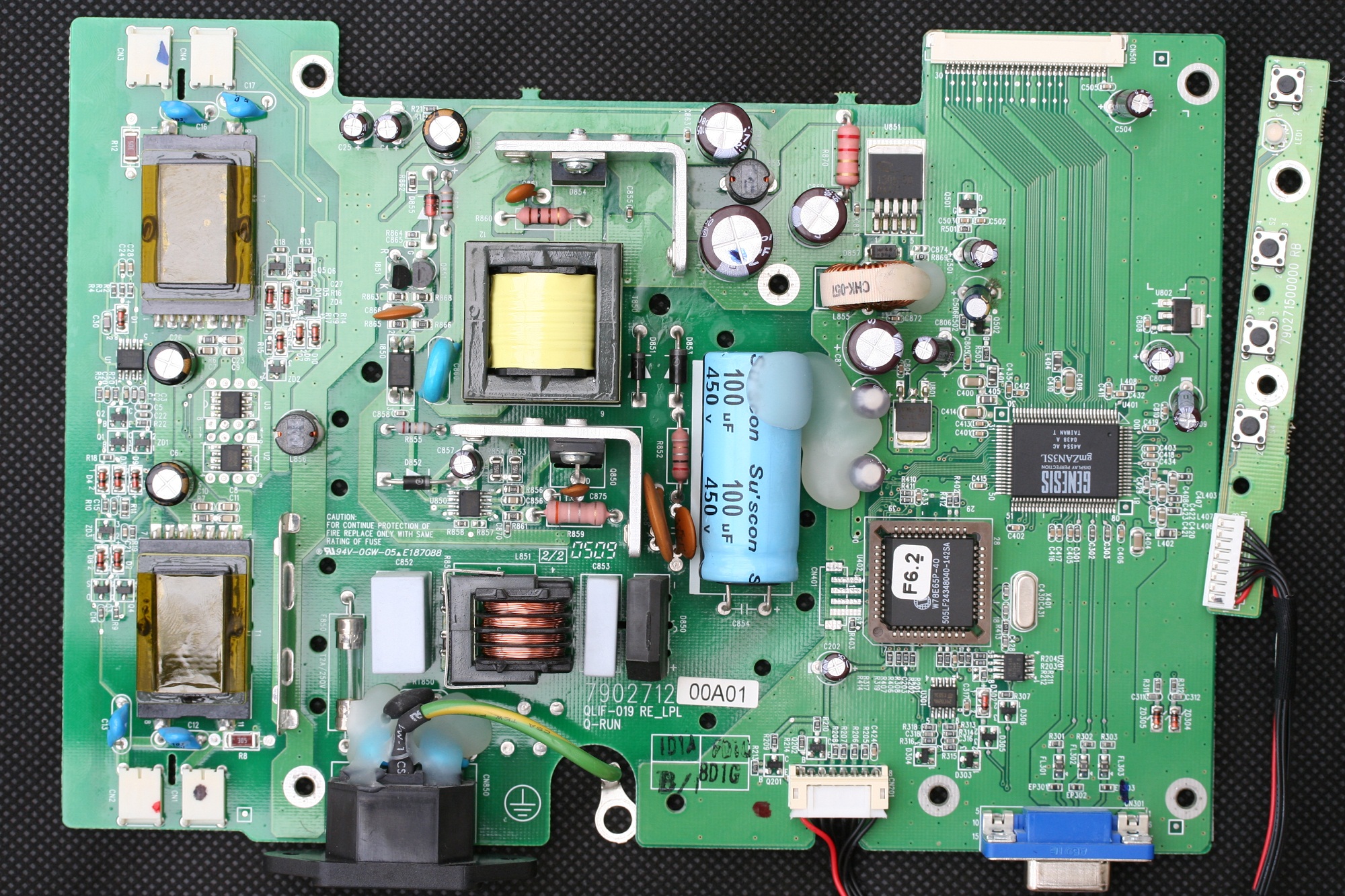

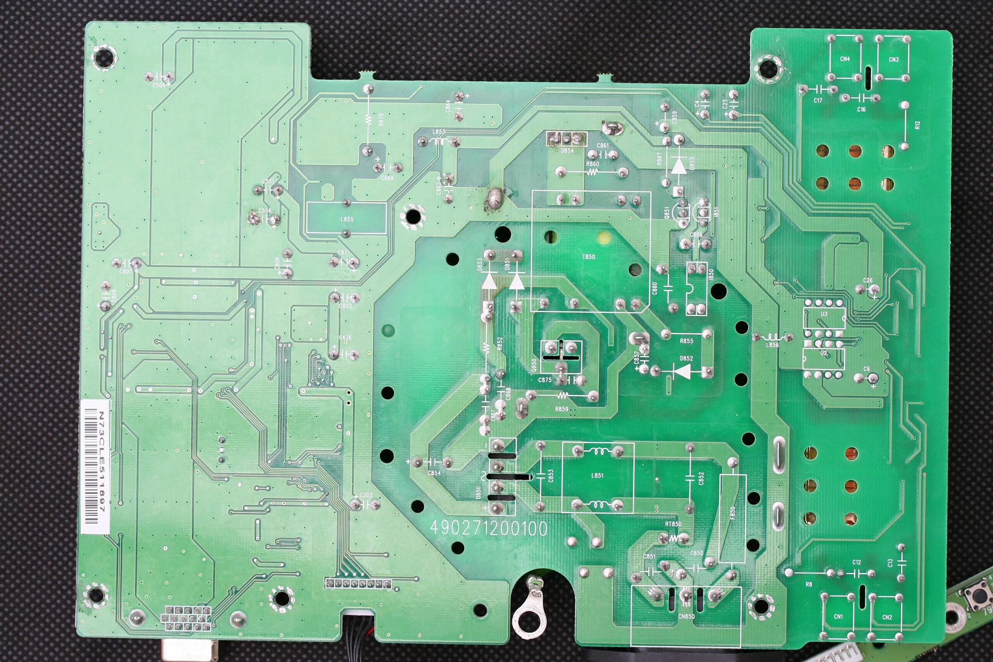

    Model: Dell E173fpf
    Fault: No power led comes on and nothing is displayed on the screen at all.
    Observations: constant ticking noise heard from T850 and I get a constant 131v from the primary capacitor (using mains earthing point)
    I have changed cap C506 (4.7uf 16v) as the ESR was slightly high - 2.1
    I have also changed D854 (SRF 10-10) as I had seen on another post that this part was faulty and before I replaced it the solder points looked slightly different compared to the rest, maybe due to it running hot?.
    I have checked the board and cannot see any burn mark at all. I have checked the larger resisters and these are fine. D850 which I think is known as a bridge rectifier tested fine.
    Questions: If I put my negative lead only from the DMM on the primary negative I get some fluctuations in voltage normally between 0.5 to 6v's so what could I do to get an accurate reading from the pins on U850?
    Could someone please confirm what Q850 does and how I might test this component?
    Many thanks
    Ps: I am aware that there is some excess flux which I didn't wipe off prior to taking the photo's.

    6) Those are excellent clear focused photos. Easily in the top 5 best photos this year.

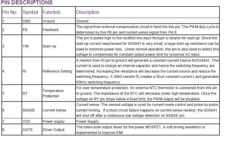

        3) U850 has these part no's (used a DSLR sensor loupe for reading - very handy!!) on it SG6841S & KA126690501E I have located the datasheet and included some diagrams.
        datasheet specs:
        Min Typical Max
        U850 - startup threshold voltage 15 16 17
        - minimum operating voltage 9 10 11
        I tested the resistance on Q850. I get 94K between G&S but testing S-D or D-G the resistance keeps changing normally increasing past the 200k mark.

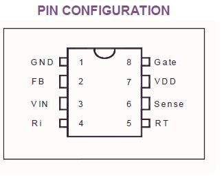

              1) Okay, I have one more test that I can think right now.
              Measure the resistance between pin 1 (GND) and other pins. That is, 1-2, 1-3, 1-4, 1-5, 1-6 and 1-8. Report all readings.
              2) If none of them are shorted, my best *guess* is that SMPS IC is bad even though it is not shorted. If you search this forum for SG6841, you will see similiar cases where this IC is bad.
              If you have to order a new SMPS IC, I suggest replacing the startup cap with a Panasonic FC even though it tested fine with your ESR meter.
                  1-2 = 78.2K
                  1-3 = 30K-->130K+
                  1-4 = 26K
                  1-5 = open
                  1-6 = 41ohm
                  1-7 = 90ohm --> open
                  1-8 = 172ohm -->open

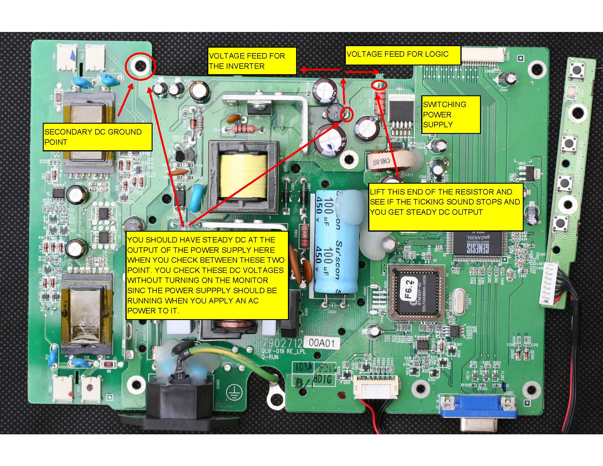

                      Re: Dell E173fpf - No led coming on
                      Please see the notes in the pictures, see what happen when you lift one end of the resistor and let us know what happen.
                      What I am trying to do is try to remove one load at a time to find out if the loads are causing the power supply to go into shutdown, or the power supply itself is having the problem.
                          Ok I lifted one end of the resistor at R870 ( and may have pulled part of the pad unfortunately at the same time) and the ticking still persists. I get no voltage at all when testing to the ground point or between the legs of L853.

                            OK, the shorted circuit is not in the logic circuits side, you will have to remove the round inductor and see if the problem goes away next, you have to use good 40watts or more with large tip (2.5~3mm wide tip) soldering tool to work on this double sided circuit board, otherwise you will be damaging the traces on the board.
                            • quattro alex
                              • Mar 2012
                              • 92
                              I have removed the inductor but the ticking is still there. Also primary cap DC voltage is fluctuating between 280 and 330volts.
                                I think this is shorted, but I can't be sure since I don't have this SMPS IC.
                                That pin 6 of the IC should be connected to the resistor (R859)Source leg of the MOSFET through R861 (value as printed on the body?) Can you tell us the value of R861 that is connected to Pin6?
                                OK, I see that the R861 is 470 Ohms, so you are reading 41 Ohms, it must have an internal short inside the IC as retiredcaps has suspected. You can try lifting pin six and measure the resistance between PIN 6 and Pin 1 again.

                                  470 is the value and when I test the resistance with the DMM on the 200 scale I get 47.0
                                  Fixed so far: GNR TS902W monitor, Sony Game Gear, Philips FCD565, Arcam Alpha 10, Memorex SA 404amp
                                    47 ohms is correct, I thought I saw 471 as printed but not sure if I was seeing it right.
                                    I do not belive you will be reading 41 Ohm between pin6 and Pin 1 if the resistor is 47 Ohms.
                                    • quattro alex
                                      • Mar 2012
                                      • 92
                                      Your correct - I've just measured again and the reading was 48.2 (-0.07 for leads resistance) = 47.5ohm
                                        OK pin 6 is good.
