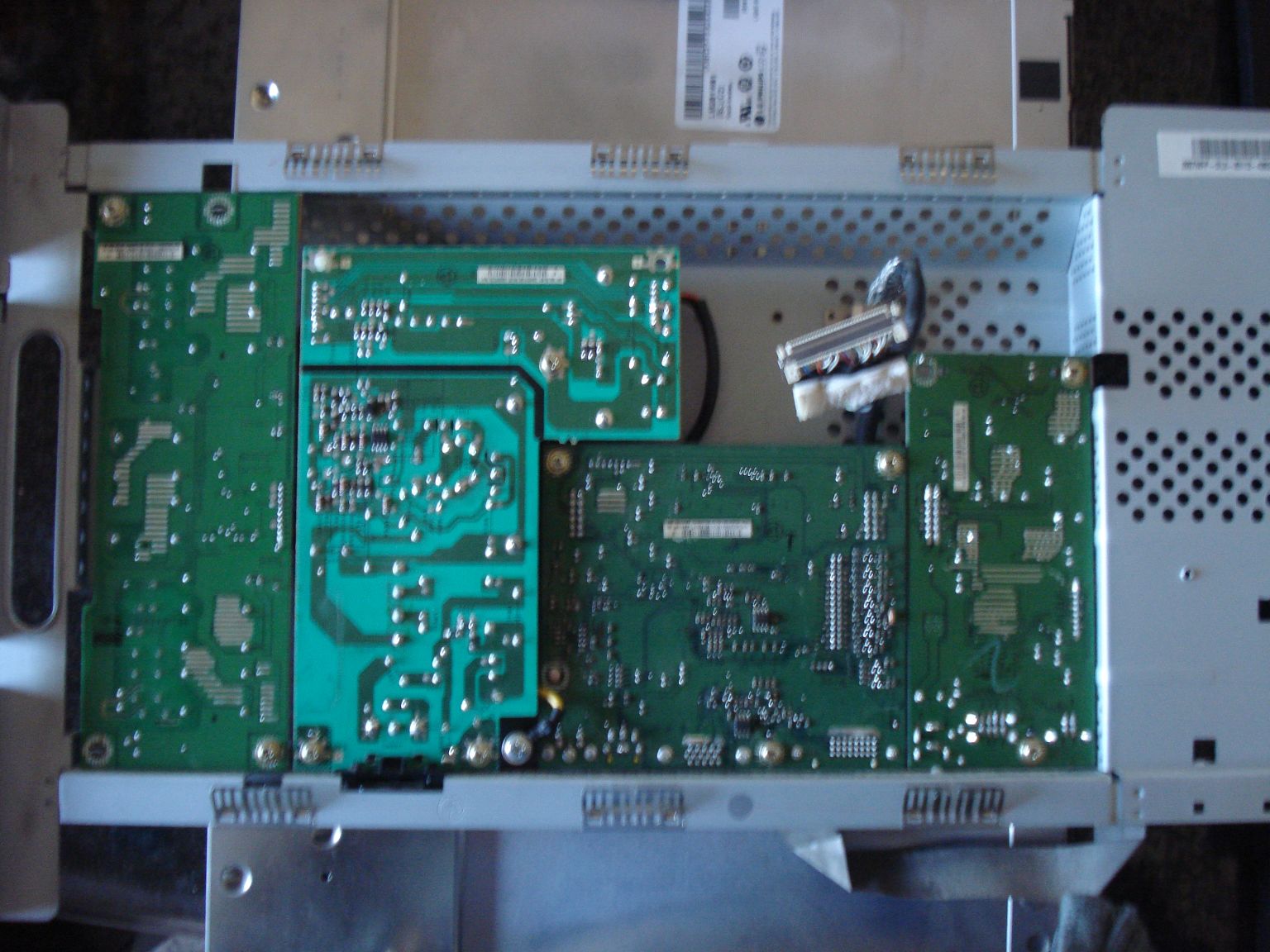

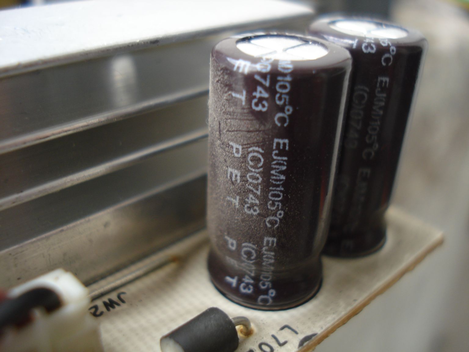

    Hi guys,
    My monitor just stopped working a few days ago. I´ve tried it in another computer but the problem persist. The thing is that when PC send signal to the monitor, power lights on green light, but is not showing the image, a few second later goes to amber light. The backlight starts when the pc send signal. I´ve opened the case and checked the caps but no one is damage.
    OSD is not showing either.
    Here are a few pictures I took from the logic board:
    http://*************/g/98/resizeddsc04634.jpg/
    Thanks in advance!!!

    Re: Dell WFP 2007 No image
    1) For several reasons, I prefer pictures so they are hosted on this forum. Follow my sig file below exactly to post your pictures. We want them in the following composition.
    https://www.badcaps.net/forum/showpo...94&postcount=1
    2) Do you have a multimeter and do you know how to use it?
            When it went into standby was it connected to a pc that was not in standby.
            Repeat retiredcaps question - "Does the screen stay white" that is does the back light stay on.
            You will almost certainly need a multimeter.
            Also a soldering Iron and solder.
            There is an inverter board in this set with 3 gray rectangular transformers on it
            Can you see if the number on it begins 4001R - picture would be good
                          Ok,
                          your picture shows 2 voltage regulators on the bottom left of your picture above.
                          One has a tab and 3 pins and the other has a tab and 2 pins. Please can you tell us the measurements off each pin and can you tell us what it written on the top of each one.
                          Fixed so far : 1 Home cinema system, 16 LCD Monitors, 4 LCD TV's
                          How to resize your pictures guide click HERE
                          Retiredcaps Ideal post example click HERE
                            Update: The monitor stays with green light on, and the backlight started. It has been there for about 15 minutes, no image.
                            A picture of the problem would help.
                            We also need a picture of the panel board. It is the long board that runs the entire length of the lcd at the top.

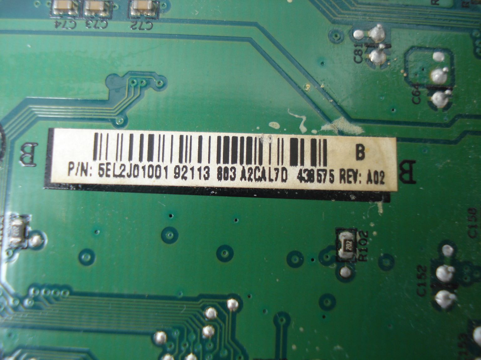

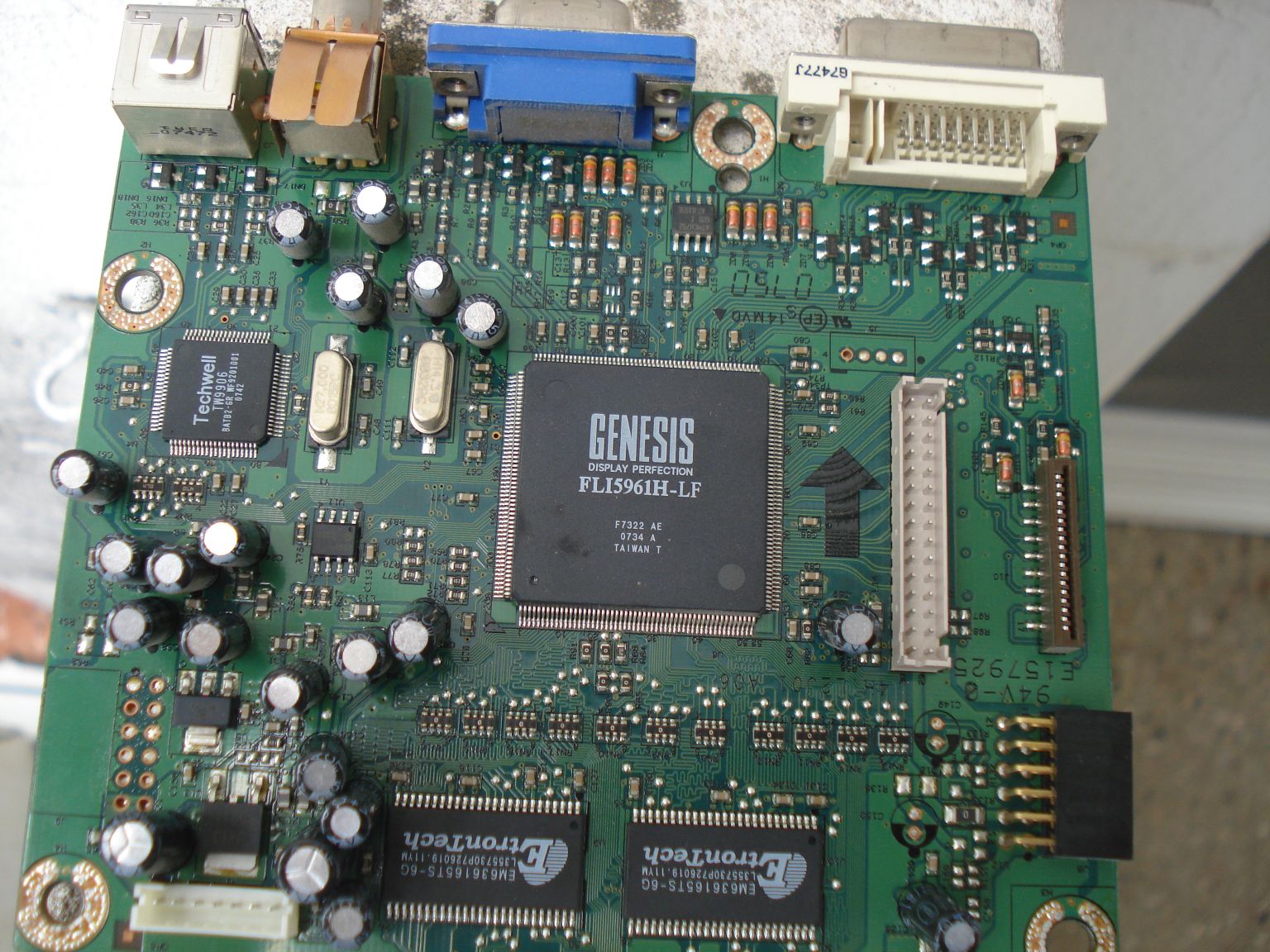

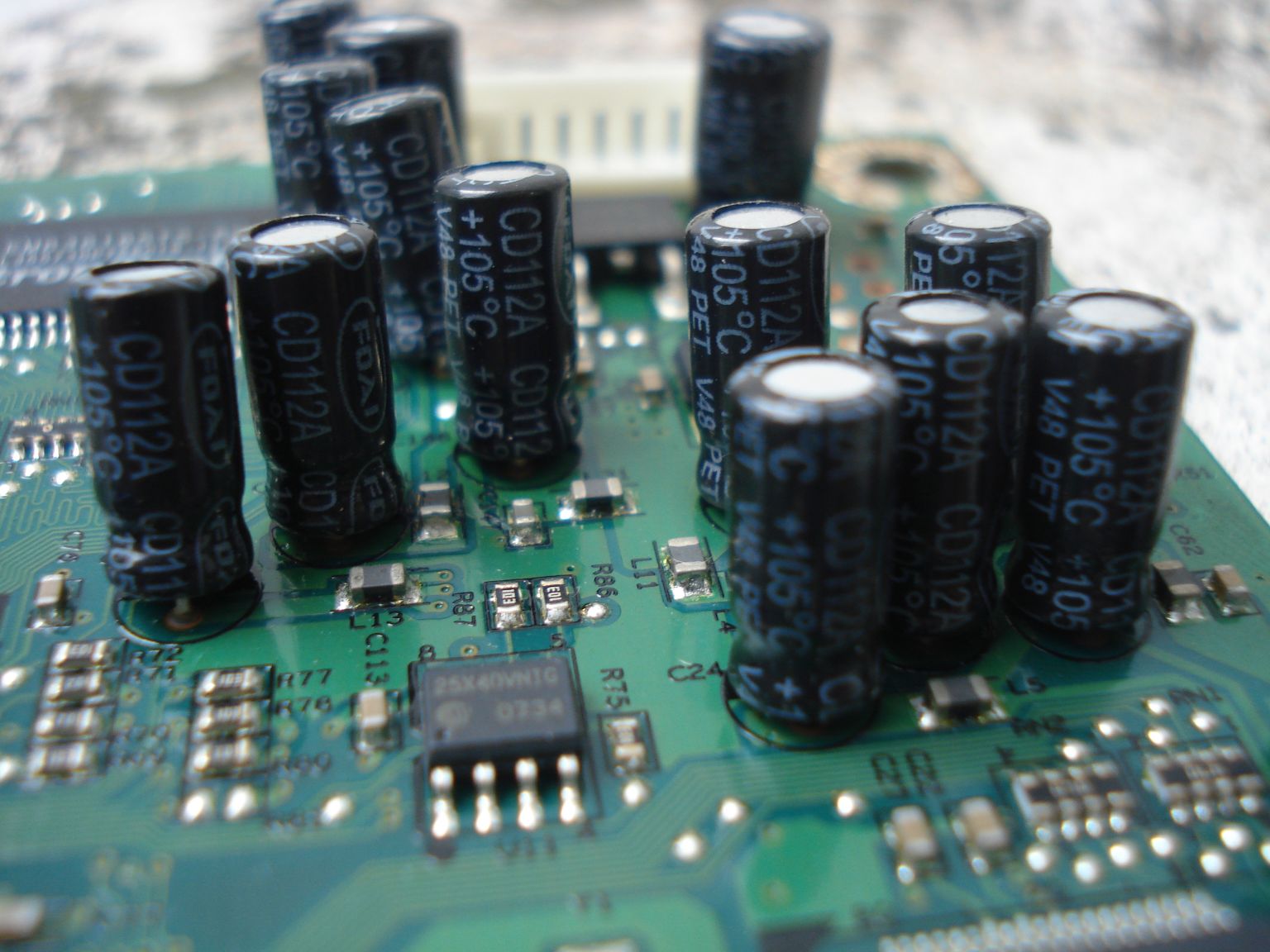

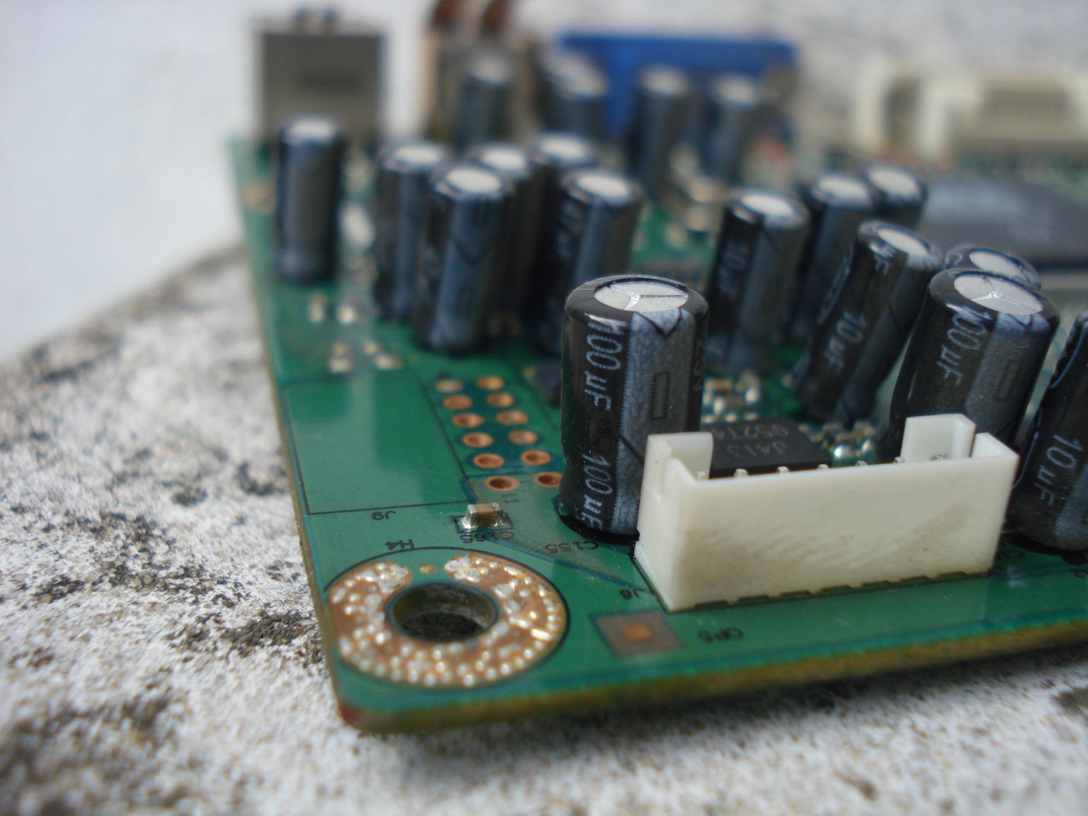

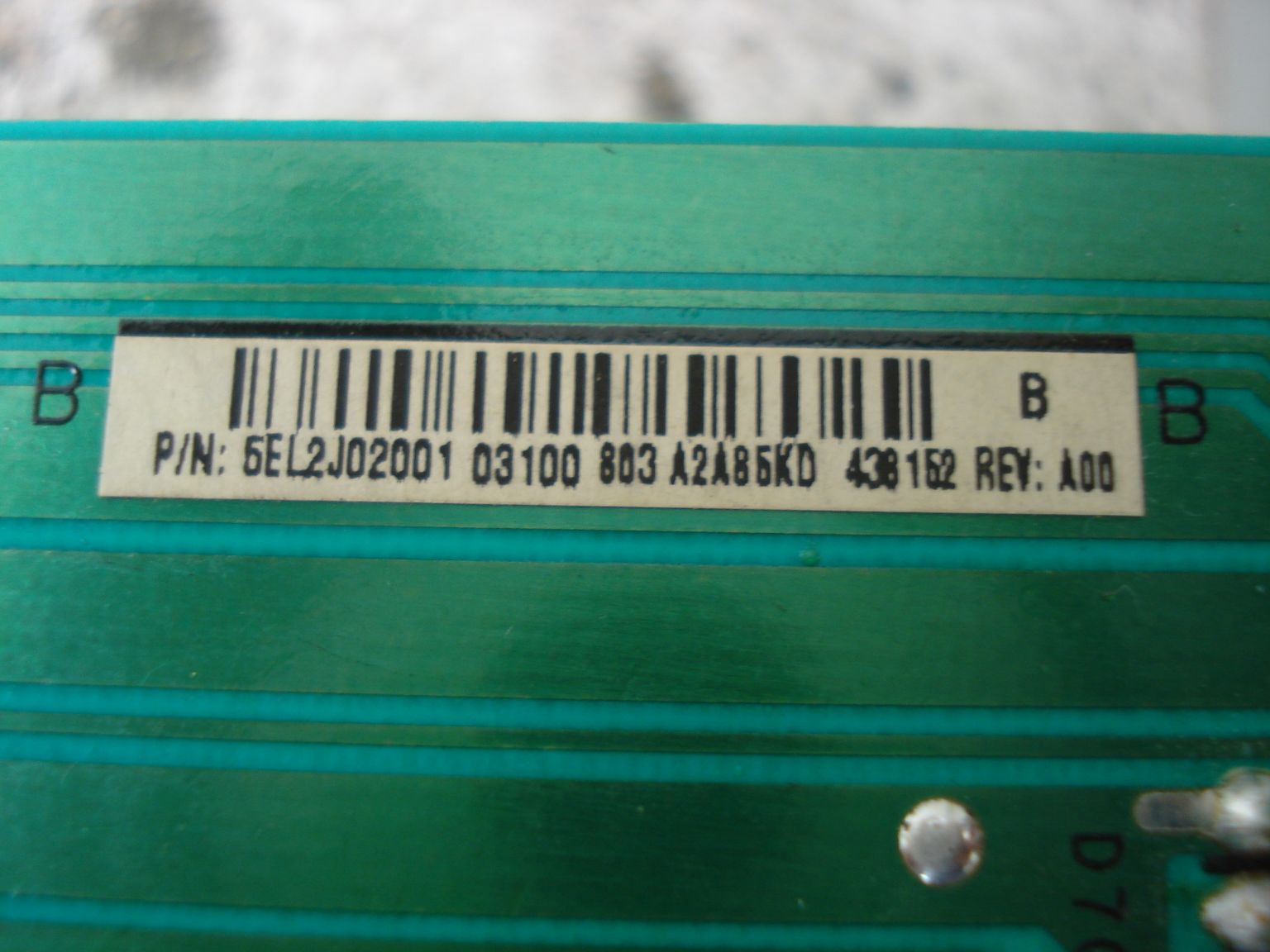

                                  I have added 2 more images, please let me know if you need more of them.

                                      I have uploaded more images at the top of this post, from the other side of the cards, please let me know if you need something specific.
