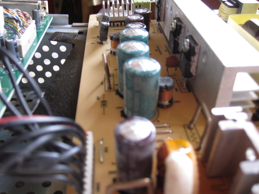

    so basically i have had this acer AL2623W 26inch screen for a number of years now
    i always noticed a small noise coming from the back for many years now but in the last month or so when the screen came back on it used to flicker over the whole screen for a few seconds, i'm guessing until its warm? also some other slight electrical sounds.... so i knew it was on the way out, but i dont have any problems with dead pixels etc and its a pretty good screen so i would like to try and rescue what i can
    so earlier today the flickering started when i was using the machine, it had been on for a while, so i turned off at button and back on again, but this time it would not fire up! was a regular sound coming from the back trying to fire it up
    turned off my cpu and screen and came back later, same again but i left my cpu and screen on, back in 10 mins to see half the screen on the right very dull and still flickering so i tried changing some menu settings just incase but nothing changed it
    i had a hnch it might be some parts replaceable at the back so took it apart and got to the back and exposed the boards, its late here now and will wait for sunlight to take pictures and put them up in the next few days
    the bigger board has
    3x Samxon 680uF 35v - these are all slightly bugled and one has a small amount of browning at the top, not much but certainly present
    1x Suscon 680uF 25v - this looks bulged too, clear of fluids, the yellow board has changed colour near this one tho [darkened]
    all the other capacitors do look ok from what i can see inc the big black one, also on the smaller green board everything looks good
    hope that will help for now until i can get some pictures up to show u, if there is any info i may of missed please let me know and i will do my best to find out and show
    thank you very much in advance

        Re: Acer AL2623W: flickering soon followed by more problems

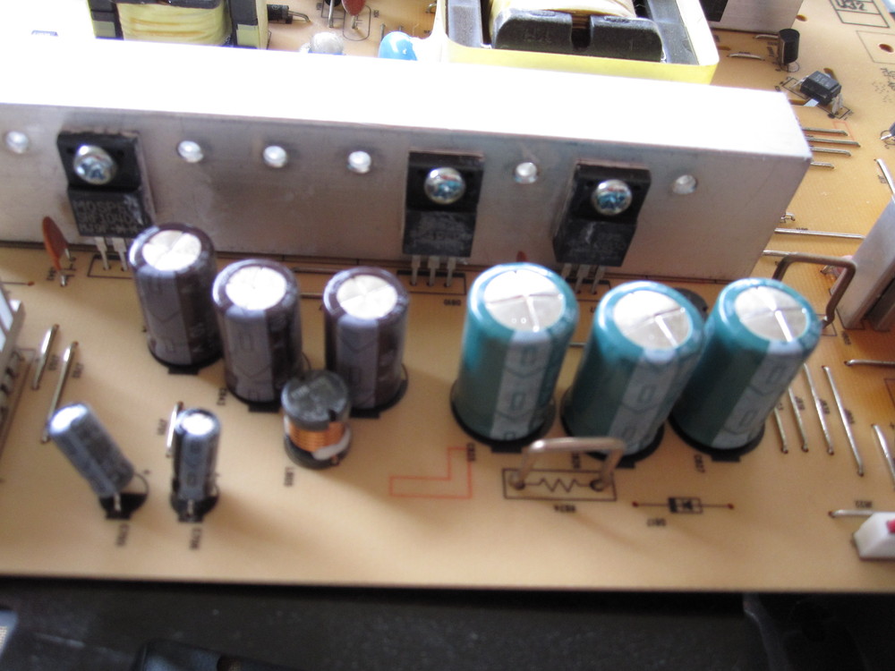

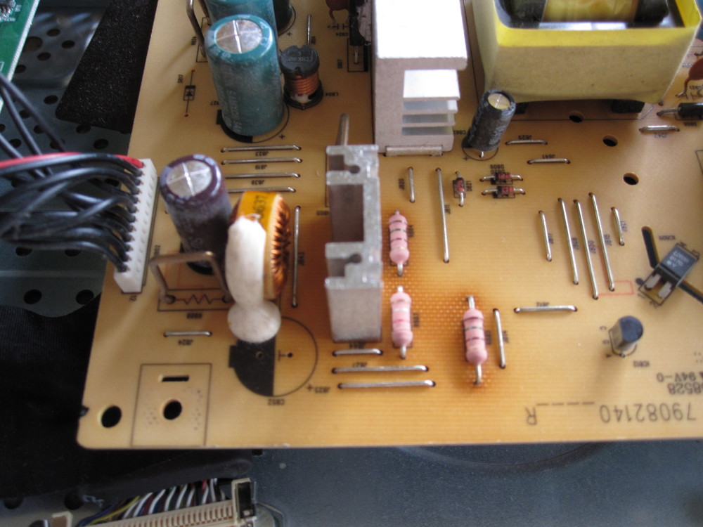

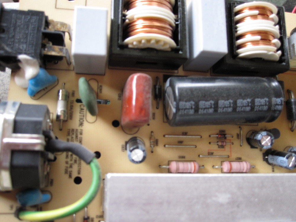

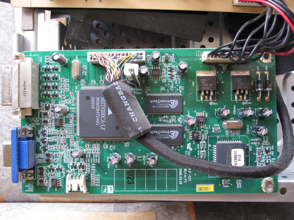

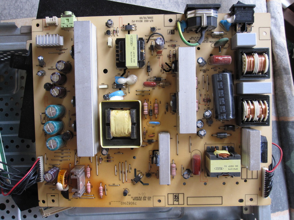

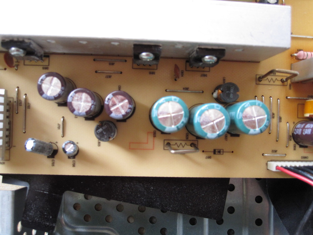

        ok here are some pictures
        hope they are ok
        picture 3/4/5 is the suspect caps, the three green larger ones are obviously knackered and the one in the corner on picture 6
        in picture 6 u can also see ths discolouration of the board, this was where the noise was coming from too
        anyone know any good german vendors for new caps?
          Some discoloration is normal because there are mosfets or transistors probably on the backside and they tend to run hot.
          See
          https://www.badcaps.net/forum/showthread.php?t=613
          We have a number of German members and maybe one will provide some real life input?
          It is important to get proper low ESR caps for replacements on the power board.
            funny thing is on the other side of that tiny heatsink, there is no mosfet!

                            It likely is. No monitor will work properly when you have at least 4 or 5 obviously bloated capacitors.

                              You definitely have several bulged caps in the the power supply. Therefore, replacing all the caps except for the large 450v one would be advisible and a step in the right direction. As for the inverter, can you please post a photo of the entire inverter?
