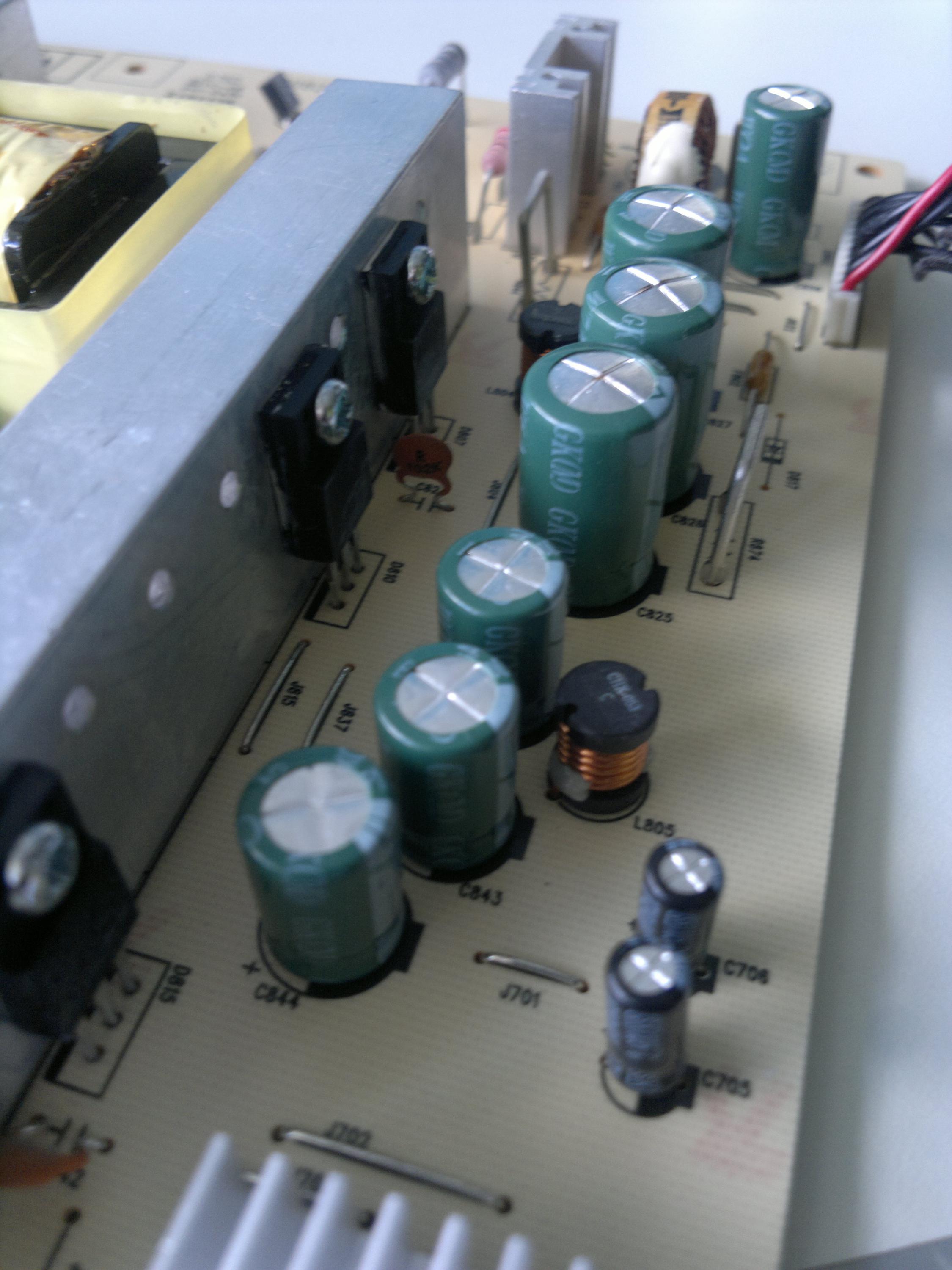

Acer AL2623W: flickering soon followed by more problems
    Re: Acer AL2623W: flickering soon followed by more problems
    You can try this:
    https://www.badcaps.net/forum/showthread.php?t=19987

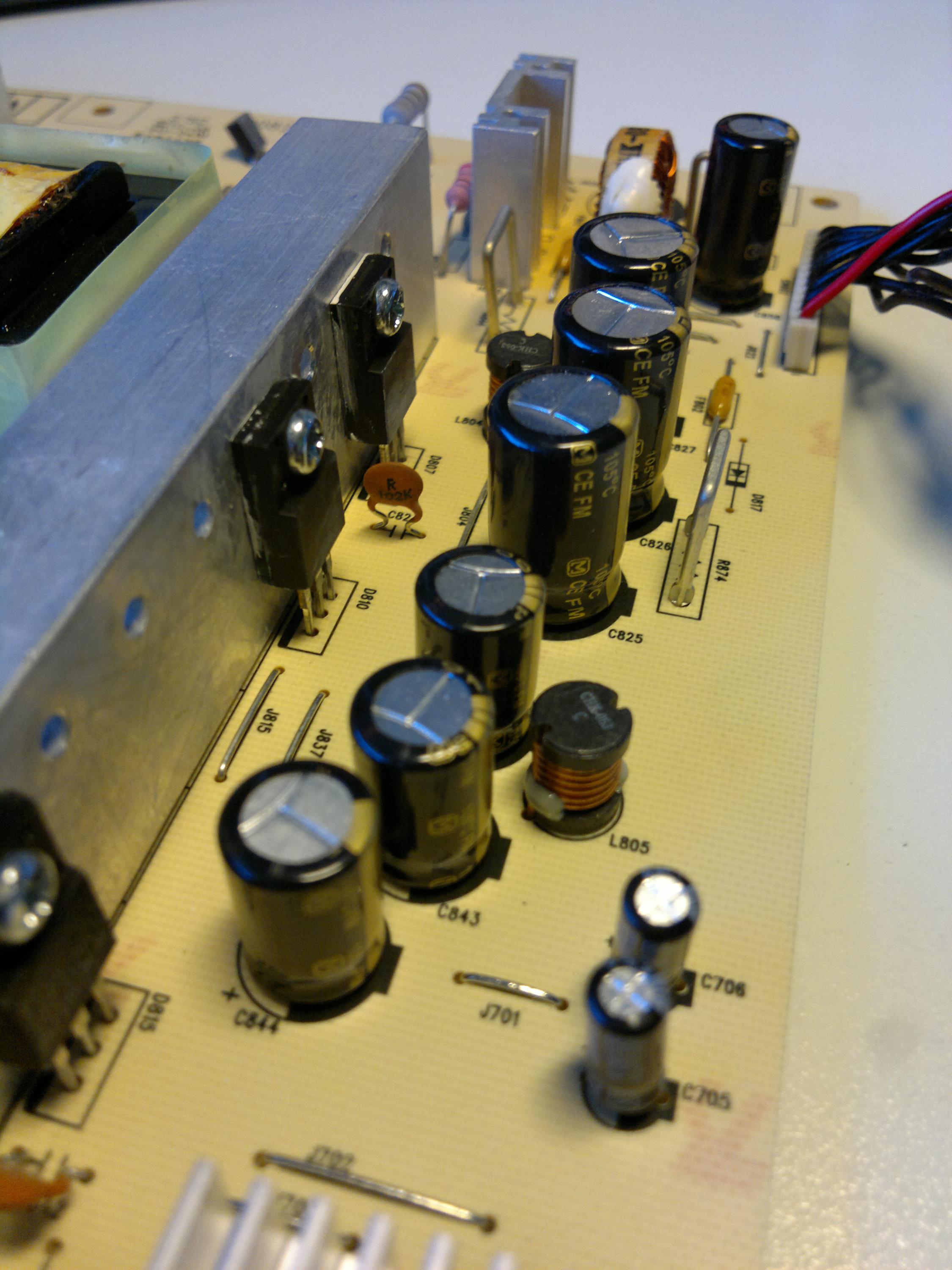

        Hi all, i am bringing this up from the past, as I have the same monitor and few days ago i came up with the same flickering problem.
        By checking the mentioned caps on the power board of the monitor, it was obvious that some of them were bulged, so i moved on changing all of them.
        I replaced them with Panasonic FM series.
        And the monitor came back alive and even brighter than before, with no issues.
        You can check in the photos the before and after.
