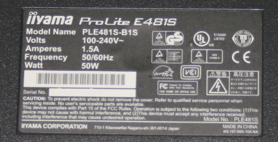

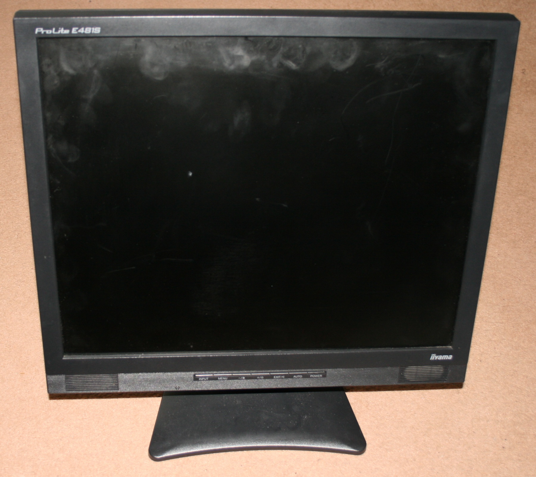

    Picked up 4 monitors today so I thought I would share my experiences with them.
    First up was was the iiyama ProLite E481S
    Advertised Issue : No Power at all

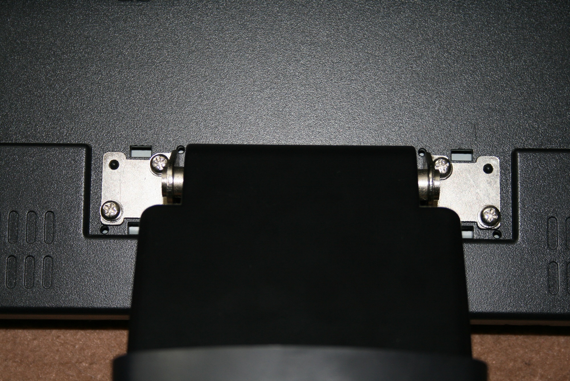

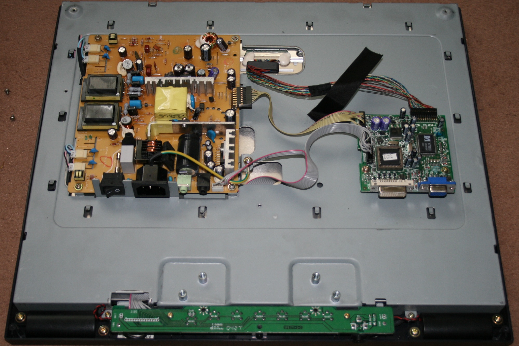

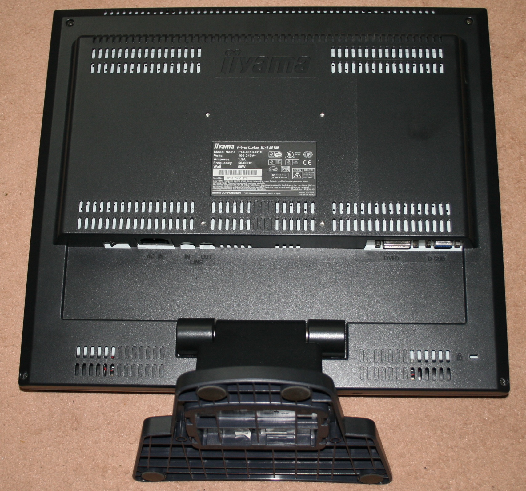

    Taking the monitor apart ( Regulars may skip ) : There are 2 caps on the left and right of the stand where it attaches to the monitor these are easily removed with a flat headed screwdriver. This reveals 4 screws that need to be taken out to remove the stand.

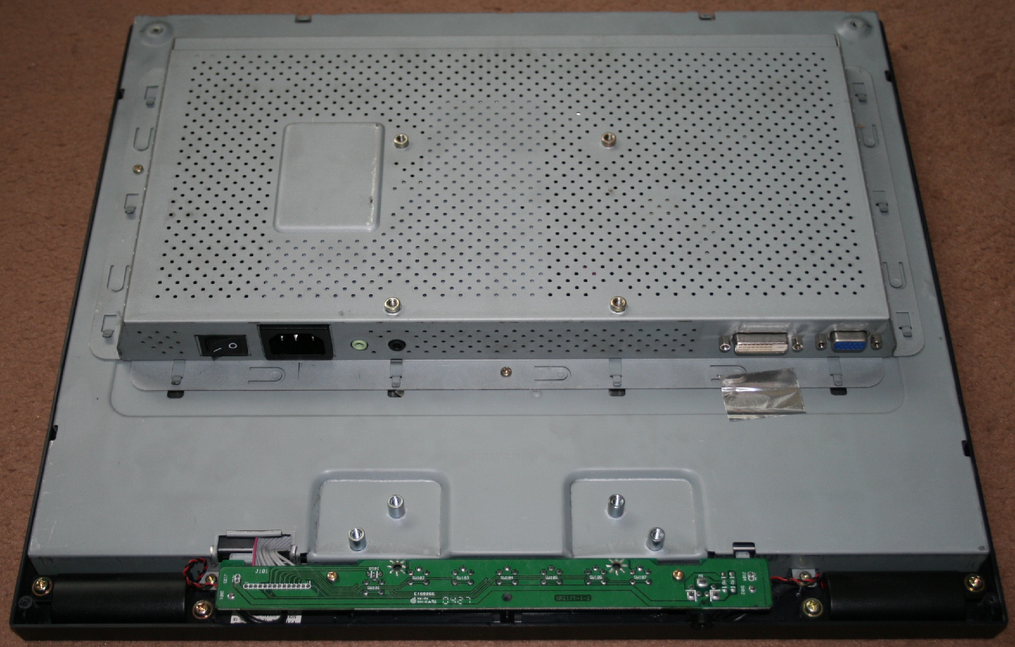

    There are then 5 screws around the back of the monitor 2 small at the top and 3 larger ones at the bottom which need to be taken out. The monitor then needs to be carefully pulled apart from the bottom then down the sides which allows you to pull the back off releasing it at the top.
    2 screws holding the metal cover on need removing to reveal the boards.

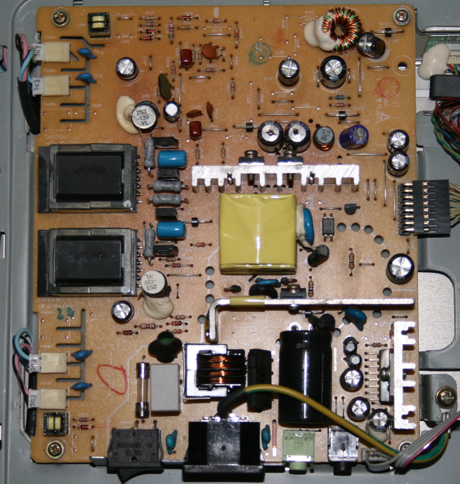

    Testing : All fuses checked on there were 3 in total and the big filter cap measures 330V + when turned on so I knew the juice was getting there. I did notice 2 badly blown caps at the top of the board.
    C914 - 1000uf 16v
    C915 - 1000uf 16v
    I didn't have any 16v caps so I used a couple of 25v ones instead.

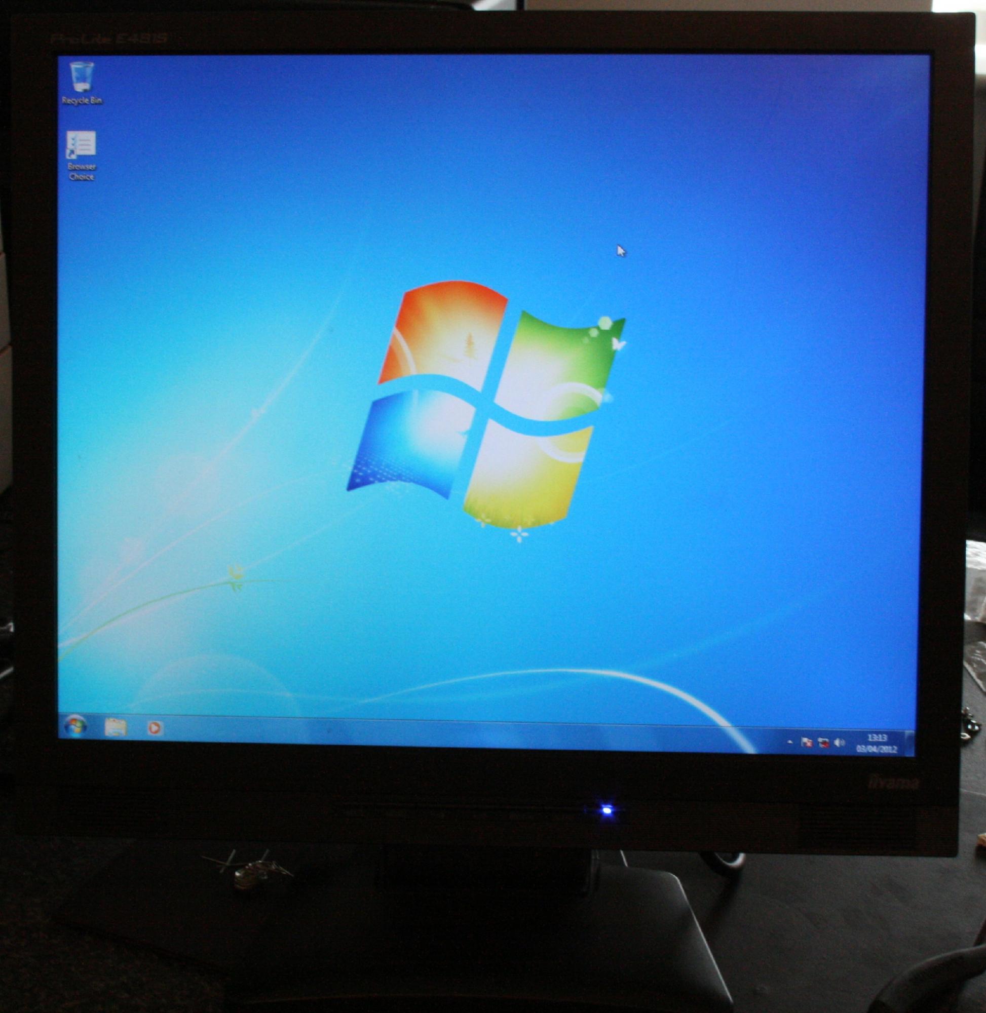

    Once these were fitted I gave the monitor a quick test and it fired up fine. I then put it back together and its been on all the time I have been writing this out so that seems to have done it.
