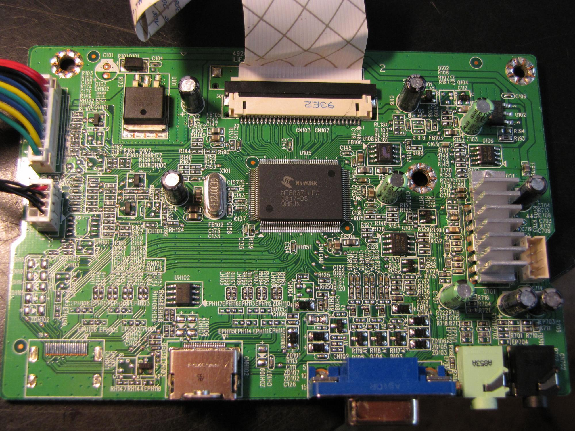

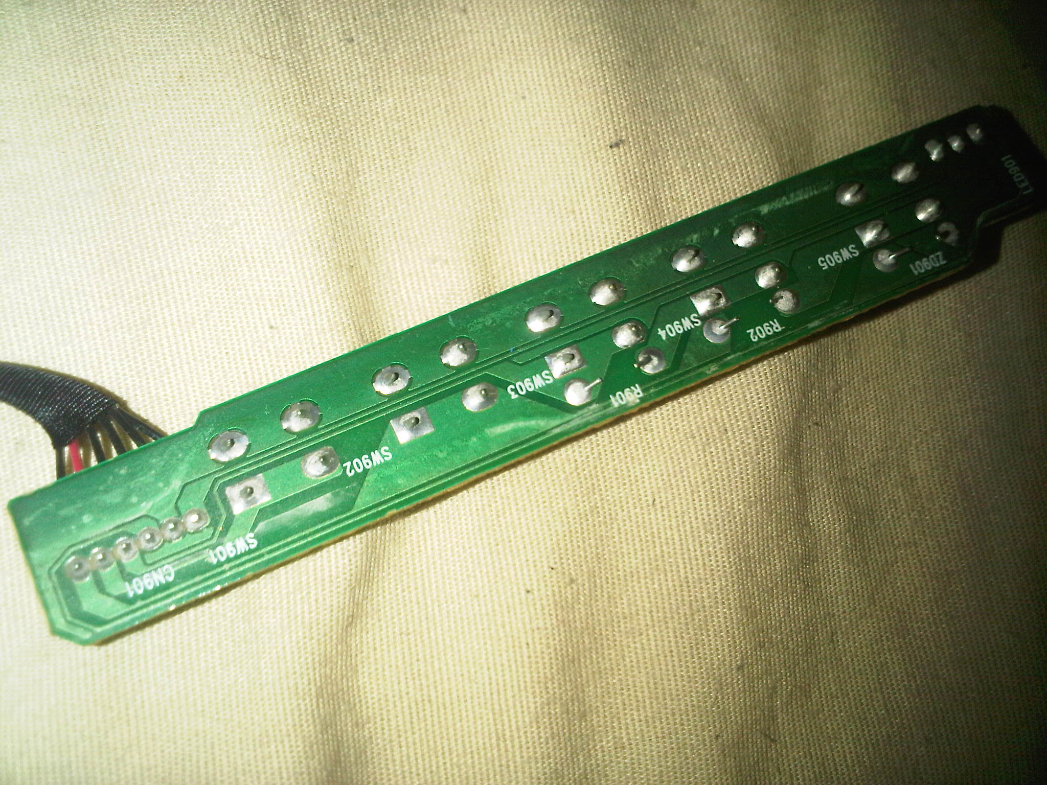

          Re: Hannspree hf237 problems
          Update: Pix and vid!!
            Good clear focused pictures.

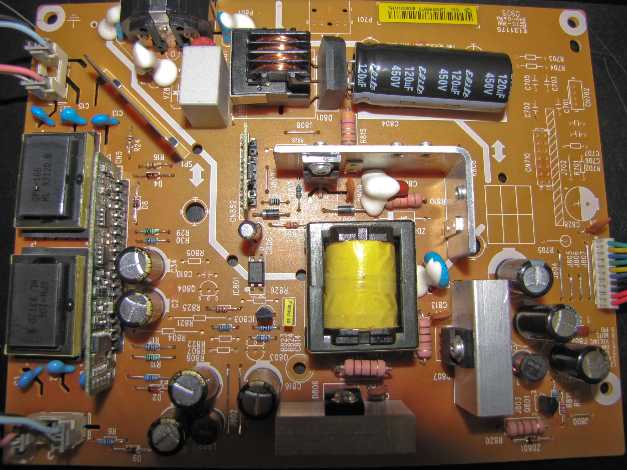

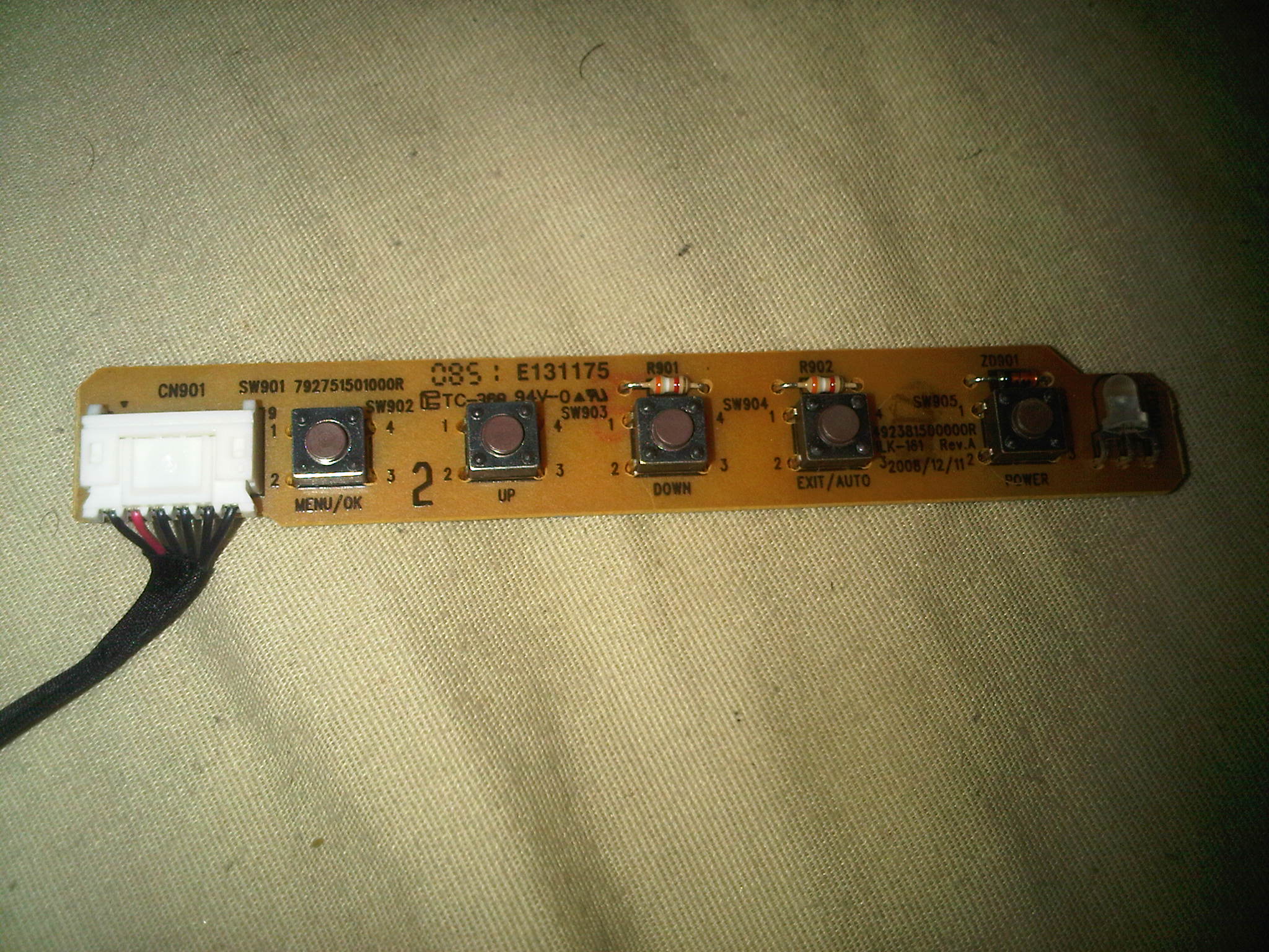

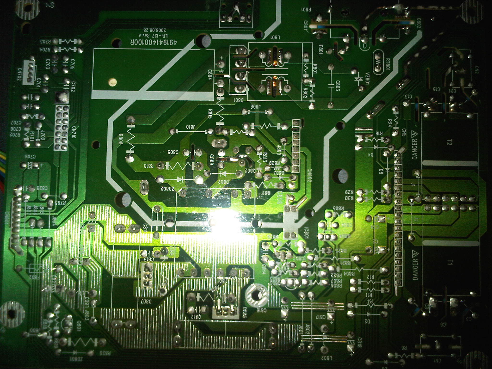

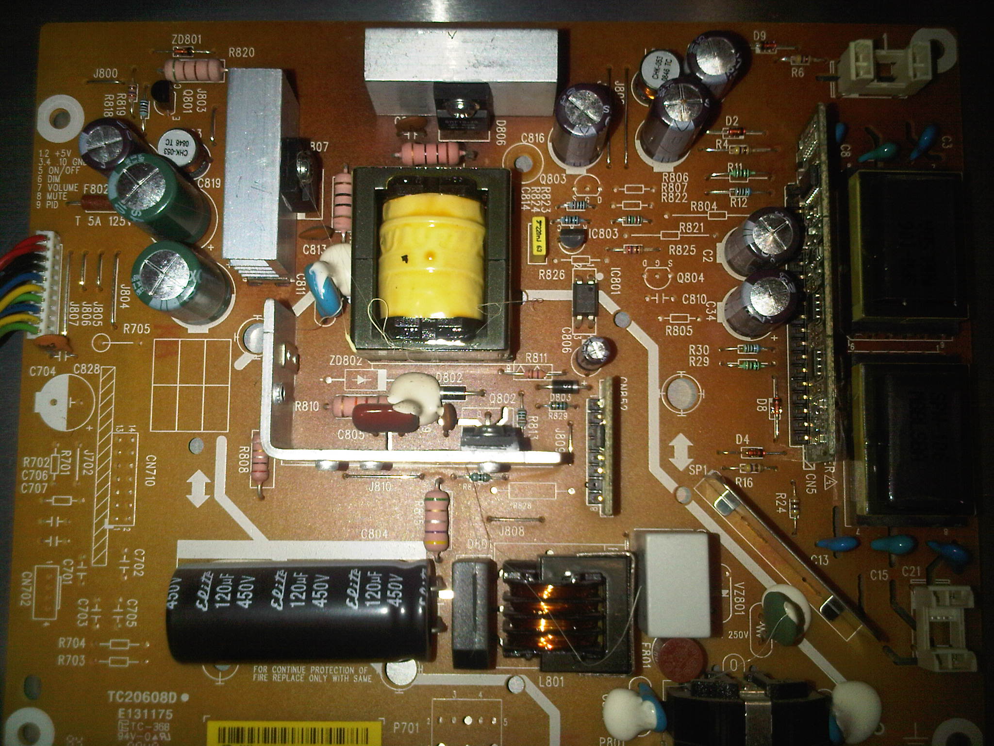

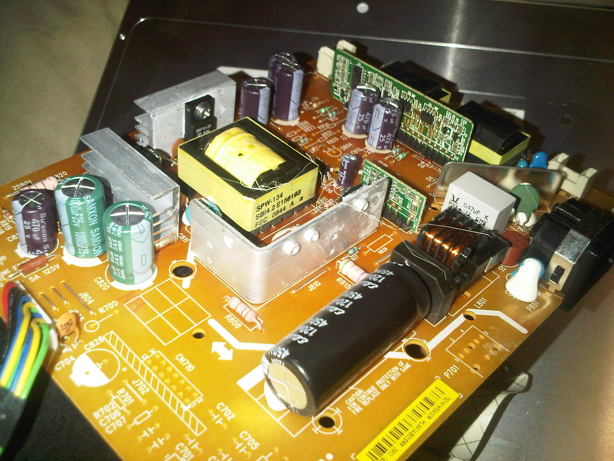

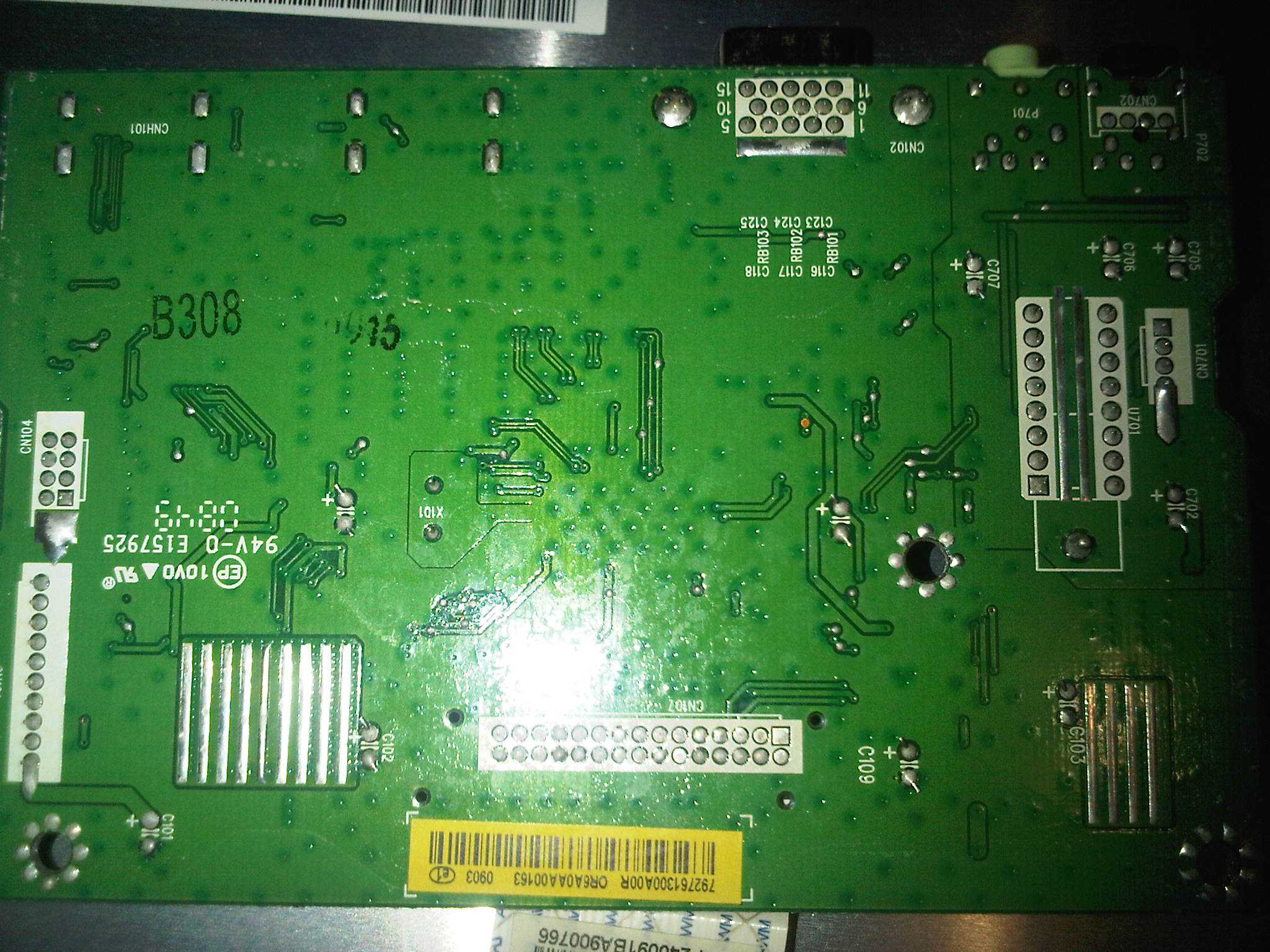

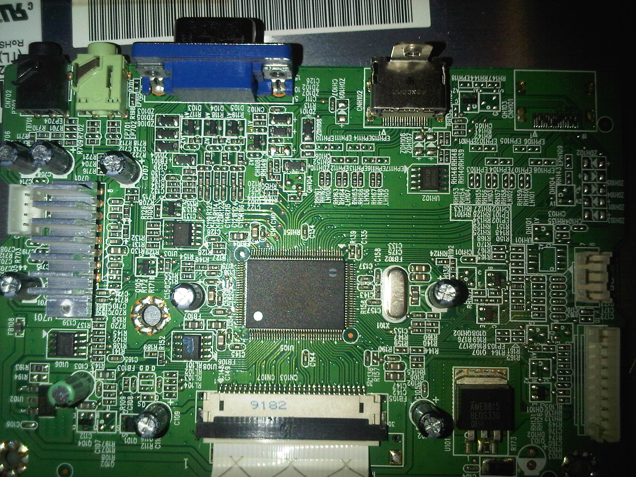

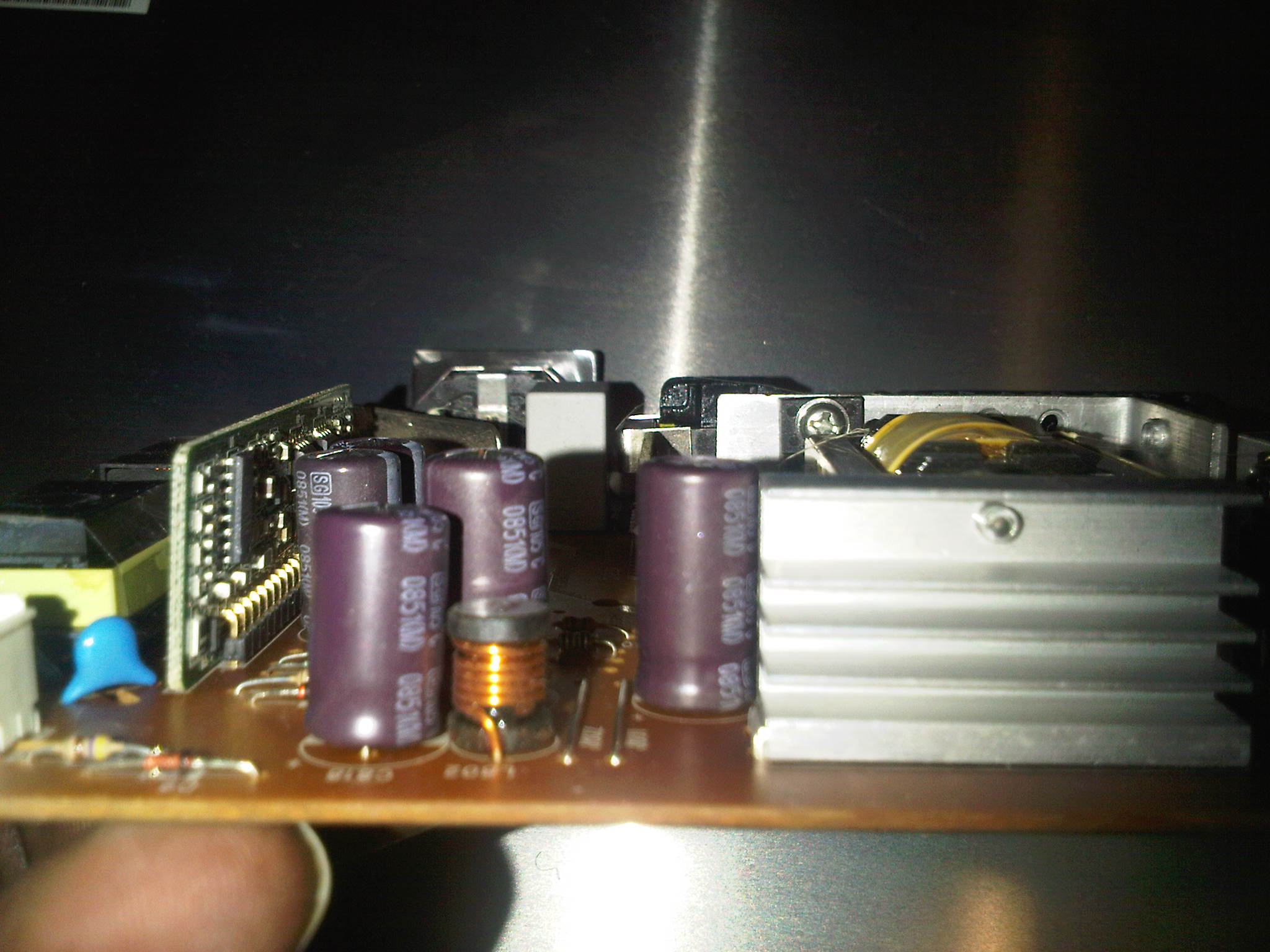

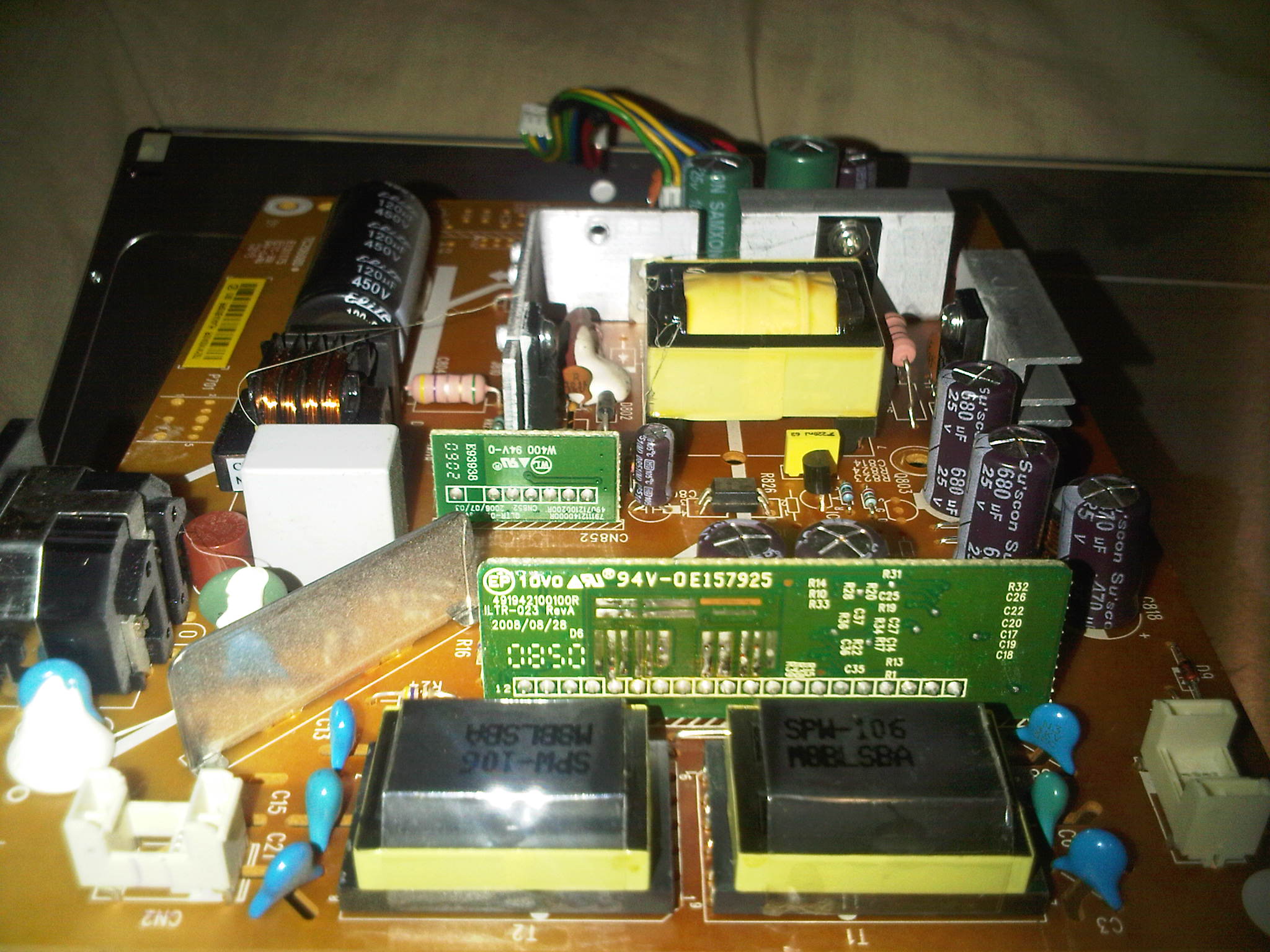

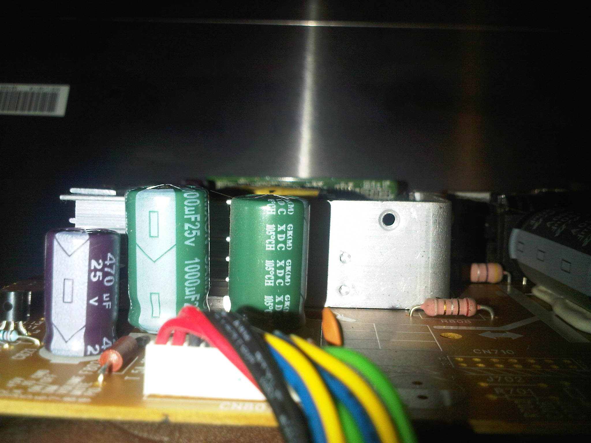

                                ok i took the pictures, i hope they are good enough. just today the power went again and its totally not coming on this time.
                                  Looks like you have a lot of bulged capacitors on the power supply board. With the exception of the large 450V cap, you should replace them all with something like Panasonic FR/FM/FC series caps. I counted 9 caps.

                                      9 caps in all or 9 caps that need replacing? and where would i find those caps? any suggestions?
                                        Here is a clue for the 25v1000uf cap BUT you will need to check the height and diameter of the caps you have and get the same or smaller
                                        http://www.digikey.com/scripts/dksea...=20823&stock=1
                                        That is for FR series if they dont have FR in the size look at FM then FC
