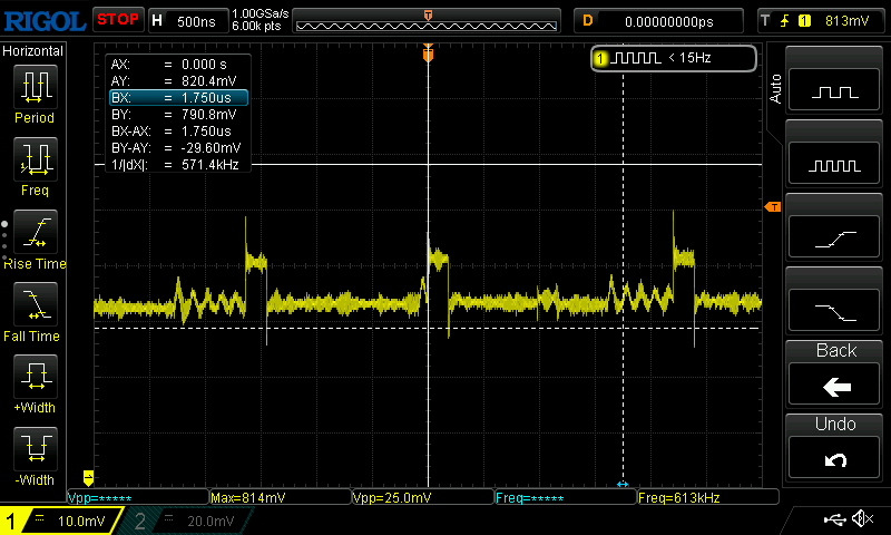

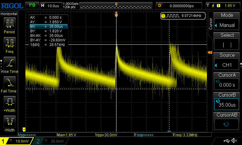

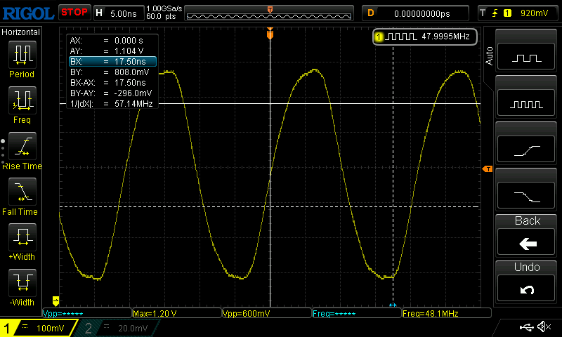

                APU_RST# is at 1.81V (for a very long time directly from fan spin, didnt sit there with my probes to wait until it resets)
                All other values are at what they are supposed to be (interpreting # as is supposed to be 0V)
                I also attached 3 pictures.
                Picture 1: LPC_FRAME#
                Picture 2: YC pin 1
                Picture 3: YC pin 3
                Edit: The picture order is reversed. check the file names to see which image i am refering to.

                  Sorry but RST# signals are a Little confusing.
                  RST# signal should not stay enable (low state) for a long Time, they have to rise up immediatly after resetiing what they have to.
                  There is a # to say « reset active position is low » but signal can't stay in reset position.
                  Mb chip just need a fast reset not a continous reset, just like when you press a power/reset button, you don't press the button for an hour or you computer Will restart continuously
                  So your results are weird, APU_RST# is ok but other signals at 0v are not, double Check please.
                  Crystal is ok (YC1). 😊
