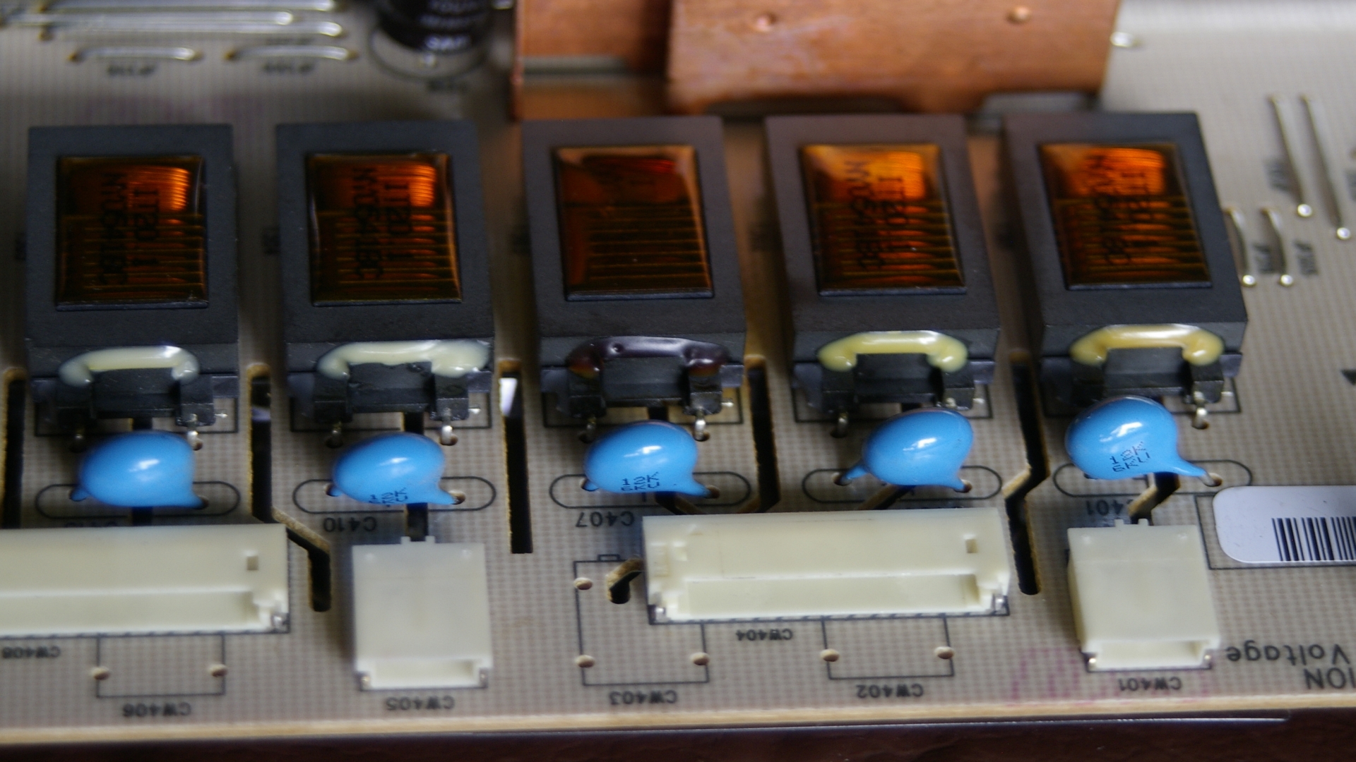

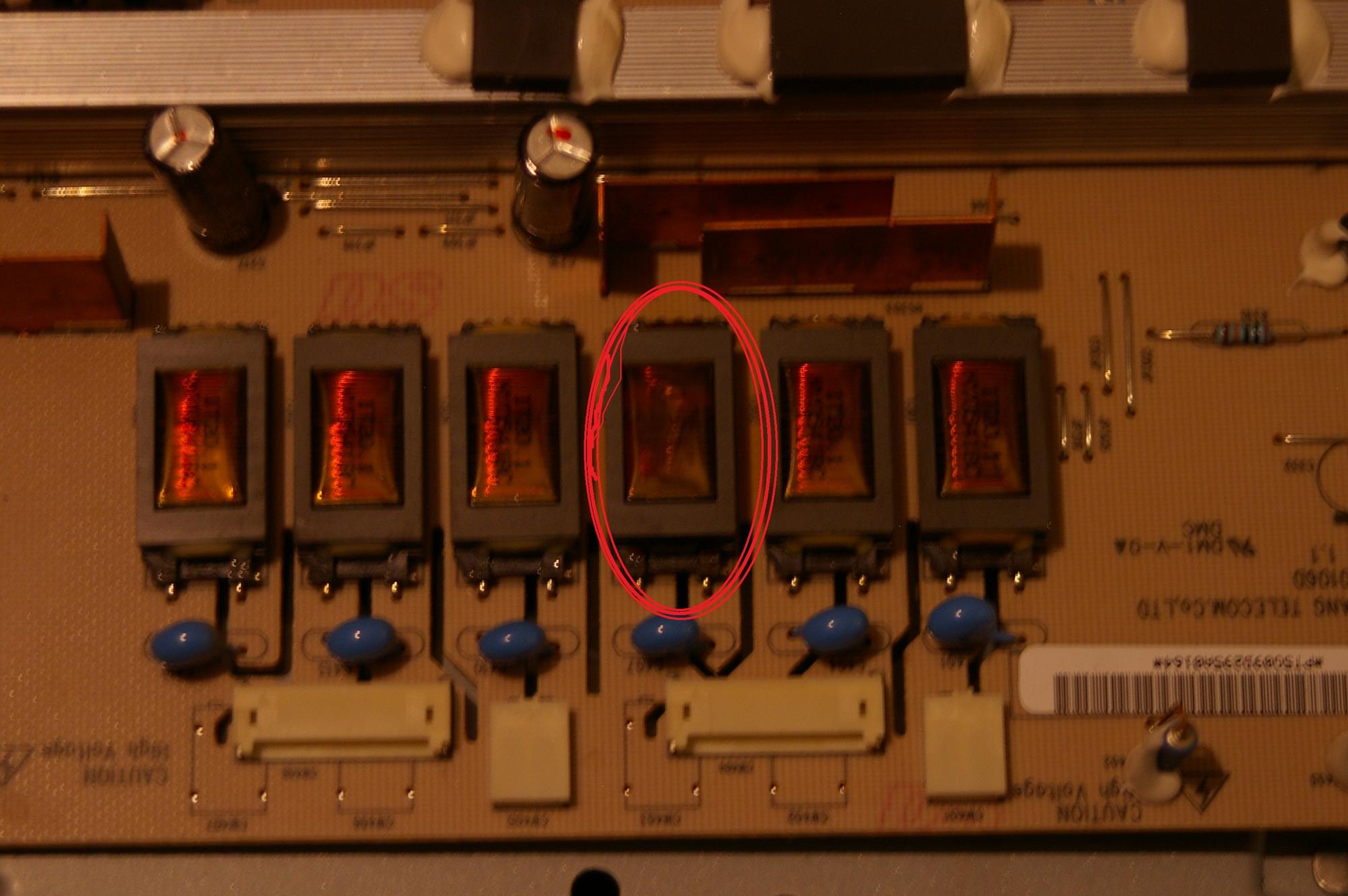

    Hello
    I have a Dell 2005 FPW with solid power lights the Two Seconds to Black'
    I think is the general term,
    I have taken the model apart I can see on the power board there is a thing at T303 is brunt out.
    What is it? Will replaing this thing fix the Two Seconds to Black ?
    I know the caps may need replaceing even tho the caps look good.
    The brunt out part has ( IT20. 1 NY0541BC ) on top of it.
    Broard is a Dell 2005fpw inverter and power board YUYANG YP20106D REV 1.1

    Re: Dell 2005FPW with Two Seconds to Black
    Its difficult to tell from that picture if it is actually burnt out. Do you have a Digital Multimeter to carry out some tests?

      That is a transformer that drives the high voltage for the ccfl's (bulbs). It is one cause of 2 seconds to black along with many others. The following link is a guide to troubleshooting 2 seconds to black written by retiredcaps. Other issue include bad caps, bad ccfl's and / or wiring to the ccfl's, shorted transistors, etc.
      https://www.badcaps.net/forum/showthread.php?t=10419

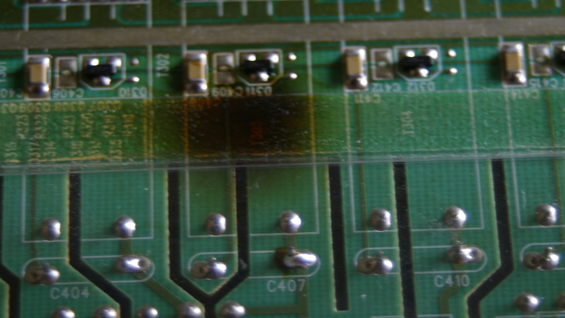

        The Transformer has 2 by 6 pins I can only get readings from the side with 6 pins.
        Doing a reading on all the transformer I get the same readings
        1-2 .6, 1-3 NO reading, 1-4 .8, 1-5 .7, 1-6 NO reading,

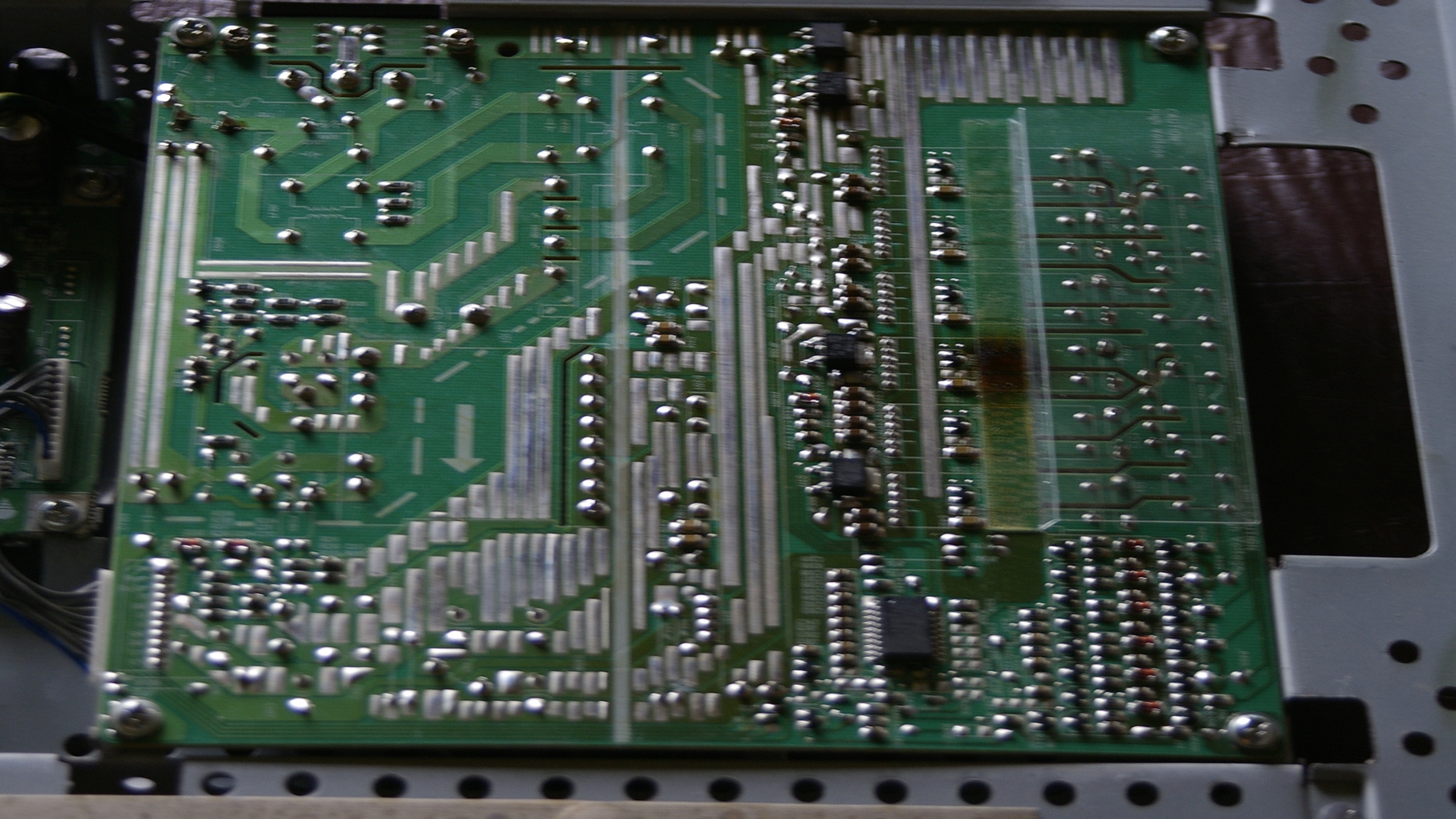

        Looking at the board there is brunt mark under Transformer at T303.
        Looks like 1 is brunt and 2 have had heated up.
        I am haveing problems uploading the pic, will repost later tonight with pic.

            The Transformer T303 is brun out, where can I find a replamet for it?
              If you take out that transfomer where the burnt spot is, you will more likely to see burnt winding on that transformer. You can see that the glue on that transformer had changed color due to the heat.

                3 transformers glue have changed color due to the heat.T301,T302,T303,
                I do not know where to get replacemets transformers from (IT20. 1 NY0541BC) ?
