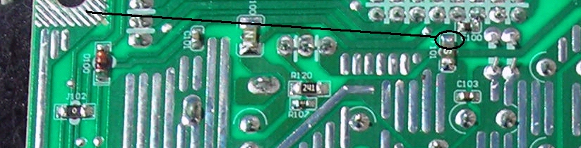

    OK......T3.15A 250CQ.....The AC cable goes right over it and I would never have seen it without the nice bright sun outside and a headband magnifier....Unfortunately I think the board position # is covered with a white gue but there is a T103 nearby ..But that may refer to the next component ....However ? and I hope I am correct here ..there is no way I can actually measure the fuse (s) with a multimeter unless I take the Power Board off ....and I presume that if I take the four screws out ,the board will lift off and disconnect itself from the circuit board ....If I am correct is there anything to be wary of before I do this ....and if there is could I please be advised... I can then do the fuse check etc and post the results ...Thanks

          OK..I could not find anything that resembled a second fuse on the underneath of the power board...I have two identical cheap multimeters and get the reading across the fuse of 02.2 on one and 02.5 on the other..So presume its ok so will move onto the next text..(#3)

            It may or may not be there. Some versions of this Delta board have it.
            You didn't provide photos of the backside so we don't know.
            The reading of 2.2 and 2.5 ohms suggest your fuses are good. However, it likely that your probes are falling apart internally. A good set of probes when shorted together should read less than 0.4 ohms.

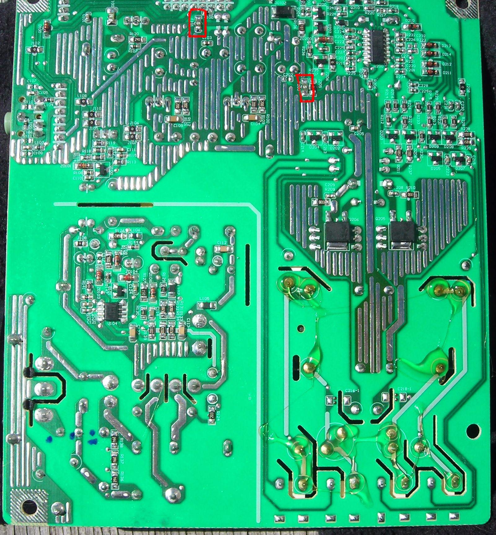

              I actually took a photo and then wondered about attaching it so here it is attached.Each photo I take is coming in at just over 2mb so I resave it in another program and its reduced to round 500 Kb ??

                You have 2 more fuses (F101 and F200) on the backside of the board. They are marked with red spray paint.

                      OK..retiredcaps..so grateful to see marked photo.....F101 shows nothing on both multimeters while F200 shows 0.07 on one and 0.08 on the other multimeter..so that seems to me we have a fuse problem with F101 but whats causing it....?? Ron

                        F101 feed the Logic board, F100 feeds the Inverter circuits, so you may have shorts circuits on the main board. Put meter in Ohm mode, black lead tot eh chassis, red to the top end (this end is connected to the multi-pin connector) of the F101 fuse as shown in your picture, take the reading.

                          OK Sorry I fell Asleep?? As I understand I set my multimeter at 200 Ohm and take a reading ..Now as I see it this will have to be done with the board removed??...I put my red lead to the end of the F101 fuse connected to the multi pin connector ....and the black lead to the chassis which would be ground?? Right.....so I would get the same result putting the black lead to the ground on the board where the screws hold the board in place (as marked on photo attached ) or am i missing something ..Thanks Ron

                              OK..There is no reading ..I put the black lead of my meter set at 200Ohms to the corner of the power board (or is it inverter board) where it would connect to the chassis if it was actually screwed onto the chassis and the red lead I put to the F101 Fuse at the end nearest the 8 pin connector.....Its Dead ..there is no reading from either of my multimeters..Ron

                                OK, that is good, next thing to do is to get 1/4 Watt 1 or 2 Ohms resistor and solder it in place of the blown F101 fuse, you do not even have to remove the fuse, just solder it carefully on to the old fuse and see if it will turn on now. Worst case it just blow the resistor, we are just using resistor as a fuse for now to test.
