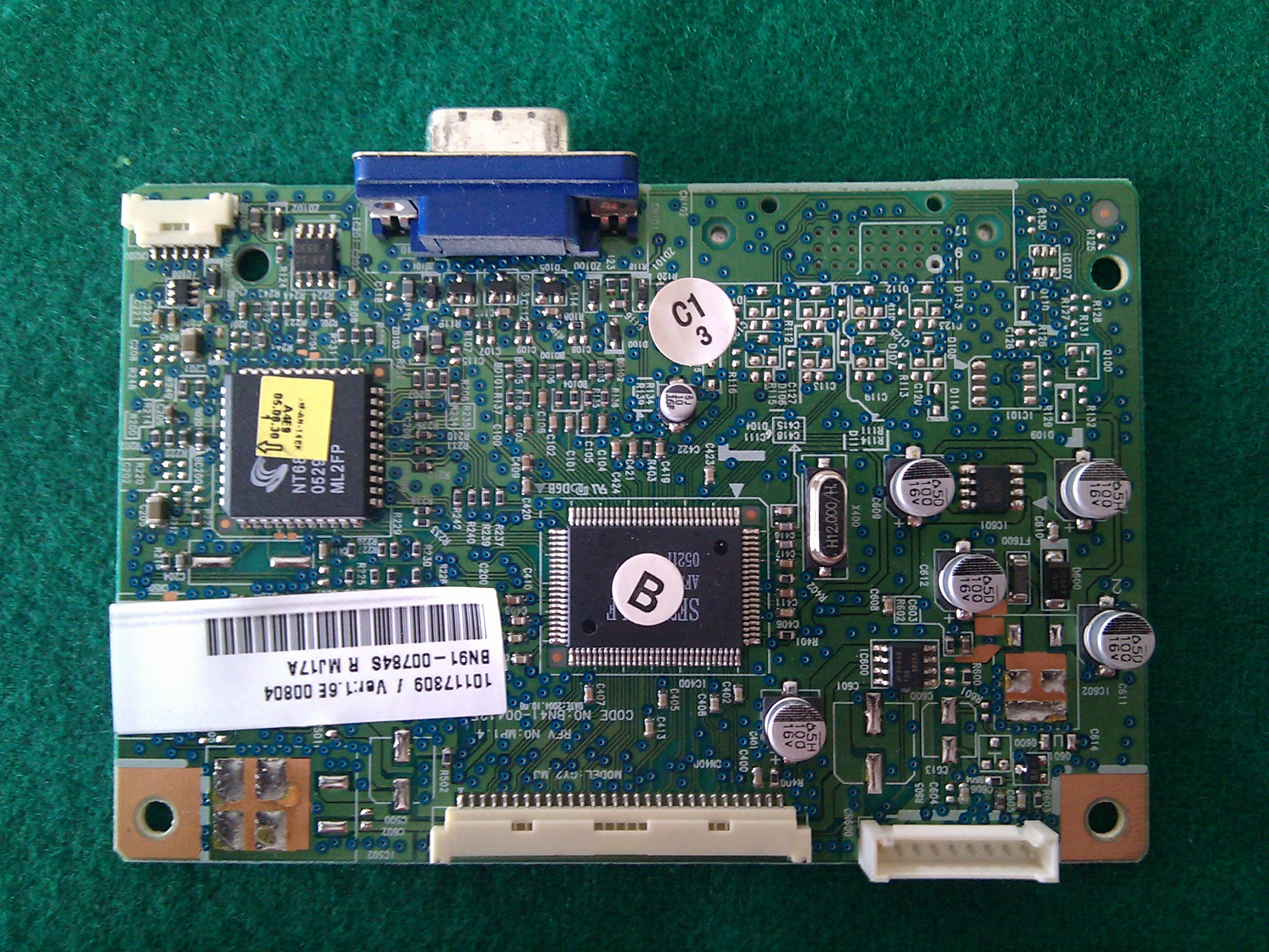

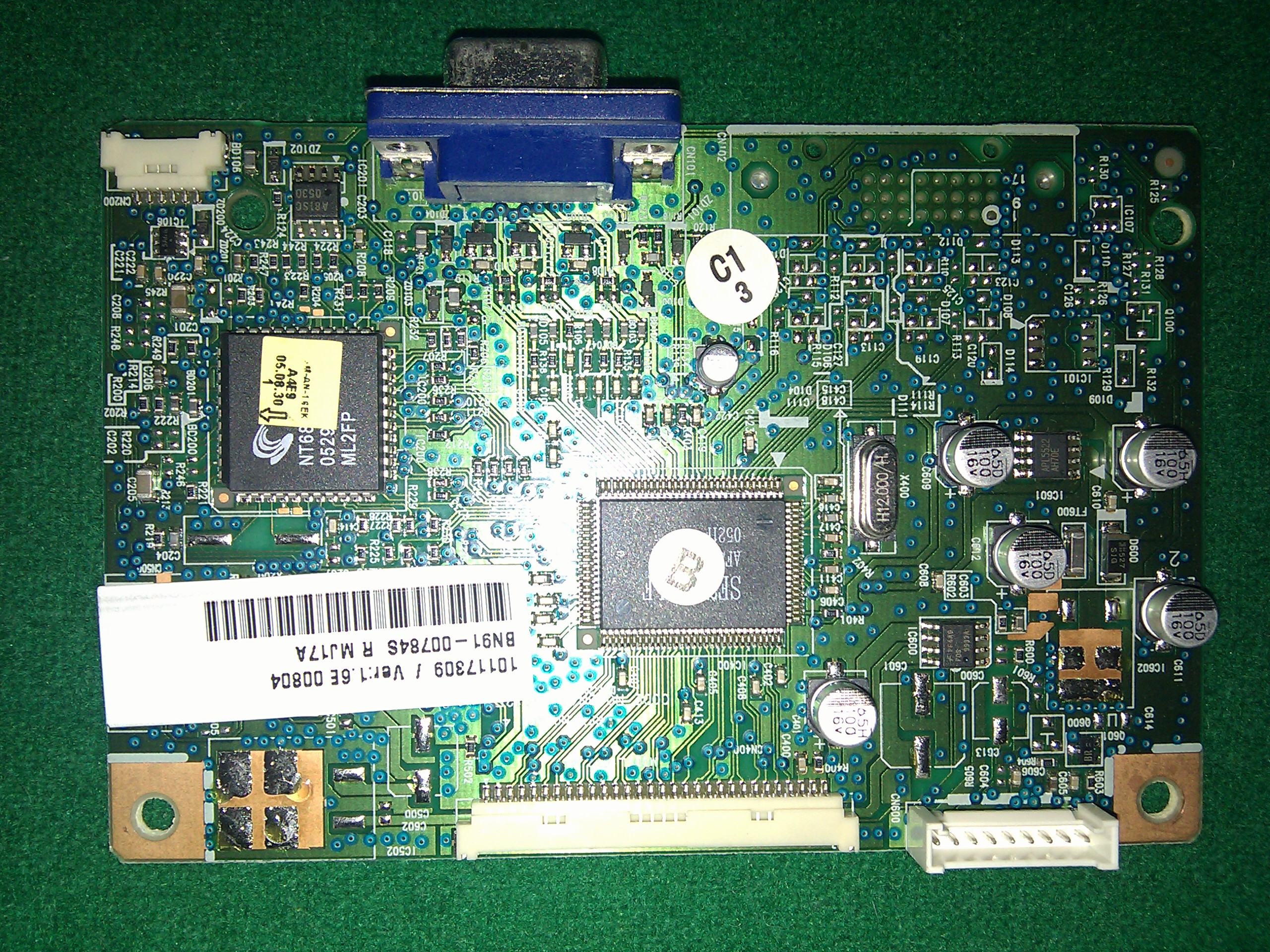

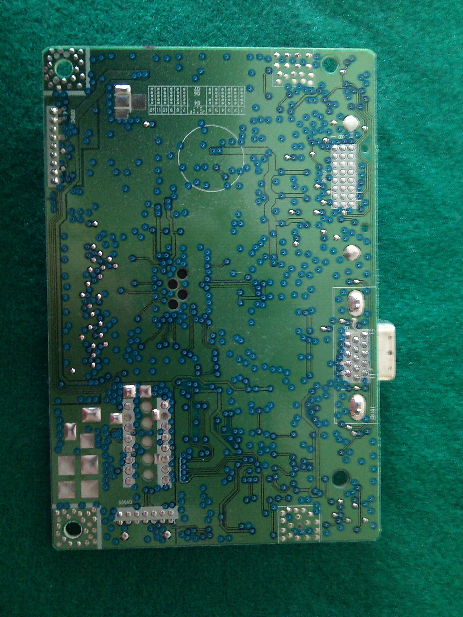

              After about forever, I'm back with the photos of the board
              I didn't take those of the power board because I've swapped it with one that I know for sure it works, and the symptoms persist.
              Thank you for your directions!
                Re: Samsung 710n bad image
                Thats a bit odd id have expected voltage regulators at
                IC 502 and IC 602 was there never anything on those pads, perhaps they have used different type
                what are the part numbers on IC600 and IC501 and IC201 and
                IC 106.
                Check the data sheets and if they are voltage regulators see this on how to test.
                https://www.badcaps.net/forum/showthread.php?p=261329
                  IC106: 5AG4? 5A64?
                  IC201: A81SC-Q530
                  IC600: PF4AG FDS 9933A
                  IC601: APL5522-AH70E
                  No IC501, or at least I couldn't find it. I'll check the manuals.
