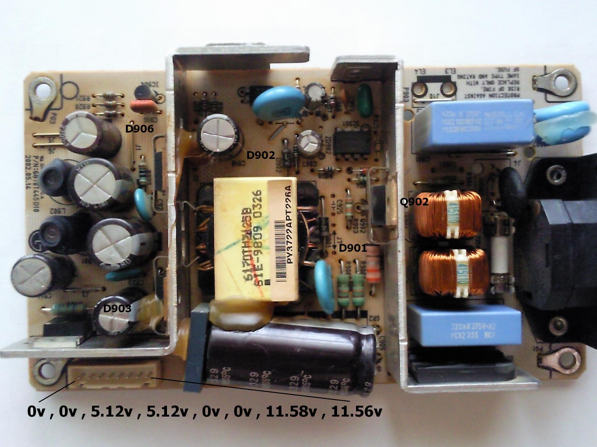

      Re: Dell 1800fp
      I'm not sure this is correct since i was getting wierd readings.
      At first on the ic i was reading .40-.45 between 6 and 7 pin. When i rechecked it after the caps i got 11.45-12.08.
      C924 showed 0v until i switched to 2000m from 20v and then showed 003.
      C907 showed .55 average but jumped to 11.45-12.05.
      All fluctuated or would continually drop when showing the lower numbers other than C924 which stayed the same.

        Okay, we have 3 likely possibilities for your fluctuating voltage.
        1) The startup cap C907 is bad. It doesn't have to bloat in order to be bad.
        2) The SMPS IC is bad.
        3) There is something shorted on the output side to cause the fluctuating voltage. I would suspect one or more of the three diodes on the secondary side. These 3 diodes are mounted on the aluminum heatsink and are likely marked with the letter Dxyz.
        Test each one of these diodes with your multimeter on the diode test function. If the diode looks like this -><-, you should have 4 readings per diode. You don't have to remove the diodes in order to test them. If the readings look suspicious, then you will have to remove them and verify out of circuit.
        Start with #3 first.

          Re: Dell 1800fp
          Lost me. On the heatsinks there is a q902 near the ice chip which i think is a transister. Directly across on the seperate sink is a d906 and d903 with >l< symbal.
          Off the heat sink is a d901 and d902 near the ice chip. Also a d907 just below ic901 in the pic.They have a l< which is what i think the diode funtion on my meter is.
          Do i still test with power? Sorry not sure how to do this.

            Re: Dell 1800fp
            "Q" is a transistor. "D" is a diode. We only want to test the diodes.
            Let's try this. On all the chips that have a "D", follow this procedure.
            1) Set your multimeter on diode test.
            2) Power off the TV and unplug it. Wait 5 minutes.
            3) For a 2 pin diode, put your black probe on one end, red on the other. Record the reading. Now reverse the probes and record the reading.
            4) For a 3 pin diode, number the pins 1, 2, and 3. It doesn't matter which side is 1.
            pin 1 - black probe, pin 2 - red probe
            pin 2 - black probe, pin 1 - red probe
            pin 3 - black probe, pin 2 - red probe
            pin 2 - black probe, pin 3 - red probe

              Re: Dell 1800fp
              D907 = 095
              D901 = 480
              D902 = 507
              D903 looking at bottom non power cord plug side and left to right.
              1-2 = keeps climbing
              2-1 = 180
              3-2 = keeps climbing
              2-3 = 180
              1-3 = 001
              D906
              1-2 = climbs
              2-1 = went from 102-104 after a couple seconds
              3-2 = climbs
              2-3 = started negative then 100 and slowly climbed and steadied at 104
              1-3 = 001

                Re: Dell 1800fp
                Originally posted by junktv
                D907 = 095
                D901 = 480
                D902 = 507
                For the above, you should two readings each. Reverse the probes for the second reading.
                Double, triple check D907.

                  Re: Dell 1800fp
                  Ah sorry. Both the same for D907 and the other read infinite when reversed.

                    Re: Dell 1800fp
                    Desolder D907 and retest out of circuit. If it is the same reading both ways, it is bad.

                        Re: Dell 1800fp
                        If there are any ZD in the same area, they are zener diodes and should be tested as well.
                        ZD901 = 801/infinite
                        ZD902 which some have mentioned would save the IC901 is missing.

                            Re: Dell 1800fp
                            Or do you think my problem is some where else on the PSU?
                            1) Did you change out D907? You said it had the same reading both ways.
                            2) If this monitor has been used 6 years 24/7, then
                            365 x 24 x 6 = 52560 hours.
                            Your ccfls are likely near end of life. From my research, they last anywhere from 40k to 60k. If this were my monitor, I would just replace the diode, and retest. If it works fine, leave the caps in and use the monitor until the ccfls start to die.

                              Re: Dell 1800fp
                              Ah i forgot to do that. I'll get to it here in a few and report back.
                              True but i am hoping it works alot longer and only $10-15 in parts w/ shipping.
                              Good clear monitor and can run dual pc's.
                              EDIT: D907 is 638 and infinite.

                                Re: Dell 1800fp
                                D907 is good with those readings out of circuit.
                                I would change C907 first then. If the voltage still fluctuates, then your SMPS IC might be bad.
