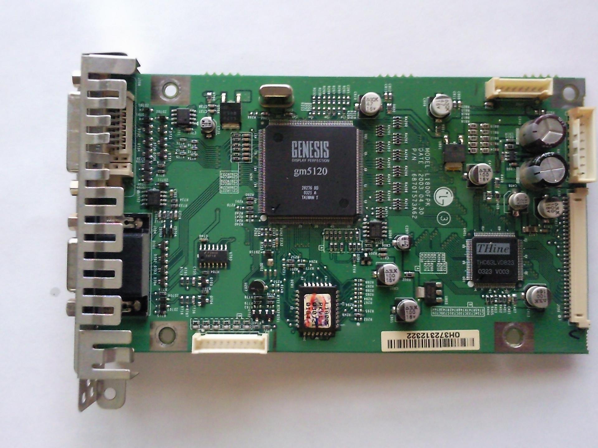

    Hey guys, i'm in need of your assistance again. My old dependable 1800fp quit on me after 6+ years of 24/7 service. I turned the power on and nothing.
    The LED was dim and flashing but got brighter after a couple of minutes. The power button has no effect. I can here a faint clicking from the psu or under it.
    I read some of the other threads and did some checks listed in them and here is my findings.
    1. Visually everything looks good but dirty.
    2. No resistance between 6-7 pin on psu ICE chip. I have checked while powered on. will have to find that thread again.
    3. Pin out voltages on psu are 0v ,0v ,5.12v ,5.12v ,0v ,0v ,11.58v ,11.56v. The 5 and 12 volt fluctuate about .05v. Is the 12v to low?
    4. I did notice a couple dry joints on the transformer so sucked and resoldered those.
    Any other ideas?

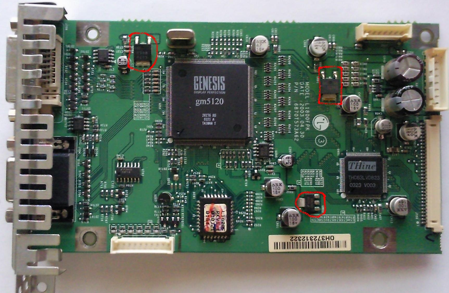

      Re: Dell 1800fp
      Here is now my almost daily response on how to measure a voltage regulator thread. I will write it generically so I can bookmark it.
      1) Circled in red are voltage regulators. Measure all 3 pins (ignore the fat tab). List the part number for each regulator. If the middle pin is "cut", you can still measure it and report the reading.
      2) Report it like this ...
      U1
      AL1117-33
      pin 1 = 0.0V DC
      pin 2 = 3.29V DC
      pin 3 = 5.01V DC
      3) The suffix in the part number, if present, tells you the output voltage. In the above example, -33 means the expected output voltage should be 3.3V +/- 1%.

                Re: Dell 1800fp
                U1
                AL1117-33
                pin 1 = 0.0V DC
                pin 2 = 3.29V DC
                pin 3 = 5.01V DC
                None of these are labeled like that so I just labeled a pic with the placement ,part number and voltages i got. I hope easy to make out.
                I'm using a cheap DMT7 digital meter. I may be able to borrow a fluke or craftsman this weekend.

                              Re: Dell 1800fp
                              From what I can see, it looks like the power supply is outputting the required 5V and 12V. Even with the .05V fluctuation, I don't think that's enough to prevent your monitor from turning on. Moving on, it appears the problem is on the logic board. Looking at post #12 in the thread below could be the cause of your problem.
                              https://www.badcaps.net/forum/showth...ghlight=1800fp
                              If those two caps don't solve your problem, this logic board is also known to get a corrupted eeprom (the chip with the red marking on your photo). If this is chip bad, then you'll have to replace the entire logic board.
                                Re: Dell 1800fp
                                On page 3 of that thread someone mentioned good voltage but low amps from the power supply. I figured i'd try that first so i made a harness to test with a computer psu and it worked.
                                So my problem is definitely in the power supply after all. :relief:
