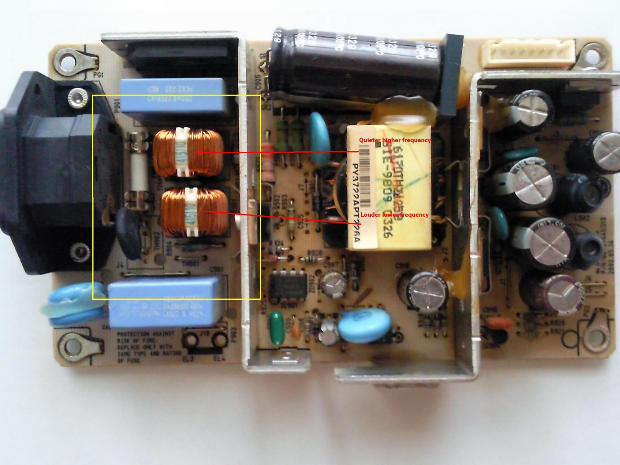

        One thing i noticed today is a really quiet buzz. With a stethoscope i tracked it down to these coils. Sorry i'm not sure what they are called.

                  #48
                  Re: Dell 1800fp
                  The DCV output is steady or not?
                  https://www.badcaps.net/forum/attach...7&d=1338497270
                  You should check or replace those two startup/running caps next to the SMPS IC.
                  The rectifier in the cold side is OK?

                      • Relayer
                        • Nov 2017
                        • 35
                        • Earth
                        #51
                        Re: Dell 1800fp
                        Hello junktv,
                        Could you please check any high value resistors around or near IC901?
                        You need to lift one leg to obtain an accurate reading. High value will mean anything at or above 100kΩ.
                        Please see picture below:
                        As shown in the green shaded area is where you need to look for any high value resistors.
                        Also, the boxes shown on your power out connector, I assume that the twin pins are physically tied together? The 4 ground pins as well?
                        Please see next picture:
                        It would be good if you could obtain a couple of automotive incandescent light globes to use as a dummy load on the PSU to determine if the 12 volt rail remains steady. You may need to leave it like that for a while to see if there is any fluctuation. Therefore you'll need your multi-meter to be connected during the test.
                        Both globes can be 12V types, but make sure they can at least handle 30 Watts or more, but not too much more. Say 30W to 50W would be fine.
                        One more thing, polarity on the globes doesn't matter, but make sure that when you attach the wires to the PSU that you connect them on the solder side and not to the connector pins on the component side.
                        By the way, I assume you've already replaced the capacitor as indicated by the green arrow?
                        Please let us know how you get on.
