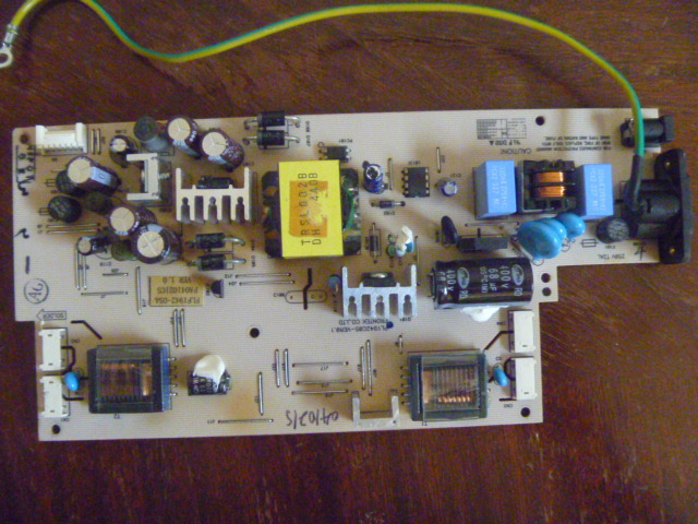

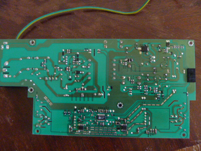

    I my firend just give me Elo ET1925L-7UWA-1 19" LCD Touch Screen Monitor is not turn on find out the Inverter Power board PL1942C05-V1 ELO is not get 5 VDC & 12VDC replace all the Capacitors but still same problem, check diode is ok
    If some one work on Inverter Power board PL1942C05-V1 ELO please let me know

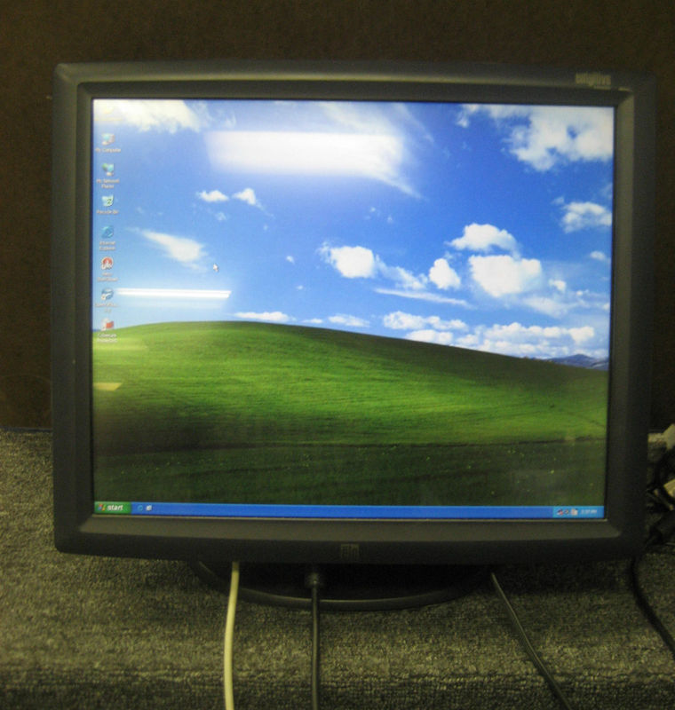

    The first picture shows the monitor on? Does it come on and then go off?
    • hoadle
      • Jul 2010
      • 174
      Re: Elo 19" LCD Touch Screen Monitor
      Is just the another good Elo ET1925L-7UWA-1 19" LCD Touch Screen Monitor I take picture for sample the Elo ET1925L-7UWA-1 19" LCD Touch Screen Monitor I had
      The Elo ET1925L-7UWA-1 19" LCD Touch Screen Monitor i had do not turn on at all check the volt at CN101 top to bottom is
      1/ adj
      2/ on/off
      3 & 4/ ground
      5 & 6/ 5VDC
      7/ 12VDC
      When I check the volt at 5 & 6 & 7 the volt go up down from .5vdc to 1.5vdc look like some thing short to ground
      If some one had diagram on the Inverter Power board PL1942C05-V1 ELO just post the link i will check is out
