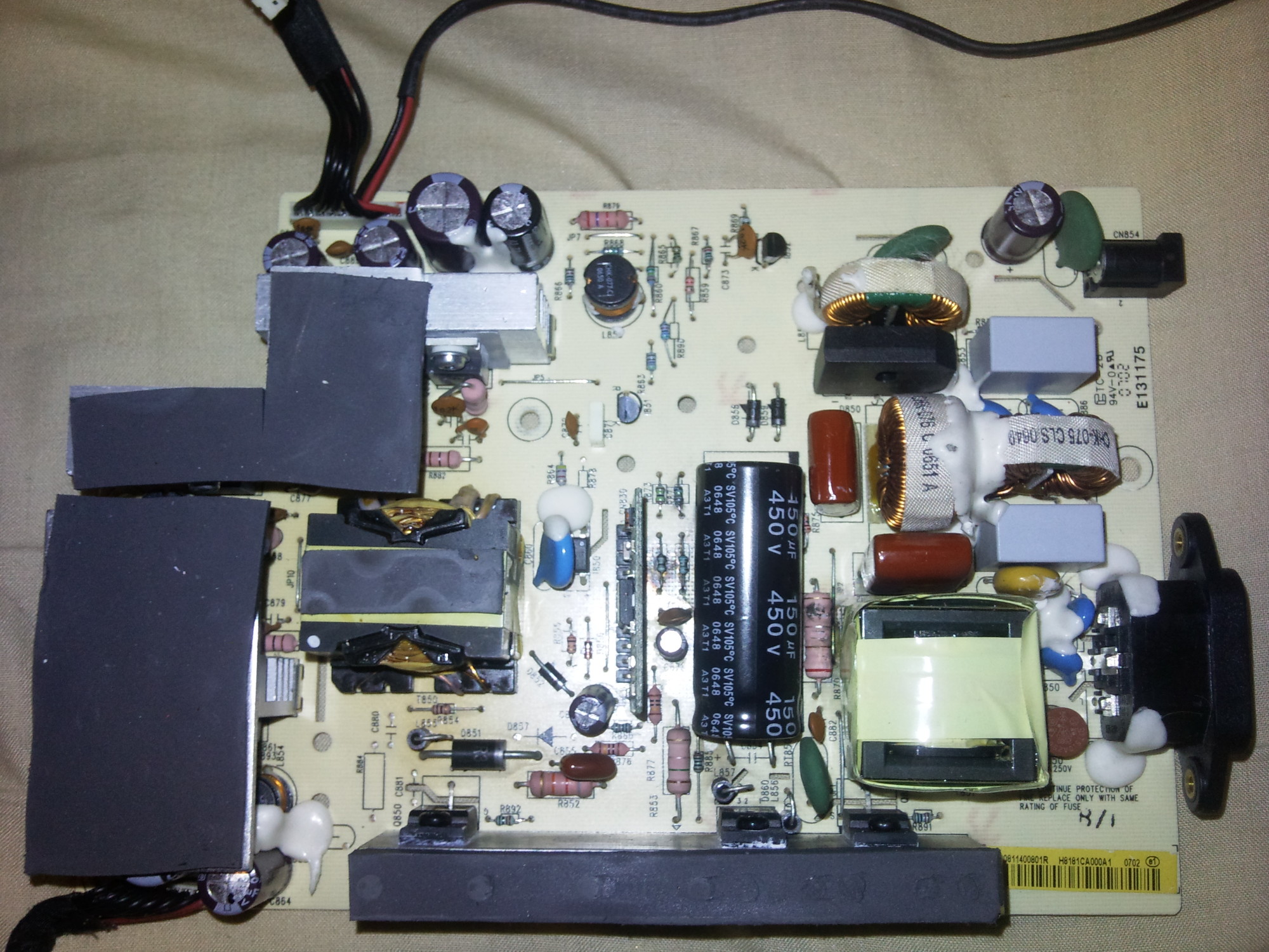

    Hi, I have got a gateway LP2407 monitor and the power supply board is burnt and dead.
    Are there any alternative power boards that will work in a gateway 24 inch monitor LP2407.

      I have got 1 or so bulged caps. I'll replace them but there is burn marks on the power board itself. Burn Marks are circled in red. Although there is no power to the monitor. Please help.
        Re: Gateway LP2407 Power Board.
        1) Use some isopropyl alcohol to clean off all those smoke/carbon stuff. Sometimes the damage looks worse than it really is.
        2) After you clean it, upload another photo of the board.

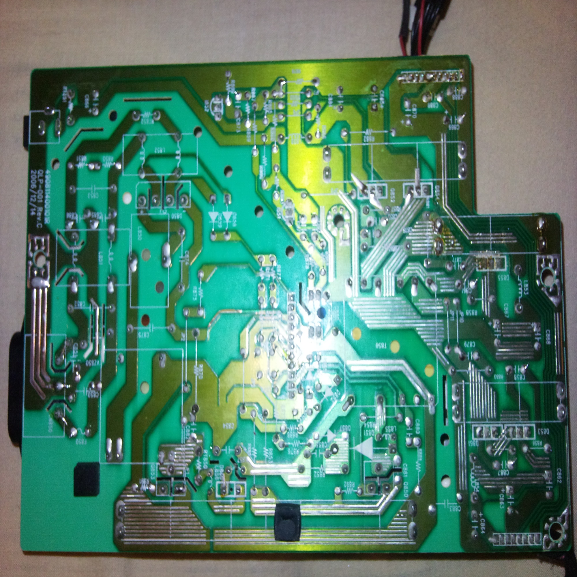

        3) Clean the backside too and after cleaning it, upload a picture as well.
        4) Do you have a multimeter? Are you experienced at using it?
        5) What is the history of this monitor? Power surge? Liquid spill?
          Yes, I do have some experience using a multimeter. I don't know the history of the monitor. I bought the monitor off someone who says it may work or be sold as parts. I guess they used it for some time and the power board started to burn out and stop working. I'll upload the pic a bit later.
          Is the board still repairable?? By the looks of it, the power transformer and some resistors are burnt out.
          If not what other alternative or similar power board that will work for a Gateway LP2407 monitor. I am in UK. Trying to find a power board for it...very rare to find one.

            The board could still be repairable. The burnt resistor is nothing to worry about - it can ceasily be replaced. The burn mark on the board is strange - there is no obvious cause. A picture of the back side of the power supply would be a big help in making an intelligent decision. After all, what do you have to lose?

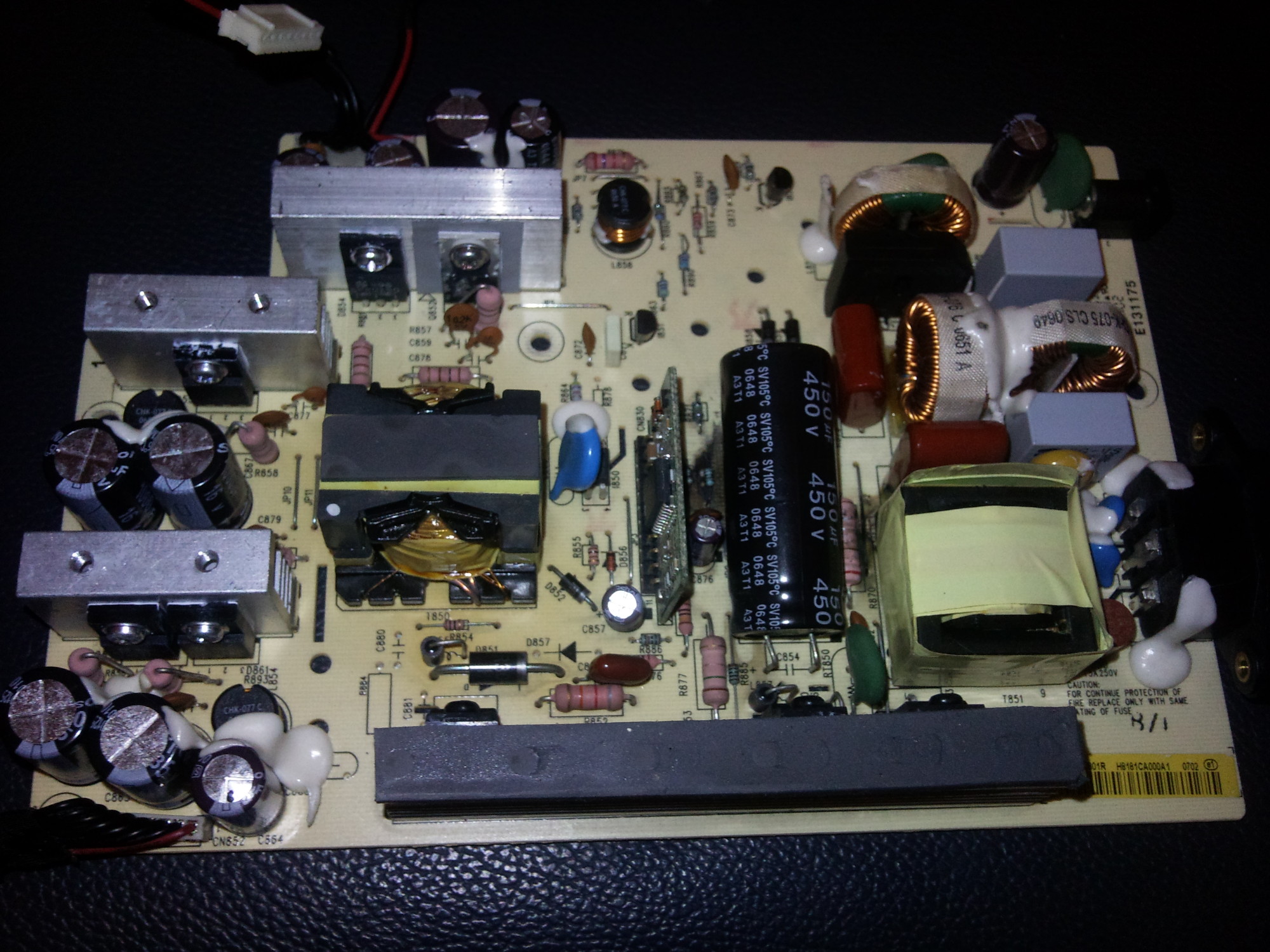

                I bent the cap straight to show you the burn mark damage on the board. The cap is the right value. I'm guessing its the transformer that looks burnt. I couldn't clean the burn marks off. I tried using Isopropyl alcohol to clean it. Only managed to clean off a bit. Still showing shiny burn mark on board.
                I used my samsung phone to take pics.

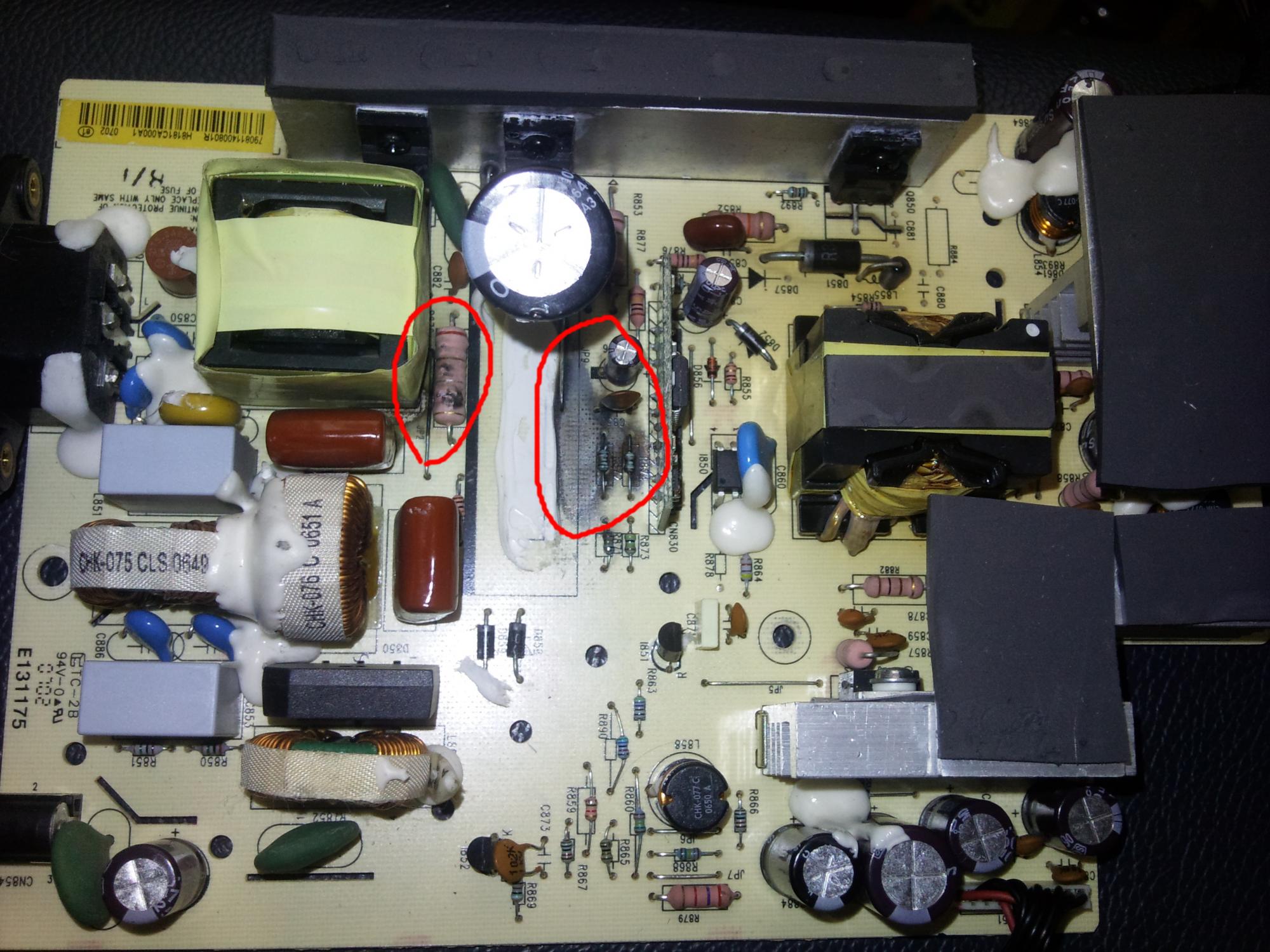

                  Well if you have a mulitmeter, you can test the following:
                  1) fuse (red). A good fuse should measure less than 1.0 ohms.
                  2) resistors (yellow) that were "burned". Read the color code and see if the resistor reading matches.
                  3) bridge rectifier (green) - see if it is shorted.
                  4) power mosfet (orange) - see if it is shorted.
                  5) I see one bad cap at C854. Was this replaced? There may be others that are bad underneath all that black plastic?
                    The resistors (yellow) does not show any value. The outside resistors on the board are working. I don't know how to test blue ones with color code.
                    I don't know what the resistor value for the pink resistor circled in yellow. looks toasted really. can't tell what color band it is.
                    The bridge rectifier is showing 0.10 - 0.12 on 20v DC test.
                    The power mosfet also doesn't show value.
                    Yes, I need to replace that C854 Cap.
                    The fuse is showing 0.89 - 0.90 amps
                    I have removed the black plastic with metal plates on top covering the rest of the board.
                      Color code chart at
                      http://en.wikipedia.org/wiki/Electro...de#Color_bands
                      1) Test the bridge rectifier by numbering the pins 1,2,3, and 4. Measure the resistance between pins 1-2, 1-3, 1-4, 2-3, 2-4, and 3-4. Any reading under 30 ohms suggests a short and the component should be desoldered and retest out of circuit.
                      2) Test the power mosfet by numbering the pins 1,2, and 3. Measure the resistance between pins 1-2, 1-3, and 2-3.
                      3) A good fuse should measure less than 1.0ohms.
                        The power mosfet is getting about 8.30 ohms on each pin resistance.
                        The Fuse,I cannot test the fuse in ohms. not showing value.
                        The brodge rectfier is showing with diode test
                        pins 1-4 =1595
                        pins 2-4 = 717
                        pins 3-4 = 713
                        pins 2-3 = no value
                        looks like somehow, just not powering the whole board.
                        Those blue resistor are working too.
                          It is 8.30 ohms, it needs to be desoldered and verified out of circuit.
                          Sigh, a multimeter always gives a reading. If it shows "1" on the left hand side, it is telling you that the fuse is measuring out of range or infinity for your chosen ohm setting. So if you have it on 200 ohms, the fuse is reading greater than 200 ohms -> bad.
                          pins 1-4 =1595
                          pins 2-4 = 717
                          pins 3-4 = 713
                          pins 2-3 = no value
                          Again, "no value" means out of range.
                          --- begin sig file ---
                          --- end sig file ---
                            The fuse is bad. measurung over 200 ohms, about 391 - 600 ohms. I tried 200ohms but out of range.
                            The bridge rectifier pins 2-3 has no reading at all. just the other pins that works.
                            would this mean I have to replace every component that is shorted and burnt out.
                            The 2 burnt resistors, I don't know the color of them as they just look burnt.
