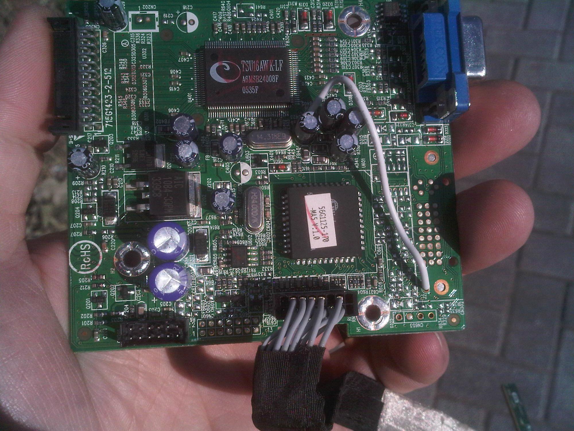

    i have this 17inch old monitor which doesnt even light the led. i inspected the circuit, no blown fuses, the caps seem good. i get 11V and 3V from the main rails of the circuit. is this normal?

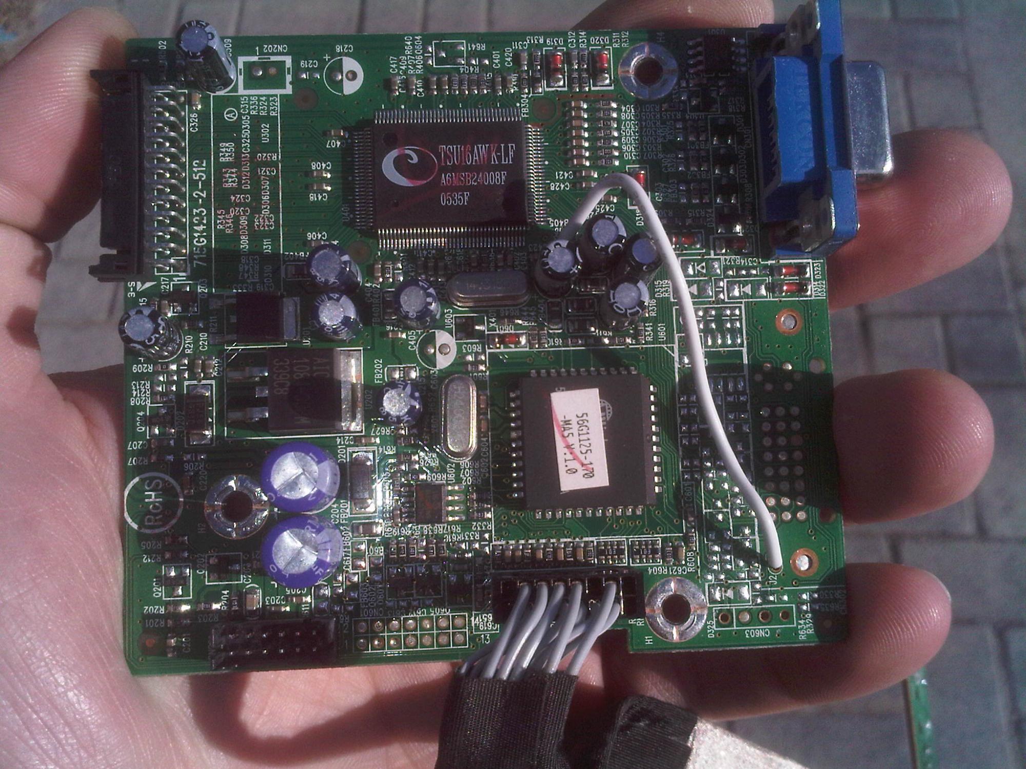

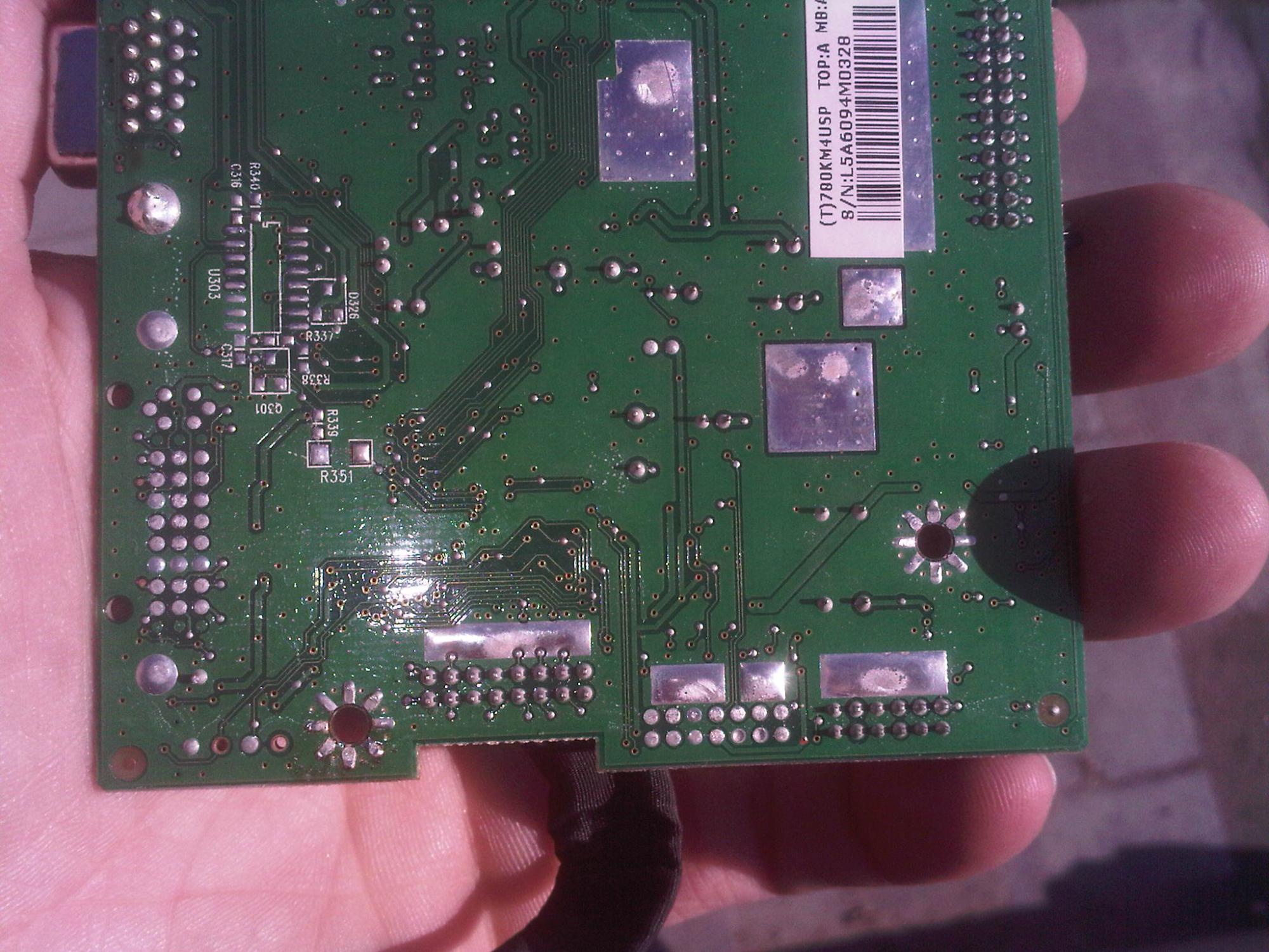

              now i am suspecting it not a a power supply problem. i am gonna show some pics of the logic board.

                  Re: Asus MM17D no power
                  some pics.

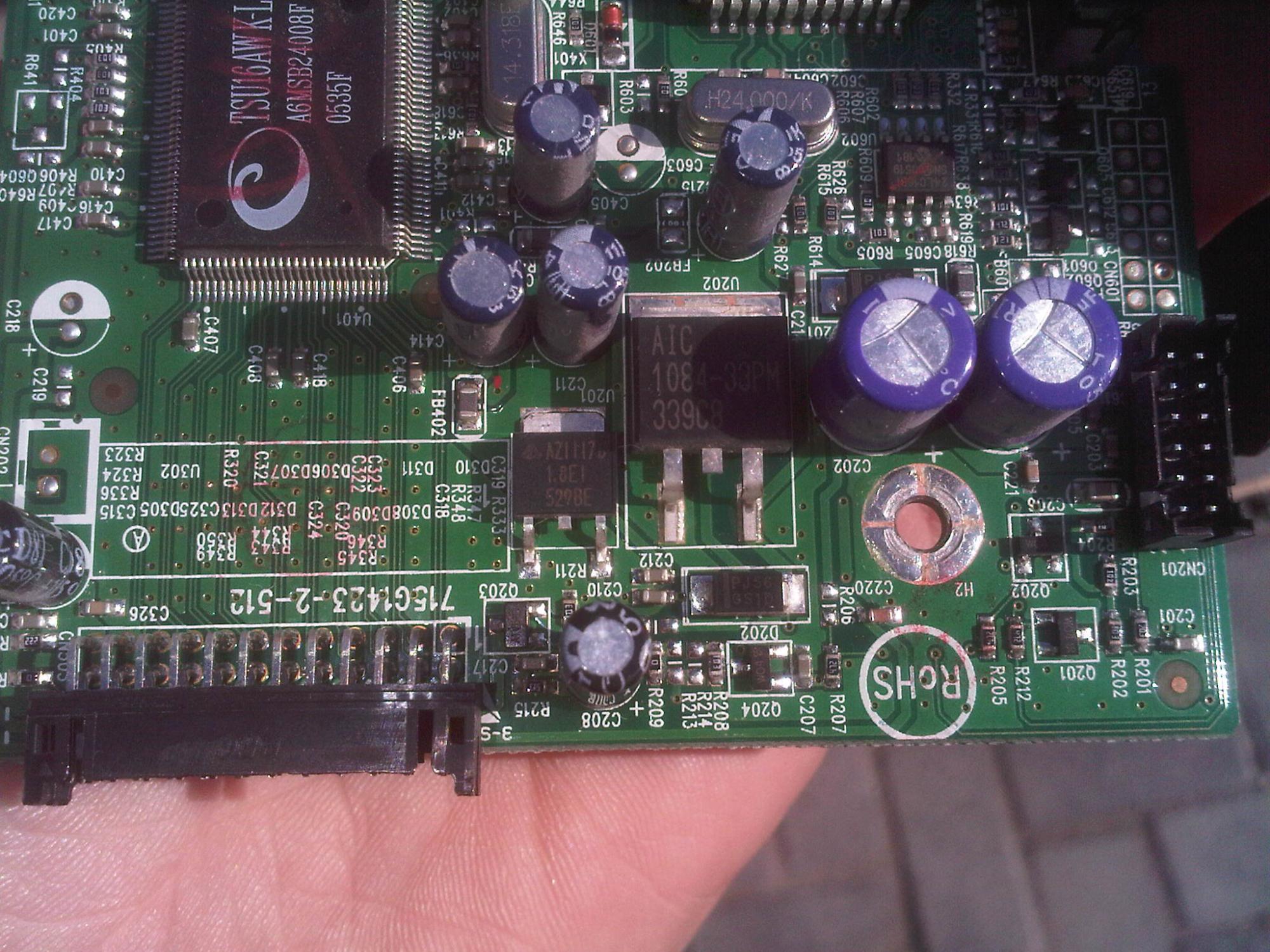

                          Suggest you start by measuring the output of the voltage regulator U202, It's marked AIC 1084-33 and should have an input of 5v and an output of 3.3V. I'm not sure what U201 is, but it wouldn't hurt to also measure it's voltages.
                            U201 is a 1.8V regulator. The part number is AZ1117-1.8E1
                              confirmed, U201 input 4,05V, output 1,77V.
                              U202 input 4,7V output 3,22V.
                              i repeat, this monitor doesnt give signs of life.

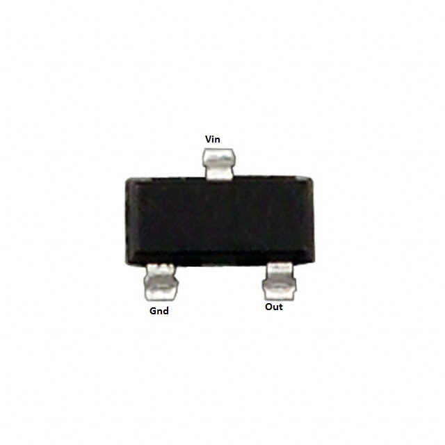

                                    Not exactly. It's between the two crystals, but it's a reset controller. With power applied, what is the voltage on each pin?

                                      Its a MAX810 Datasheet attached

                                        Thanks for confirming it. I drew a blank on that one. Probably too early in the day.
                                        Senndogg, I've attached the pinout of U603. What is the voltage on the output, using the Gnd pin for the black lead?
