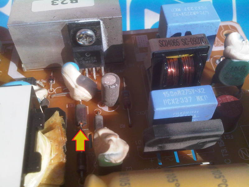

          • dpauto47
            • Dec 2008
            • 5
            Re: Samsung 2233SN panel problem
            Also if you look at the diode on circuit # BD1 it looks like it is burnt out on the anode side of it. shown in pic image # 10
              thank you dpauto47 but it doesnt seem like a diode to me. it has the resistor logo from the other side of the board and it measures approx 0 ohms.

                just to clarify what dpauto47 was talking about..

                  that component DB1, which TBH i dont know what is it, i desoldered one leg , and measured with the diode tester, beeped at both ways, and had a resistance of 0 ohms. it has a resistor symbol in fact.
                  • trebo
                    • 514
                    • Wales, UK
                    surely something wrong with it
                    looks like a diode
                    was wondering if it may be a ferrite bead???

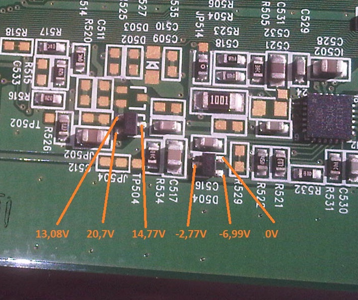

                      Could be (and most likely is).
                      If there was problem with something on the primary of the PSU, the PSU (and thus the monitor) wouldn't have worked at all in the first place. So the problem most likely is either on the video/logic board or the t-con board.
                      I find the t-con easier to check, so let's start with that...
                      Using this picture as a reference
                      http://img249.*************/img249/6...1201031326.jpg
                      measure the voltage between the cathode side of D501 (the side with the white stripe) and ground. Place the negative probe of your multimeter on ground. A good ground point to use is usually the bare traces where the screw holes for the t-con are. Let me know what voltage you get. Ideally, it should be anywhere between 9 and 20V (depending on the t-con design).
                      Also, using this picture as a reference,
                      http://img821.*************/img821/3...1201031326.jpg
                      check the part number on IC502 and post it here (IC502 is the small black chip to the left of the round inductor).
                            the cathode side of the D501 and a good ground showed 13.08V
                            the IC502: AAT117
                            AOT256
                            0927
                              master hoarder
                              • May 2008
                              • 12175
                              • Bulgaria
                              Looks good.
                              Next, measure the voltage at every pin of D502 and D504 with respect to ground.
                              the IC502: AAT117 AOT256 0927
                              Can't find a data sheet for it, unfortunately. It's not that important, though.
                                i think i screwed up sth. i just broke the connector of the t-con (( i think i cant resolder it cos the pins are broken
                                anyway here are the voltages
                                  Oops.
                                  Keep it for spare parts. If you ever get a monitor with a white screen problem, you can use this one for parts. Or if you find a broken screen with a good LVDS connector, you may be able to put that one on this monitor.
                                  These voltages look good too.
                                  There's a variable resistor on the board (to the left of IC502 in this picture). I'm not entirely sure what it does, but one of my guesses is it could be for the gamma adjustment.
                                  If you get the LVDS connector fixed, it may be worth to try and mess with this varistor to see what it does.
