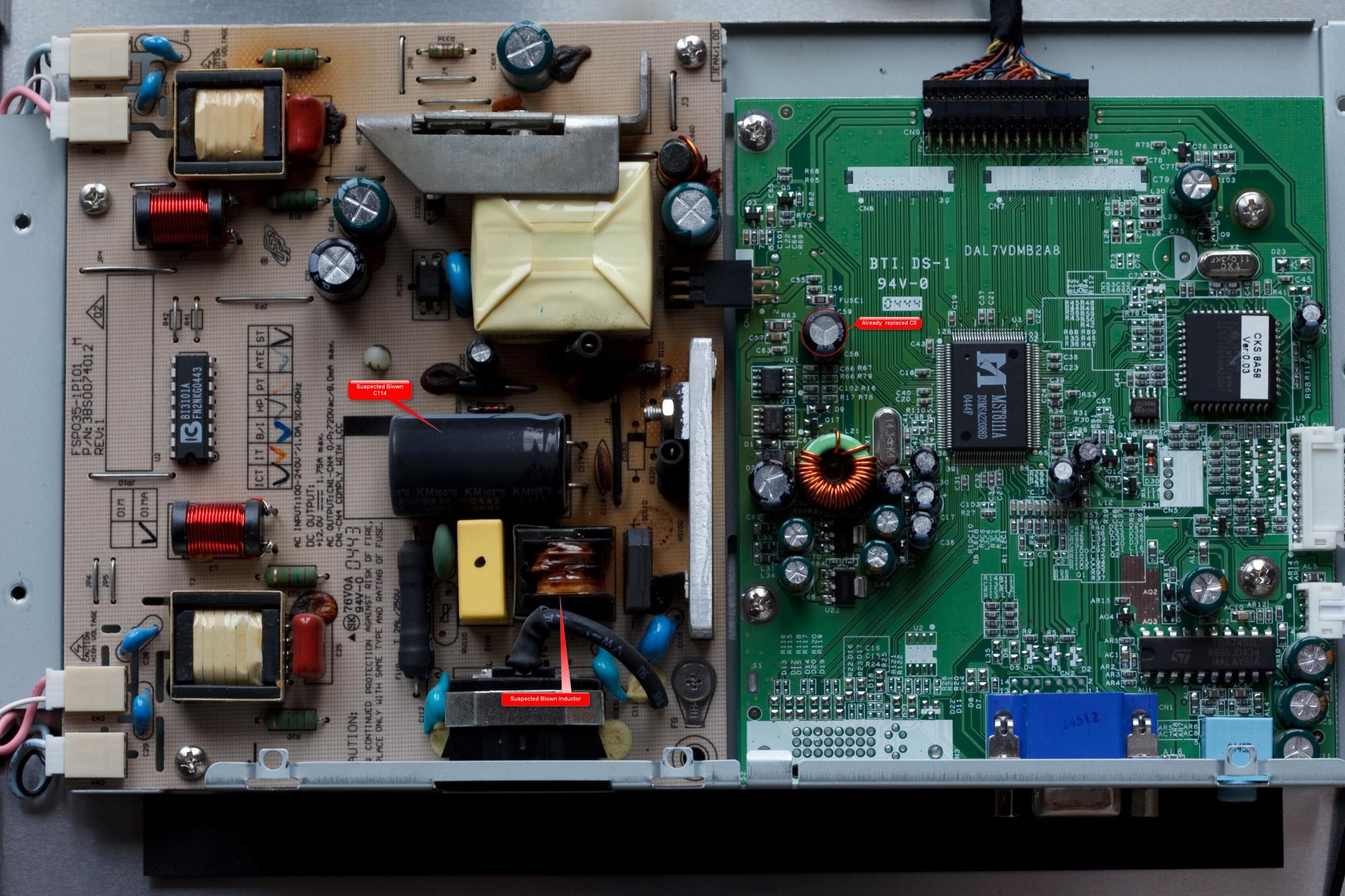

    I'm trying to repair a Belinea 101902 Monitor (Art#111916) and would like to ask the forums advice before I send off for the spare parts I think I need, or whether the monitor is perhaps beyond repair.
    When it is turned on, the power button is green for approx. 5 seconds and then it appears to restart, i.e. turn off briefly and then back on, and then repeats. When I had a laptop hooked up I saw a very brief, and faint, overlay which I believe was the "No Signal" because I perhaps didn't have the dual-screen mode in Ubuntu on correctly.

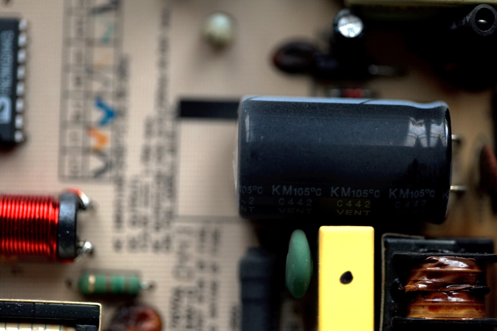

    When I opened the back I saw one cap on the display board was definitely blown (C58, 16v/330uF) and I suspected the large cap on the power board was also blown (C114 400v/100uF). After reading some of the posts in this forum saying that the large caps rarely blow I decided to replace the c58 - largely because I had a spare laying around - however the problem still persists and so I will order a replacement fot the C114. Looking closer. I think there is electrolyte at the base of one of the pins, so I am pretty sure it's blown.

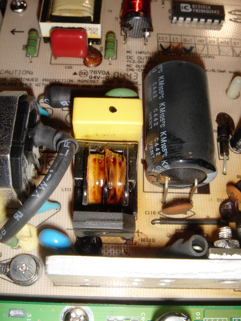

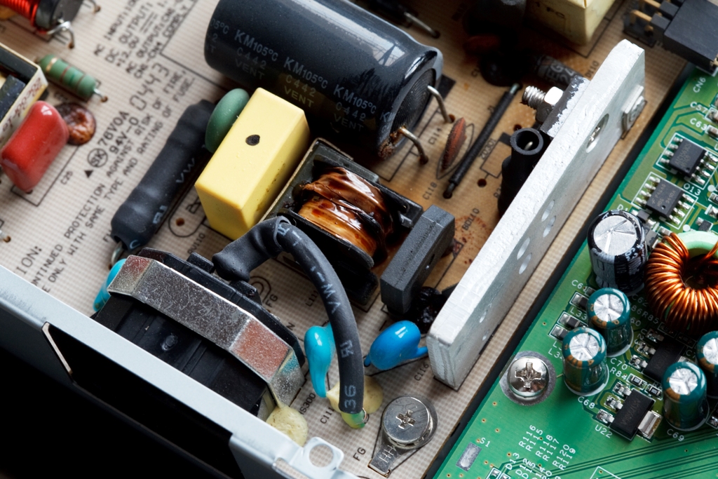

    My concern is that the inductor (?) next to the C114 capacitor (L111) seems to also be damaged. The photos attached should give a reasonable view of it.
    I've only dabbled in electronics and I am not too sure how to go about taking measurements on the live circuit to determine if this component is damaged or not. If anyone could give me a hint where to start I would be most grateful.
    And if anyone could glance over the circuit photo and suggest other components that may need replacing before I send off my order that would also be really appreciated.

    Yeah, the large capacitor definitely needs to be replaced but that's not a fix, you need to fix what caused the large cap to go bad.
    I would also be concerned about that glue they used that turned black - it may become conductive when it warms up, which may explains the resets.
    I see what looks like glue right under the bridge rectifier (the thin rectangle between the inductor and heatsink - could try to test if the rectifier still works by measuring the dc voltage it outputs.... it should be the same as probing the two leads of the large capacitor.
    I see more of that stuff on the small ceramic capacitor and a bit above that, where it's a diode or something... I'd clean it up and rub the terminals with isopropyl alcohol or something just to make sure they're not shorted.
    The inductor doesn't look that bad to me... looks more like overheated plastic. But it could be bad.

      With the big cap, I count 6 electrolytic caps in total on the power board. I would recommend replacing all 6 since they have in service for nearly 7 years.
      Your power board has signs of running really temperature hot from all the white glue turned brown and pcb discoloration so it wouldn't suprise me if some of the caps on the power board are dry, but not bloated. Remove all the brown glue as mariushm suggests.

        The inductor (L111) looks bad in the first picture, but in the last picture it appears to be varnish.

          The primary cap (the biggest one) is definitely bad. Bulging at the top and bottom, and electrolyte has been leaking out on one of the legs (last pic).
          Like retiredcaps said, I'd replace all the caps in there, seeing how hot it runs/ran.
