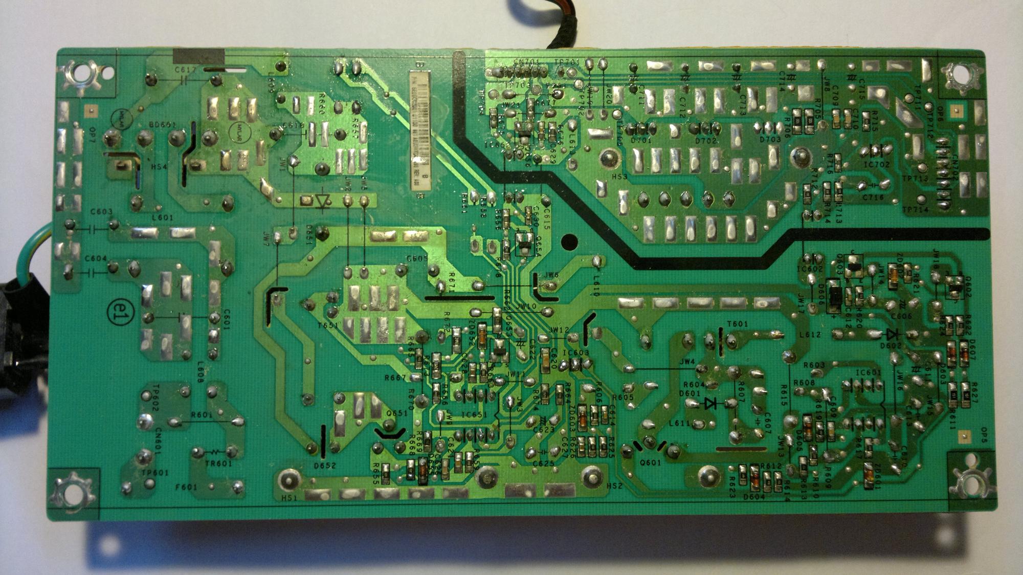

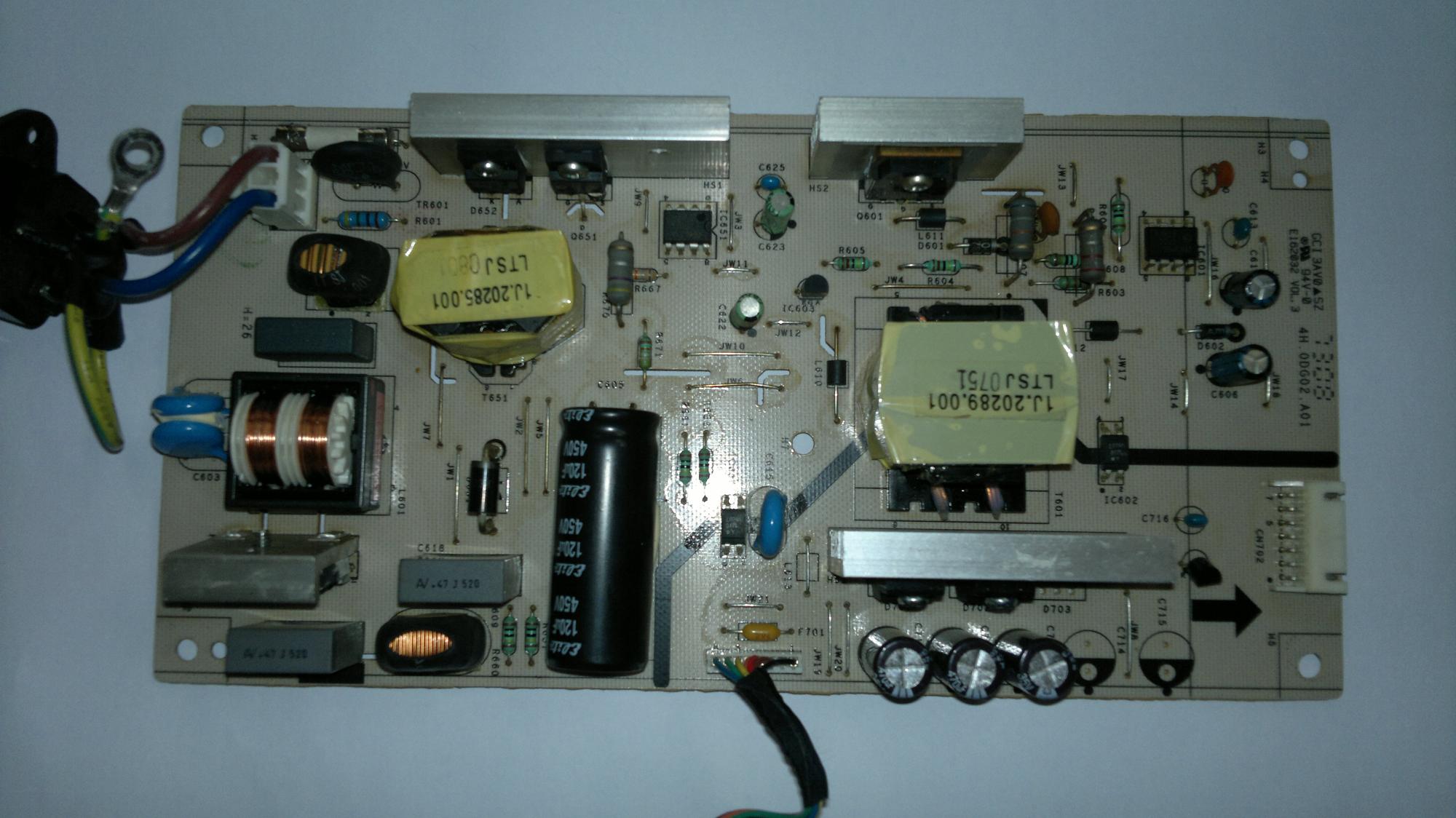

    Best bet would be to take it apart and post some good focused photos of the power and signal boards.
      Re: Dell E248WFP power cycling off/on
      The fault is on the main Power board - with the other boards disconnected it still faults.
      Voltage across main cap (C605) is 330VDC STBY/402V RUN.
      Primary DC output to other boards is 18.9V STBY/RUN.
      Once the fault kicks in both the above voltages fluctuate on STBY and RUN.
      Power board is marked 4H.0DG02.A01

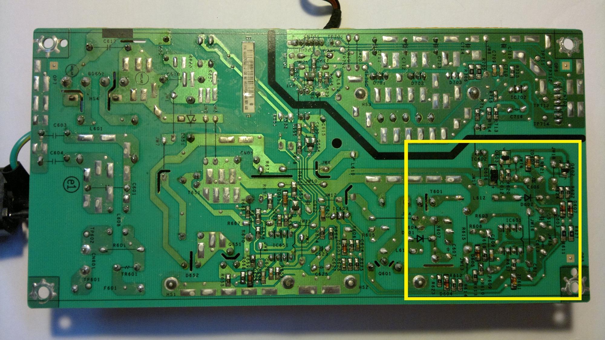

        This is a slightly unusual power supply. It has a single output; switching to Run mode apparently only turns on the PFC front end. What is interesting is that when the fault occurs both PFC 'boost' and output voltage fluctuate.
        There are a number of possible ways to troubleshoot this. I'd suggest disabling the STBY/RUN input (as shown in the bottom picture, second pin from the right on CN701). The supply should still work at full load.
        Another option would be a complete recap, certainly this has the earmarks of a defective cap destabilizing the circuitry. Before that, I would suggest checking carefully for bad solder joints.

                      It's been nigh impossible testing this board due to it's design and the fault and it's really had me stumped. I've spent the last few hours literally reflowing every tiny little SMD/pad with my 25W soldering iron. I'm knackered - and my eyes are shot - but so far the board has been running with the Power LED permanently ON for 5 hours now. Reinstalled the boards into the back of the panel and connected the screen. Been playing a movie for another hour and so far it's all looking good - fingers x'd.
                      System: HP xw6600 Workstation, 650W PSU | 2x Intel Xeon Quad E5440 @2.83GHz | 8x 1GB FB-DDR2 @ 667MHz | Kingston/Intel X25-M 160GB SSD | 2x 1TB Spinpoint F3, RAID0 | 1x 1TB Spinpoint F3, backup | ATI FireGL V7700 512MB | Sony Optiarc DVD +/-RW | Win 7 Ultimate x64 | 2x Dell UltraSharp U2410f | Dell E248WFP
                        Glad to hear you have it working. Fixes where you cannot identify a specific component are always stressful - did you fix it, or is it waiting to fail again.
                        PlainBill
                          Been running for about 7 hours total now. Switched it off for an hour and then started fine when switched back on. I'm quite confident that the reflow has sorted the initial fault, a dry joint on one of the SMD's, although I can't tell which specific device. But I can say with certainty that it was within the area marked by the yellow box on the pic below. I had already reflowed all the heavier pads/terminals/jumpers on the board so I divided the board into smaller areas and reflowed every SMD in that particular area and then hooked everything back up to test - it wasn't until I did this area (the last!) that I had success.
                          So I'll just see how it goes from here, hopefully it's a permanent fix. If it's still running at the end of the week without any further probs then I will mark this monitor as definitely fixed.
