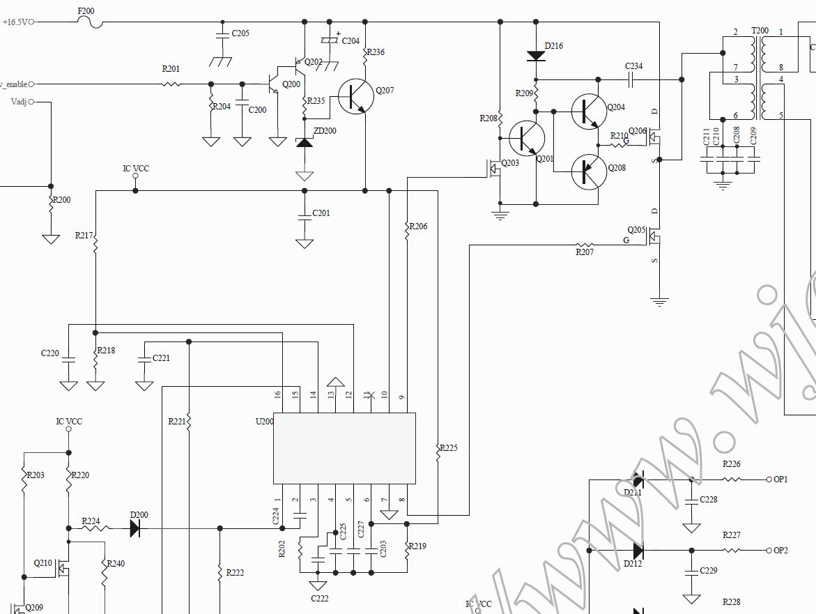

          Just to make sure you checked the corect fuse for the inverter,it's F200 on the back side of the board.

              I missed that one. Took a few minutes to find it. I'm getting .3 ohm

                                        Before we disassemble anything there are some mor things we can check.
                                        I am going to attach a schematic of the DCA19m-005 monitor/inverter.
                                        there are some pins on the back light controller you could verify are good.
                                        give me a moment to make some suggestions.We need to verify power/grounds and a back light on signal.
