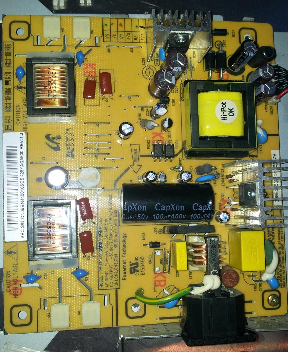

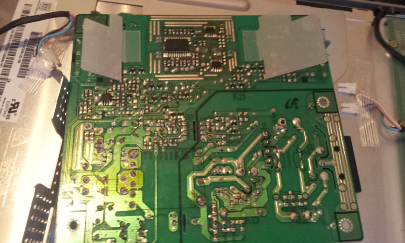

    I got given this monitor by my brother who got given it from someone else, so im not sure how the monitor failed, ive replaced all the medium and large caps with new ones low esr, i matched the voltage and fareds too, ive resoldered all the pins on the board too, ive checked the diodes with my dmm also.
    but its led is still flashing rapidly,
    theres no heat from any components when power is in no funny noises or smell or smoke whitch is good but means i havnt found whats wrong
    Any advice would be appreceated.

    Welcome to the forum! Just a few words of advice:
    1) Picture are ALWAYS welcome, but they need to be in focus and it's better if you take a overhead photo of the top and bottom of the board as members cannot see through components of photos taken at an angle.
    2) It's good that you replaced caps, but you should have also replaced the small ones. I see at least one capxon cap that's pure junk and should have been replaced. One small cap is generally used in the power supply startup process. If you had replaced all the caps, then we would have had a good starting point.....

      Thanks, and sorry about the pictures, i did take one of top and bottom and made sure they were clear i must have uploaded the wrong ones, its my fault i posted them via android mobile. I am planning to replace all of the caps i just thought id wait and see whether the new caps would solve it first, the caps are on there way so hope they get here soon. Yes i read somewhere that one small one is the startup cap but i was also told the big caps rarely fail,

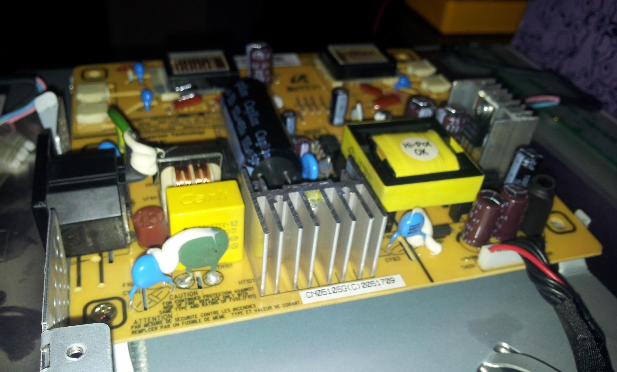

        Heres the other pic it wouldnt upload before

          You can generally leave the 450V cap alone as that rarely fails. All other caps (including the small ones) should be replaced with low-esr caps.

                                Maybe, but there is another possibility. There are 5 small caps - C103 C105, C204, C33, and another net to R101 whose component number is obscured (C104?) Were those replaced?

                                      The voltage on the big cap should be steady.
                                      The short story is I spent hours troubleshooting a Samsung TV/monitor that would try to start up, and fail. It didn't have a power led, but the speakers would click every second or so. After a LOT of troubleshooting I discovered that the startup cap in the external power supply was bad. The funny thing was I had tested the supply at about 2 1/4 amps load. The supply was rated at 4 Amps, the TV/monitor drew about 3.
                                      PlainBill
                                        Re: syncmaster 913n flickering led
                                        It seems that my thoughts turned out to be right in the big cap fluctuating ! :-) I replaced it and it started right up ! Whoo, only to find that when me and the ex fell out the other day shed taken her anger out in the LCD panel ! She did a his job in it too :-(. So now am selling the power board and video board anybody in Lancashire UK area is welcome to PM me
