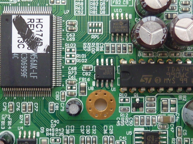

    Can any one help I have 8 Hanns-G HC174D 17" LCD monitors, thay all have the same problem. When I got them the thay all had bad PSU caps. Replaced the caps and the PSU are now good (tested in a woorking one). Thay still will not power up (no power light), I removed the Eprom from a good working one and then thay work OK. Can I get a new Eprom for them and where from, or is there any way to rewrite the Eprom from a good working one.

    What is the part number? Is it soldered in or does it plug into a socket? Does it store firmware or does it store user settings? Have you tried one of the monitors with the 'eprom' removed?

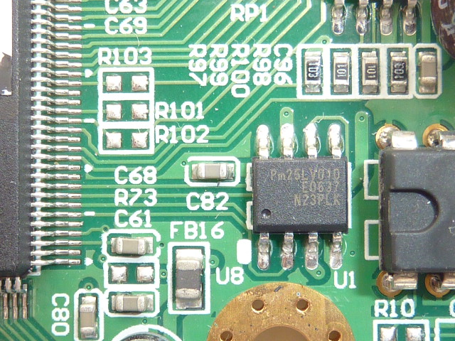

      You need an EEPROM programmer, they are readily available. http://www.ebay.co.uk/itm/EPROM-EEPR...item1c1f3798ef
      You can also use a PICkit 2 microcontroller programmer, and a breadboard.

        if its just user settings the unit may init the new one on first power up.
        you may need to go into the service menu and touch up greyscale , ect.

          Here is a picture of thr chip, I guess it has the firmware. with the chip removed stiil no power.
