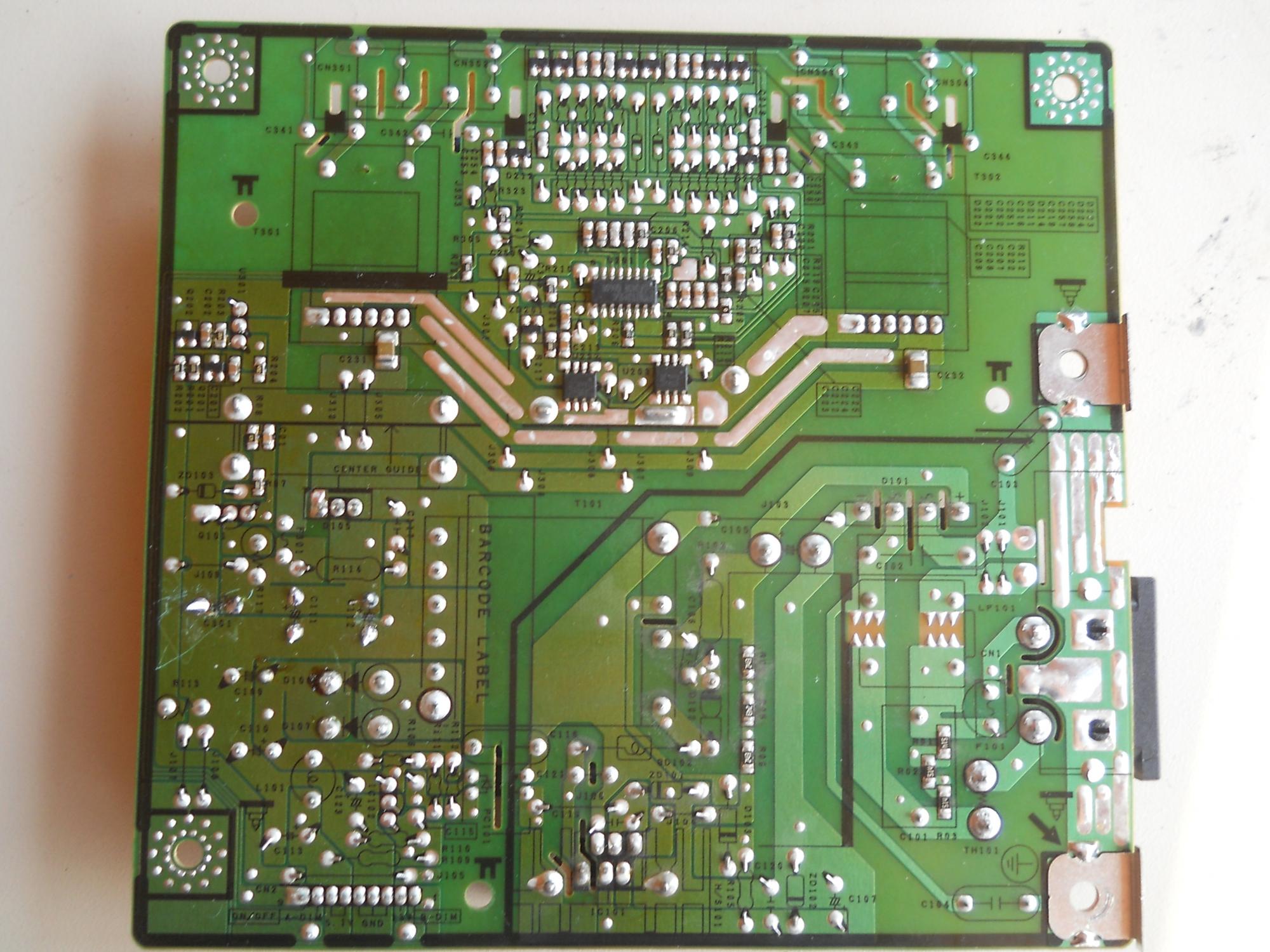

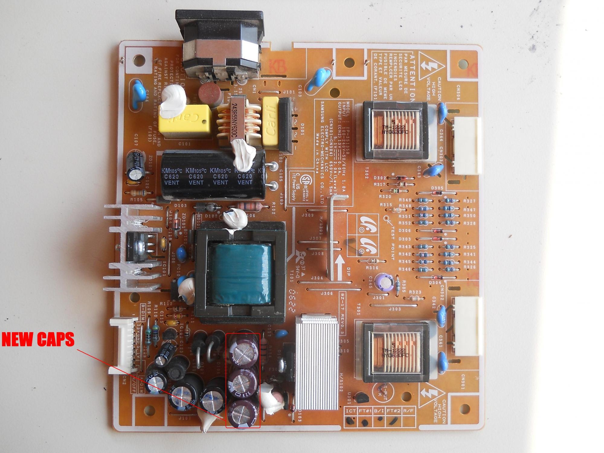

      Re: Samsung 740n no backlight after cap replacement
      i found the white/pink & black/green image on google, its just to show which cables im talking about.
      but here are the pics of my board (sorry lol .. as i said im new here )
      i dont have a multimeter right now but i'll try to get one today to check the fuse
      any other pictures needed?
        Were the backlights working before you replaced the caps?
        You seem to have installed Nichicon KZE caps, those should be good. In general, replacing only a few caps is a recipe for continuing problems. Congratulations.
        CN2 connects the power supply to the signal card. Pins 3, 4, and 5 are ground. What are the voltages on the other pins using any of the ground pins as reference?
        There is a 16 pin IC in the inverter area, U201. What is the part number on that IC?
                I think those new caps are fake.
                KZE made by United Chemi-con, their vent mark must be Y shape.
                  ^ lol
                  I was just about to write the same thing. dodgy sleeve + wrong vent
                  Seeing how old the thread is, and when shaisudri last posted, I don't think it's relevant anymore.
