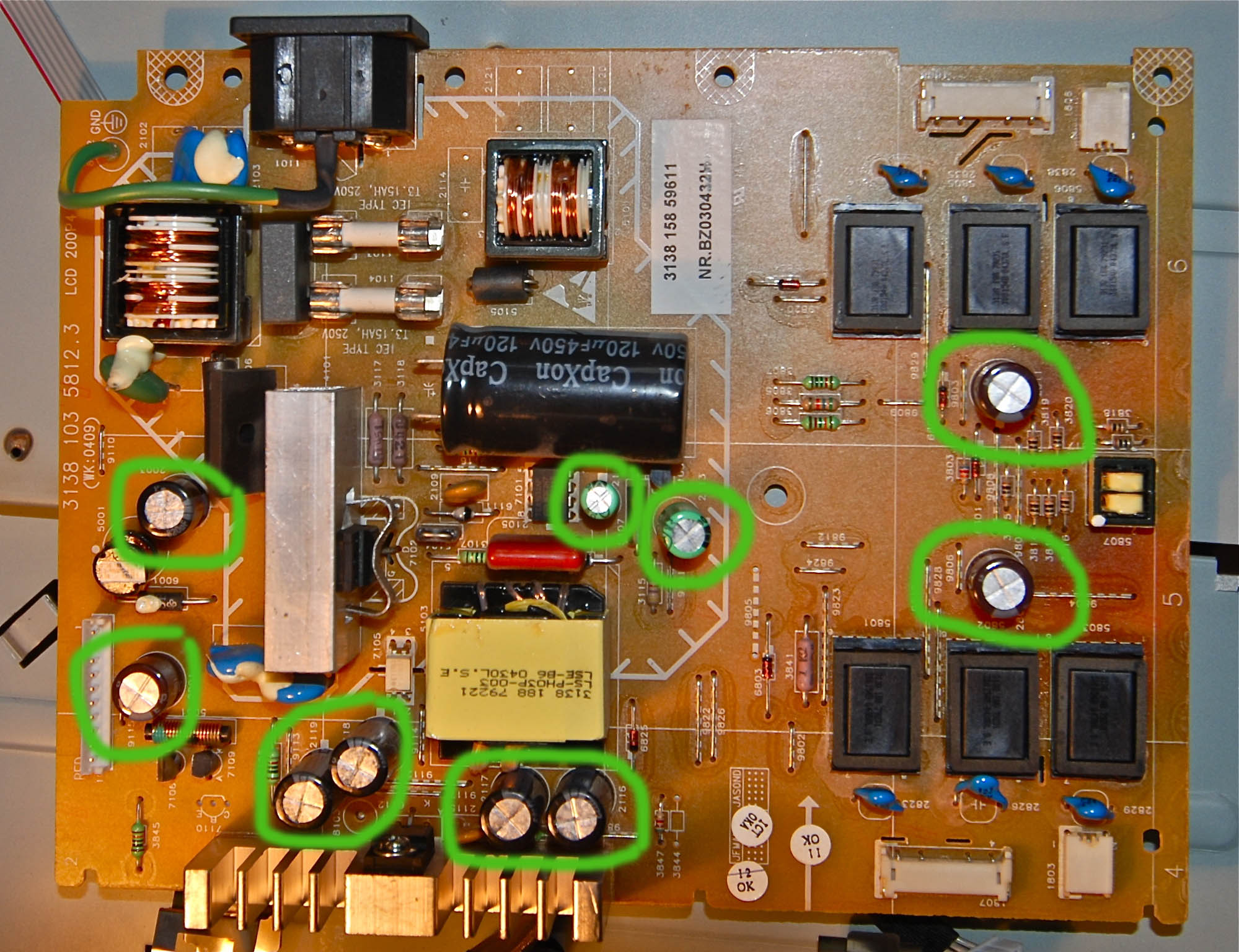

    Hi folks,
    I'm having a problem with a Philips 200P Monitor.... think it might be the caps on the Power Supply board.
    The unit powers up ok but after a few minutes there's a click and the screen dies and goes black...the power LED turns
    purple....it's normally blue when working correctly.
    What you guys think?

    The symptoms sound more like an intermittent connection (bad solder joint?) or a thermal problem. Note the links in my signature. Open the monitor up, take a picture of the power supply and attach it to your next post using 'Manage Attachments' - below the text entry area. For best results the picture must be well lit and sharply focused,

      Thanks Plain Bill,
      Here is a pic of the beastie!!
      I can't detect any bulging, burning etc...all looks clean and tidy!

        Doubt if it's thermal as it happens almost immediately from cold.....maybe a solder joint! If so, which one....there's a loud click when it fails!

          There is a 10 pin connector in the lower left hand corner of the board. Using the mounting screw that goes into the hole in the upper right corner, measure all the voltages on the 10 pins while the monitor is working, and again when if fails.

            Here's a good or bad scenario depending on your point of view...I'm waiting for the monitor to fail again and it just wont!! It's been turned on for two days now and nothing....seems to be working fine!! How strange is that?

              Try putting the rear cover back on. If it fails with the cover on (due to heat buildup), then it confirms PlainBill's suggestion that it might be a thermal problem.

                  Rear cover back on and still no sign of failing....even the slight dimming of the power LED before failing seems to be missing! I'm sure it's only a matter of time and I'll be back here seeking your help. Meanwhile, can I thank you again for your advice and postings and look forward to reading the many other posts that pique my interest.

                    I'm Back.....It finally failed again but strangely, if I tap the monitor anywhere it comes back on before failing again...argh...annoying! So, it looks more and more like a joint somewhere is acting up....any ideas folks?

                      Definitely a bad solder joint. Try tapping very gently to see if you can locate a sensitive area.
