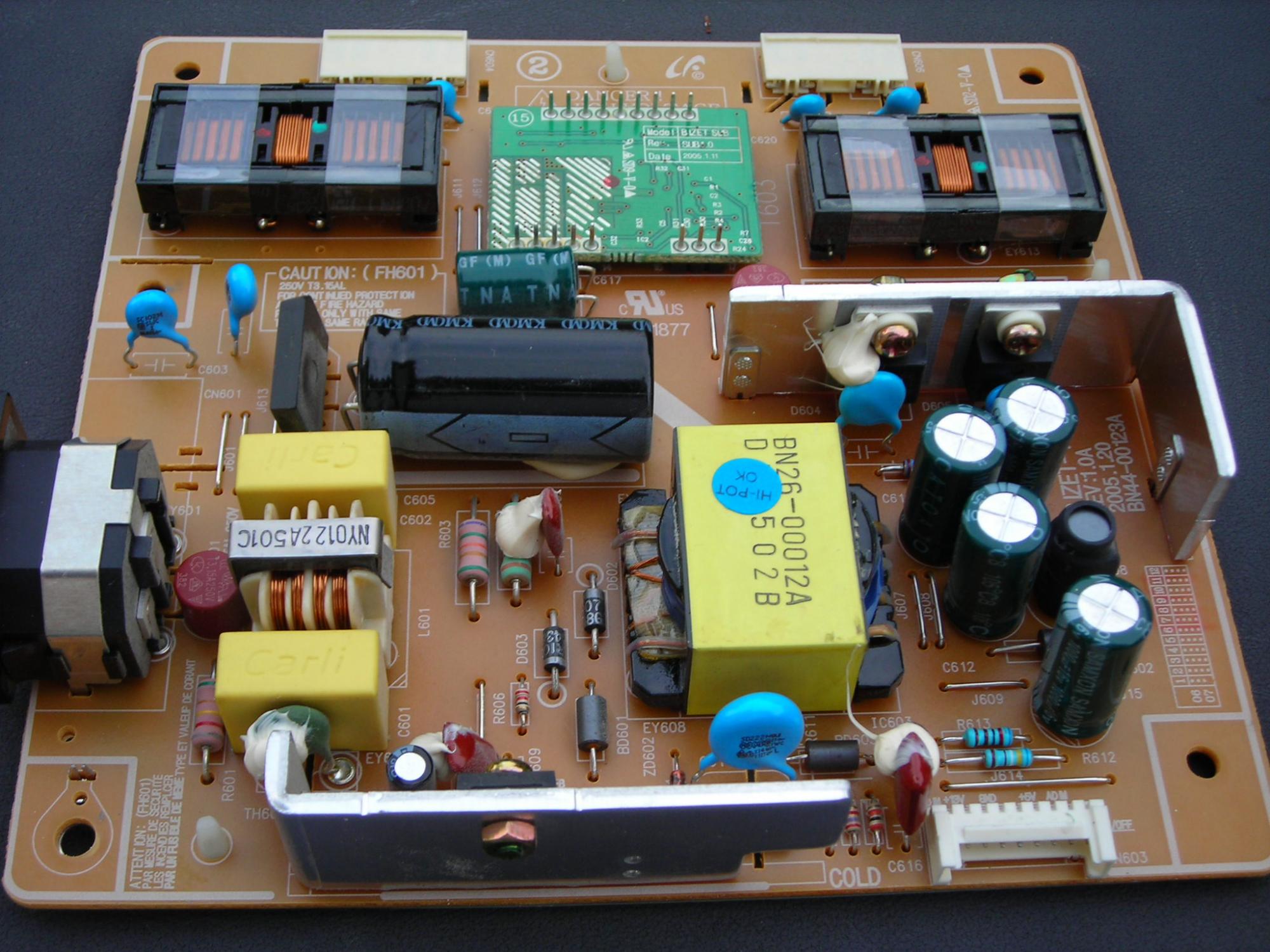

    My monitor screen blinks off for a second or two every 10-15 seconds or so. Before purchasing a new monitor I decided to browse the internet for possible causes - after reading a variety of information including info on badcaps it seemed to me that it was probably a bad capacitor or two. I have opened up the monitor now and removed the board with the capacitors. However, the capacitors are not showing any visible signs of problem. The tops of them are all nice and flat, the capacitors are straight with no bulging anywhere nor are they leaking anything. They look pretty much perfect. Is it likely that my screen problem is something else - should I be checking something different.
    I am by no means an expert on these things so any assistance or direction that anyone could provide me would be greatly appreciated. Thank you!

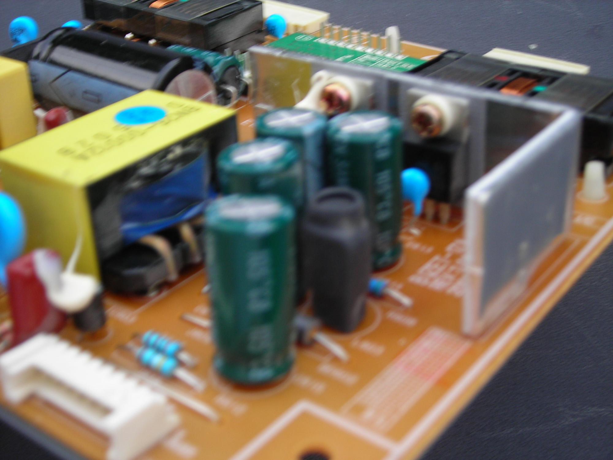

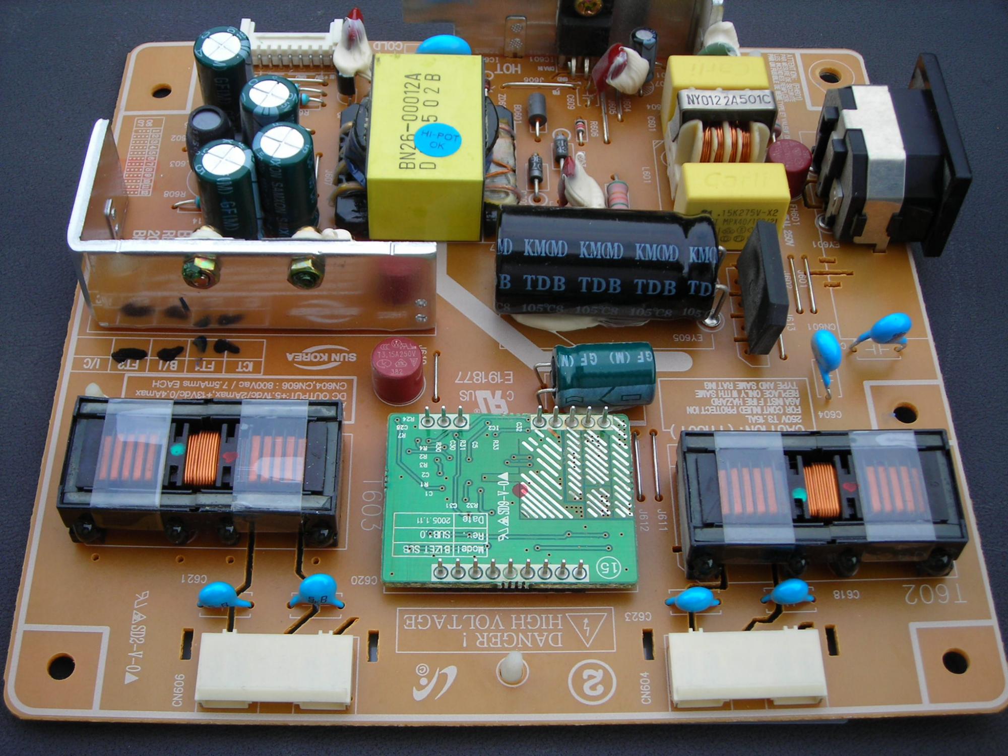

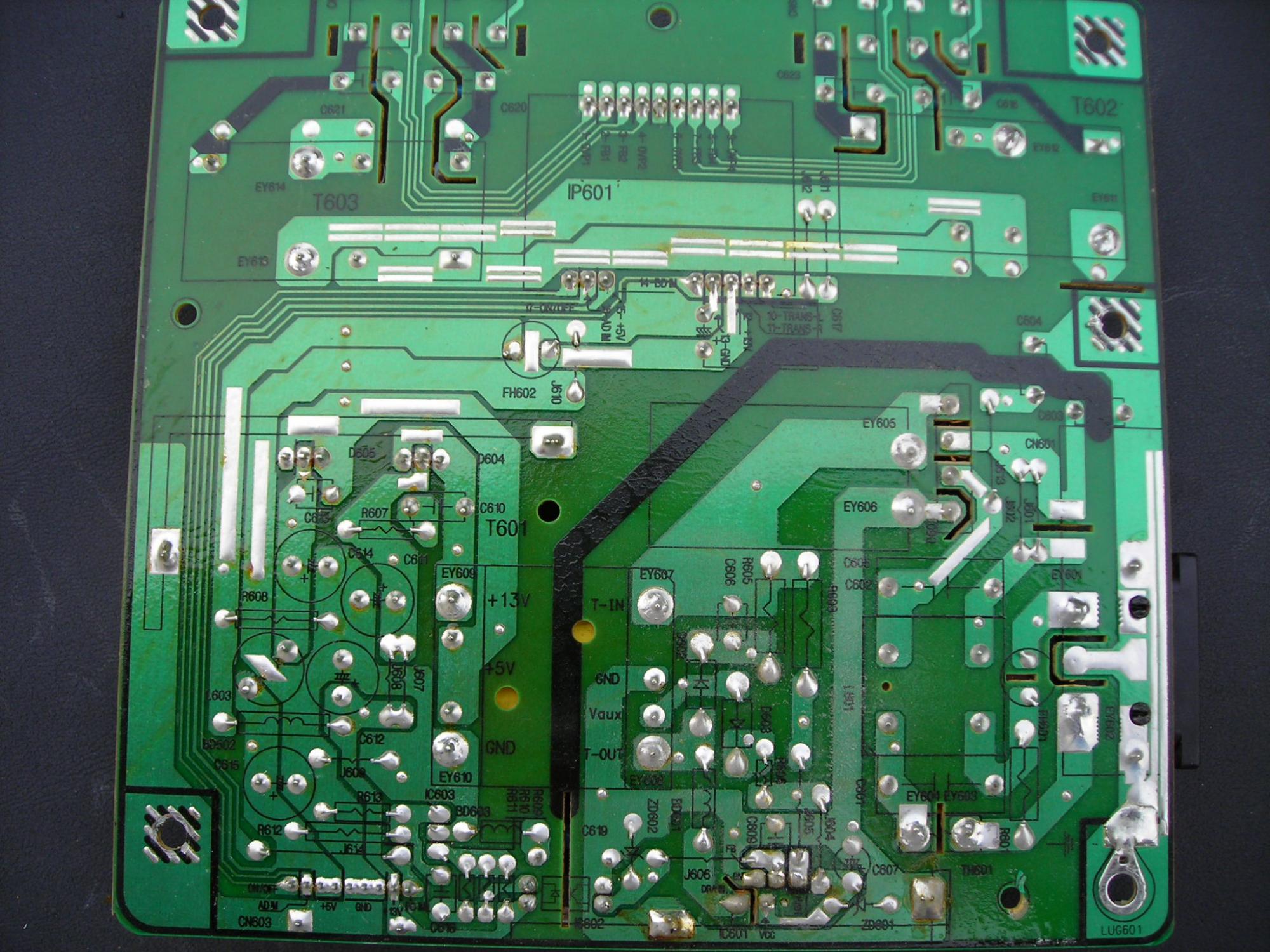

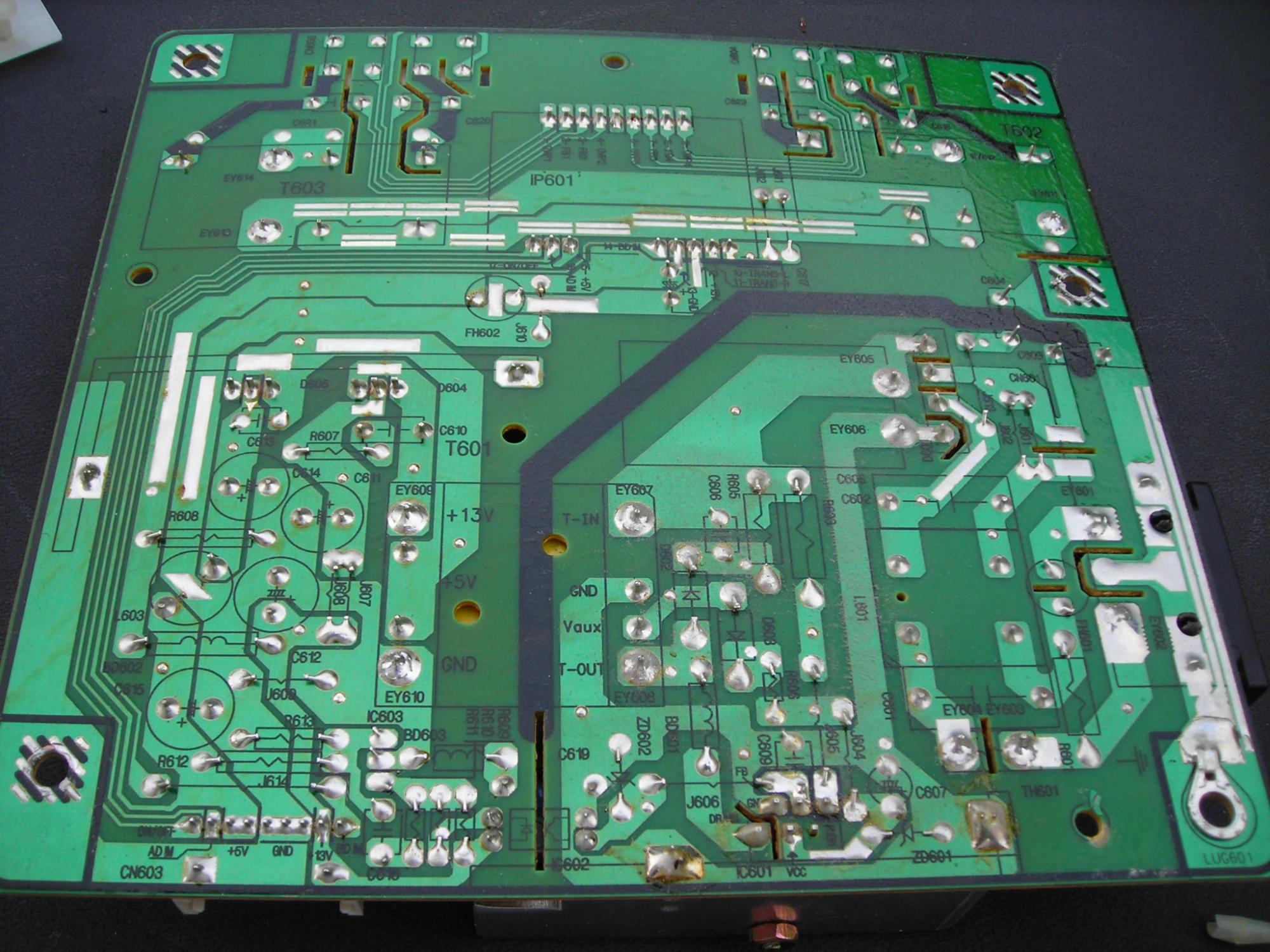

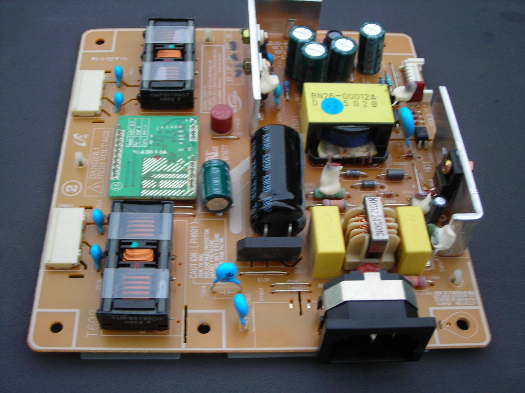

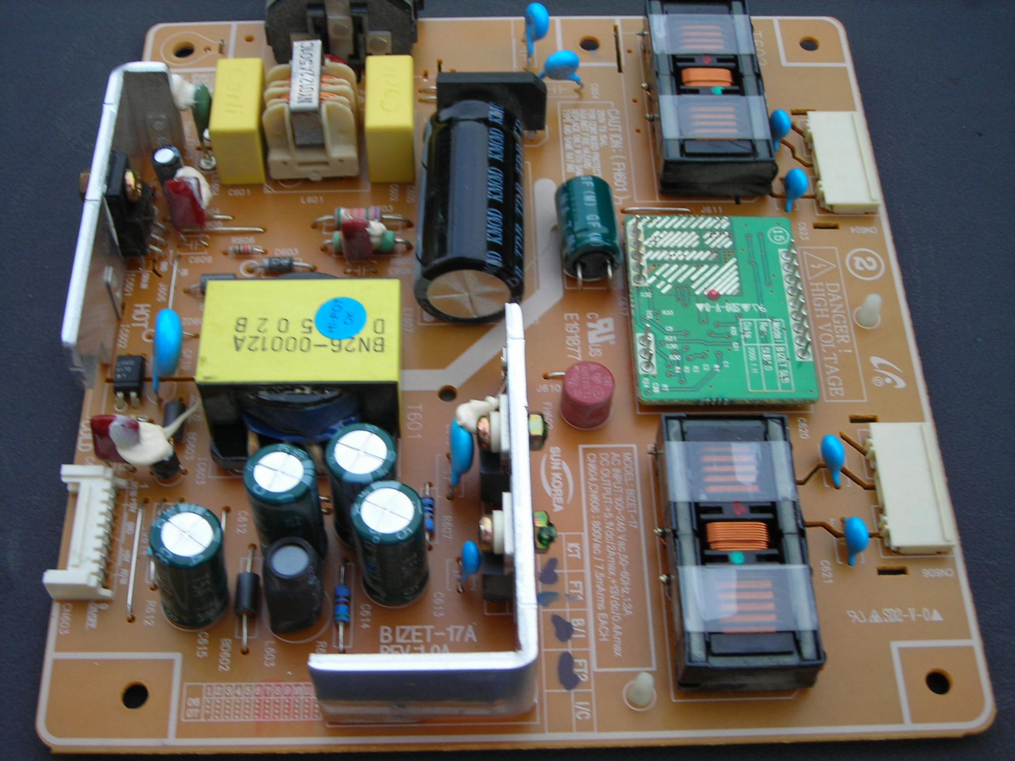

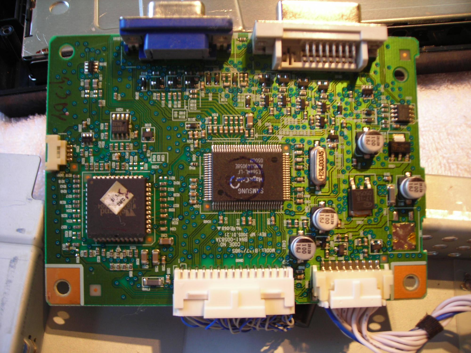

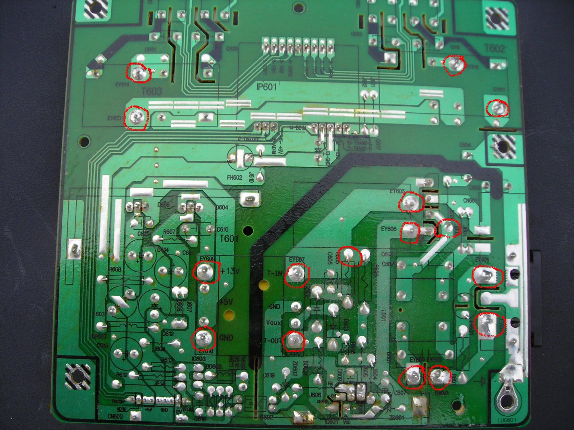

          I took the monitor apart again and took some pictures. I took a number of photos (front and back of the main board where the capacitors are) and also a front/back picture of the other board in the monitor (where the power and monitor plug into). I am certainly no expert but everything looks quite good to me. And, the capacitors look perfect. Again, the screen goes off for a split second every 6 seconds (when it does the power light goes off as well). Any assistance/advice greatly appreciated. Thank you!
            1) Read this thread by our fellow Canadian, smason.
            https://www.badcaps.net/forum/showthread.php?p=163015
            2) Your board also uses Samxon GF caps.
            Capacitors die from age, heat, and shoddy build quality. Capacitors DO NOT have to be visibly bloated in order to bad. They can be out of tolerance uF (a 1000uF measures 20uF) and/or have high ESR (ohm). A multimeter will be insufficient to test for ESR. For that you need an ESR tester which costs between $50 and $300. (Refer back to #1).
            3) There are some solder joints that have ring cracks. I circled the most obvious in red. I would touch up all the dodgy looking joints. If the problem persists, then you can try replacing the caps with something like Panasonic FR or FM series.

              Thank you so much for your assistance. Can you give me some direction on how to best touch up the joints. I read somewhere where you can reflow such joints by putting the whole board in the oven - doesn't sound like a good idea to me! Should i just reheat each joint with a soldering gun (until it softens) or do i add solder? Thanks.
                Re: Samsung Syncmaster 930B - screen going off and on
                1) You can reheat each joint until it goes into liquid state and then remove your solder gun/iron.
                2) You can remove the old solder completely and add new solder.
                3) You can reheat each joint and add a bit of new solder.
                I have done all 3 at various points and I don't have a preference, but some would suggest #2 is the most reliable.

                      As soon as I see one of these little sub pcb's mounted on the top of a PSU/Inverter,I cringe and approach the 'fault' in a different manner,as these regularly fail, as they carry the Backlight drivers etc. To fault find them is usually not feasible,and to replace them in total...no chance,so I do not change caps as a first immediate action,until I am certain that this PCB sems OK,that means measuring voltages(as suggested by retired caps),ensuring the BL On signal is functional,and removing the power to the sub pcb if possible,and then see if the power lamp stays on.

                        The power light is indeed a clue. It would appear the processor on the signal card may be momentarily turning off the power led and inverter. Jay333 has already mentioned checking the BL_ON (or equivalent) signal.
                        Excuse me if you have already done so, but you should also be examining the power line (5V?) to the signal card, the outputs of the LDO regulators on the signal card, and even the reset controller (if any) on the signal card. Don't forget the input signal itself - you may want to make sure it is a plain vanilla 640 x 480 @ 60hz
                          I did ask for voltage readings back in post #9 (3 minutes after I answered the reflow question), but perhaps the OP didn't see the message?
                          All the suggestions by Rtech and PlainBill were next on the list of things to examine. It looks like 2 voltage regulators on the signal card. One is -33 and the other is -18.
