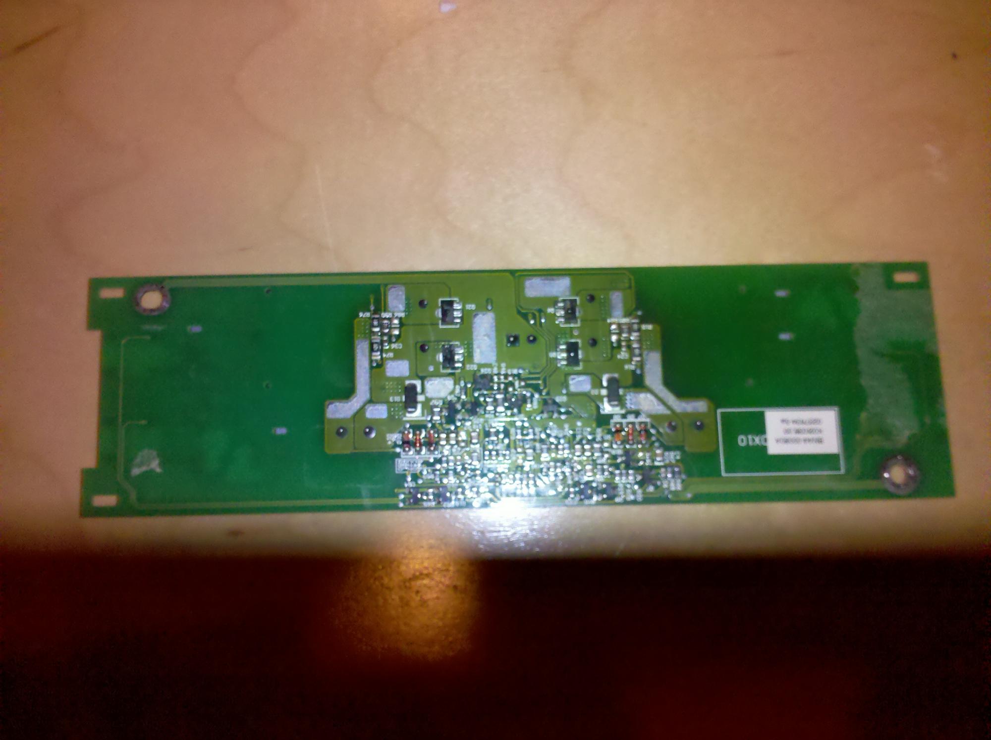

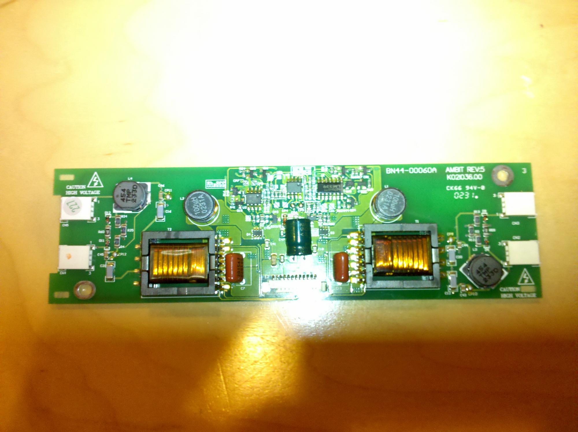

    I just signed up great to have help here. I need help working on A Dell E171FP LCD. It turns on and the backlight lights up however it is a very pink color. And after about two seconds it flickers, and changes to the normal color of the monitor, and one second after than it it just goes black. However, the green light still stays on and if I put a flashlight on the screen and you still can see windows desktop, so the actual panel is still staying on. I have a few pictures of the inverter board below. The power supply looks fine, however I can take pictures upon request. So what should I start testing.
    OH, two red HV caps read
    2A154J
    H2810S
    And the green one reads,
    220uF
    25V

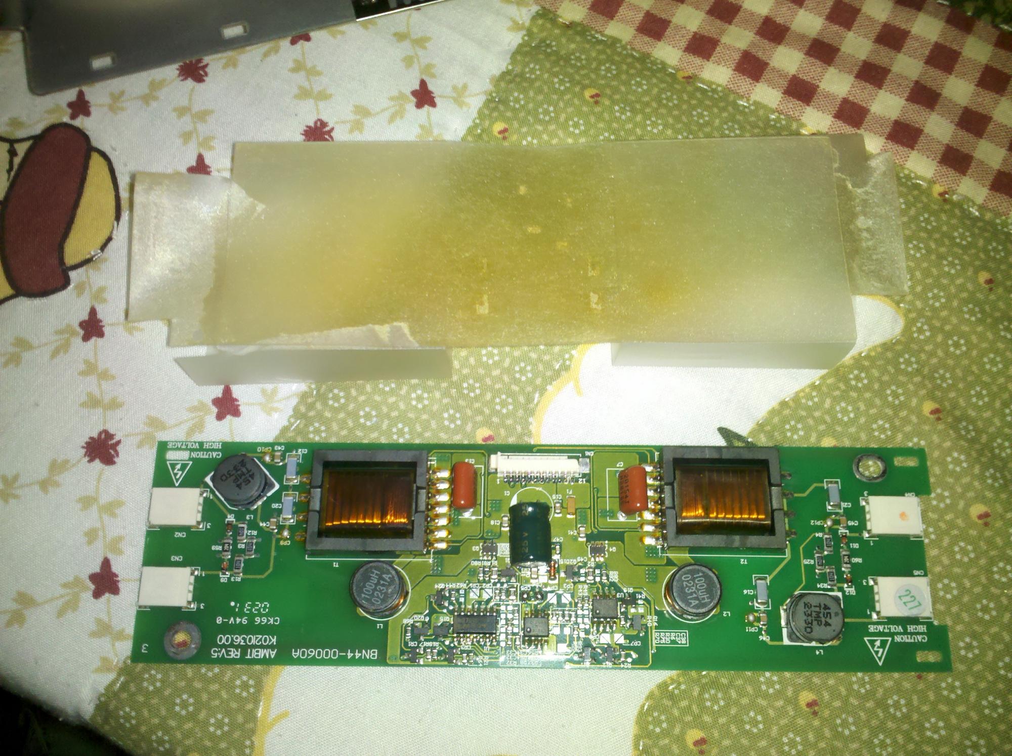

    Nothing looks burnt or bulged, well with the exemption of the clear plastic covering for the inverter board, but I think that's from heat.
    Also, Sorry the pictures aren't the greatest my real camera is broken right now.
    Thanks!

    If the images is a pink/red color that means one or more of backlights CCFL tubes are worn out and need to be replaced.

      But why does it change to its normal color after a 2 seconds. If the HV line was weak wouldn't it cause the backlight to be discolored?

        There are two sources of light involved. In normal operation the gas inside the CCFL generates UV light, which activates phosphors on the inside of the tube, which produces the color you see. An old tube produces a red glow inside the tube which initially overrides the glow from the phosphors.
        Shovenose is correct, the initial pink tint is due to a failing CCFL.
