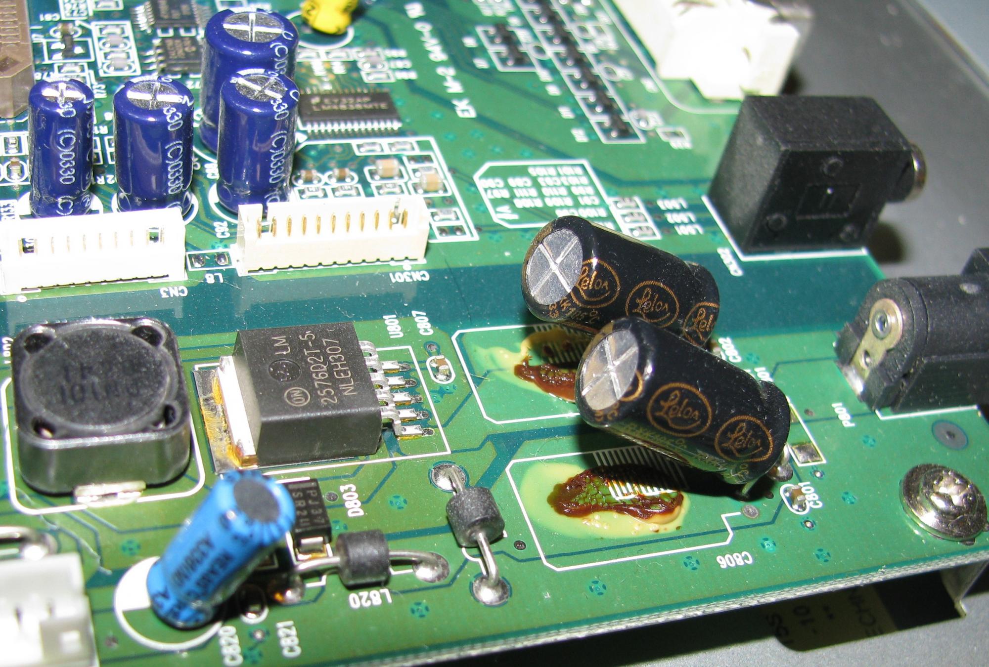

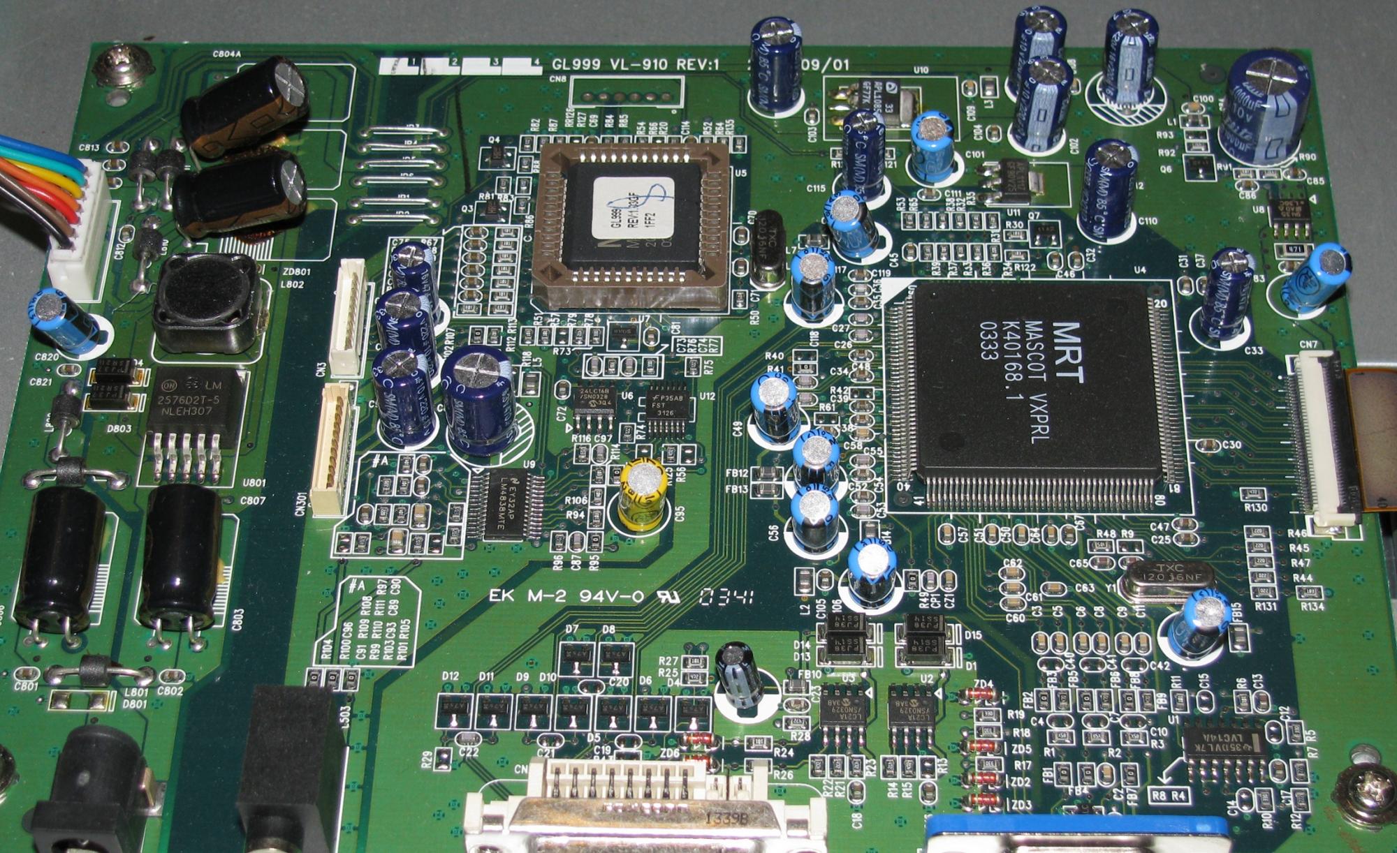

    Part time reader, first time poster here.
    I've done a couple recappings before, so I have been learning steadilly.
    I got a AG Neovo E-19A monitor that went out a bit ago, plugging everything back again today has the image pop up, but immediately shut off. The green light stays on, so I have to turn it off and back on again to see the image. I don't think that the CCFLs are on at this time, but its hard to tell without fully tearing this monitor apart. (its got a nice glass front).
    It has a separate 12v DC source, and that reads fine at 12.3 steady. I looked the board over and it doesn't seem to have any blown caps or things that are noticeably bad. There was the fact that on the video board, the glue holding some of the caps down looked dark, but those capacitors looked fine.
    There was also some darkening on the inverter board for the CCFLs, but I didn't see anything that would look damaged. There was also some odd coloration to the video cable to the panel, but I'm not convinced it would cause issue.
    I haven't done any readings on the board yet, as I am not positive where to start on those.
    Any hints or help would be swell! Thanks!

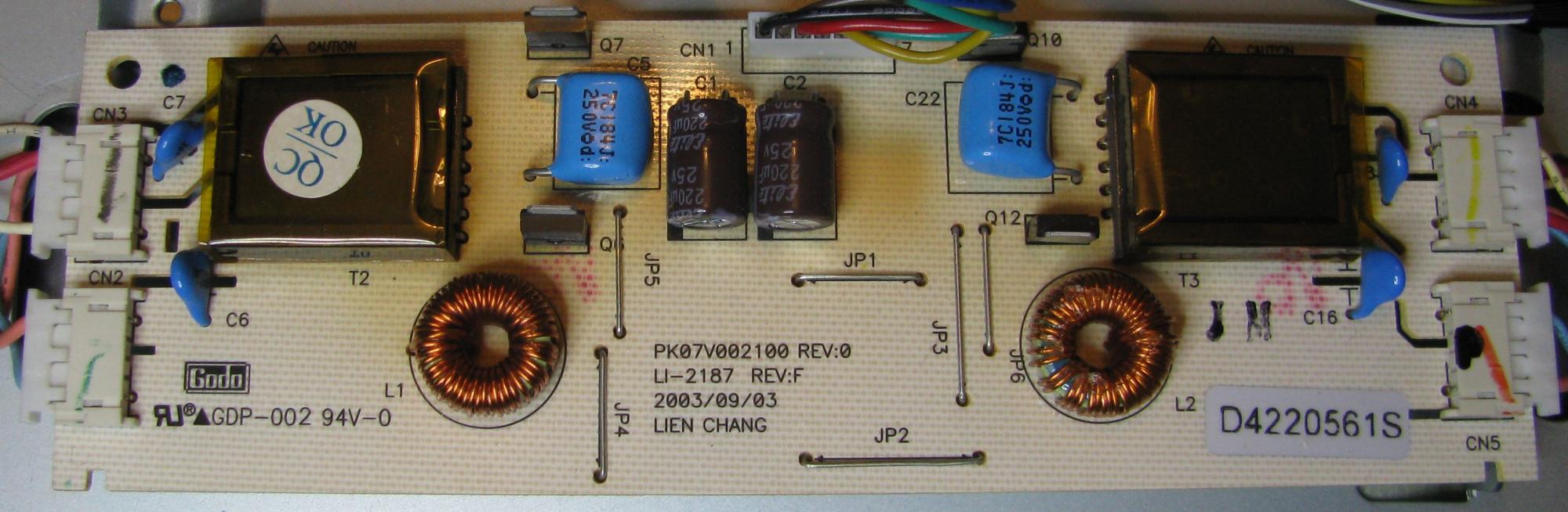

    Re: AG Neovo E-19A (E-191)
    Good pictures, thanks. It makes a big differentce. You've got 'two seconds to black'.
    This is our old friend the Royer oscillator (OK, two of them). C1 and C2 are automatically suspect; Elite caps are worse than Capxon and the heating on the board doesn't help them.
    Check transistors Q7, Q10, Q12 and the other one - Q6? Q5? for shorts. Resolder the transformer pins.
    As a test, disconnect all but one CCFL, power up, and see if you get backlights for the two seconds. Do the same for the other three backlights. You are hoping to see one backlight that doesn't light.

        The darkening is not excessive, but I would be interested in that components are causing it, although the FETs are a prime suspect.
        When you do open the monitor up, the very first test should be testing with one CCFL at a time. That requires minimal work and could identify the problem quickly. If only one CCFL doesn't work, you have a bad CCFL or wiring. If two don't work, you have a problem on the inverter.

                      Correct. The only readings that are important are the resistance between the two left hand pins of T2 and the resistance between the two right hand pins of T3. Those two readings should match to within 3%.

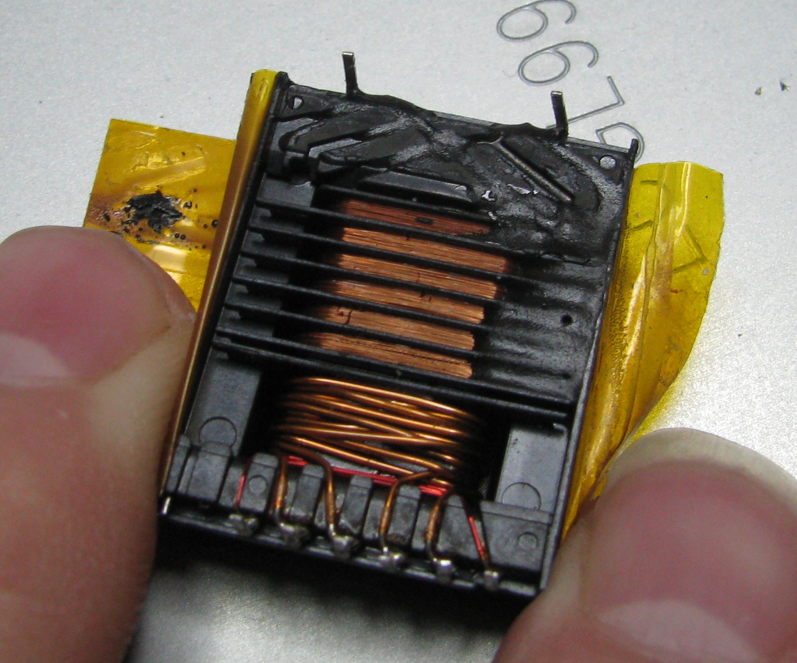

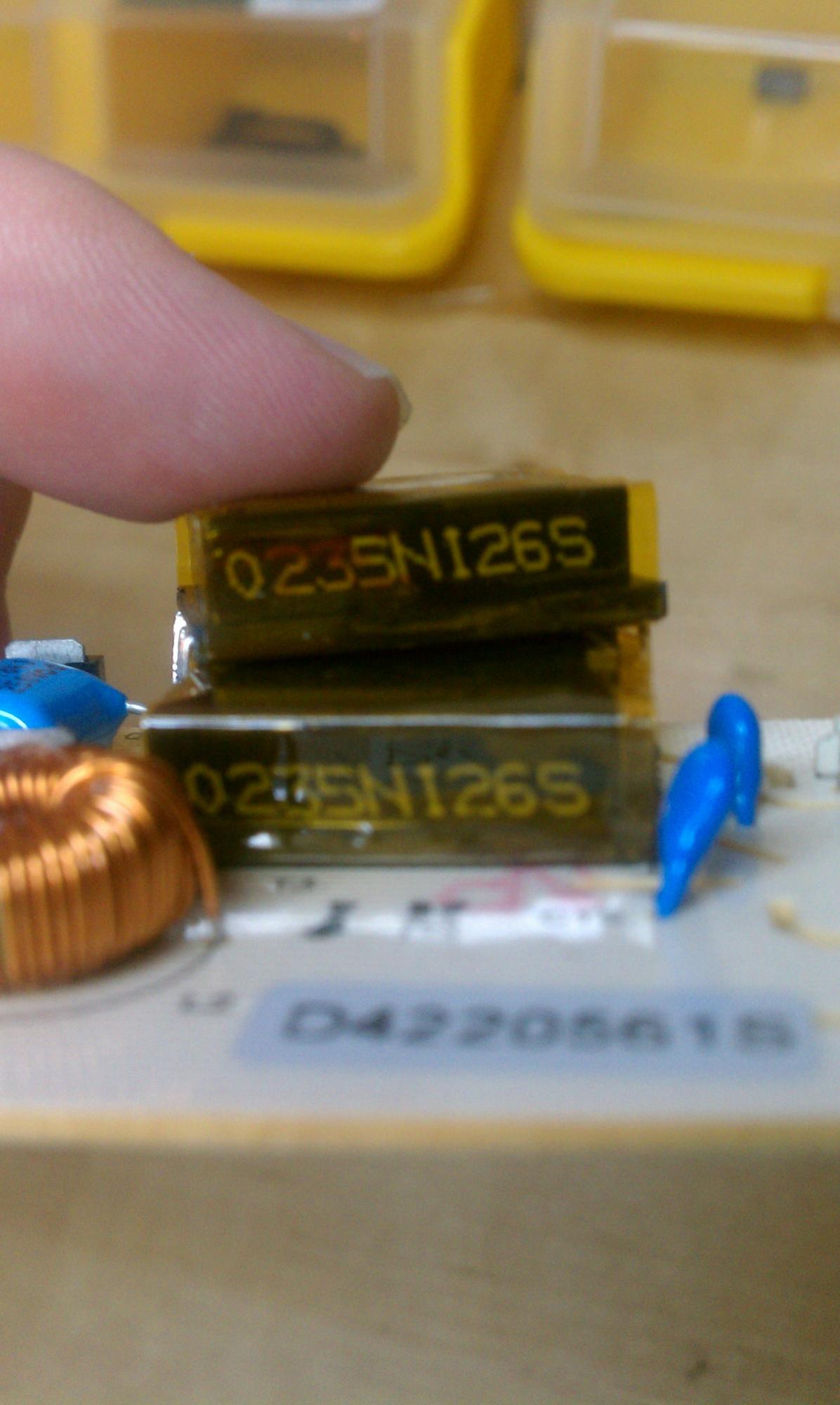

                        Great! That means its T2. Since I am getting 82k Ohms from its secondary loop. Now to find a replacement...
                        I see "0235NI26S" written on the side (of both), Though the 5's and S's look close, I am almost positive that is what is written.
                        I was not finding any hits on Digikey or Mouser (or Google for that matter) for that number, and there is no other information written on it anywhere.
                        Any good hints what to be looking for?
                        • thraxarious
                          • Jun 2010
                          • 25
                          Oh yeah, melty.

                            I'm not good at remembering transformers. A picture of the actual number on the transformer will give me more to work on identifying a replacement. The numbers are usually a combination of an identifier and a date code or production lot.
                            Or look at LCD warehouse, IIRC they carry inverter transformers.

                              Awesome! Thanks, I really appreciate the time you are spending with this. I've been sifting through the forums and learning a good deal.
                              Yeah, not finding any hits on that supplier, some Ebay seller, but only a couple monitors.
                              Here's the pic, showing both off.

                                No luck identifying it. I ran through all 8 possible combinations of 5 and S, I and 1, and S and 5.
