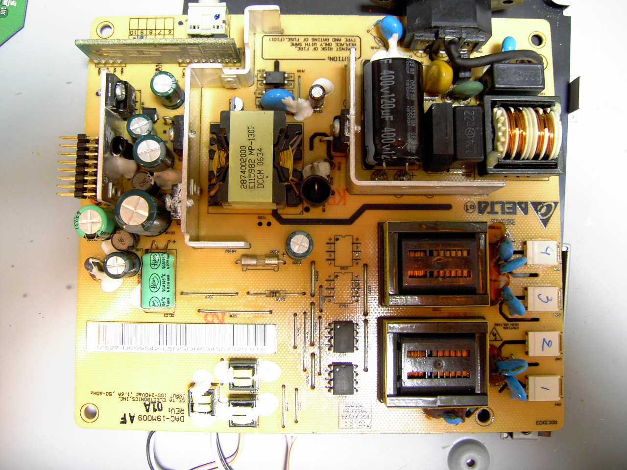

    I'd like to share a problem i deal with a Viewsonic Monitor which seems to work normal for 30sec and then goes off with the blue light on.
    I already replaced 2 bad capacitors but the problem remains. I'd be more than greatfull for a suggestion.
    Thank you in advance

      The most common fault on these aprt from the caps, is failure of one or both the AP605 inverter drivers, U202 and U203, PROVIDED your Board is a standard one, which is why the Photos requested by Retired Caps, are really important if you need more help later.

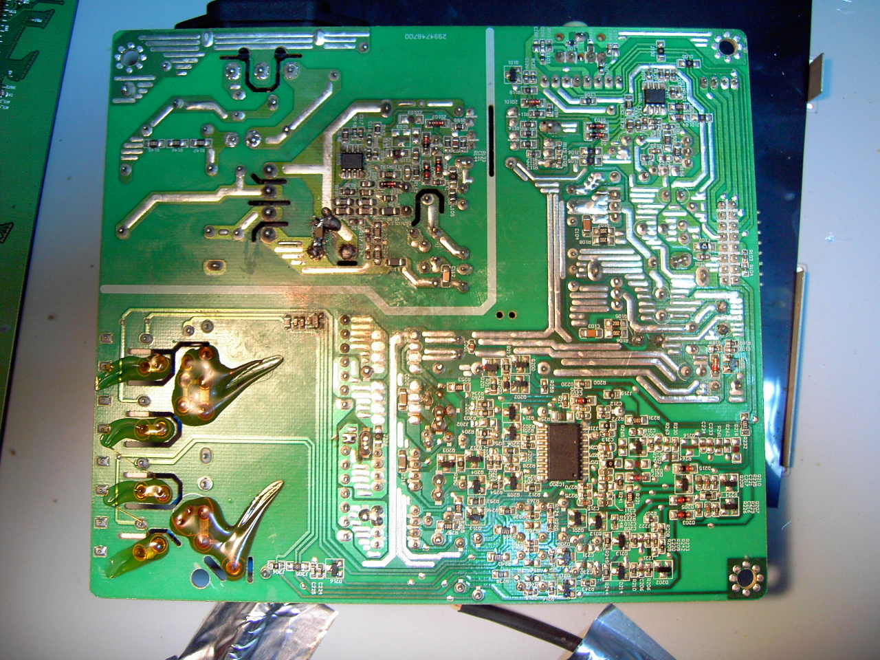

        Thank you guys for the fast answers. I just get both side photos and uploaded the power board.
        The original 2 caps replaced were VENT KF105oC P632 and replaced with LELON RGA105oC H036(M)

          Even though this monitor works after 30 seconds and shuts down, this could be "2 seconds to black".
          2 seconds to black can be
          a) bad caps (especially if you used Lelon for the replacement caps - were these used caps from somewhere else)
          b) bad inverter transformer
          c) bad ccfl and/or ccfl wiring
          More details about 2 seconds to black can be found in posts #13 and #14 at
          https://www.badcaps.net/forum/showthread.php?t=10419

            Are those blue caps near the CCFL connectors dodgy or just exhibiting varnish-splash from the transformers?
