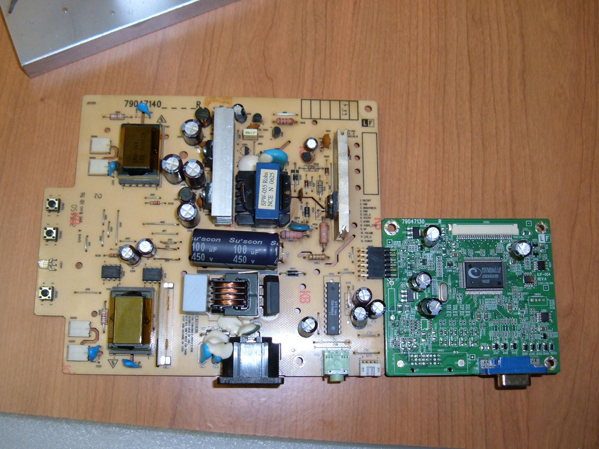

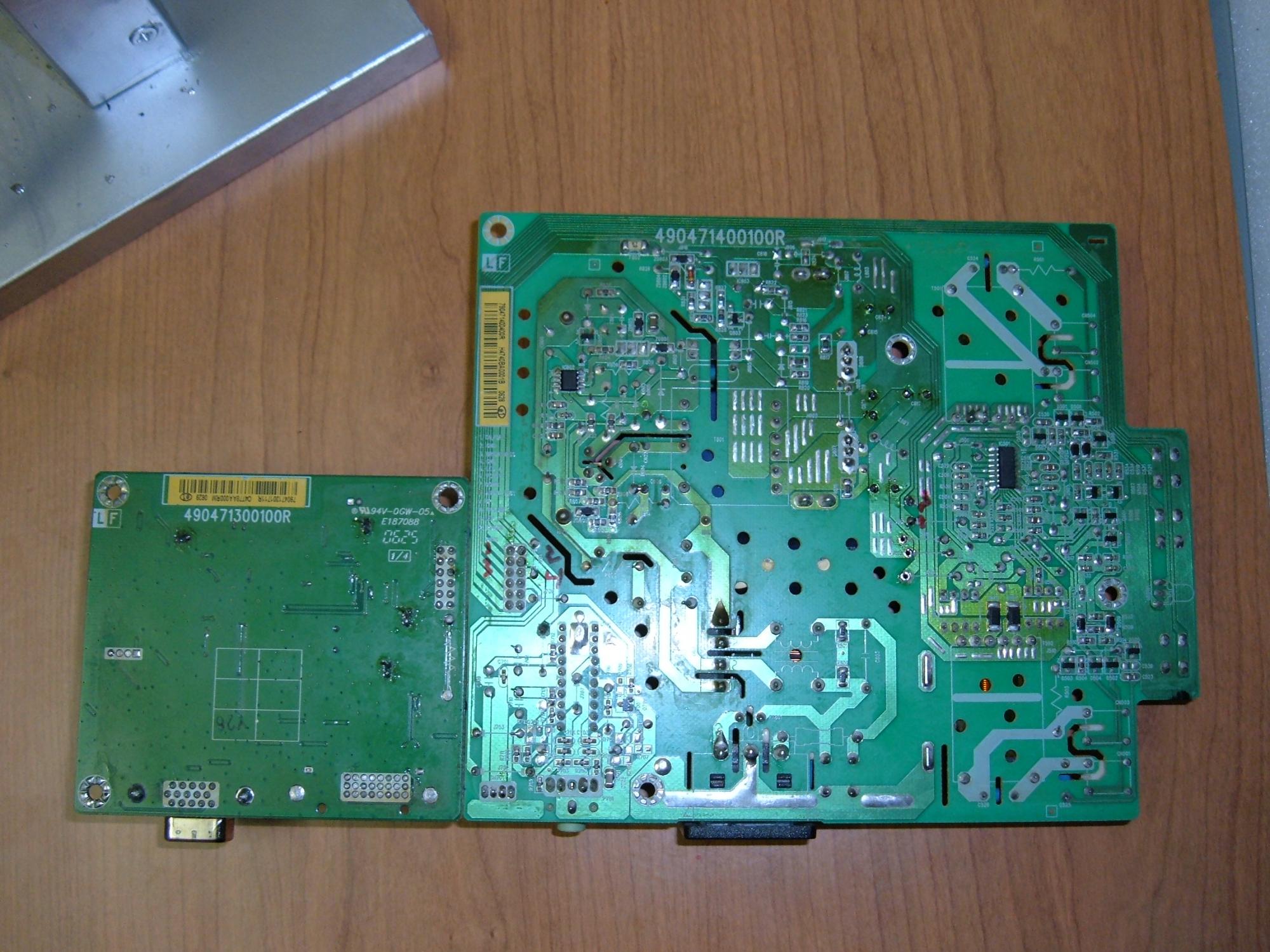

        Hello again.
        I attach the pictures of board.
        On power board, after some checks i can't find something worng. I replace 4 caps to test but nonthings happend, so i decide to change and put the original again. I try to remove bridgets to inverter circuit. (i open 5 wires on left of big cap 100uF - 450V). This isolate the inverter zone.
        The 5 wires are:
        1 for Vcc (14vcc)
        2 for GND
        1 for "on/off"
        1 for "brightness"
        I only have 14 Vcc and 0v on "brightness" and "on/off" . I supposse than the scan board turn on the inverter with a continuos ttl signal, and manage brightness with a variable voltage between 0v-3.3v . Its this correct?
        I also remove the audio-amp (tda7496lk) with similar method in my test whit no result.
        Led and buttons in power board connects direct to scan board trought pins-conector. It also have 5.2v to main power of the scan board.
        In this point, i think that the fails its on scan board. And on scan board i change 4 caps (100uF-16v). No results.
        I check 2 voltage regulators, labeled as U101 and U102. Its a AS1117L-33 and AS1117L-18 respectively. The U101 outputs 3.3V , and the U102 output 1.2V , so i understand that maybe here its my problem.
        Next days i try to change this componet and continue with this thread.

          Re: Lcd CTX X962A dont turn on
          The logic board turns the monitor on/off by changing the voltage between 0 and something larger than 3.0V.
          U102 should read 1.8V DC output so you are correct that U102 is bad. The suffix -18 tells you the correct output.

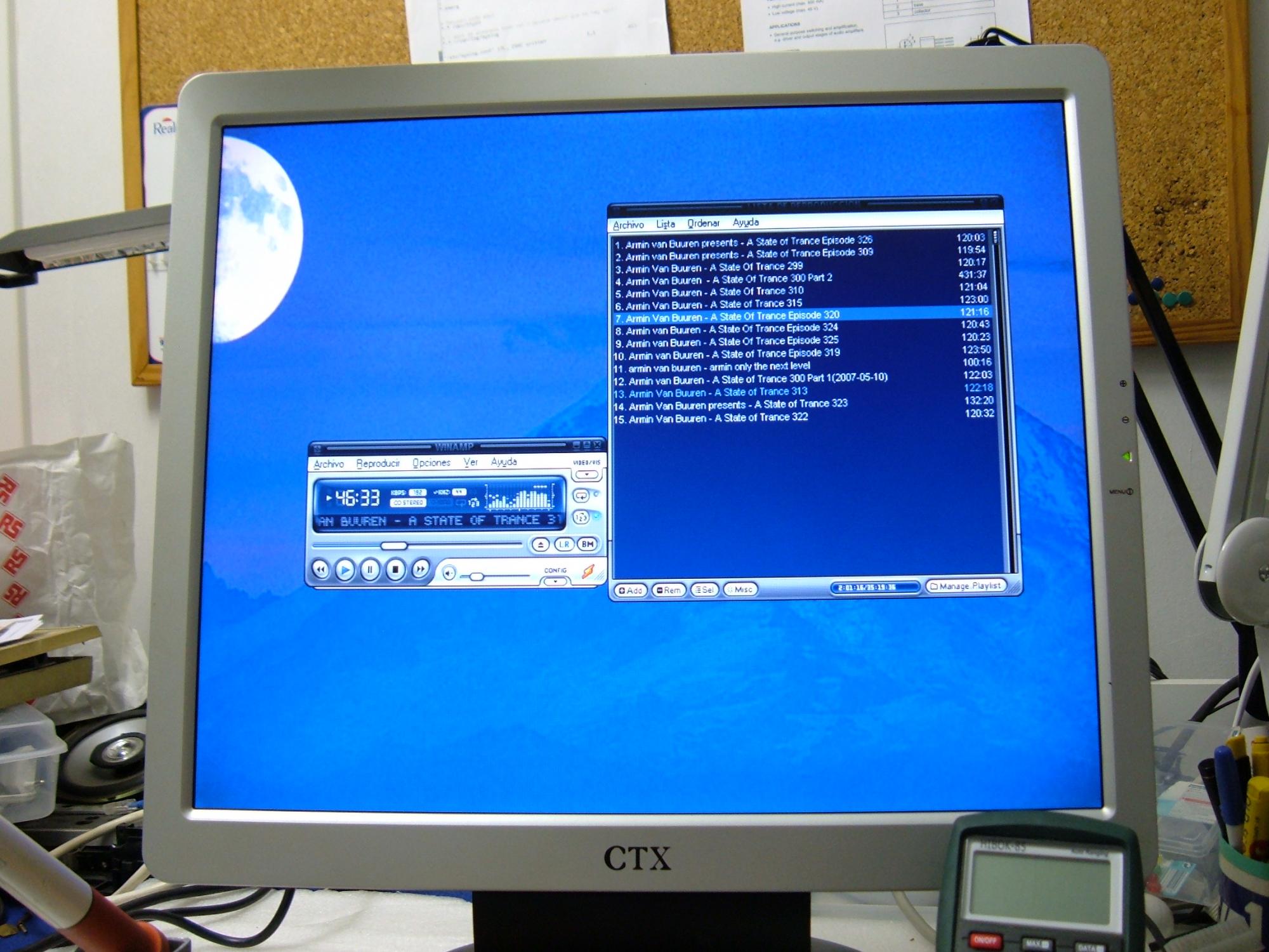

            Solved
            Finally, after ten minutes searching on my old-damage hardware i take an AS1117L-18 from a damage livebox-router (other manufacturer).
            After change i test again and now i have 1.8V.
            ...and this is my results :
