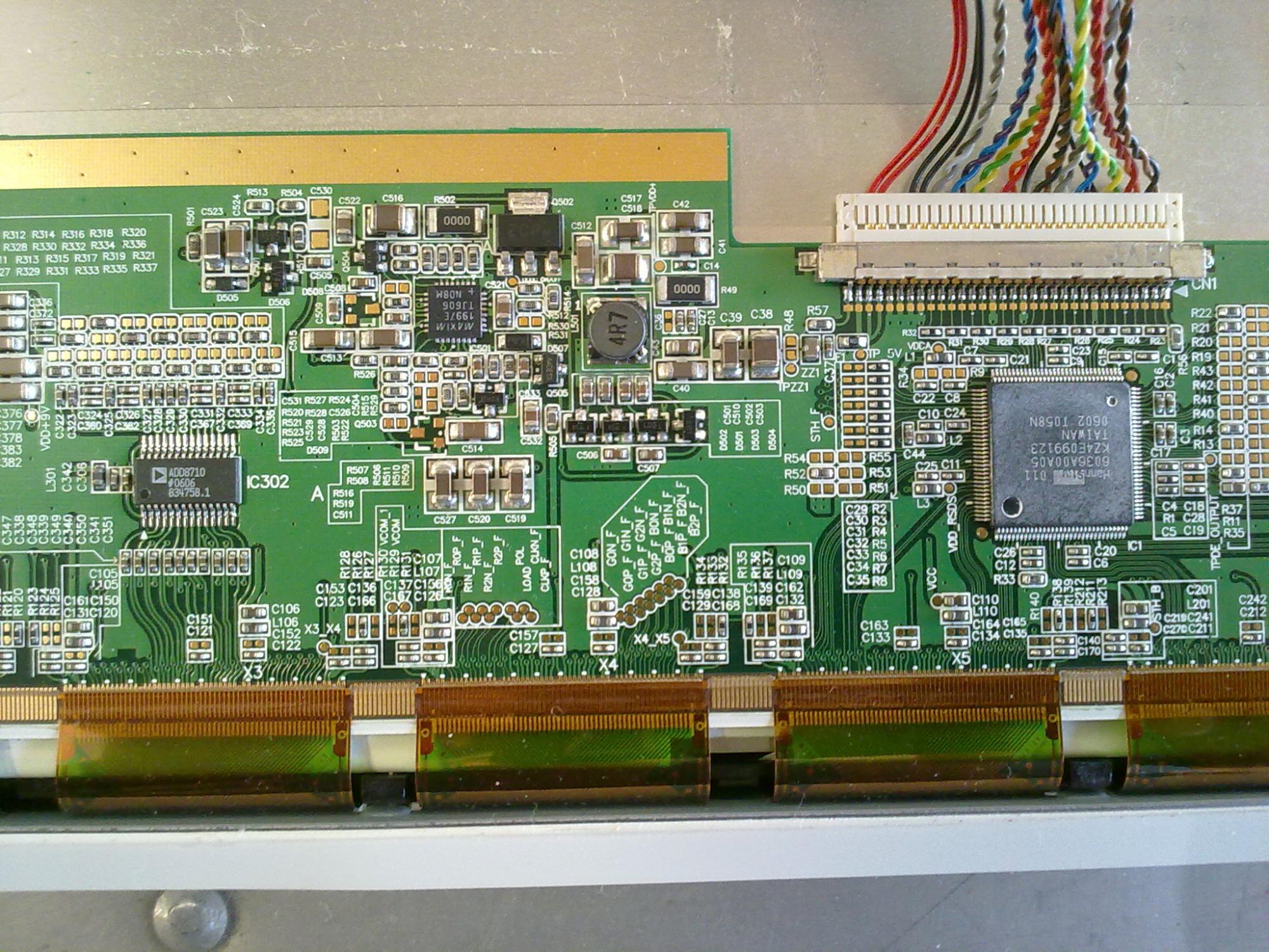

              • PlainBill
                • Feb 2009
                • 7034
                Re: HannStar Monitor
                Originally posted by rigeback
                OK, To be certain about getting power to ICI-501 I hooked up the CCFL lamps and the T-Con board gets the 5 volts @ the ICI-501 for short burst until the video card goes into standby. So this seems to romove the power source and video card from the problem??
                Correct. A quick summary of how these work: The power supply takes line voltage and converts it to 5V (for the signal card) and 12V (for the inverter). The signal card checks it's last known state. If it was On, or in Standby, it turns on the LCD panel and the inverter, then starts looking for video signal. If it doesn't see a video signal within a few seconds, it puts up a 'No Signal' message, then turns off the LCD panel and the inverter.
                Take a look at the second picture you posted; it shows the panel card (or more correctly, the tcon). Look at the connector from the signal card. The left pin goes to R57. The next three pins are all tied together, and to one end of F1.
                  Well thats a real small bugger and I'm glad I don't have to change it and yes it has contenuity.
                  • PlainBill
                    • Feb 2009
                    • 7034
                    #29
                    IC501 and associated components generate the voltages required for the LCD panel. I'd suggest looking up the datasheet for the IC and checking if it is generating voltages. A common failure is the not-so-small SMD caps short out. Also, near the left edge of the same picture is a point labeled VDD+9V. I'd look for more and check the voltage is present. For the sake of convenience, you might want to hook a computer to the signal card so you can make sure the power will always stay on.

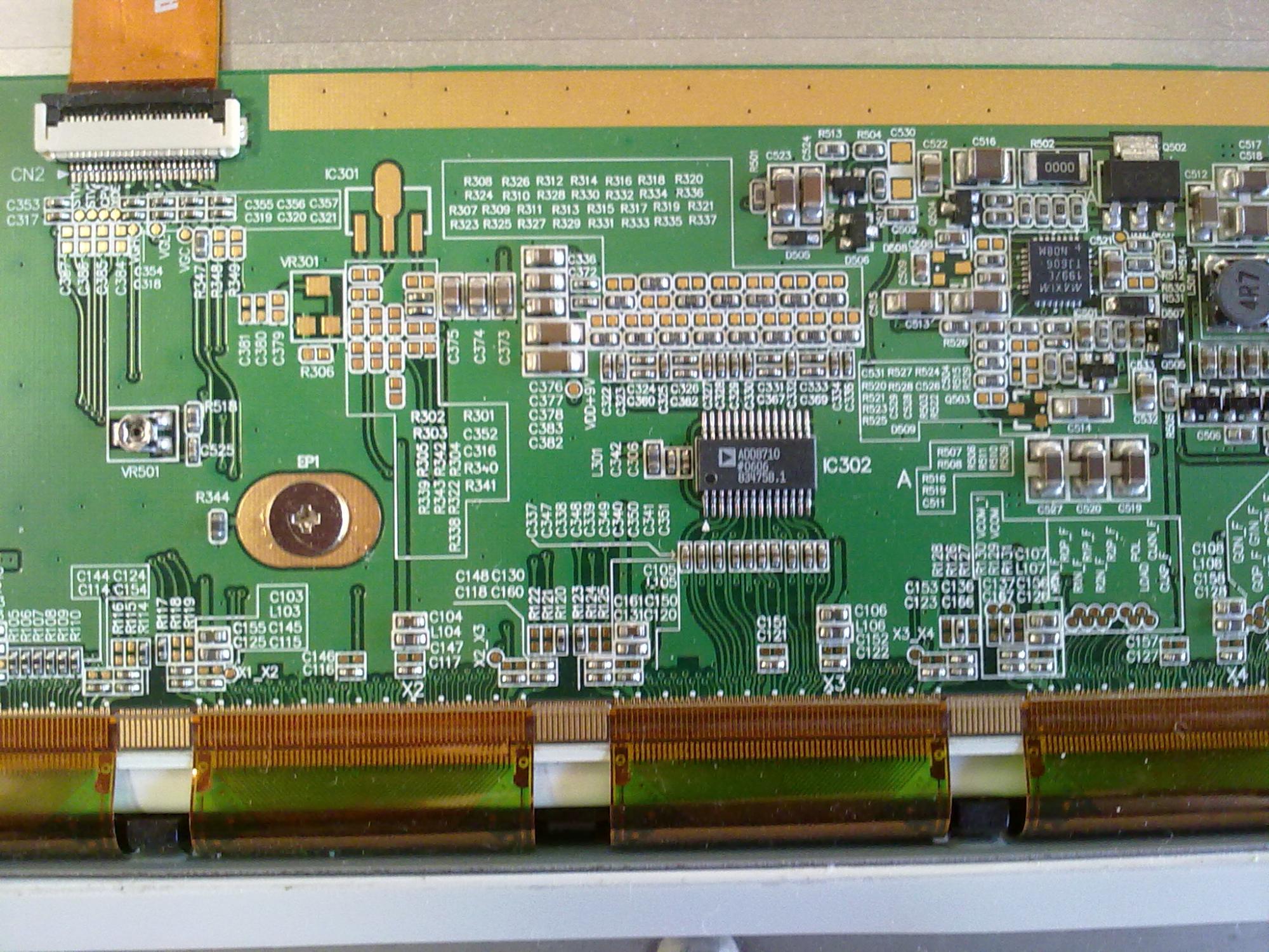

                          #32
                          Bill, you must have good eyes or good screen because these pictures are not so good, I'm going retake them in the sun light.
                          IC501 has the markings Maxim 199/E TJ606 +NDBM, I've searched but not found its data sheet, TJ apparently stands for temprature?
                          On VDD+9V I got 9,5 volts but I have not found and more points with the same details. Must be my eyes!

                            #33
                            IC501 is probably a MAX1997ETJ. The main thing you should be looking for is a missing output voltage.

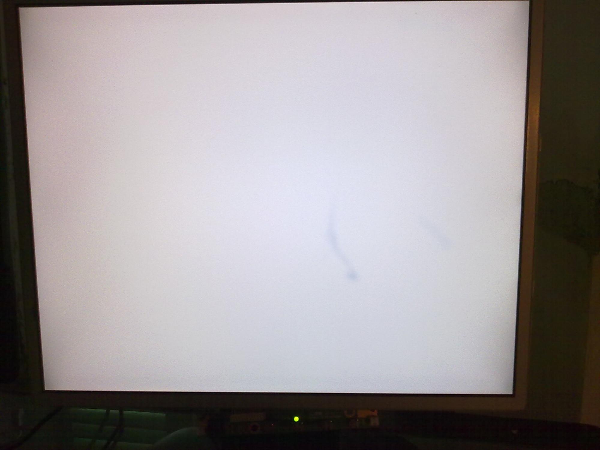

                              #34

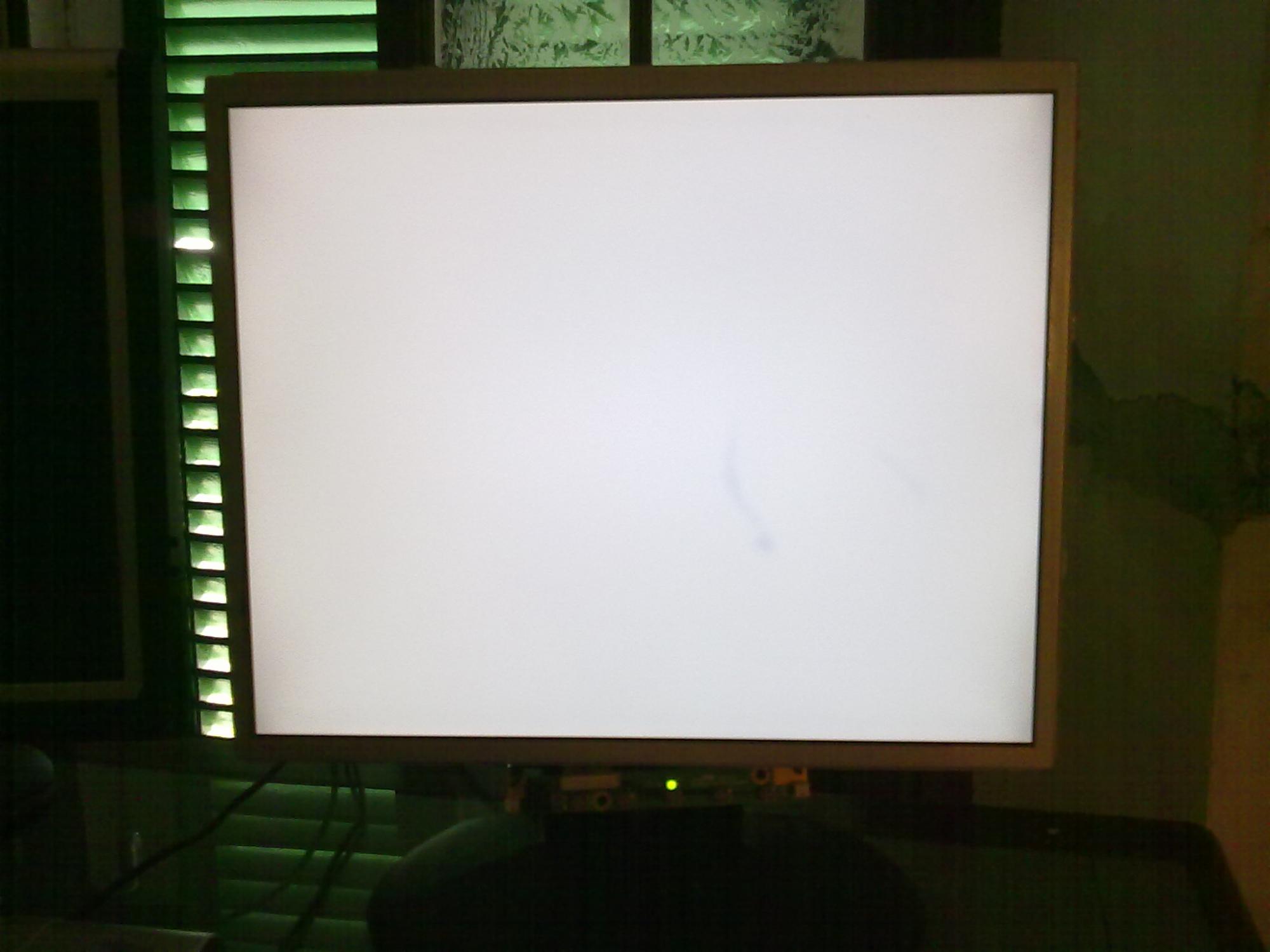

                              Well I done a fair bit of research today and even found a service manual, went through the t-con board checking all locations and then went back for another search and came across this message on BADCAPS Hanns-G HU171D & 171A - Blank (white) screen... both of them.
                              After reading this thread I think I also have a cracked screen, I guess I'll keep the rest for parts for the next dump pick!!
                              I've added a picture of the screen that indicates the marks.

                                #35
                                Excellent troubleshooting so far!
                                Besides the 5v and the boosted 9v VDD+9v rails, there should be two other boosted rails derived from VDD+9v. And yes, those rails can cause a white-screen as well if one is missing or not up to spec.
                                I can't seem to find the test points for those rails (they are usually called VGH and VGL), but I'm almost certain those SOT-23 diodes under the inductor are part of that circuit.
                                Therefore, check the following parts for short-circuit:
                                C501, C502, C503, C510, C506, and C507. Those are located right under the inductor with the "4R7" on top of it. If they are not shorted, check diodes D502, D501, D503, D504, and D506. The arrangement of the diodes in D502, D501 and the others usually looks like this internally
                                https://www.badcaps.net/forum/attach...1&d=1294381123
                                (the anode may be switched with the cathode, though. I'm not sure, so check yours both ways).
                                There should also be another voltage rail going to IC1 - it's usually 1.8v or 3.3v derived from a linear voltage regulator. I don't see a linear regulator, though. Perhaps Q502 does this? It probably wouldn't hurt to check the voltage on it.
                                If you can't find anything wrong, just run the monitor for a few seconds and see if anything on the t-con gets hot. If one of those secondary boosted voltage rails is bad, IC501 and the surrounding components will most likely become hot.

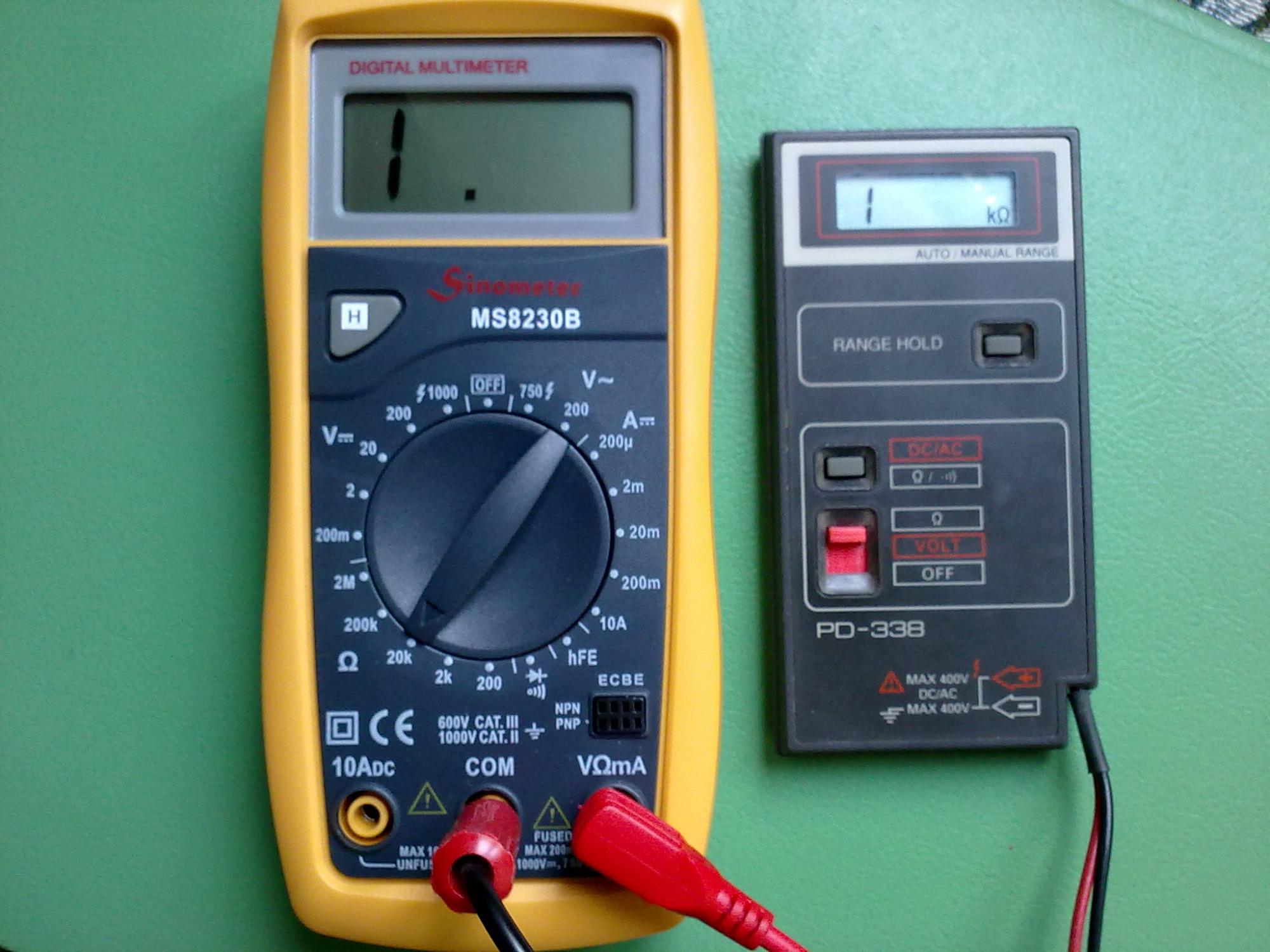

                                        #39
                                        Sorry about about the poor imformation, I forgot mention that the first resistance measurements were done at 200K on this meter in the picture. The measurements to the right were done with the power on for voltage. Yes Q502 read 4.87 volts 2-1, 2-3 2-4=0 (4 between 1 & 3)
                                        This morning I was reading the instructions for diode testing and its advised to use the same setting as contenuity on this tester? I am a bit confused so added that picture for your comments.
                                        Anyway I have retested all the diodes using this setting which infact seems to give a more efficient reading. I take it that these "Q" parts are also diodes?
                                        D501 2-1=550 2-3=550
                                        D502 2-1=550 2-3=550
                                        D503 2-1=236 2-3=236
                                        D504 2-1=235 2-3=234
                                        D505 2-1=758 2-3=758
                                        D506 2-3=231 2-3=1 ?
                                        D507 2-3=165
                                        Q501 2-1=648 2-3=638
                                        Q502 2-1=601 2-3=598 2-4=0
                                        Q503 2-1=734 2-3=1 ?
                                        Q504 2-1=712 2-3=1 ?
                                        Q505 2-1=519 2-3=1 this one might be shorting as the alarm sounds as in contenuity as I start to probe it, however when I use my auto resistance tester I get 2-1=1180
                                        2-3=8.89 A bit confusing?
