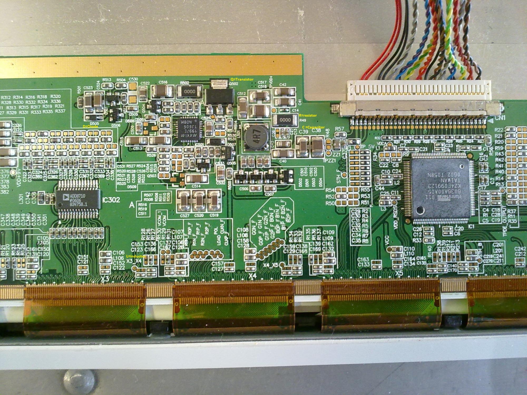

Hi Momaka, thanks for the instructions although its nots so easy to comprehend for someone who has never done it before, anyhow took some more readings and you right about the 200 setting that worked for some of the caps.
I take that at this setting of 200 when I get a reading of 00.6 I've got 0.6 Ohms, right? That means I've got a bunch of low readings!
Anyhow ZZ1 is 00.6, C513 is 00.7, C515 is 10.8, C518 is 00.5 (the Big cap) C13 is 0.502 @2k.

C523, C524, C505 and C508 and a few more no reading 200 or 2K tester reads 1??

Yep its real low 00.8 from both pads to various areas on the board, the only cap that gave a bit more 10.8 was C515.
