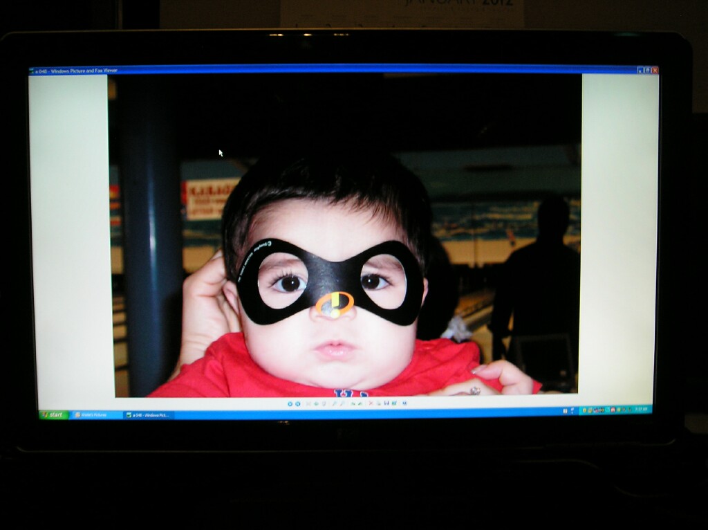

                                      Just as a followup, I FINALLY completed the repair of this monitor. The package was delayed because of the holidays, then it was bent in transit. The replacements arrived a week ago and suddenly 'two seconds to black' appeared while reassembling the LCD panel which irked me mightily. Eventually with a little repositioning wires it went together.
                                      Thanks, Dave
                                      PlainBill
                                      p.s. - No, I don't know who the kid is. But in about 12 years maybe he'll be ready to repair monitors.
                                      pb
