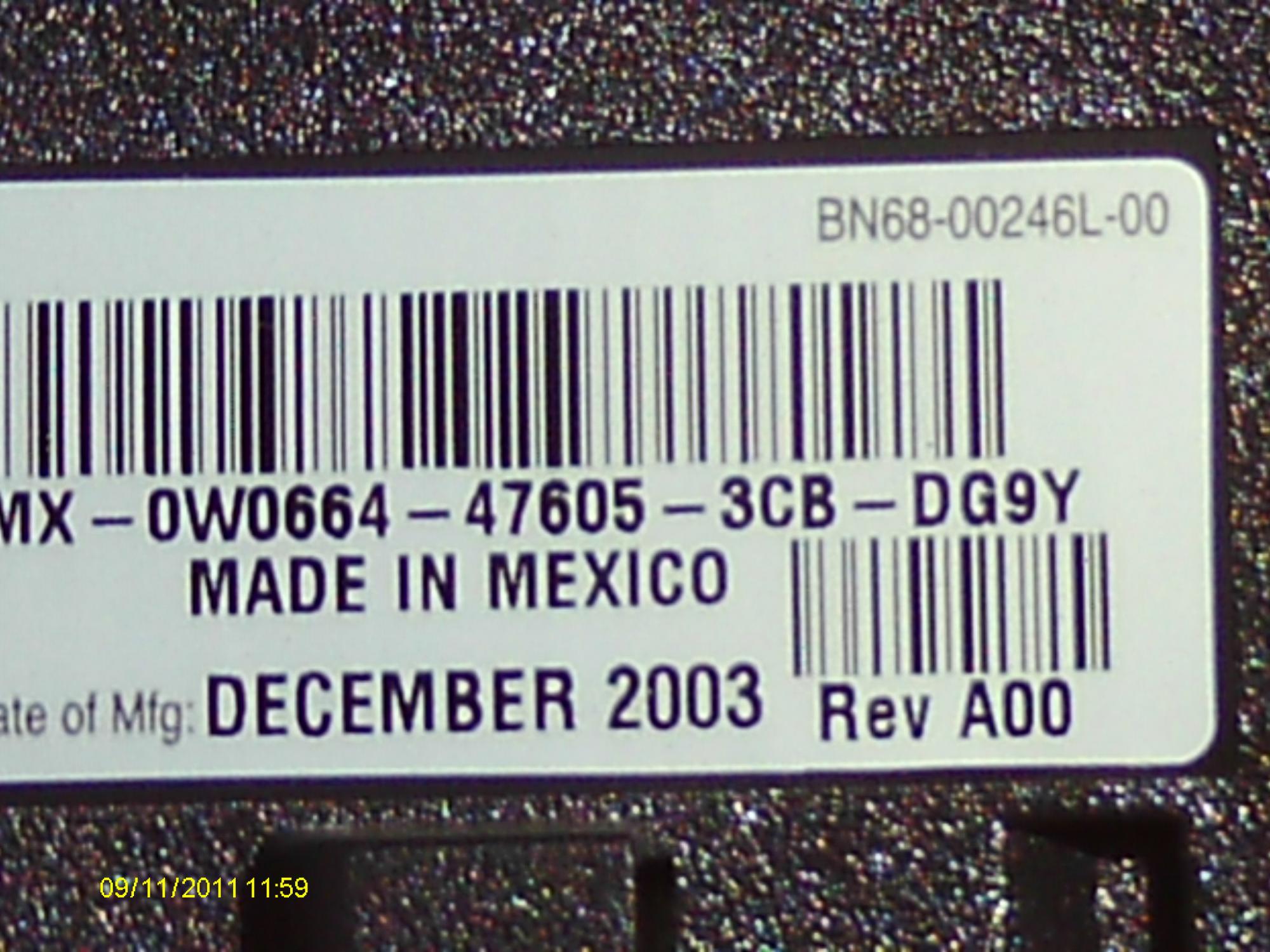

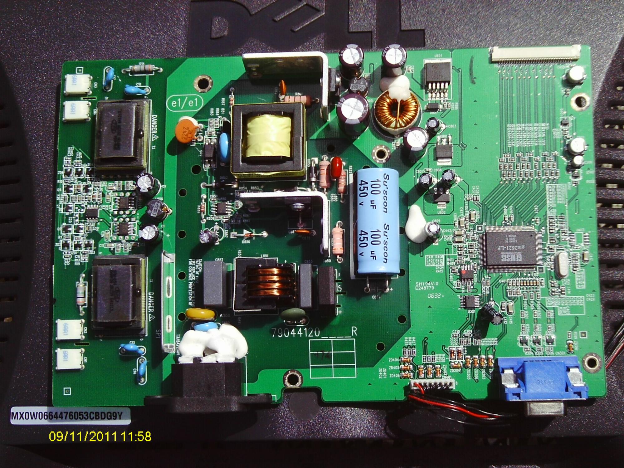

    This the same board as the other post how ever this one has more problem with it

    Need to what is the real value R858
    One R858 is open which is next to U850
    Also every thing work but only if you have two power supplies one 12 volt and one that 4.5 volts then you see it work

      Re: Dell 1703 FPS Board # 79044120 Dead no life #2
      What are the color bands on the resistor?
      PlainBill
        This a SOP chip and I can not read the numbers

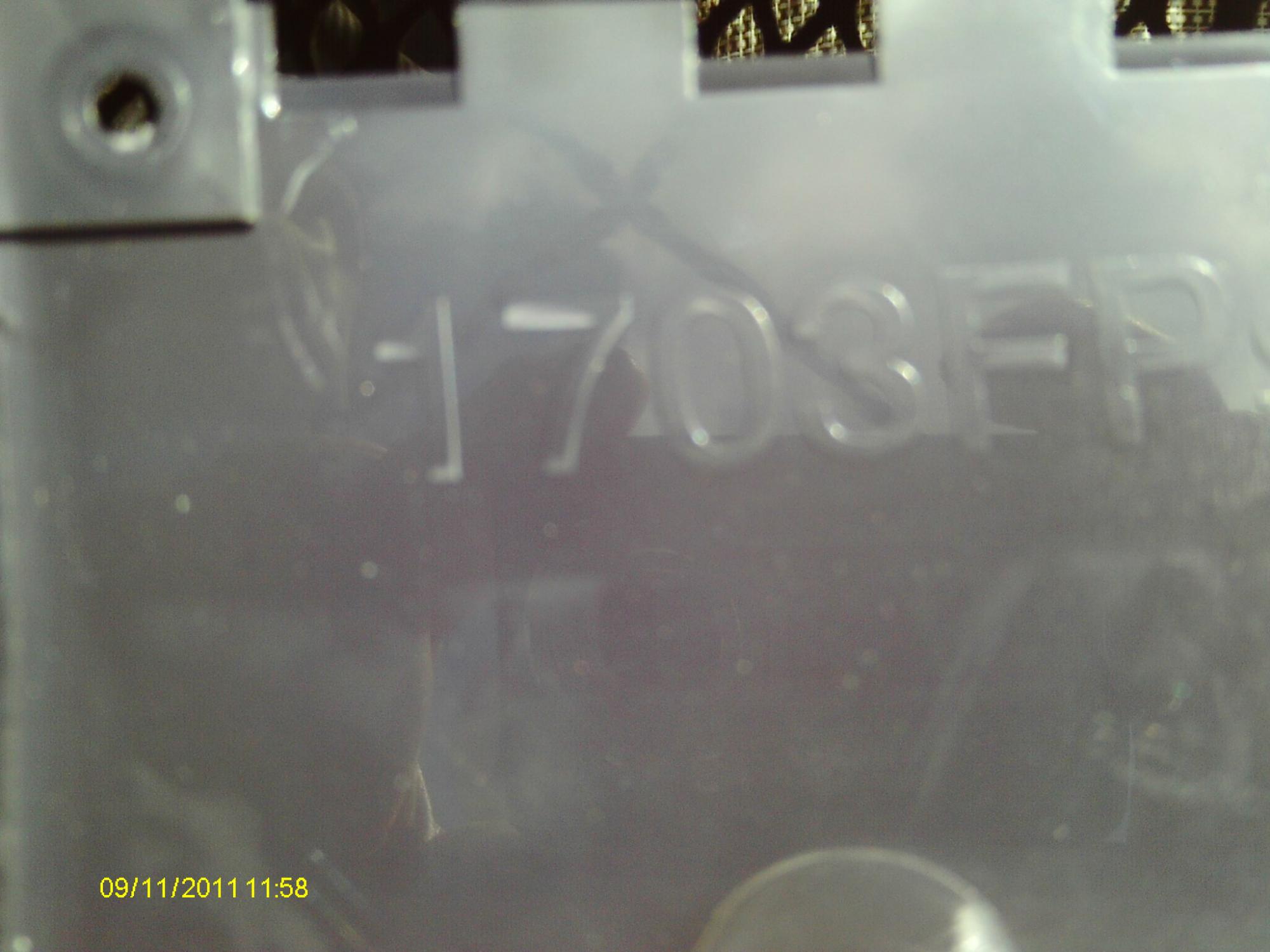

        I made a mistake in model # it is not E1703 it is a E1706
        How ever I have both models
          The only way that I will know for sure what the value of this resister is IF i can get one of these board to work ONE note I do not have any CLF tube that good for these two monitor at this time I do have two other screen that do have good CLF tubes
          Like said in the other post I know this board has more problem I may just use this one for parts IF I do this I will cut the inverter board part off the main part of the board and use it to test CLF tube
            I WILL use this one for parts IF I do this I will cut the inverter board part off the main part of the board and use it to test CLF tube
            It' getting cut apart SOON
