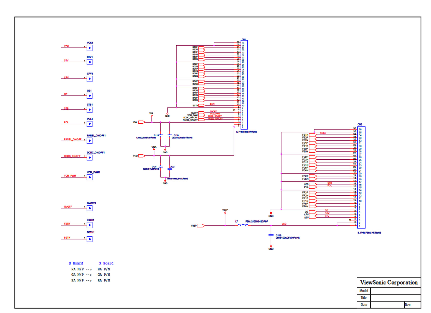

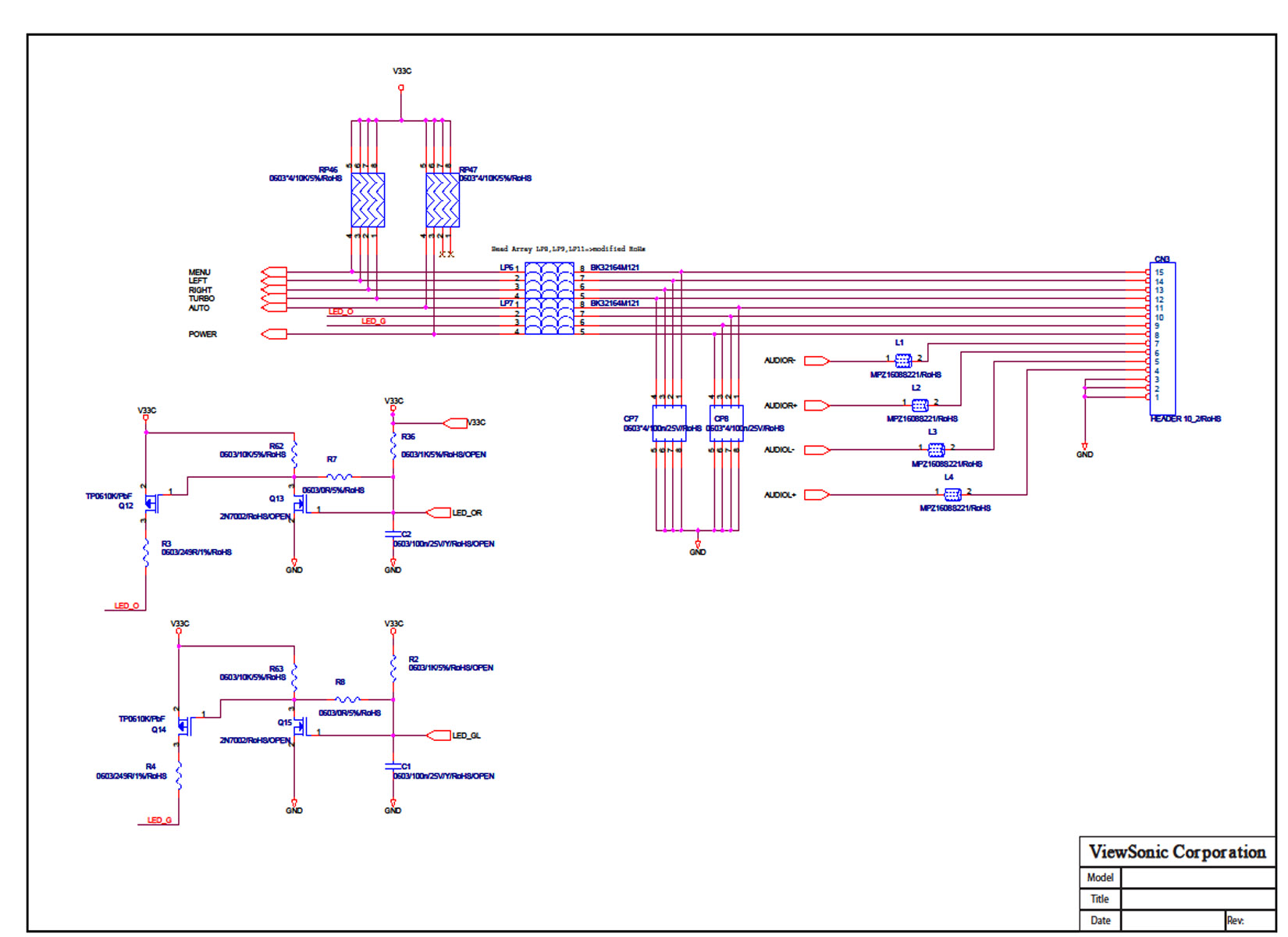

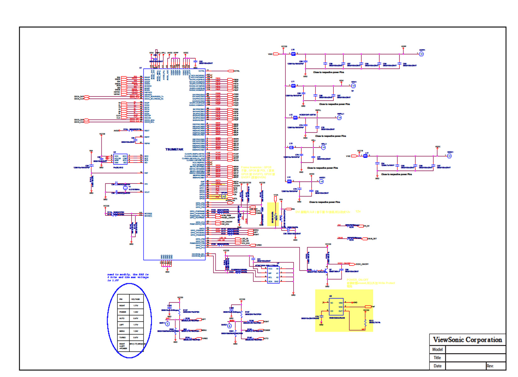

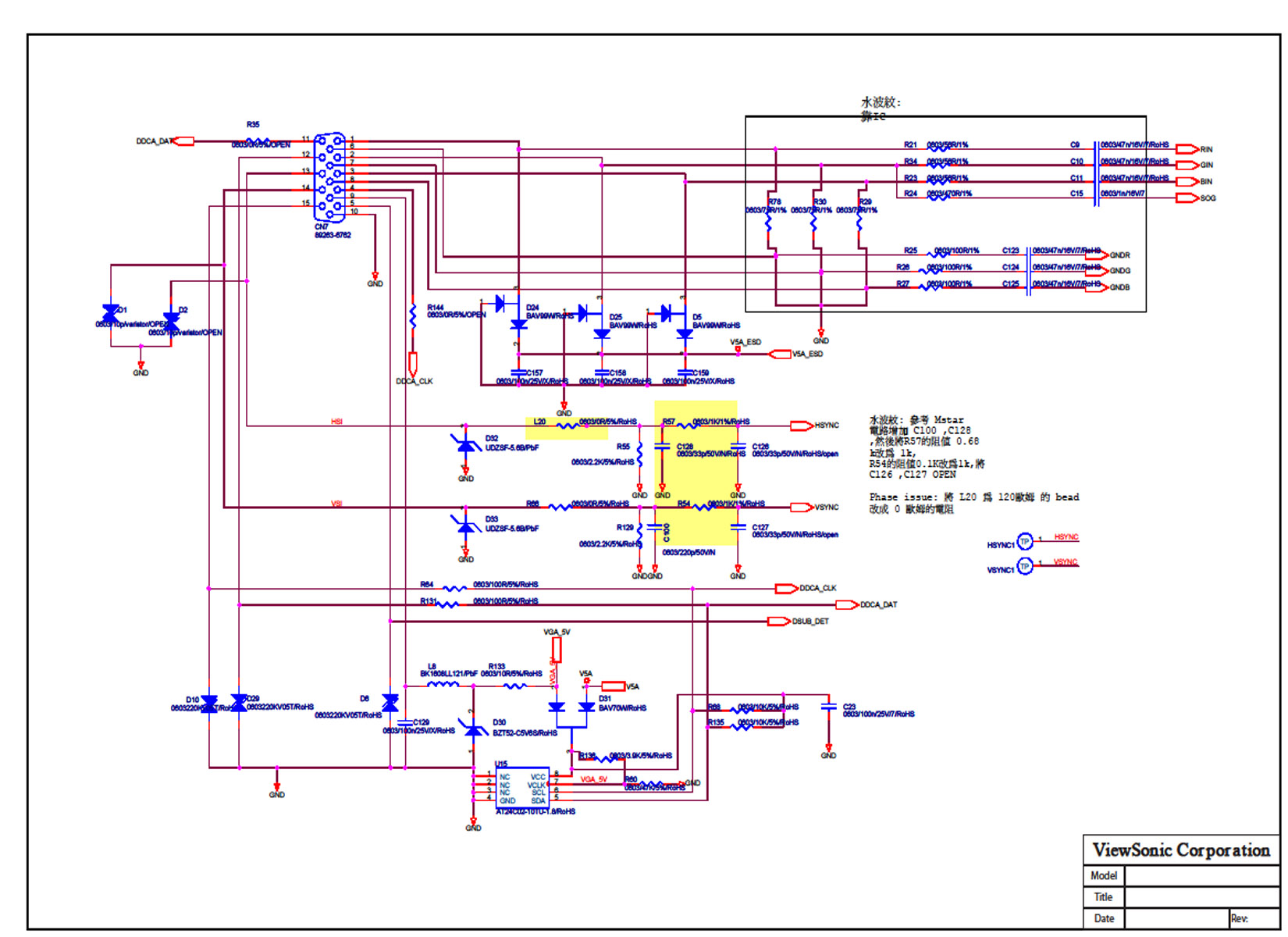

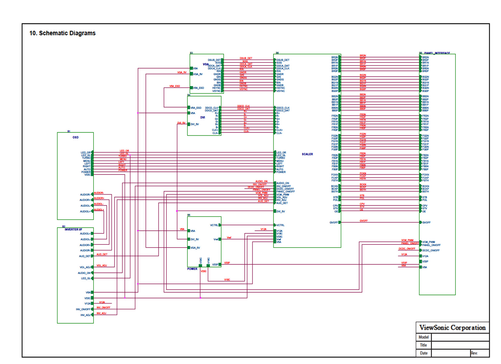

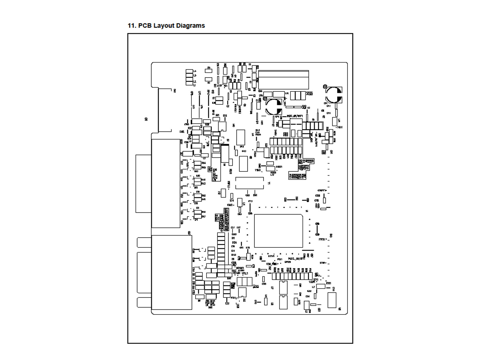

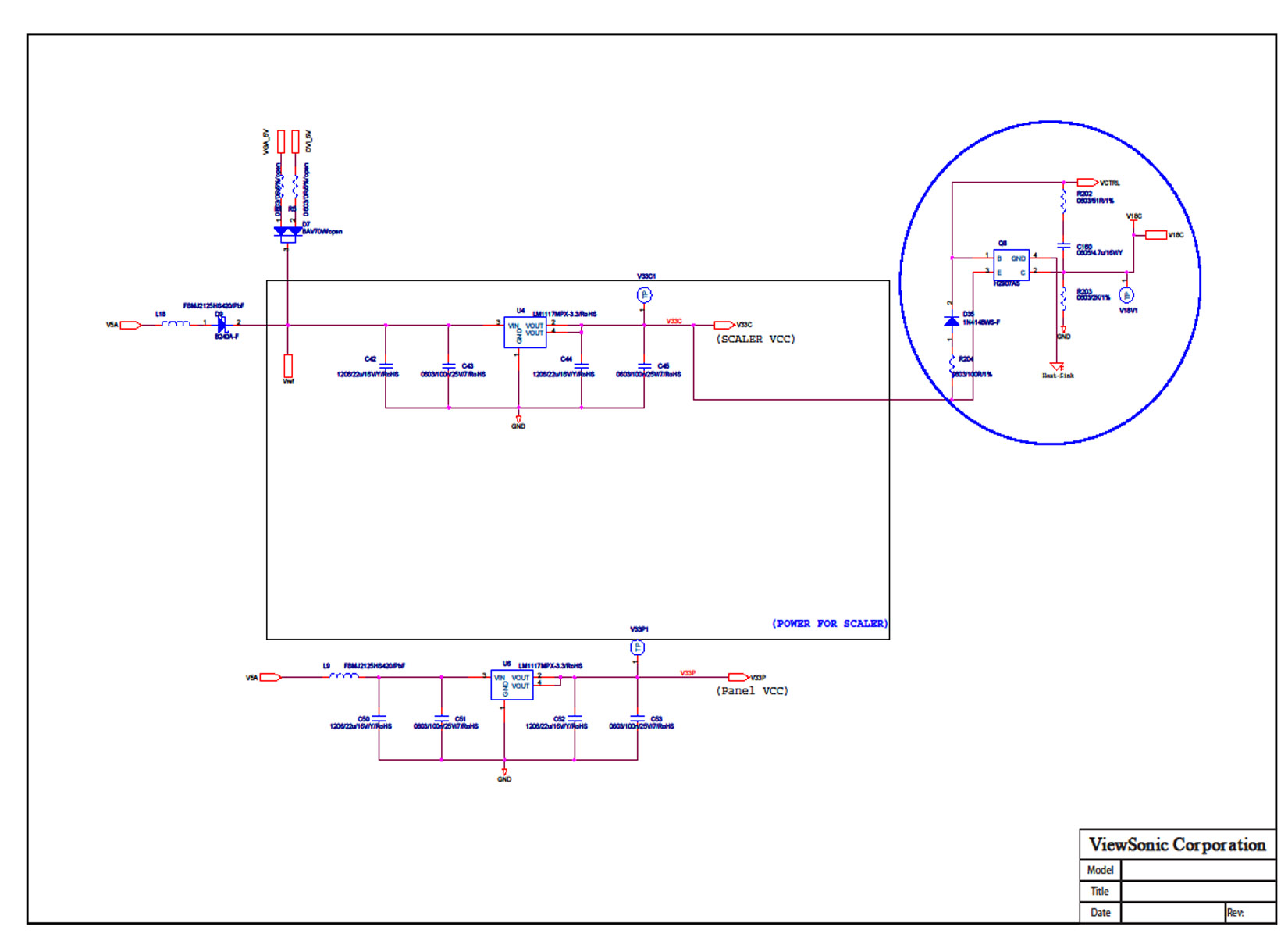

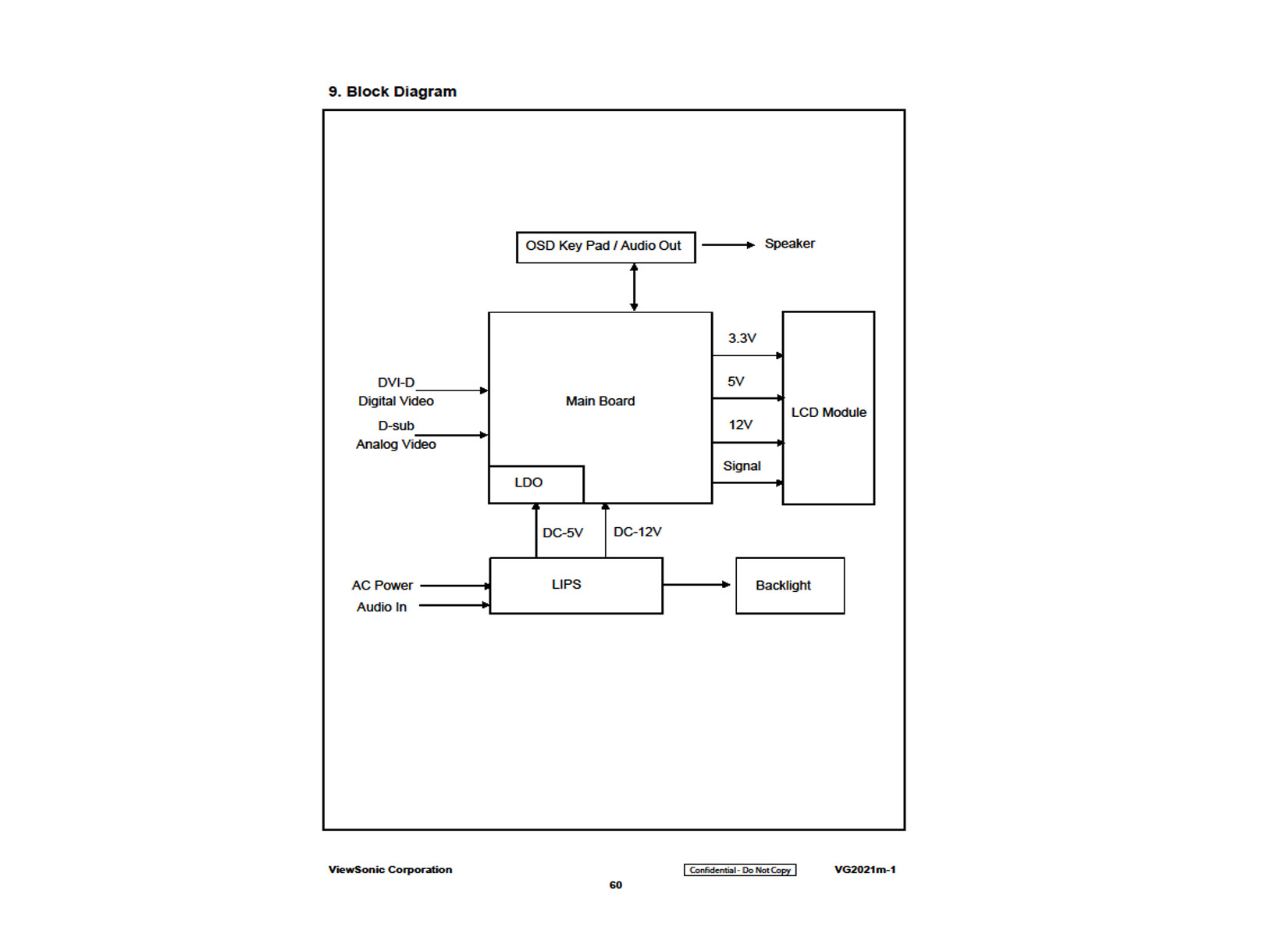

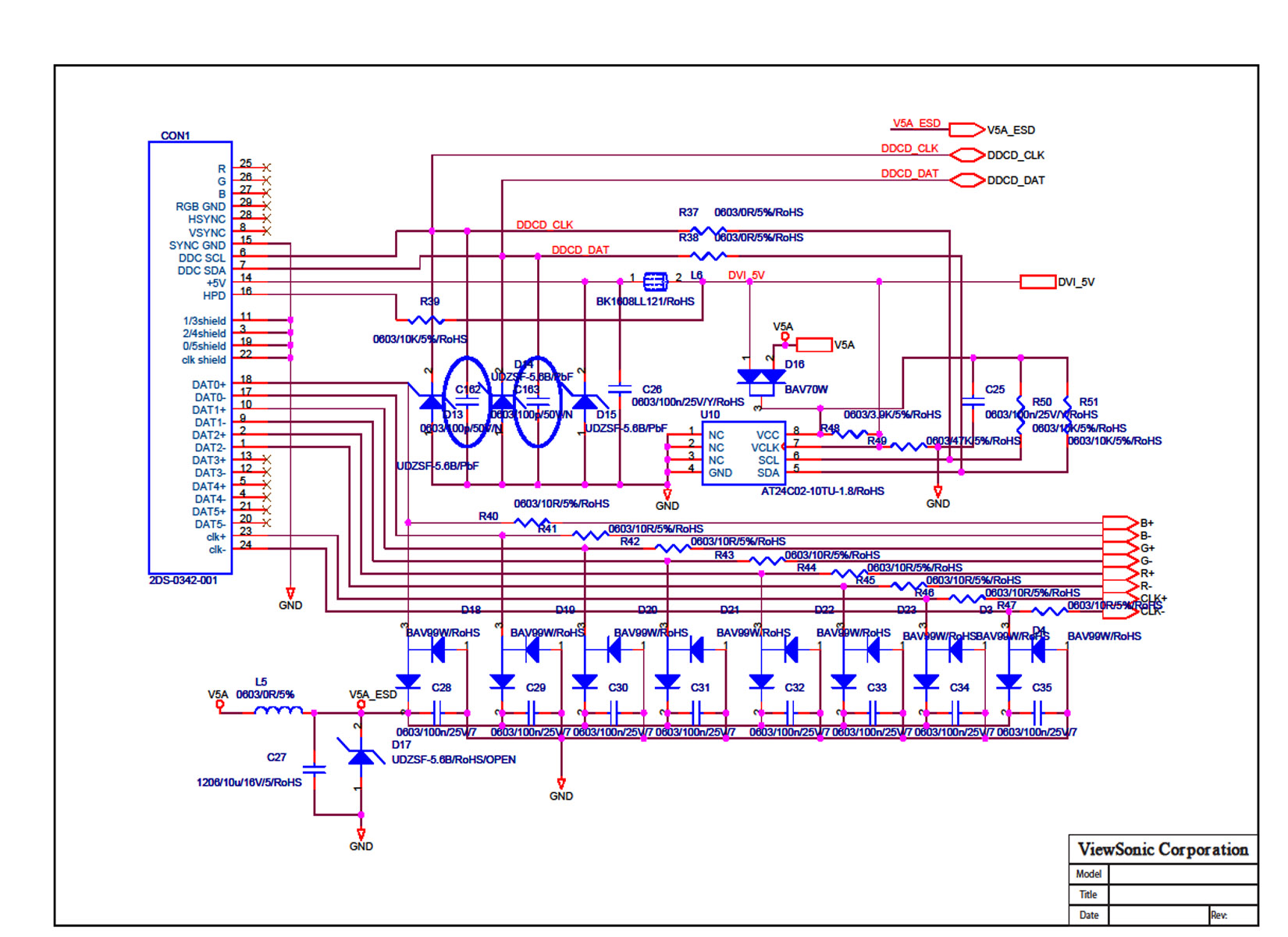

    I finally found the schematics...I have seen some references to eprom reset
    for other models but not for 2021.
    Your submission could not be processed because a security token was missing.
    could not upload them!
    • Medlock
      USN Salmon 573
      • Sep 2011
      • 26
      Re: Moved-Viewsonic VG2021m Blue flashing PLED no image
      Converted from PDF tp JPG

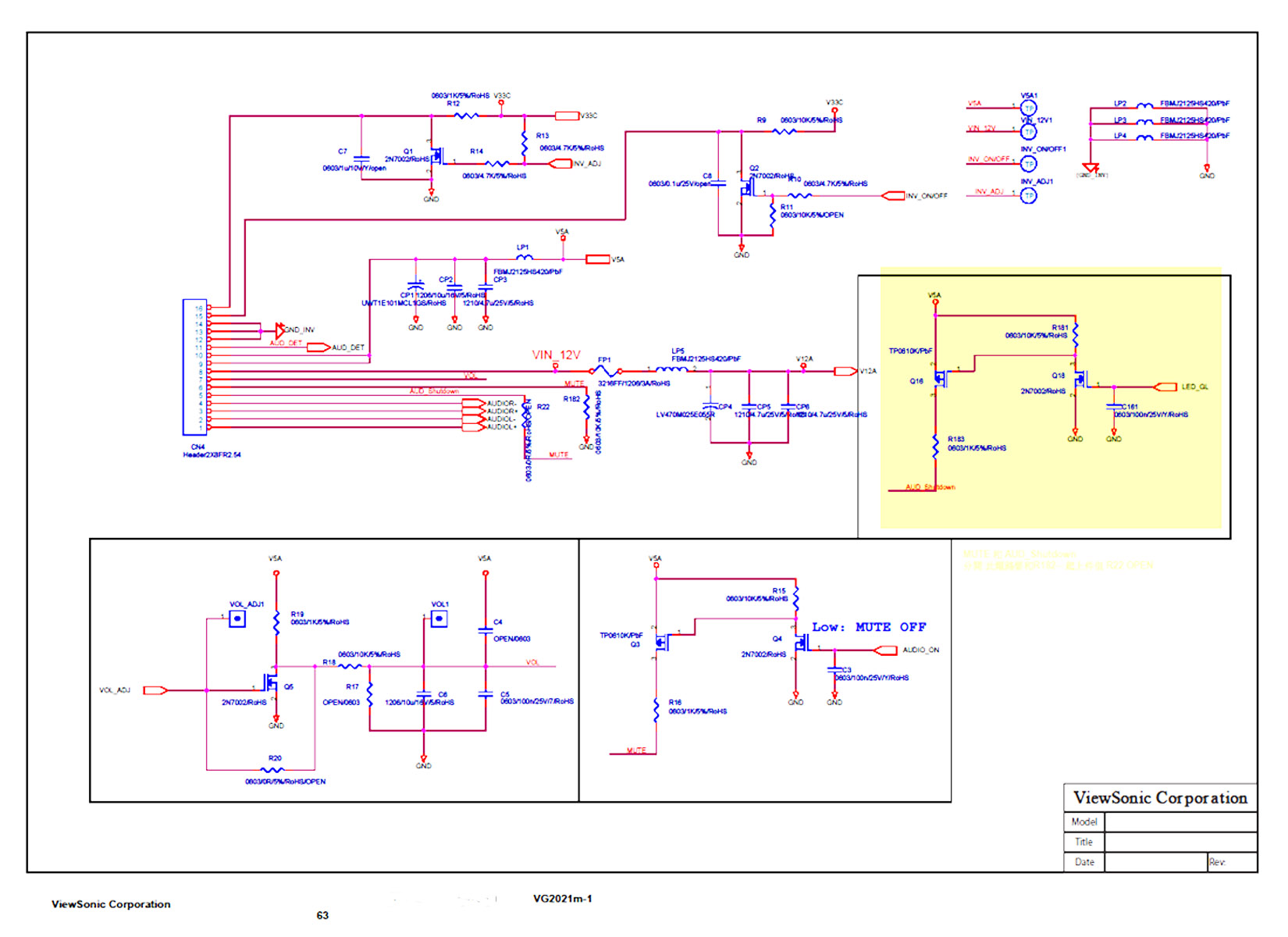

              • alexanna
                • Mar 2010
                • 1346
                Like you suggest I think you have a short causing the U4 to heat up and causing unstable voltages,The new logic/signal board would probably be your best bet.
                On the 16 pin connector bottom row the ENA pin voltage will go high when back lights are requested,You had called it EVA.
                Do you have any schematics of the inverter/PS supply?It may tell us what voltage to expect to see.
                Whatever I do, I consider it a success, if in the end I am breathing, seeing, feeling and hearing!
                • PlainBill
                  • Feb 2009
                  • 7034
                  It's on the first page of the schematic Medlock provided. CN4, pin 15 on the signal card is the inverter On/Off control line. It's pulled high through a 10K resistor tied to the 3.3V rail on the signal card, and pulled to ground by a FET, Q2. Brightness has a similar arrangement.

                  • Medlock
                    USN Salmon 573
                    • Sep 2011
                    • 26
                    #29
                    Morning everyone
                    ok today I briefly jumped U6's 3.2 volts to the EVA (thats the actual letters) pin and tada BACKLIGHTS!
                    So I am going to go ahead and get the board. I traced the short to the main chip on the signal PCB. I think I lost the PCB to the power annomaly we had recently, where we didn't lose power completely but we had a low voltage situation for about 2 hours. I had run around the house turning off all he surge protectors but forgot that the monitor was on a separate one all to itself.
                    I will return to update and to hopefully close out this thread. Thank you all for your help and I will be sure to come back if I need any help with other things. Also I will spread the word to others.
