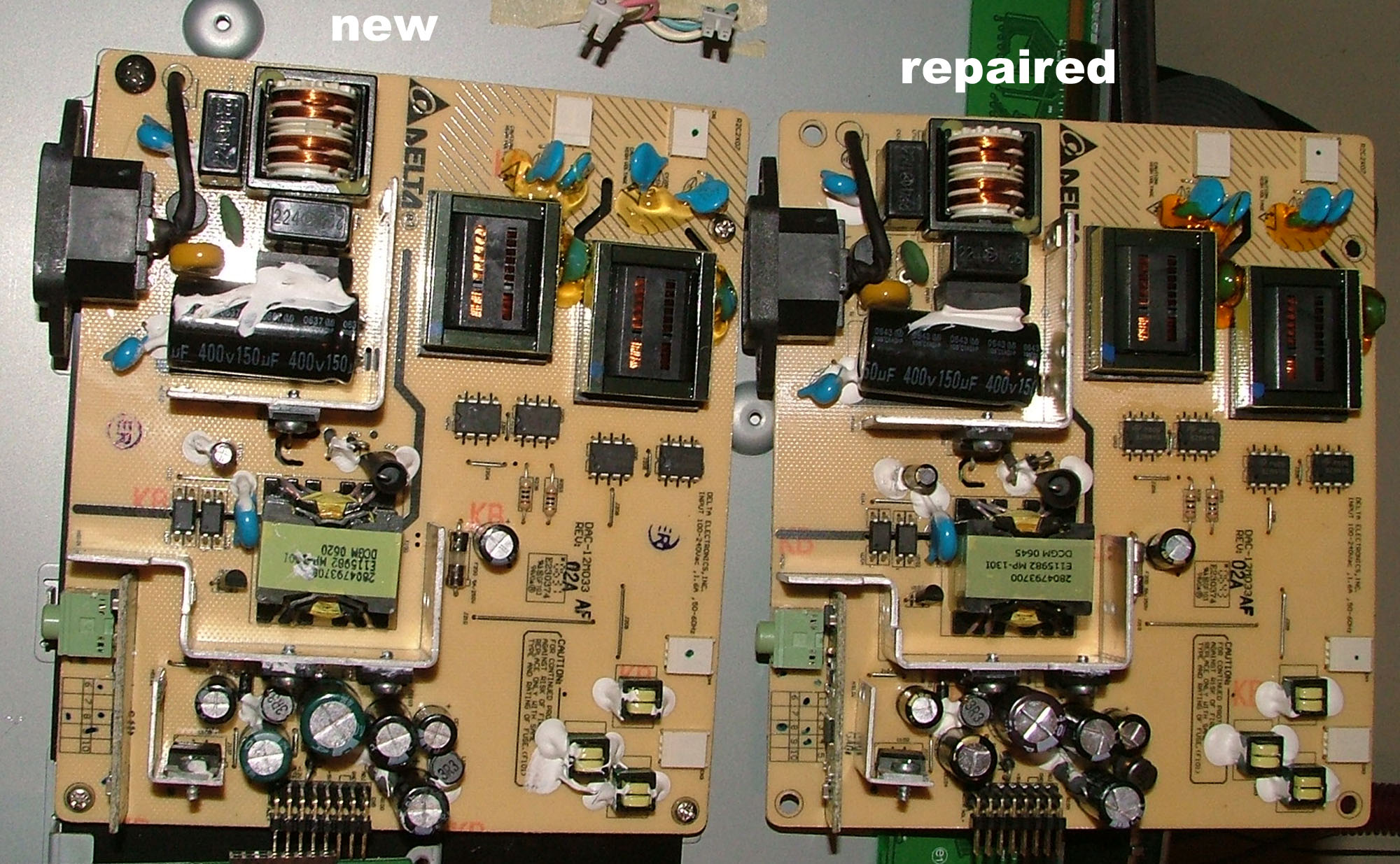

    Ok Folks This is where i really could use your help.
    After purchasing the cap kit from the above mentioned co., They did not solve my problem, the folks there suggested that you all were the people to contact if I needed experienced help in the matters of LCD monitors.
    Ok as you have read I replaced all the caps in the first power board and was left with the same problem. I purchased a complete board and the problem remains. The symptoms are as follows:
    With the first power board before replacing any caps
    Amber standby went to flashing dim blue power LED when coming out of standby.
    No OSD No image when connected to computer.
    After replacing all caps (except large 150uf 400v):
    Same flashing blue LED except it was brighter
    Blue LED is on IMMEDIATLY when power plug is inserted
    Chirping was heard at the component (coinsiding with flash of LED) marked
    2804793700
    E115982 MP-1301
    DCGM 0645
    After inserting the new power board:
    Same Blue flashing bright LED Immediatly when plugging in power cord(sigh)
    Audible popping sound coming from internal speakers coinsiding with flash of LED (cannot hear the chirp)\No OSD No image.
    I did not have the protective metal cages that cover the boards on at this time. Just the boards mounted with all screws inserted and monitor supported by a wooden holder. -2 1x1's horizontal to surface of bench.
    Thats it guys, other than disconnecting all connectors and reinserting them and checking all PCB's for anything obvious thats all I can think of doing.
    Pictures can be submitted if need be, but I think they would be of little use at this point. Let me know if you would prefer to see them.
    power PCB Part # 12m033af rev 02a on both boards
    Chi Mei LCD Model A201P1
    Viewsonic VG2021m Bought 2005 Very light work as a Digital graphics and video editing computers monitor. Always off when not in use.
    Again Thanks for your time
    Joe

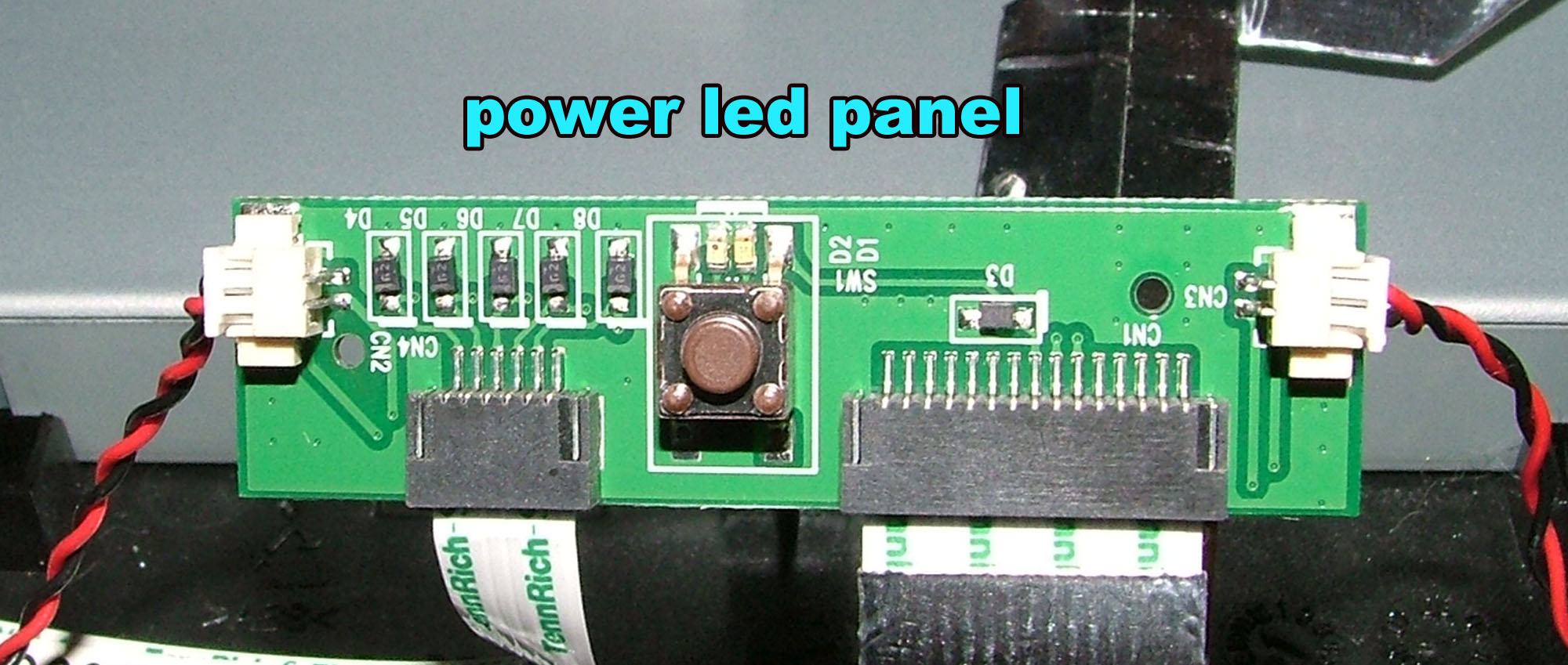

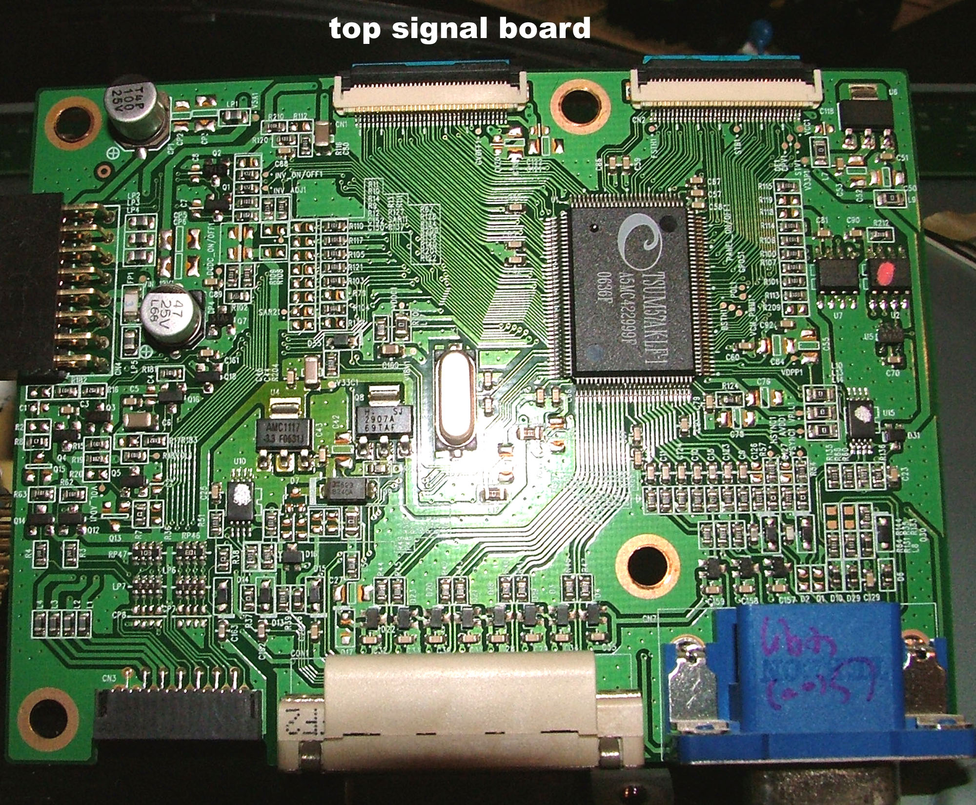

    I would start by removing the Ribbon cable from signal board to the LCD panel,Dose the behavior of the PLED change?
    Next unplug the Front panel switch from the signal board; you will not have a front PLED but do you get any indication that the back lights trying to come on.

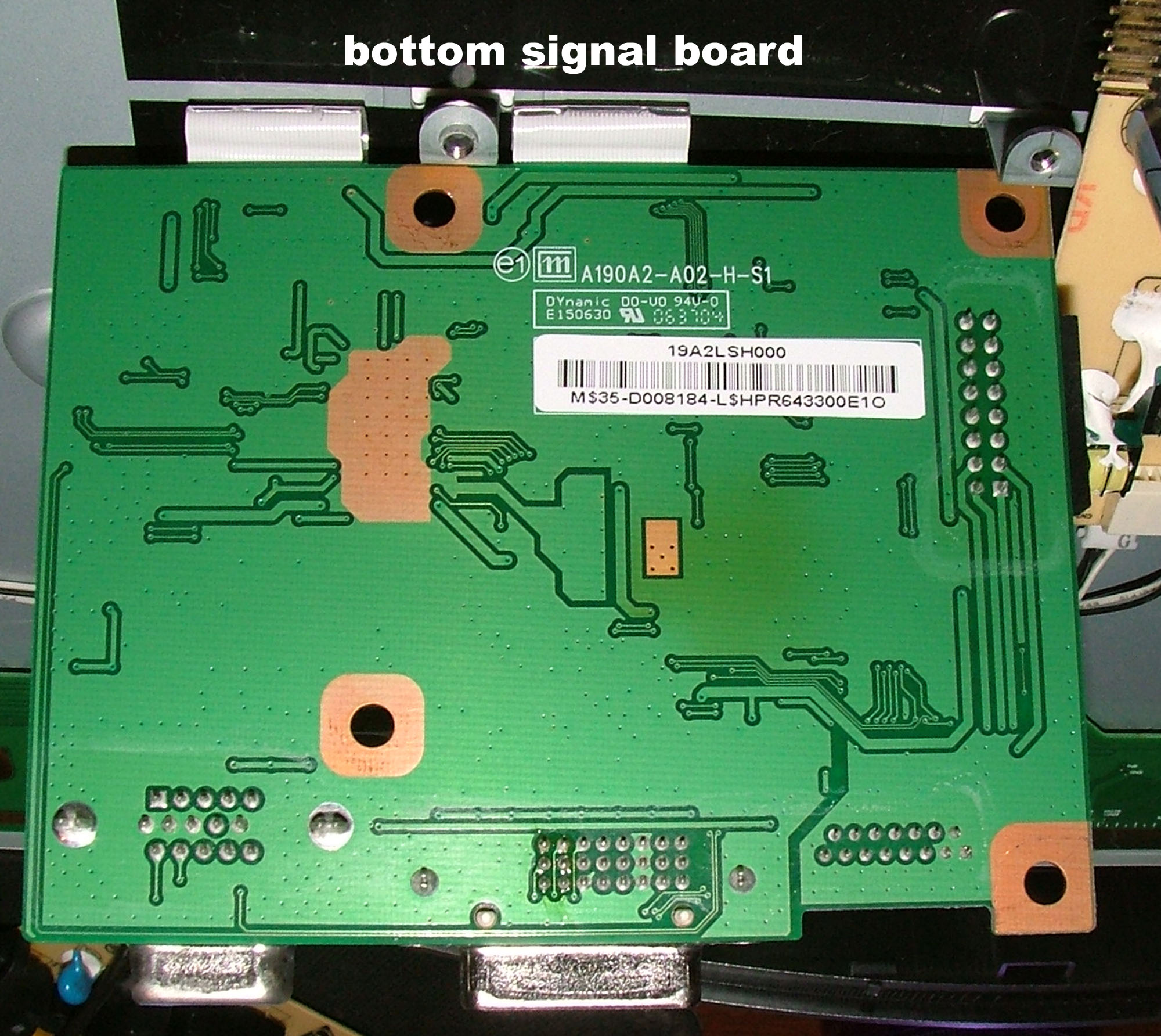

    Or there may be a problem with the signal board.
    Pictures of the signal board will be needed, close up and in focus as close to 2000x2000 pixels as possible showing the entire board, using managed attachments.

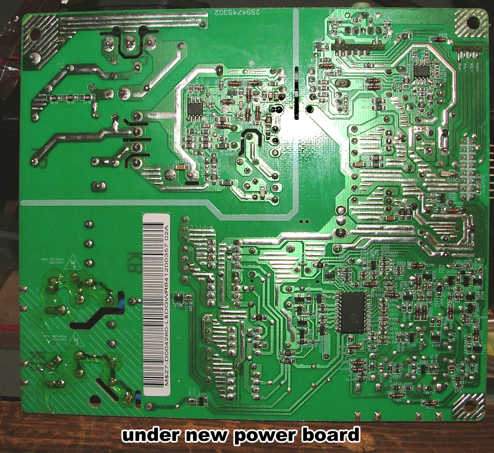

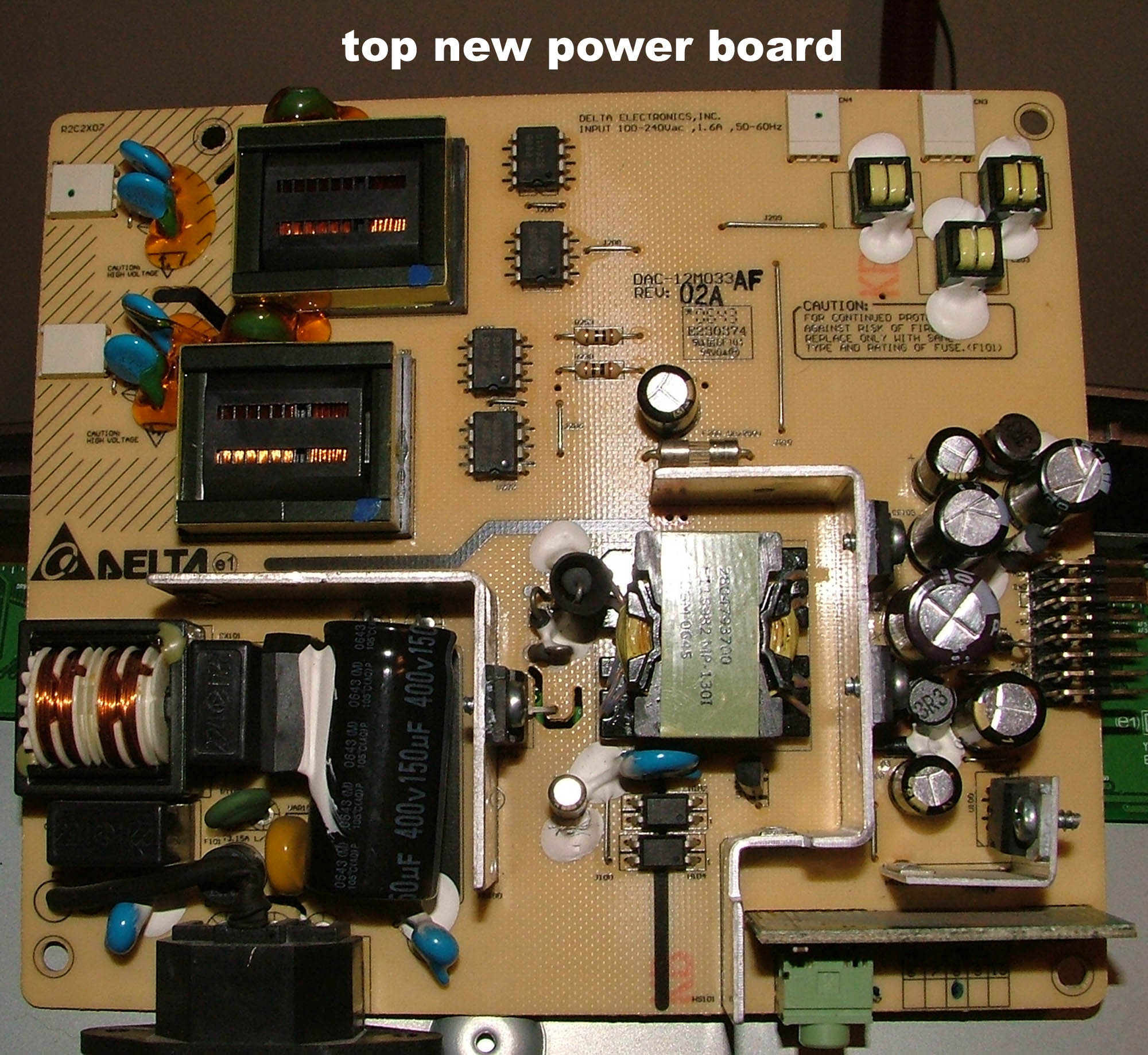

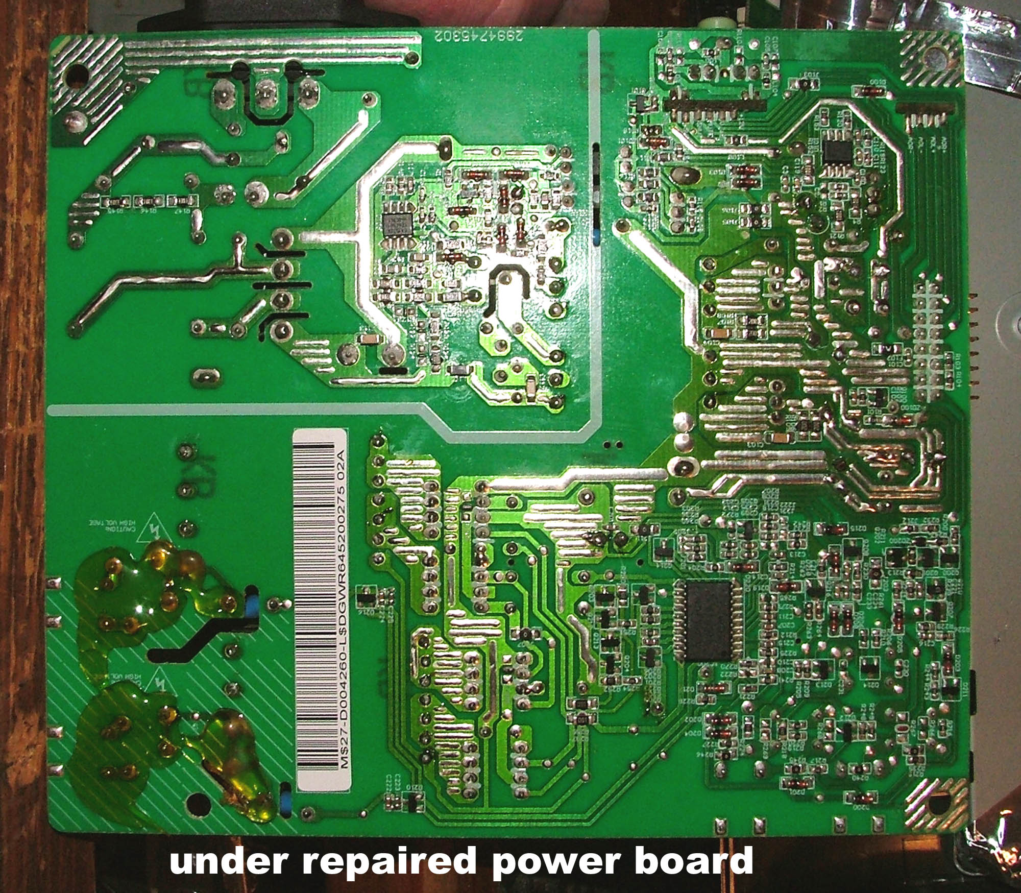

      Ok
      No changes in symptoms after doing the suggestions by Alexanna.
      Pics as follows:

          It probably would be a good idea to verify some voltages on the new power supply
          With everything hooked up and a signal going to the monitor, verify you have 12V and 5V at the 16 pin connector from the power supply to the signal card.
          Is fuse FP1 good? This is on the signal board next to the 16 pin connector
          Also measure the voltage on the pins of U4 it looks like it's a 3.3 voltage regulator.
          What numbers are stamped on U6? Upper right top of the signal card.

            Hi Alexanna thanks for your responce.
            Pins at the 18 pin for 5v and 12v are 4.9 and 11.8 respectivly.
            Fuse is good
            U6 is the same as U4
            U4----2.7
            --------I
            --I-----I-----I
            -G----2.7---4.6
            U6----3.2
            --------I
            --I-----I-----I
            -G----3.2---4.9
            Q8----1.4
            --------I
            --I-----I-----I
            -G----1.4---2.7
            note: on the top pins of U4 & U6 (pin4?) there was fluctuation of .1 volt coinsiding with flash of PLED.

                I don't know either,after we get through this page it wont be that bad.
                The U components are low drop out voltage regulators with 1% tolerance, the tab and pin 2 are connected together internally.
                U4 has a lower input than U6,But the output 3.3 volts is way below the 1% tolerance.
                The data sheet I looked at listed the input minimum at 4.8 volts, and you are reading 4.6 volts on U4
                So the question becomes is the problem with the low voltage output of U4 caused by low input voltage to it, or a faulty U4 regulator. I honestly do not know. Whenever I have had a voltage regulator fail it has been noticeably hotter.
                I would check to make sure any of the ceramic smd caps around U4 don't show an extremely low resistance. If those check out OK,I would suspect the regulator as being the problem. The other option would be try to trace the input voltage of U4 and see if you can find where you're dropping the voltage.

                  I noticed on the back side of the signal boards PCB a discoloration in and around the regs, due to excessive heat I would think. Funny thing is that if you look at it through plain sight it is not as noticable. I will begin the trace back and see where the drop originates.
                  thanks
                  • Medlock
                    USN Salmon 573
                    • Sep 2011
                    • 26
                    Re: Moved-Viewsonic VG2021m Blue flashing PLED no image
                    Ok
                    The voltages leading from the 5v pin that feeds U4 and U6 are steady. The caps in and around problem area are of decent ohmage. Output of U6 is in spec and very steady. However U4's output as you said is out of spec and further is fluctuating irratic. +/- 1.2-.5 volts. This voltage feeds Q8 and therfore causes flucutation in its output also. This fluctuation is obviously persistent throughout all circuits supplied by these outputs. U4 does seem to be of higher temp than U6.

                        Greetings Alexanna,
                        I have replaced the regulator and the voltages are now correct. 4.98 on the input 3.28 on the output. Voltages are steady. However nothing has changed. The PLED is still flashing has soon as the power plug in connected. No backlight, no OSD, and of course No image when hooked up to computer.
                        Should I not have at least back light as it seems they are powered from the invert/power board?
                        Is there, as in the instance of a motherboard, a signal to the power board that voltages are correct and it is OK to power up? I said 5v in my earlier post but could it be the 3.3v signal instead? If so which pin ID would that be on the 18pin connector and what voltage should I be looking for?
                        I am am going to 'fix' the images that I posted momentarily, as it seems I have offended the staff. Purely ignorance on my part as this media for instruction is new to me,or maybe its just because I'm ex-Navy?.ha!. I started a myspace page the day the network became passe',,lol
