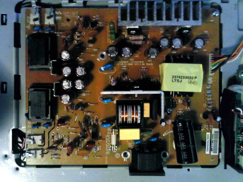

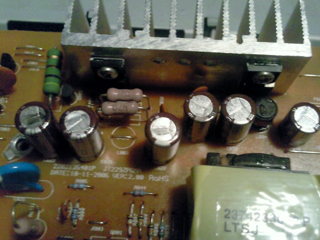

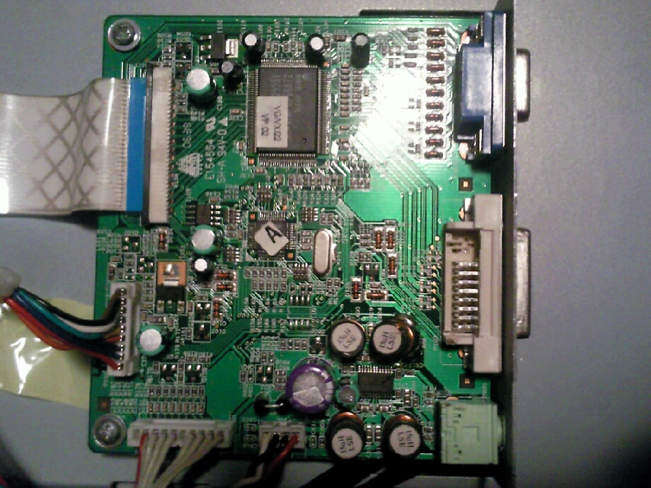

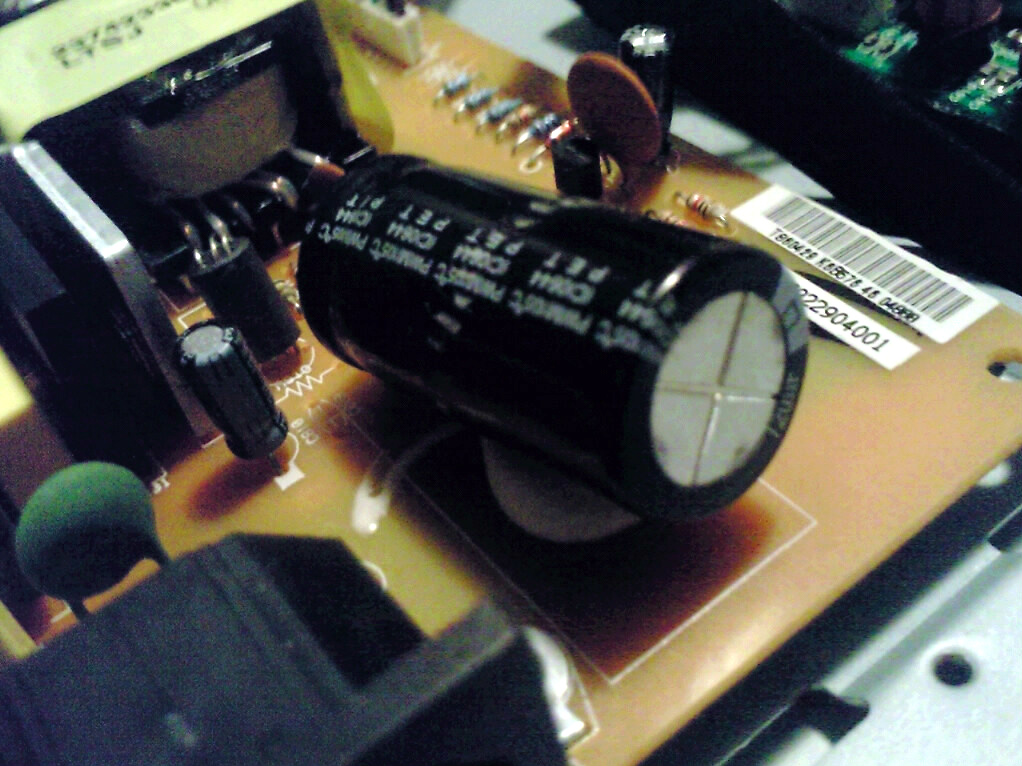

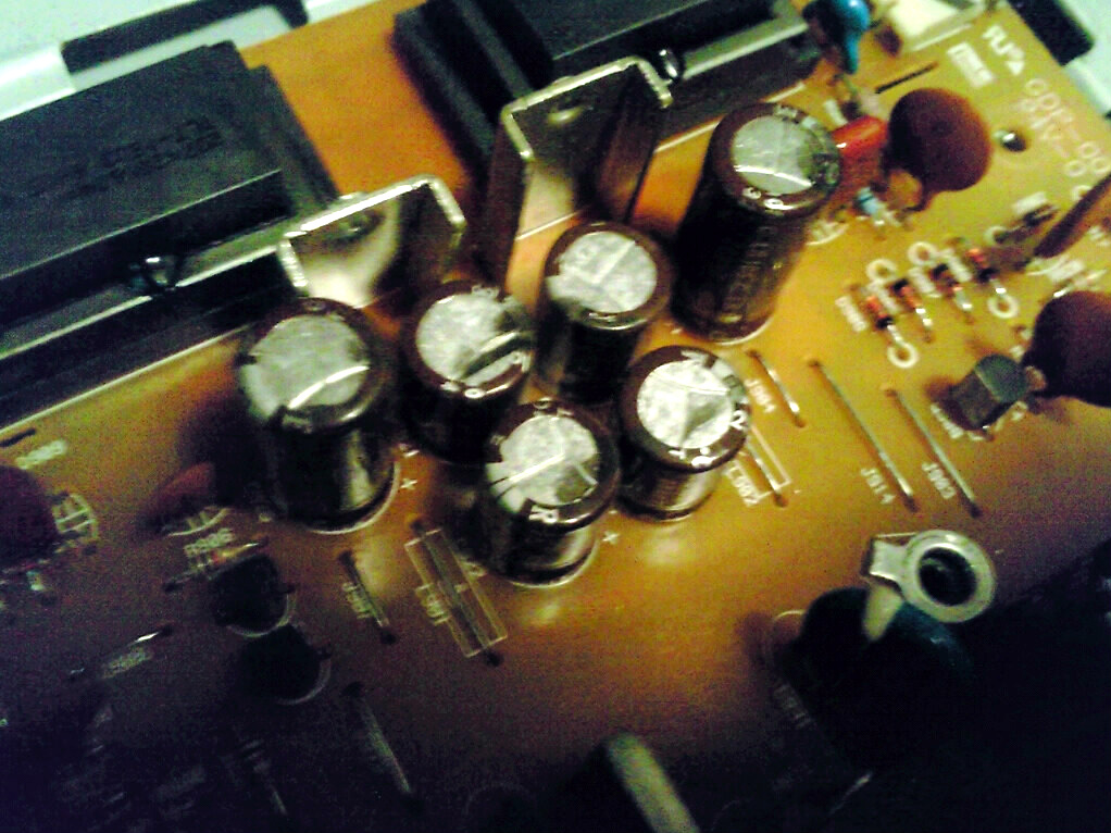

      Hey, sorry to jack a post here, but I am having the EXACT same issue here.
      I have a November 2006 Viewsonic 22" LCD model VX2235WM-3; opened it up, no bulging capacitors, no leaks, no burns, no bad solder joints. (the caps are HERMEI, not the common capXcons that are known to fail)
      Mine will turn on cold and stay on for a few hours, after that the screen will go black, the blue power light staying on. I also know it is not an issue with the back-light, I can see the "washed out" look to the screen showing its lit and not completely black, and also tried the flashlight trick, showing its just black...I can often times see a white-ish line flicker every couple minutes or so on the screen, proving more so it is not a back-light issue.
      I can also press the blue button, turning it off (I can also see the screen go darker) and then press it 10 seconds later to have it work for another 3-5 minutes, and then it goes back to a blank screen; I am able to repeat this process as the OP said, only mine will never stay on just fine again, it will continue the 3-5min/10 sec./3-5min. process.
      I'll post some pics of mine to help out, I am pretty dumbfounded to find the problem with with no blown cap issues etc.

          Guys, your monitor(s) is like 5+/6+ years old and those hermer/capxon caps could've reached the end of their useful life ... Caps can fail without a sign of failure ... My guess is that the caps (or maybe the schottky) on your lcd may be almost at the edge that when warmed up, they sputter on high loads ... then again, I could be entirely off the mark ...
          Time to decide on the caps, to replace or not to replace ... that's your call ...

            As I've said repeatedly, I have a life away from this forum. It may not be much of a life, but it's what I have. When you posted I was working on an LCD TV. Sorry if reality disappoints you.
            Since you DID wait a week, I'll make a few suggestions. Simple answers: recap the power supply, as Utni3d said the caps could have died. If that doesn't work, recap the signal board. If that still doesn't fix it, replace the signal board.
            A more complex approach: There are two LDO regulators on the signal board. Check the output voltages. If the voltage stays constant, go to the simple answers.

                caps in the psu are a common problem in this model use good versions with low esr i use panasonic fm range or sim
