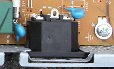

                      ^^ that's somebody else's image. If you look at the bottom part of power supply, you will see two black rubber screw-like things (right below red circle). There is black plastic clip or something around that area that is gripping the cage.. anybody come across something like that?
                        Re: Dell 2007wfp not working - no power
                        Do not mess with those!
                        Are there any screws that go through the cadge into the power plug,look on either side where you plug in the cord.

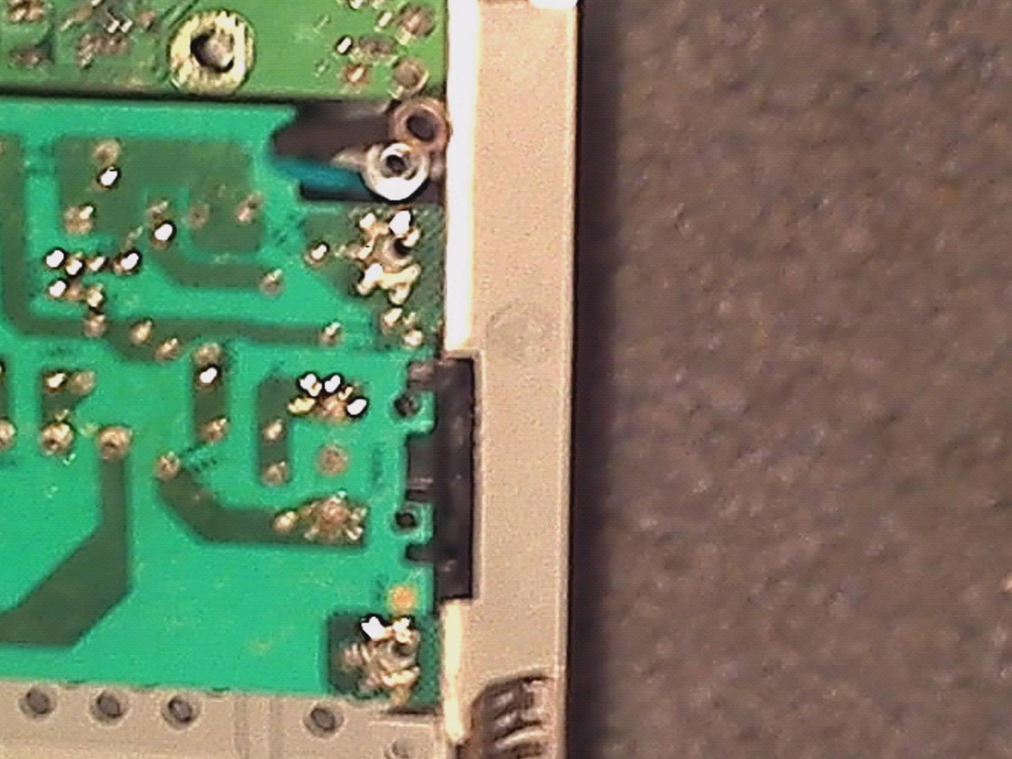

                            It would really help to post pictures of your monitor.
                            Camera doesn't matter, light does. Even a $20.00 barbie cam can take a good enough photo with proper light.
                            36 Monitors, 3 TVs, 4 Laptops, 1 motherboard, 1 Printer, 1 iMac, 2 hard drive docks and one IP Phone repaired so far....

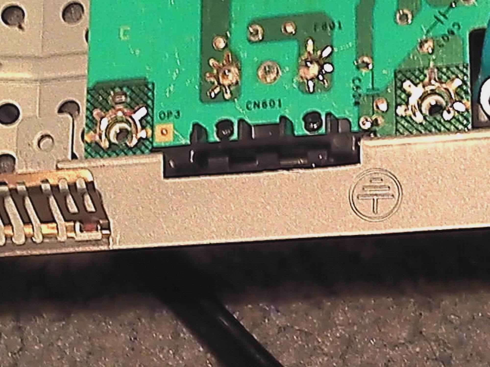

                              here are pictures... do you see that black clip?

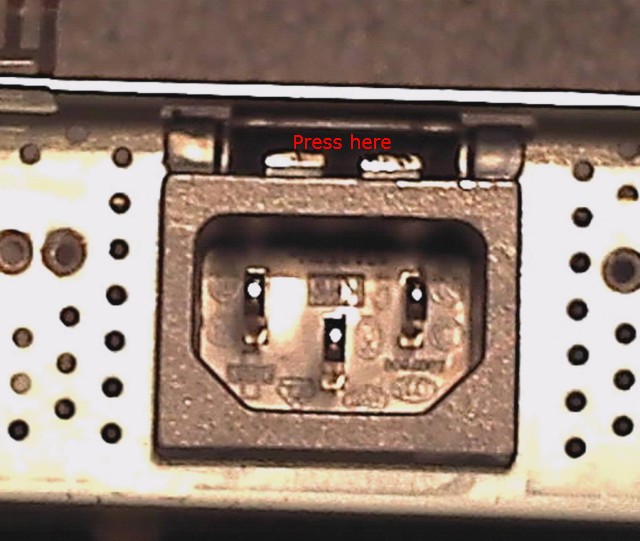

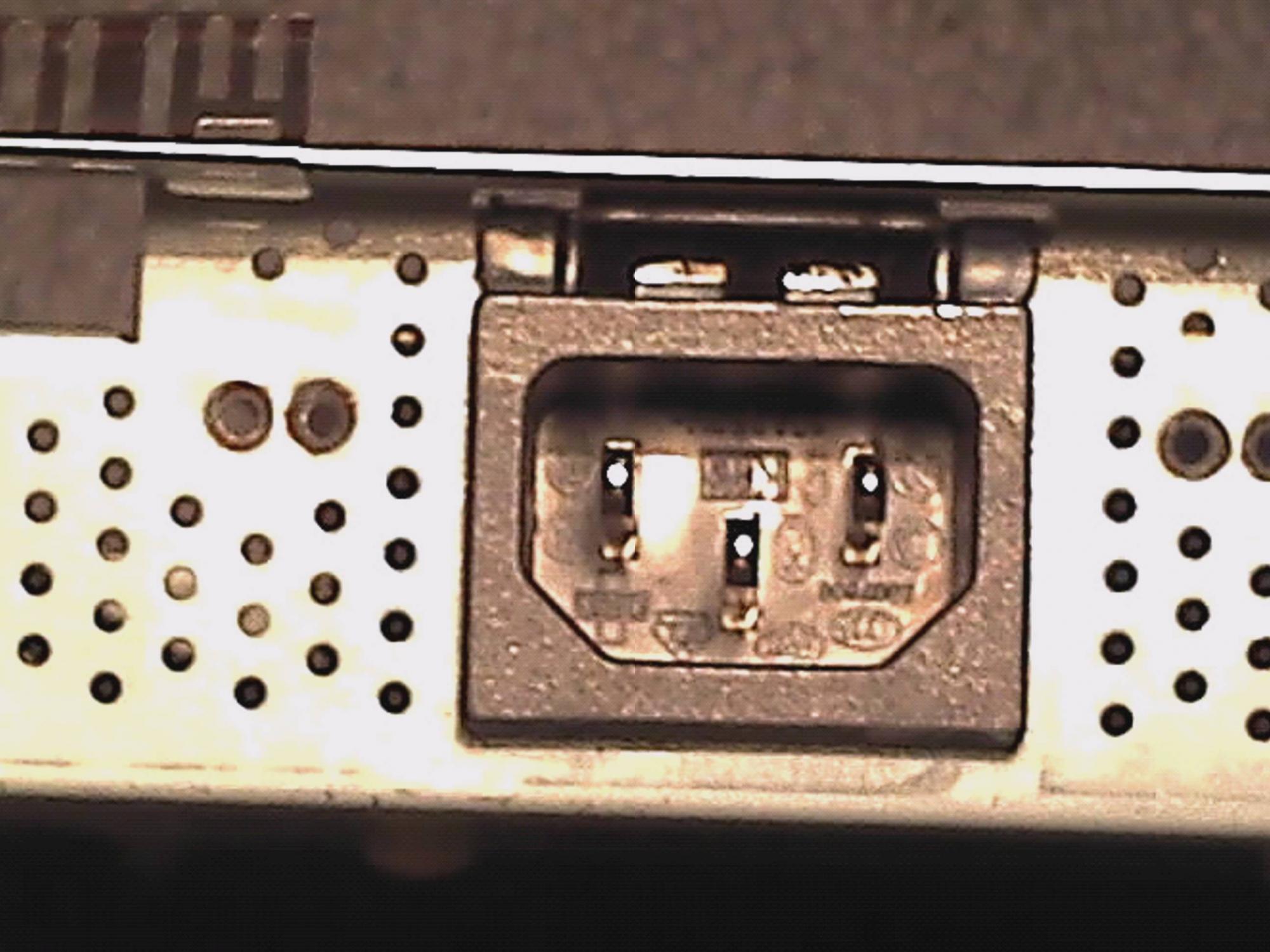

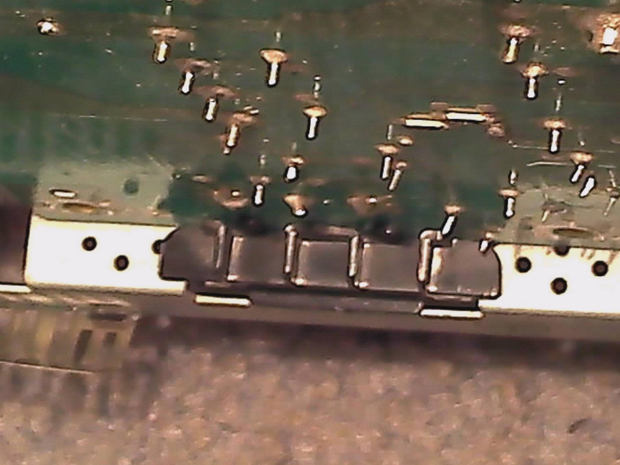

                                two more...
                                  also, I had already opened it up by the time I learnt hair-dryer works too sometimes. Mom has one, and I was wondering while it's still open, can I try hair-dryer and see if that works without re-assembling it and all?
                                    Pretty good timing on this thread, I have the same monitor with the same problem, and I haven't been able to track down what's going on...
                                    I don't know why you're having so much trouble with that clip, it's not at all complicated. It has a locking tab right above the power socket... press that tab inward (or more like 45 degrees inward/upward), and it'll pop right out.
                                        What he said. Should pop right off.
