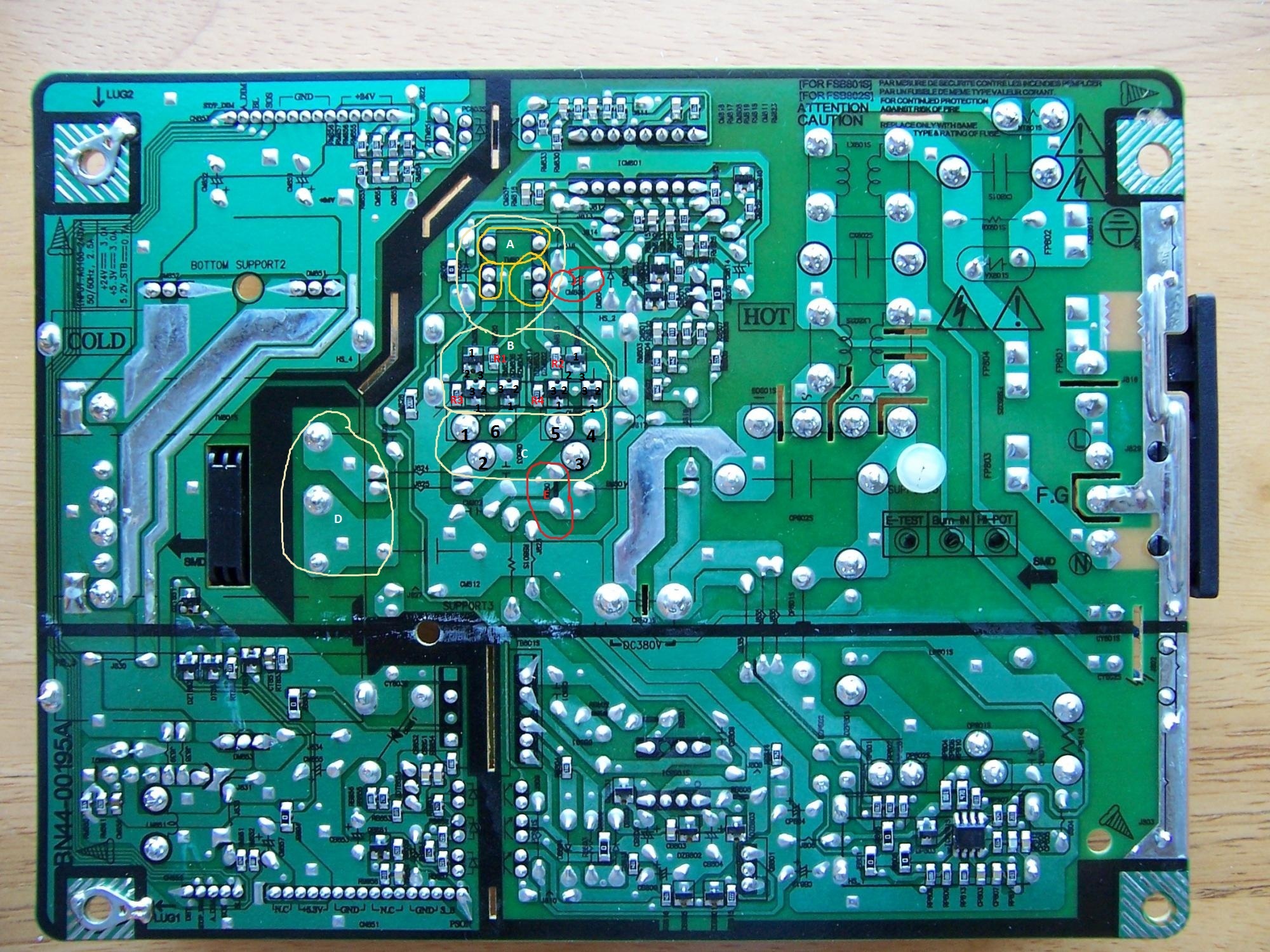

          Darn!!! I had temporary access to another BN44-00195A and made some measurements with the supply operating. Here is the comparison. As you can see, they are very similar. Unfortunately, I did not make measurements on other points on the board, and no longer have access to that supply.
          Pin Yours Other one
          1: 5.05v / 5.08V
          2: 5.05v / 5.08V
          3: 2.54v / 2.55V
          4: 0.00v / 0.00V
          5: 5.08v / 5.11V
          6: 0.07v / 0.07V
          7: 0.07v / 0.07V
          8: 5.04v / 5.08V
          9: 14.60v / 11.90V
          10: 0.00v / 0.00V
          11: 0.19v / 0.19V
          12: 14.06v / 11.30V
          13: 0.00v / 0.00V
          14: 0.27v / 0.25V
          15: 15.06v /12.2V
          16: 5.04v / 5.07V
          The next thing to test is CM812. I know your DMM does not have a capacitance function, so pull CM812, set your DMM to the 20 Megohm range, and touch the probes to the cap. You should get a reading that increases, eventually going open.

                    Darn!!! Well, I'm going to go out on a limb and say that everything up to the driver transformer is good. As is my habit, I've marked up a picture.
                    Six areas of interest are circled, and lettered A-F. Standard precautions apply - don't electrocute yourself. Make sure any resistance measurements are made with the power off, any voltage measurements are made with the power on. You can use either the signal card or a 3.3K resistor to turn the main supply on.
                    F is a resistor, it is the resistor standing on end; it provides power to the transformer primary drivers. With power OFF measure the resistance.
                    E is a capacitor. With power on, measure the voltage across it.
                    A is the small transformer which isolates SMPS controller from the main FETS. Each yellow circle encloses the ends of one winding. Check for continuity of each winding.
                    D is the primary of the main SMPS transformer. Check continuity.
                    C are the main drive FETs. Check for shorts.
                    B Is a number of transistors and diodes that handle level shifting. Check for shorts.
                    PlainBill

                              I did the measurements, Here are the results:
                              A/ all around 0.7 ohm
                              B/ As per the picture below:
                              For the 2 upper ones
                              Between pin 1-2: 23,4 ohms
                              Between pin 1-3: 23,4 ohms
                              Between pin 2-3: 0.5 ohm
                              For the 4 lower ones:
                              Between pin 1-3: no continuity (infinite)
                              Between 1-2: no continuity (infinite)
                              Between 2-3: 0.5 ohm
                              R1: 22.5 ohms
                              R2: 22,6 ohms
                              R3:22.6 ohms
                              R4: 22.5 ohms
                              C/ As per the picture below
                              Between 1-6: 23 ohms
                              Between 2-5: 0.7 ohm
                              Between 5-4: 23 ohms
                              D/0.7 ohm
                              E/ O volt
                              F/ 6590 ohms
                              Alexanna, I tried to unplug the inverter board, with the signal card plugged in though and I don't have +24 v but around 0.05V, same results with the inverter plugged in...
                              Even if my monitor doen't work, I'm still learning a lot of stuff ;-)
                                #75
                                Re: Samsung 2493 HM issue
                                There are 2 FETs in area C. If my weak spatial mapping skills are correct, 1, 2 and 6 is one, 3, 4, and 5 is the other (as per PlainBill's numbering).
                                So you want to measure resistance (power off) between
                                1-2, 2-6, and 1-6.
                                3-4, 3-5, and 4-5.
                                You should have 6 readings.
                                --- begin sig file ---
                                --- end sig file ---
                                  #76
                                  Thanks again for the explanation !
                                  That is reasonable.
                                  R1: 22.5 ohms
                                  R2: 22,6 ohms
                                  R3:22.6 ohms
                                  R4: 22.5 ohms
                                  All of these are reasonable. The three legged components are actually dual diodes and zener diodes, I believe.
                                  Please remeasure per retiredcaps suggestion.
                                  D/0.7 ohm
                                  This is reasonable; it's a transformer winding.
                                  E/ O volt
                                  F/ 6590 ohms
                                  These are mistakes on my part. Of course, the resistor is E, and I would like you to measure the resistance (power off); the capacitor is F, and I would like you to measure the voltage across it (power on).
                                  PlainBill

                                    Oups, Sorry about the measurement of area "C":
                                    1-2, 2-6, 5-3 and 3-4 gives me all no continuity (infinite resistance)
                                    - "E" gives me 0.6 ohm
                                    - "I" gives between 3V and 9V DC constantly changing .....
                                      #78
                                      Oops, here comes something else, I juste checked for voltage on the big 450V 82 uF capacitor for voltage and, power On as well as power Off I have the same voltage 163V ( I used to have 378V with power ON, 163V with power Off)..... did I do anything wrong ?
                                        #79
                                        Possibly. I have been unable to locate a schematic for this power supply, however the design is identical to the BN44-00214A in this thread.
