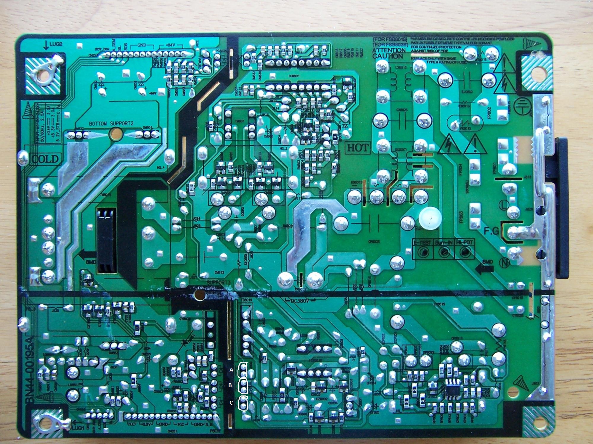

    I've marked up another picture. The output side of three opto-isolators have been circled, and labeled A, B, and C. Measure the voltage across each opto-isolator with power off and power on. One of them should show a major change in voltage, but report the results on all three.

      Here is what I find for the opto isolators:
      Power OFF:
      A/ 1.13V
      B/0.66V
      C/19.4V
      Power ON:
      A/ Fluctuating between 2.2 V and 9.5 V probably going even higher if I leave the probes o it for a longer period of time.
      B/1.7V
      C/0.15V
      By the way, you remember when I told you the main capacitor voltage was stucked at 164V power On AND power Off, well today, it's changing again from 164V Power OFF to 380V power ON .... strange !

        Not that strange. We've had one successful repair of the BN44-00214A power supply (same controllers) that turned out to be a bad solder joint. I've had two power supplies that started working after having been shipped across the country. Your experience could be due to bad solder joints also.
        By the way, based on your results, C is the opto-isolator turning on the PFC controller and main SMPS controller.
