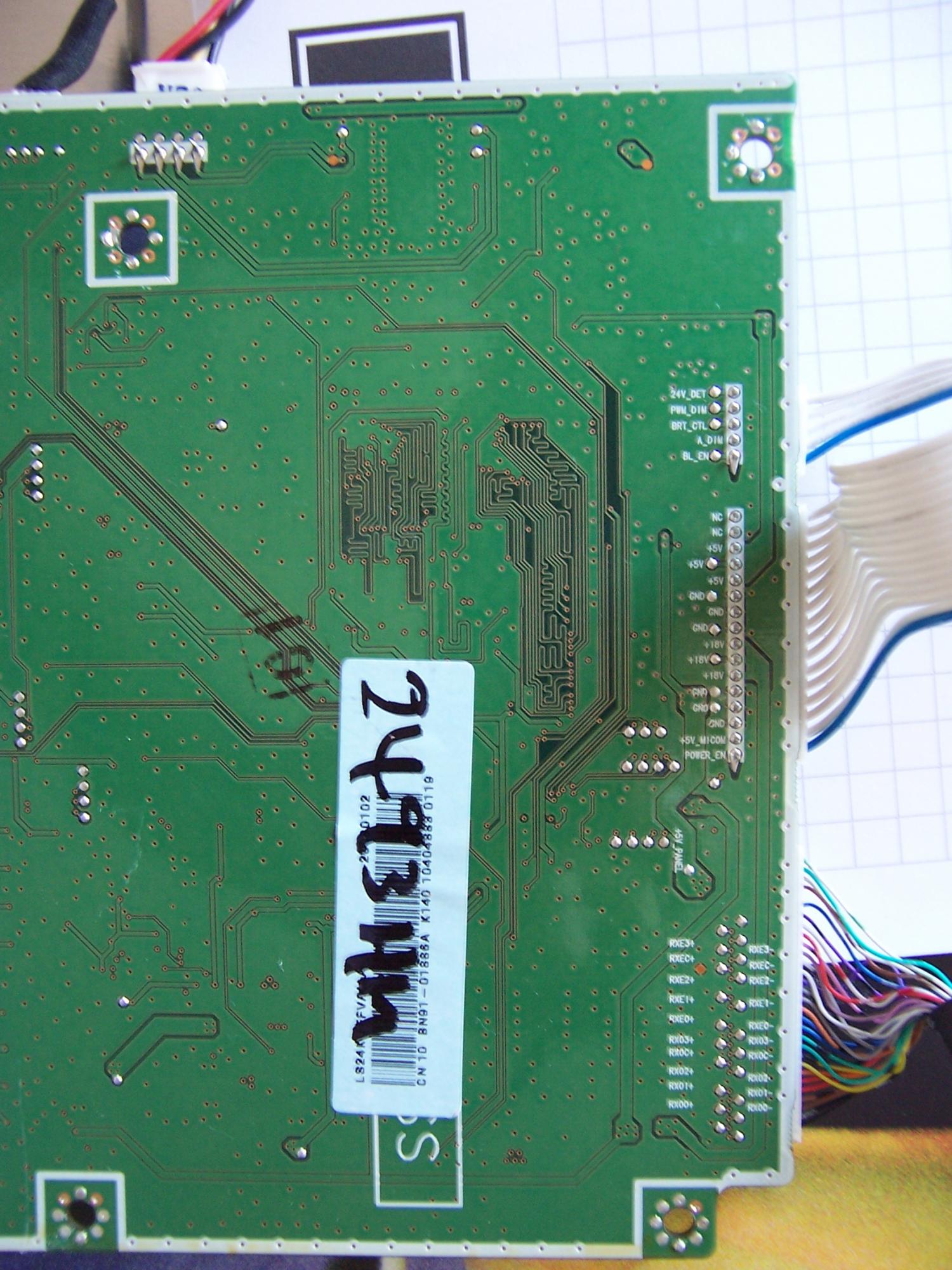

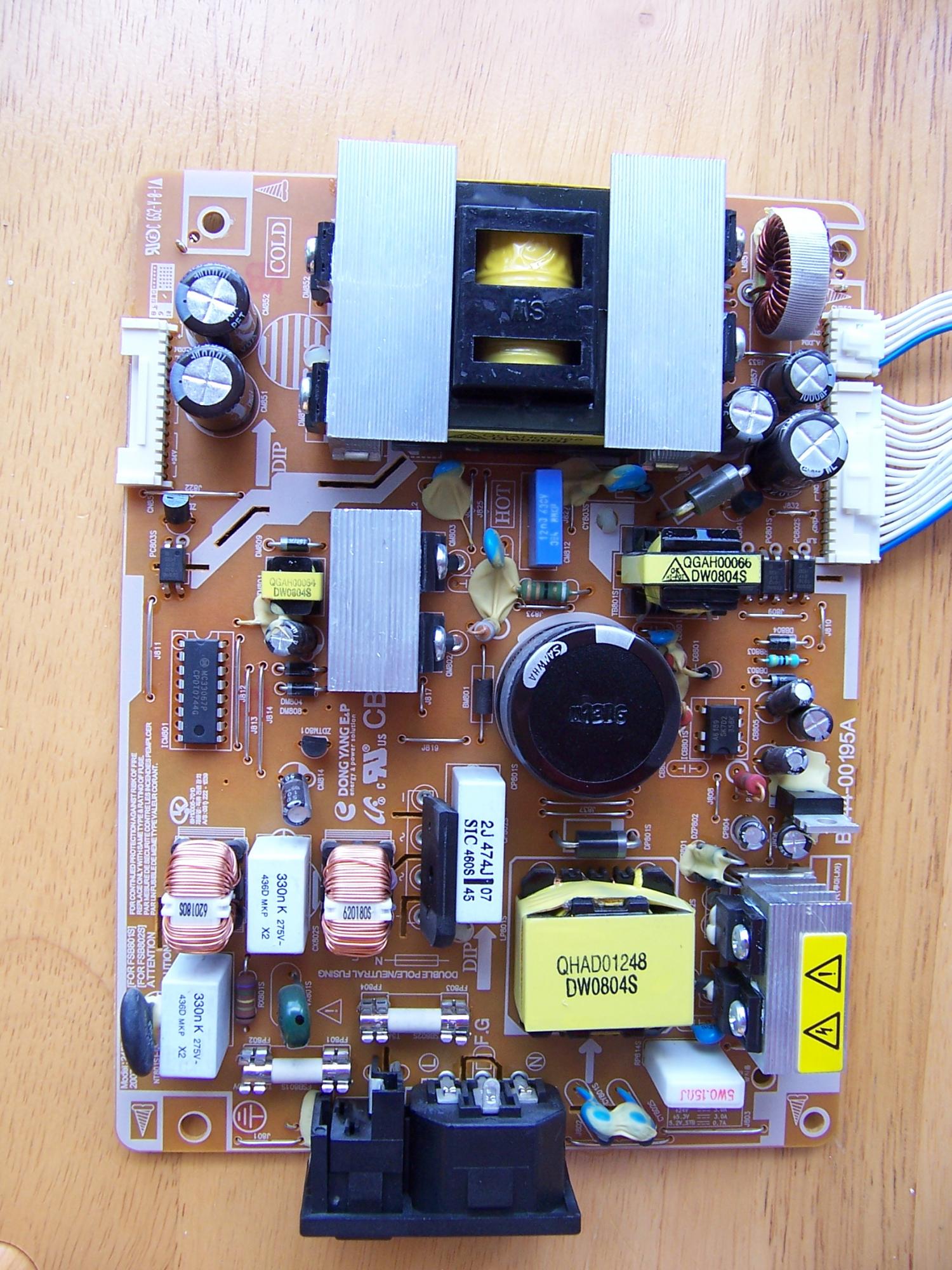

    Attached are pics from my different boards.
    Can somebody help me please ??

    I do see 2 Caps that looked bulged.
    On the left side of the power supply there is a connector, I can read that some pin are 24Volts,There should be some pins labeled on/off or p/on and one that is marked dim,and some grounds.
    With a signal going to the monitor what voltages do you read on these pins?

            Whats the number of th power supply BNxxxxxxx?

              I am working tonight, so I don't have the board in front of me but according to the picture it's BN44-00195A.

                Apparently this Power supply is also used on the samsung 245BW and 245B...
