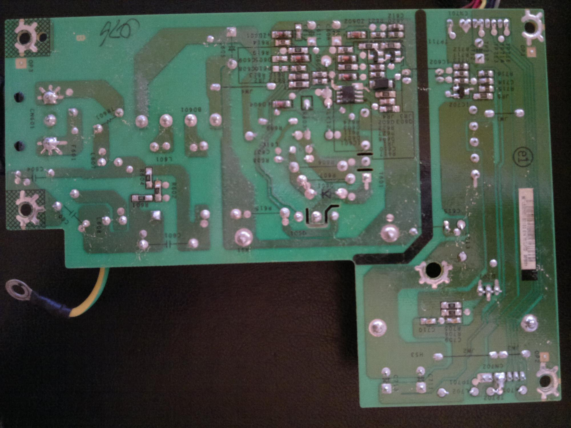

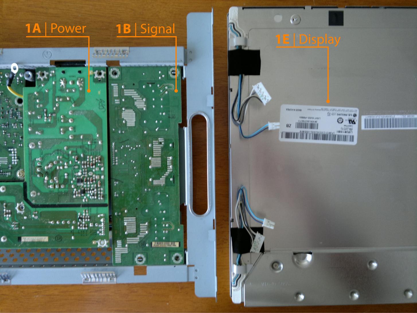

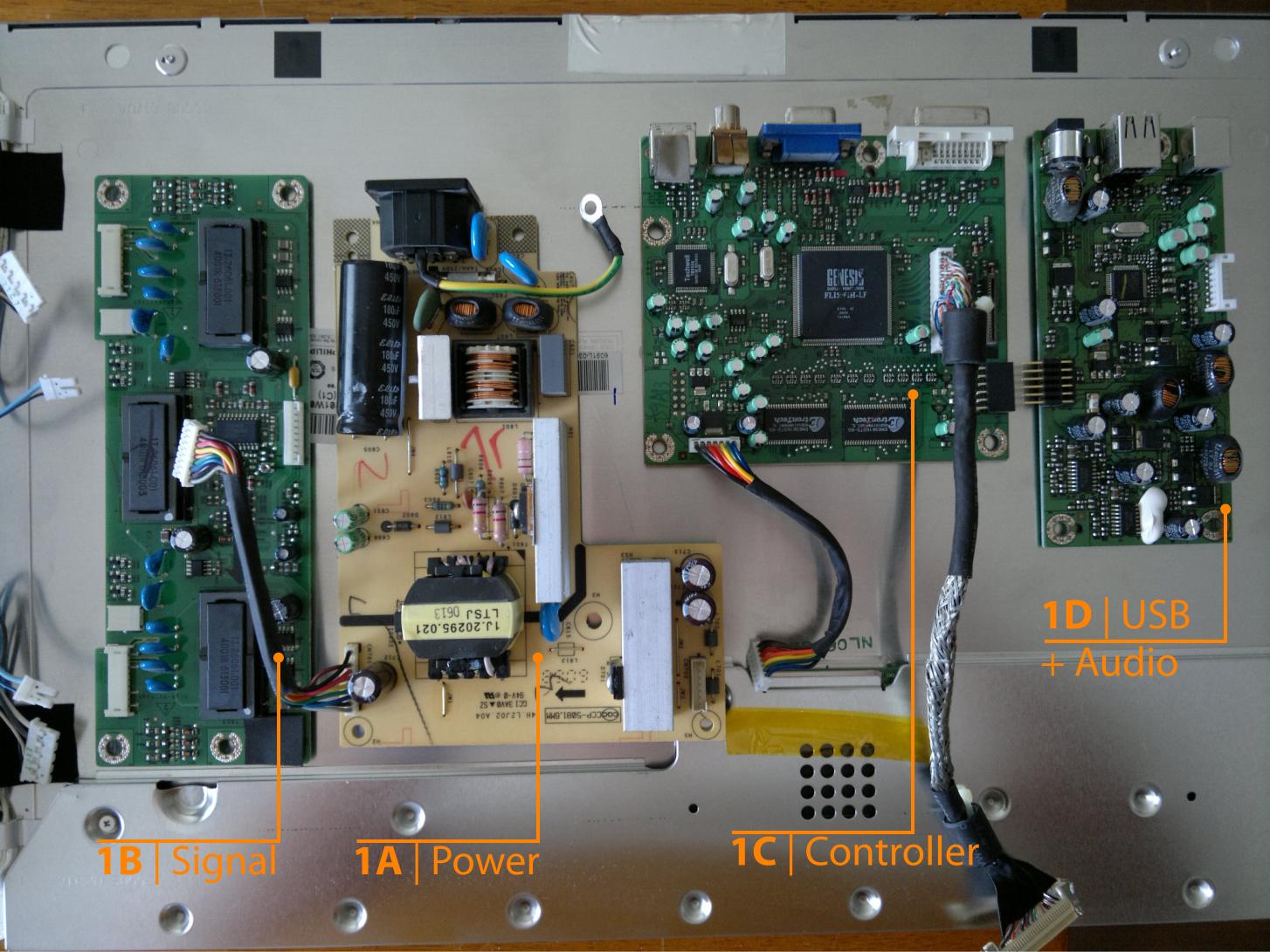

    I searched the available threads but those solutions didn't seem to fit my situation. Problem started when the monitor would restart itself, then progressively deteriorated to a blank screen while the power button led flickering on and off. Finally the front control leds (4 of them) just blinked amber, in unison.
    I searched around the web for a repair manual and happened upon this forum. I've been a DIY'er my whole life, however troubleshooting a non functioning monitor is a new challenge. I'm great at assembling electronic components but suffer in the troubleshooting area. I really would appreciate any help that could be provided.
    The status of the monitor is it has been opened and the main power board is out. However no distinguishable problems with the board (deformed or misshapen caps, diodes or transistors). What should be my next step from here?

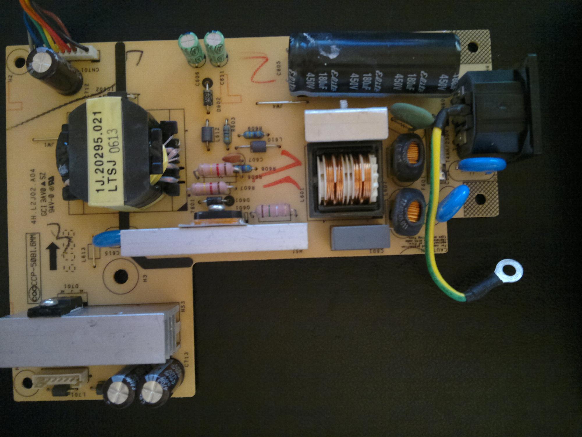

    Check the voltages on the cable from the power supply to the signal card.
    Post pictures of the signal card.
    The symptoms you describe indicate you MIGHT have a corrupted user EEPROM. I suggest searching for a reset procedure for the monitor. His involves holding down certain buttons while applying power.
    One other note. When we see a bulging cap we know it is bad. Just because a cap is not bulging does not mean it is good.
    PlainBill

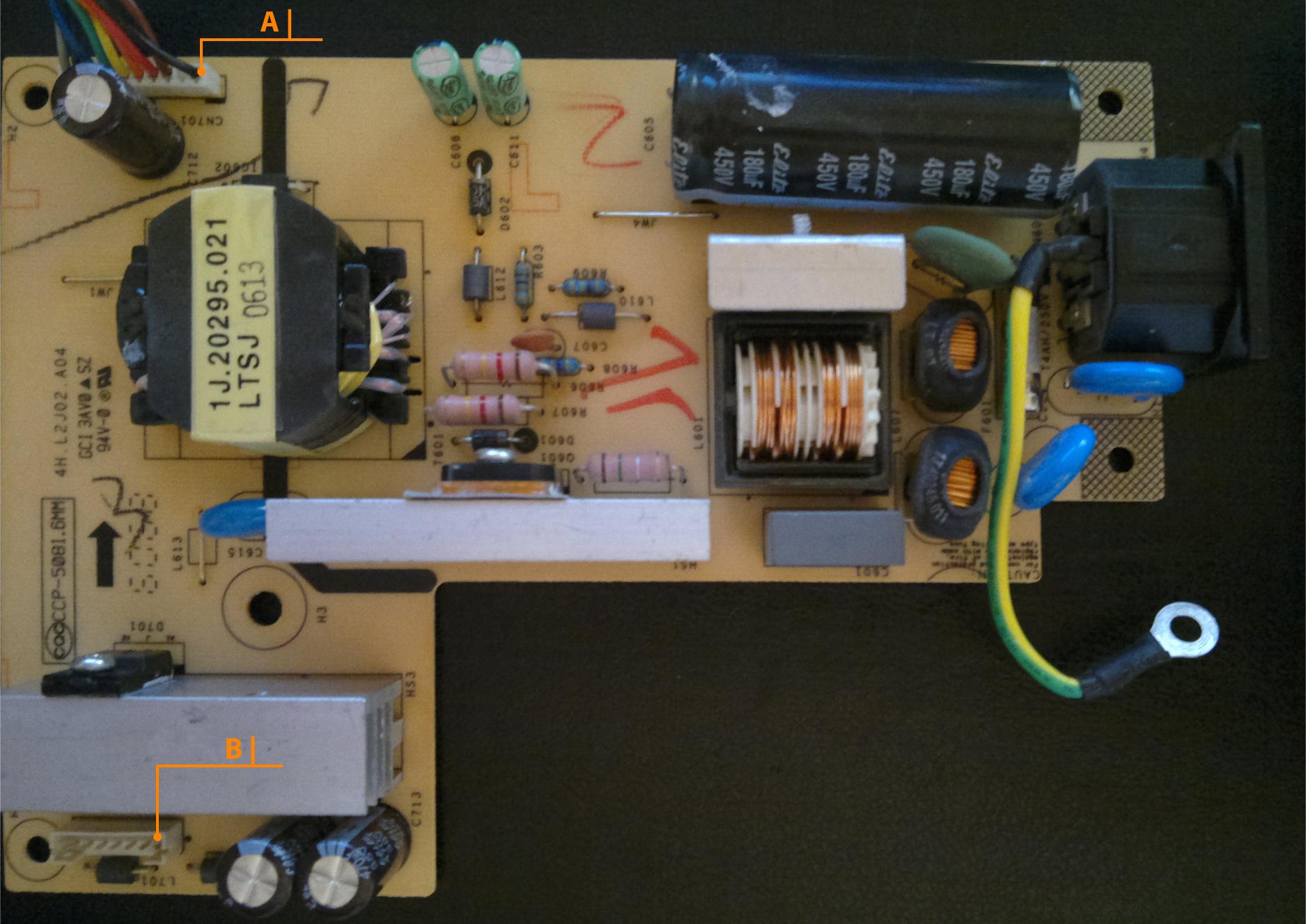

      Thanks PlainBill, I'll check the voltages tonight.
      Are they all referenced to the black wire or are there pairs I should test? I'll try both ways... The image 06082011061-MOD.jpg shows connectors A and B, I understand that I should check the voltages of A.

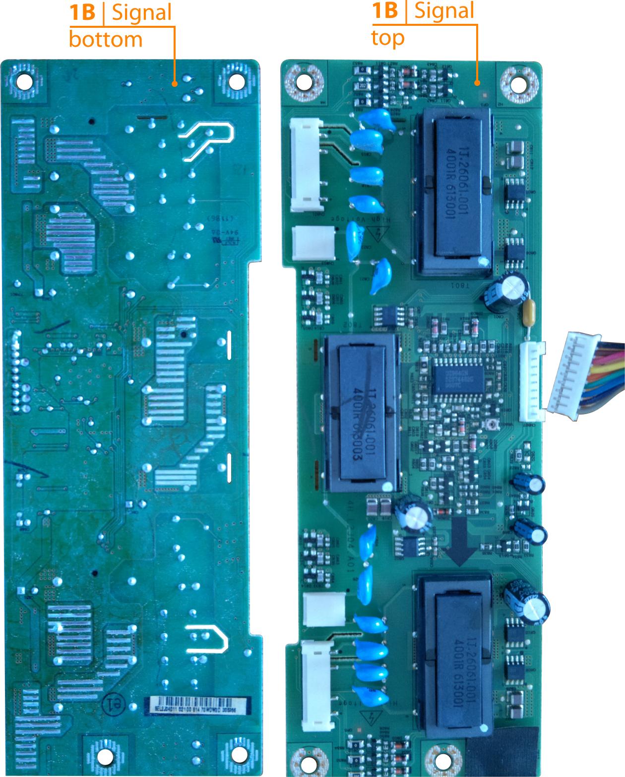

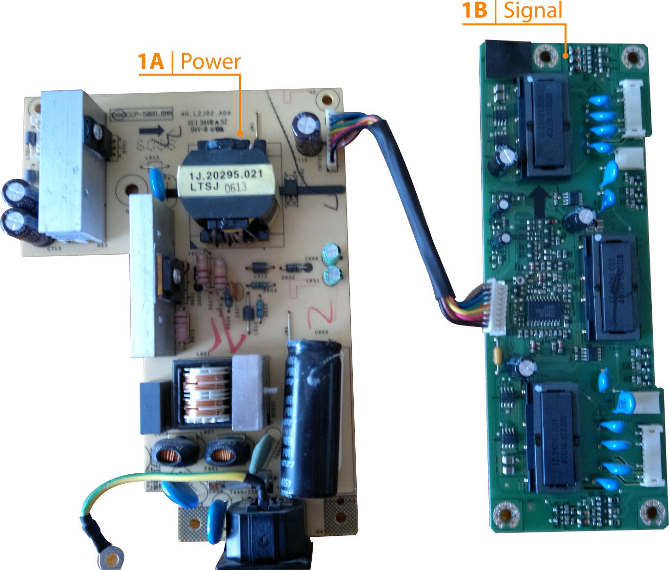

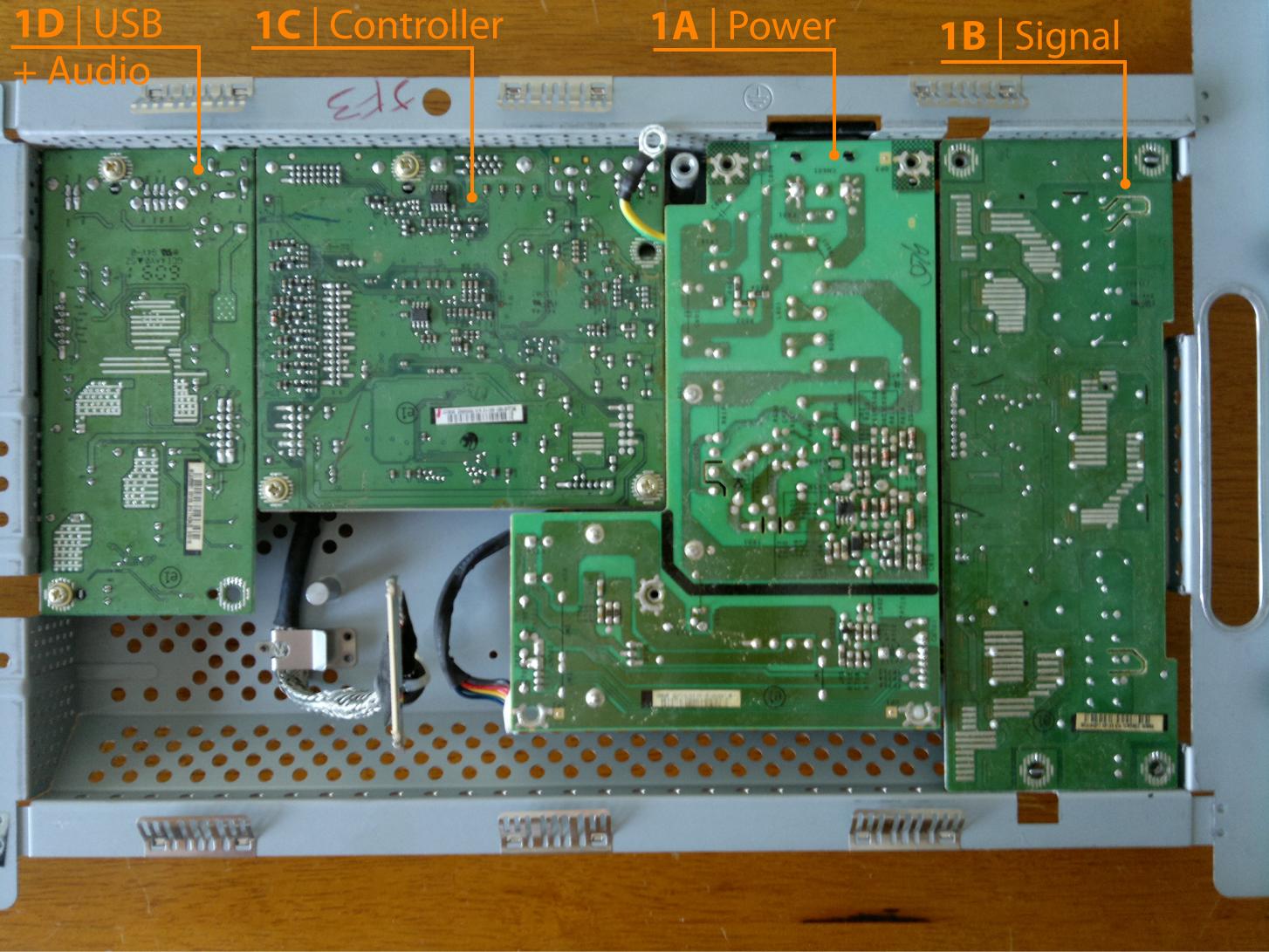

      I've attached images of the cards, with identification call outs. I get easily confused and I want to make sure I understand your directions.
      I appreciate your assistance and don't want to waste your time.
      I've searched for a way to reset the monitor and I did the factory reset, I think it just clears whatever settings I made, this had no effect.
      Hopefully the voltages will reveal something.

        Duh!!! My error. The black and brown wires are ground, so measure the voltages using the black wire as ground. And I am interested in the voltages to the signal card.
        Also, the terminology I use is 1A is the power supply, 1B is the inverter, 1C is the signal (or logic, or controller) card, and 1D is the USB card.
        You are correct, it's important to keep our terminology consistent. Of course, it has gotten easier. Some monitors combine A, B, and C all on one board.
