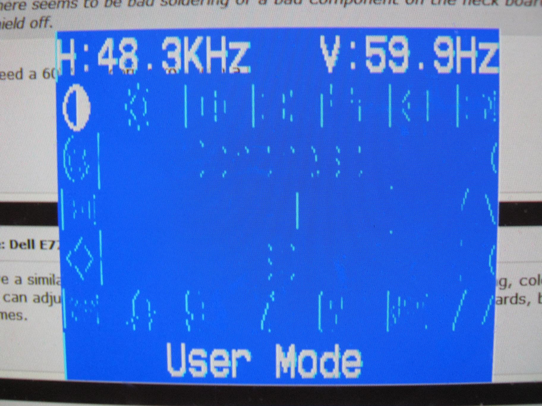

    This old monitor is going nuts. Sometimes it gives a decent picture, but it can also sometimes have a red, green, blue, or yellow tint. The change is sudden. When I started typing this, the monitor had a blue tint, and it suddenly changed to a yellow tint. Even when the colors seem normal, the background of this site is brown instead of gray.
    Also, this monitor will start flickering sometimes. When it flickers, it seems to be alternating between having a red tint and a green tint rapidly.
    Finally, I am sometimes unable to select options in the menu. I can open the menu and move between the menu options, but I can't adjust any values. It seems that the Menu/Enter button stops working when the menu is being displayed, but pressing it still brings up the menu. The menu is sometimes missing red or green and shows up as a solid blue box with transparent text.
    It would probably be best to replace the monitor, but I want to see if there is anything I can repair like bad caps or bad solder joints. This is a CRT monitor.

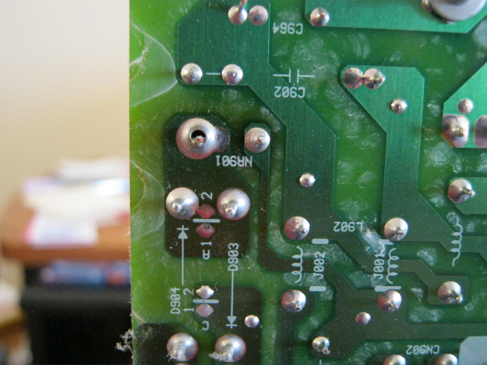

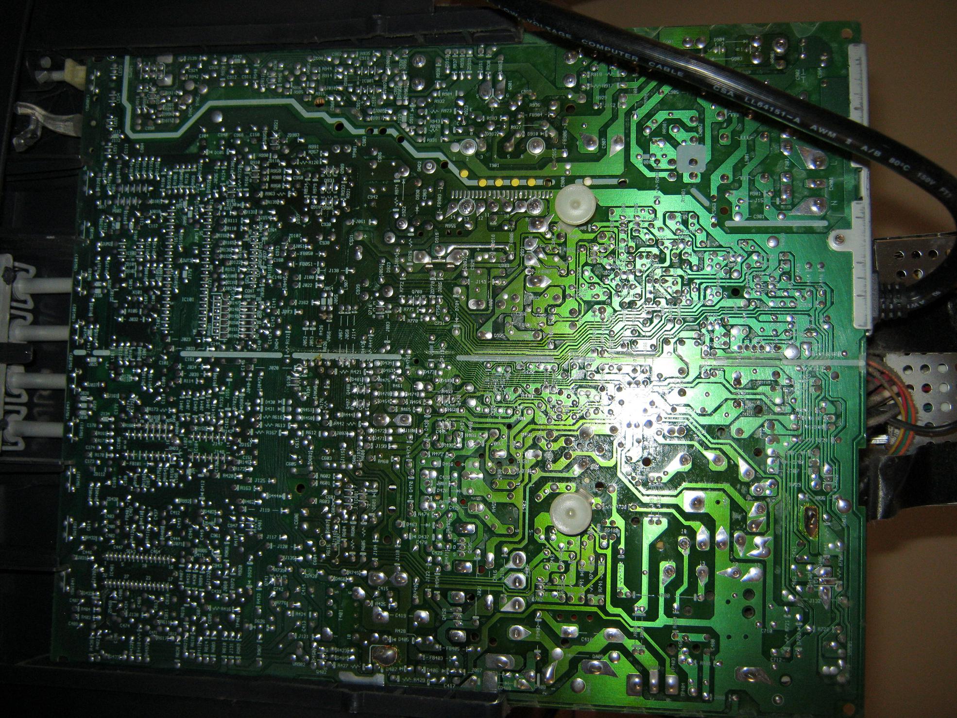

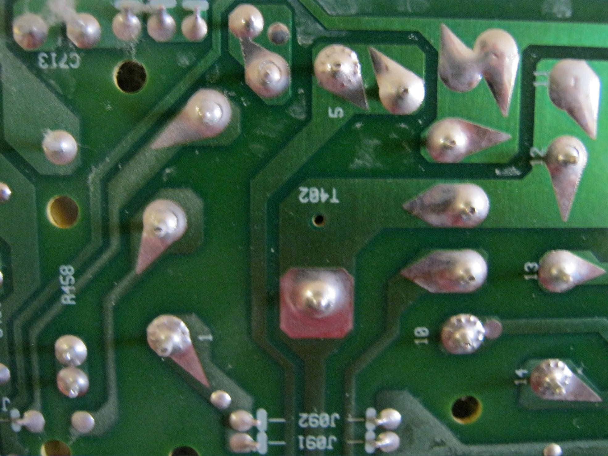

        I resoldered some points on the main board and the colors are better. I will have to use it for a while to see if it is fixed, but the background of this site is gray now. There is a slight blue/purple tint, but the colors are closer to what they should be.

          Re: Dell E772c - Wrong colors and flickering

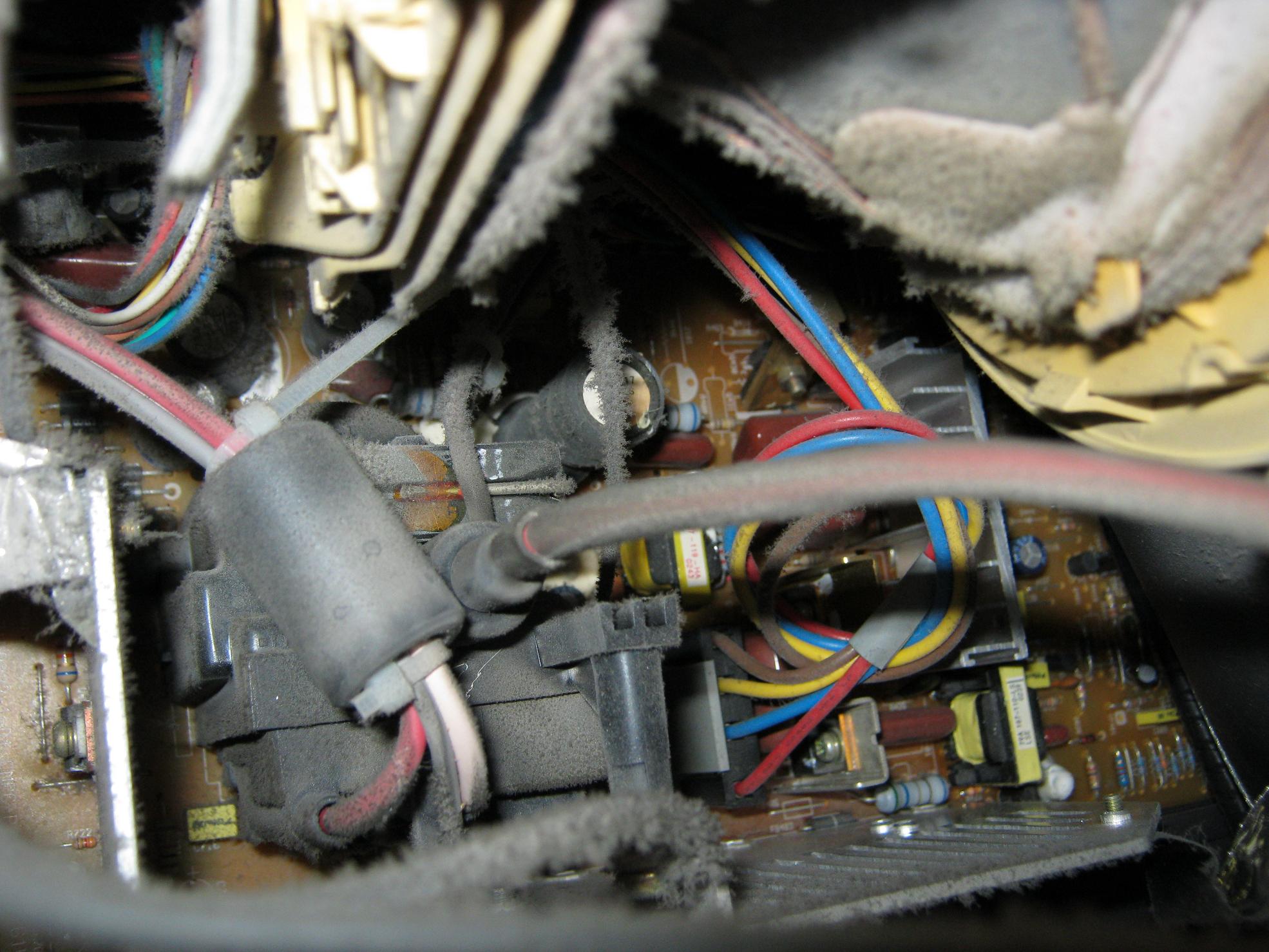

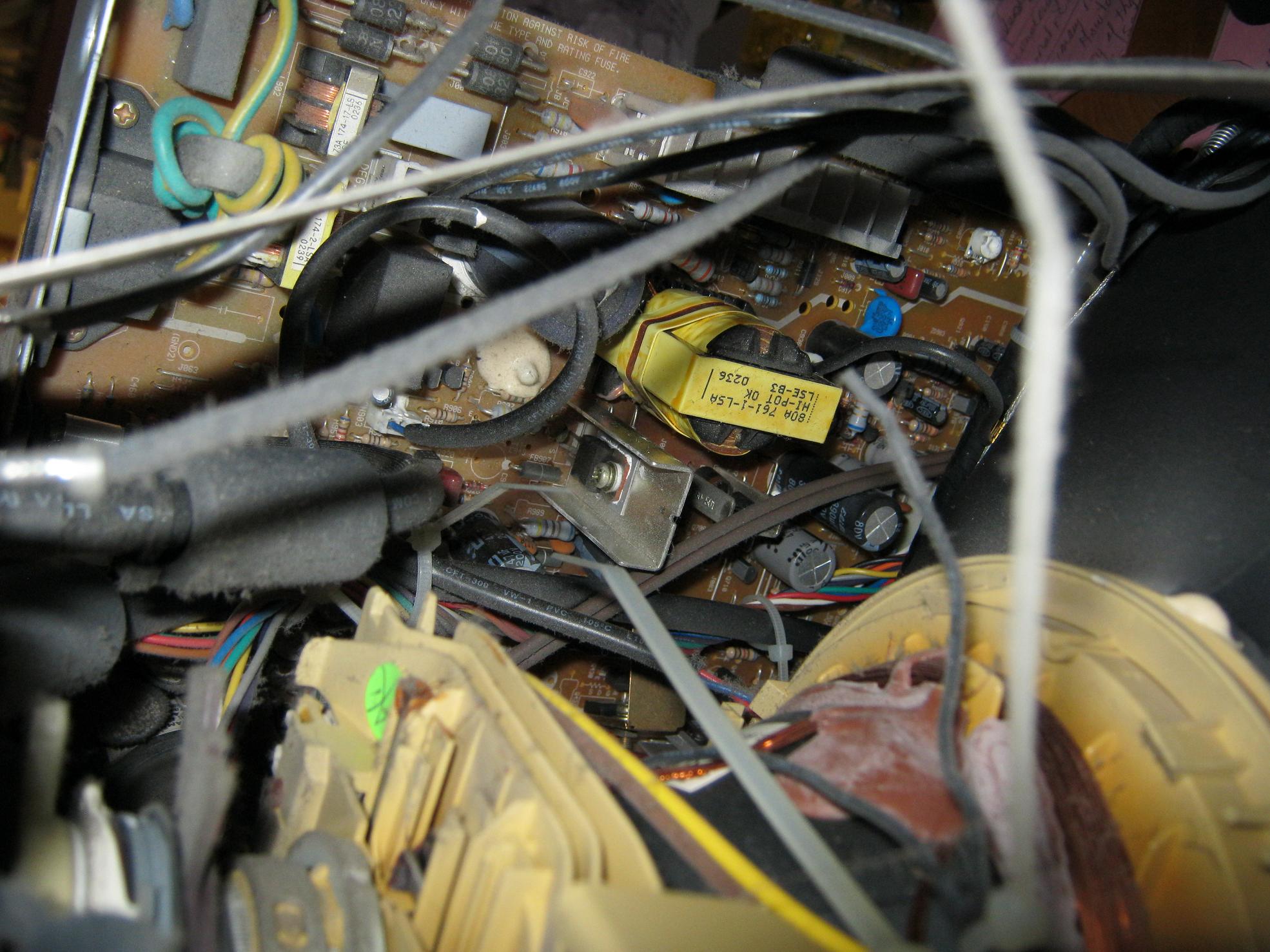

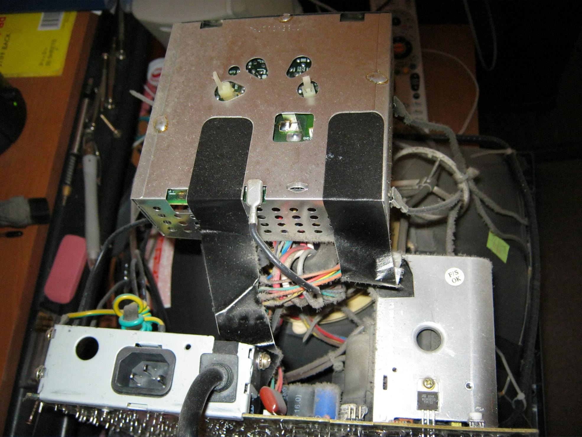

          This monitor's original problems have returned. There seems to be bad soldering or a bad component on the neck board, but I can't get the metal shield off. There could also be bad caps. The caps are a mix of Elite, TL, HEC, and these.
                  There are a lot of people that have the same problem with this model of monitor.
                  Before I resoldered the board, the screen would have a red tint if the contrast was set below 60. That problem has been solved.
                  If the VGA cable was bad, I thought one color would be completely missing, not just darker than the other two colors.
                  Here is what the menu looks like. I already resoldered the OSD IC and the connector on the main board that leads to the video amp on the neck board.
                    I finally figured out how to remove the shield over the neck board. I found that most of the solder points for IC802 and the connector P804 were bad. I also found a bad cap at C812. The monitor now appears to work.
