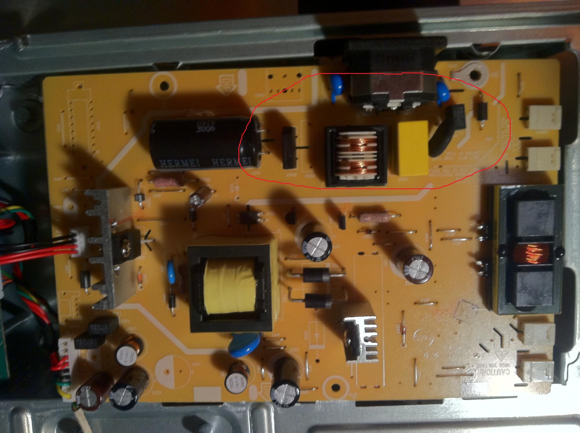

    I have an ASUS VH222H. When plugged in there is no activity on the power LED. It doesn't light up at all. Because the monitor doesn't turn on, well, there is nothing on the screen. None of the capacitors are blown. I'm not really sure what needs to be fixed on the Power Board now. Any ideas?

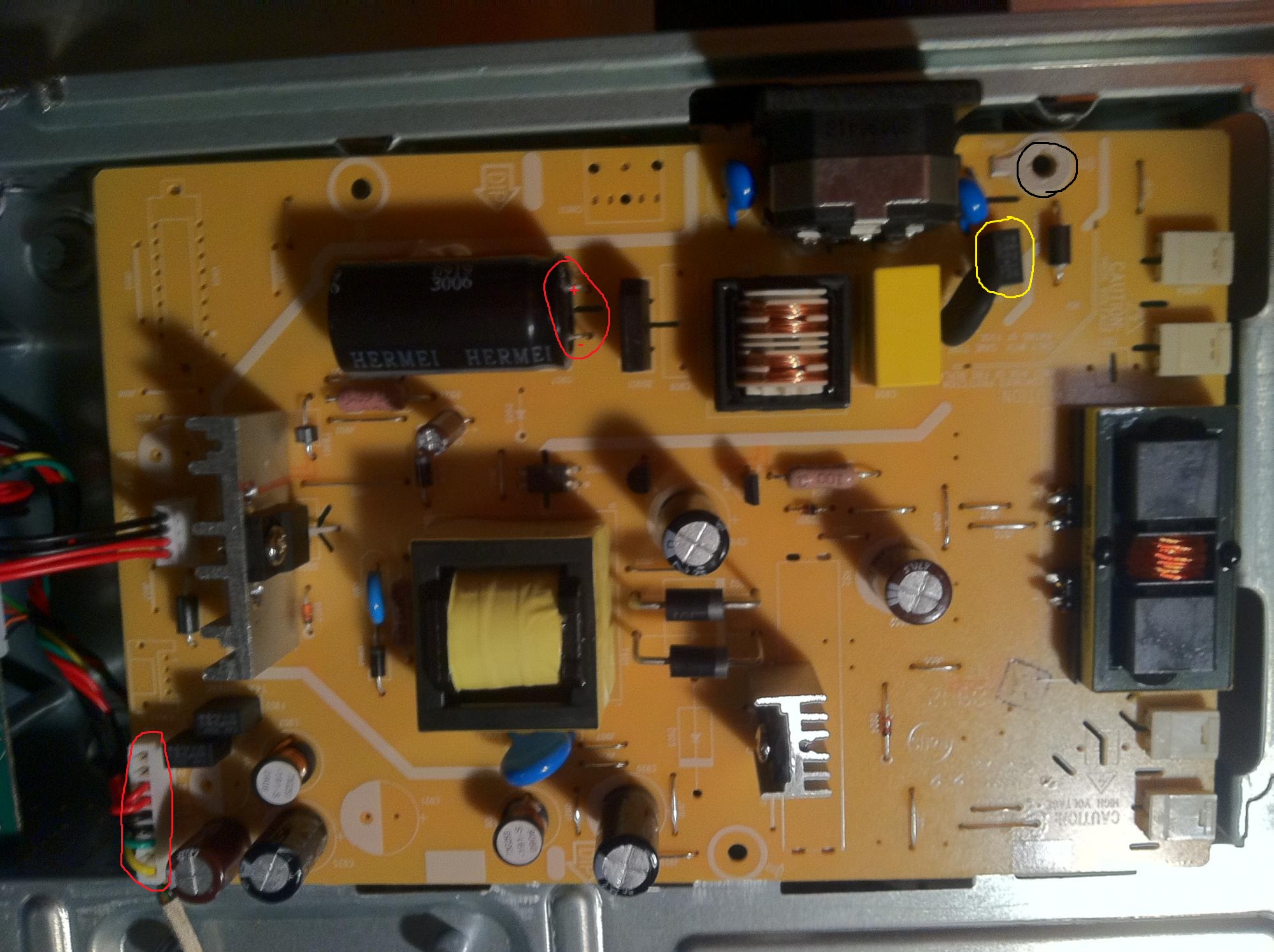

    Yeah, the picture quality would have been better if you waited until the sun is overhead. Still, they are good enough.
    1. Disconnect the cable running to the signal card.
    2. Fasten the power supply in place temporarily with at least two screws, one of which is through the grounding clip I circled in black.
    3. Plug in the AC power cord.
    4. Set your DMM to the 1000V DC scale and measure the voltage across the pins of the large cap (circled in red). Report that voltage.
    5. If the voltage measured above is about 1.4 x line voltage, the fuse is good.
    6. Set your DMM to the 20 VDC range and measure the voltage on each pin of the output connector. Use the mounting screw circled in black as the ground point. Report those voltages
    If you read 5V on any of the pins of the output connector attach a picture of the signal card to your next post.

        What parts would I need to replace if I didn't test? My multimeter doesn't have the 1000V DC setting.

          If your mains input is 110v then you are looking at measuring 165v DC across the Cap..if your mains is 240v then you want about 365 v DC.Nobody can tell you what parts to change if you do not do the tests,we don't have a Crystal Ball !!!

            Alright. I had plugged the monitor in like he said with the 2 screws. The power board started to spark. Should I still test, or could I get shocked or something?
              Provide a picture showing where it sparked.

                It was near the power adapter plug-in, but I am not totally positive.
