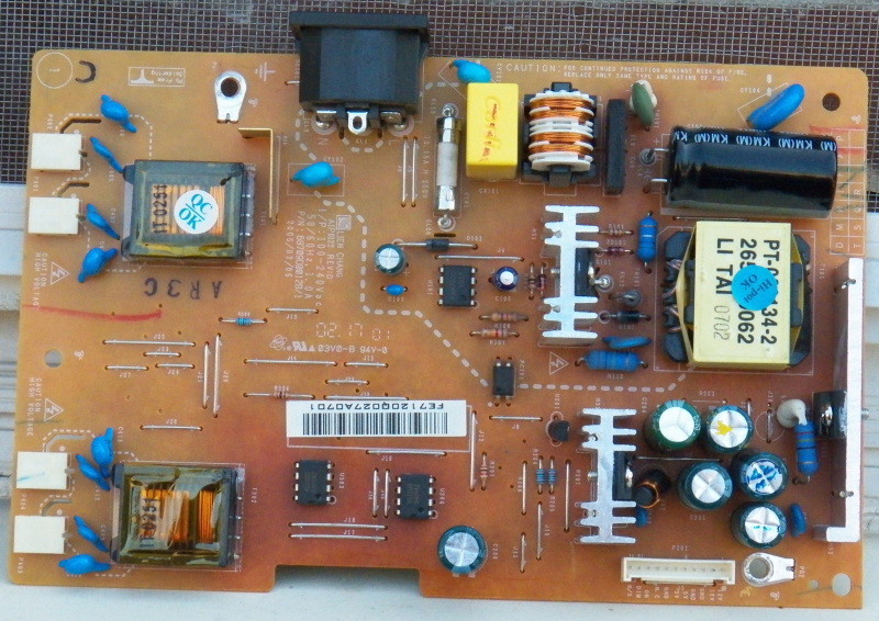

    Hi guys been awhile since I've been here. I have a dead LCD monitor here and just looking to see if my gut instinct is right in suspecting a bad bridge rectifier.
    Model L1953TQ.
    Original Symptom- No power no blinking light. Cracked it open and found a bulged cap in the output area. Tested the other caps all were fine except for one small one so I replaced that too. Applied power to unit.. still nothing.

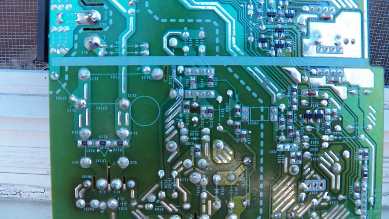

                      Something just percolated through the gray matter. In an earlier problem, one of the inverter drivers was defective, but not shorted. It overloaded the 12V supply.
                      The picture of the top is too small to really help, so I'm forced to work from the picture of the back side.
                      Referring to the 11 pin connector, the two bottom pins are 12V, the next two are Gnd, then next two are 5V. With power off, measure the resistance from Gnd to 5V and from Gnd to 12V. In each case, I would expect a resistance of over 20 ohms.
                      If you haven't already done so, reinstall D202, since that tested good.
                      I'm having a problem tracing the circuitry around U201. I can't figure out if the 12V or the 5V rail is regulated.

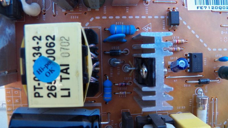

                              Just a follow up from yesterday.. haven't done that other test yet that you mentioned Bill but this morning I found something that looks like a Picofuse.. it's labeled FB101 on the board. I don't recognize the symbol.
                              I also took a better shot of that U101 IC you mentioned as well.
                              Please see attachments.

                                FB101 is not a fuse, it's a Ferrite Bead (what the "FB" stands for). Can't read the part number on U101. Can you please tell us what the part number is?

                                  Part # for U101 is: FAN7601 VG51
                                  Part # PC201: CC642 EL8
                                  Thanks for the info about FB101
                                  Update.. checked the otherl diodes and Schottkey Diodes they are fine.. just have a question about this other part. It was labeled Q101 on the board.. pulled it out tried googling the numbers on it.. no luck. FM G46 FQPF 8N60C.

                                    FQPF8N60C is the relevant number. Hint: Google each block of numbers and the word datasheet. The first hit when Googling 8N60C datasheet brings you to alldatasheet.com, which reports that FQPF8N60CF is a 600 Volt mosfet.

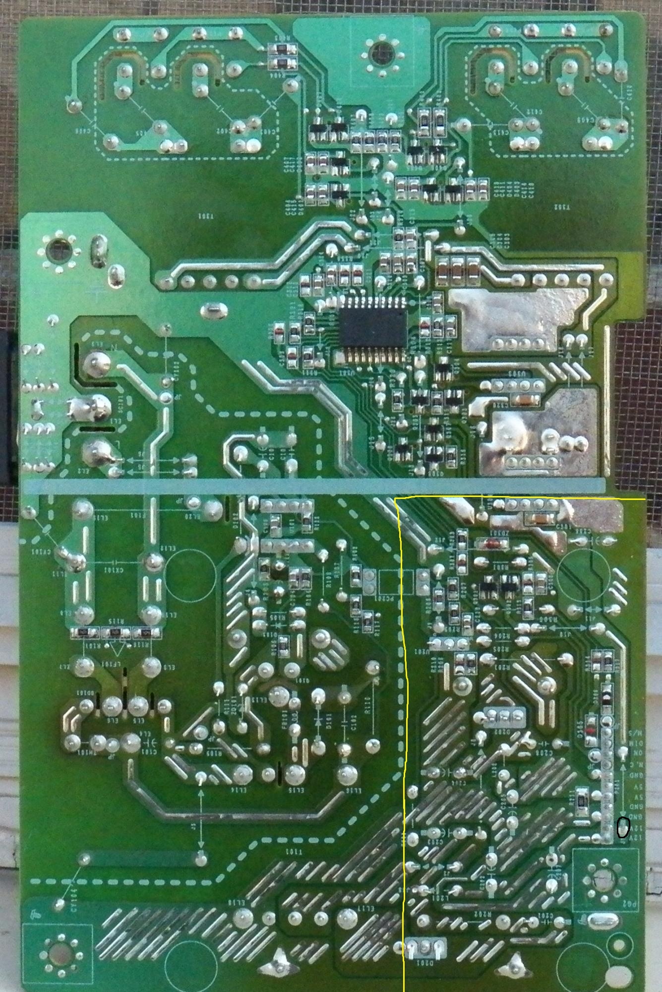

                                        Probably none of them. The fact that you do get some output voltage indicates the problem is on the secondary side, or the loads.
                                        I see two approaches. The preferred approach may take a little while. I have marked off an area of the bottom of the power supply in the attached picture. I would like a good quality picture of the area within the yellow lines. I need it sharp and clear because I am going to have to follow some circuit paths.
                                        The riskier approach is to unsolder one end of J1 (circled in black). This will disable the inverter. If the power supply now works, the problem is in the inverter.
