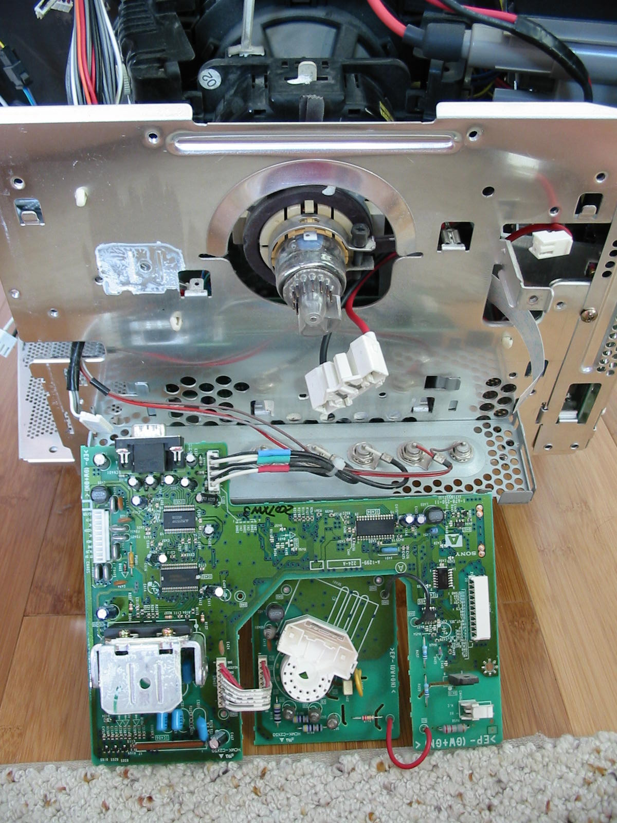

      After installing the new FBT, problem is still exactly the same - spark gap SG902 gives off a nice blue flash for a second, then the HV supplies cut out and restart only to have the same cycle repeat.
      I did notice something else too, though - there's is also a blue flash coming from inside electron gun. If I'm not mistaken, that would mean that the tube is indeed leaky, as KC suggested in post #8.
      The last 2 attached pictures below show when SG902 is glowing (2nd to last pic) and the internal arcing of the electron gun (last pic).

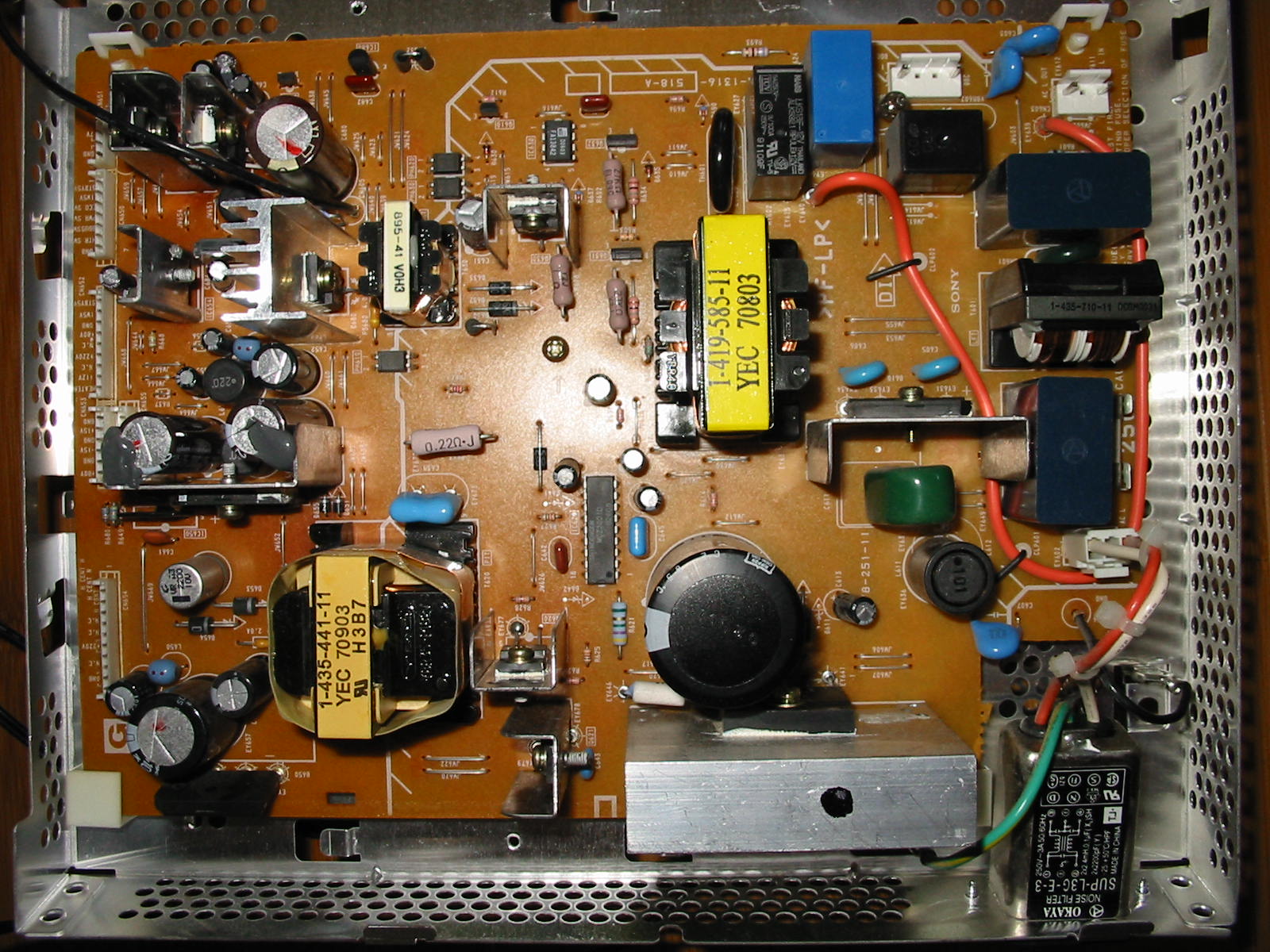

      I've given almost everything on the D-board a basic DMM check and nothing seems to be obviously bad. Attached in the zip file is a PNG image that shows what has been checked. Basically anything with green/blue/yellow/red has been checked.
      Green means the component gave me proper measurements on the DMM.
      Blue means the component gave me an okay measurement as far as I can check with a DMM (like for example a cap not showing shorted on the DMM)
      Yellow means I couldn't get a proper measurement from the component most likely due to other components.
      Red - something obviously wrong. There is nothing with red on the D-board other than D914 which actually is a component that does not exist on the D-board and has been replaced with a jumper wire JW5 from the factory.
      When I have time, I'll pull out those components marked with yellow and test them out of the board.
      I'm also thinking about testing the monitor with various HV wires (like G2 and the 2 focus wires from the FBT) unplugged from the A-board to see if the symptoms change. Would this actually be a bad idea?
      The other thing I'm thinking about is swapping the D-board (and possibly A-board) from this monitor to the good one to see if that's the problem at all. Now that I've taken this monitor apart a few times, I'm a lot more comfortable with moving boards around. I actually did find a way to remove the D-board without disturbing the S-board. Didn't know that the white connector that's attached to the 2 focus wires on the FBT can actually be detached from them. Doing so allows me to pull the focus wires without moving the whole front plate for the A-board.
      Apart from that, that's all for now. Decided to include a few random inside pictures of the monitor just for those that still might be interested (anyone?).
      The 4th pic shows the white connector for the 2 focus wires removed. This is what you have to do if you want to remove the D-board without moving the S-board and A-board front plate.
      5th pic shows the focus wires fed through and white connector installed on them.
      The last 2 pictures show the arcing.

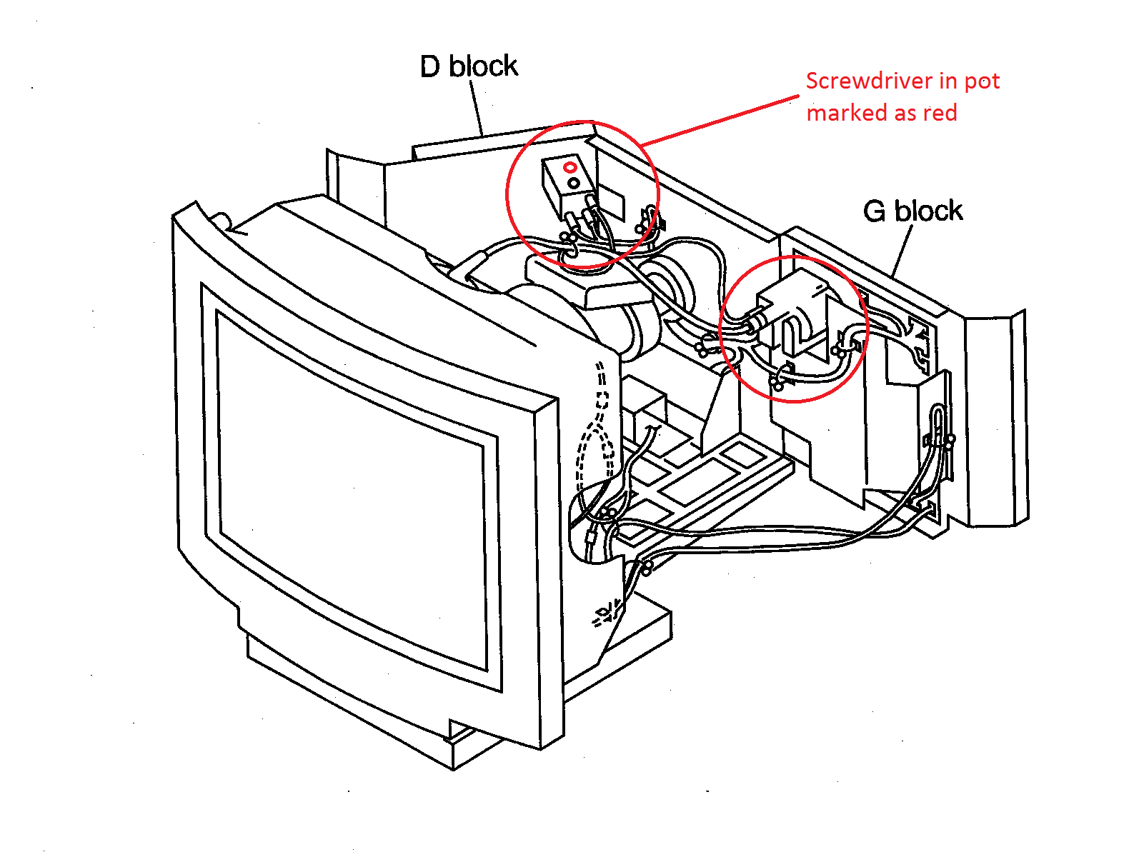

                    This interests me a lot. I have a battered GDM-W900 (not the FW900, sadly).
                    Got it free after it took a tumble down some stairs. Front buttons were smashed, inc the PCB behind them.
                    Found out that they saved IO lines by using a different resistor value for each button, all feeding an ADC.
                    From the values of the existing components on the PCB fragments(!) I was able to work out the progression and repair it.
                    Its like the FW900 just limited to 1920x1200@72, and no USB hub.
                    Problem is that I suspect the flyback is on the way out.
                    It started with it gradually loosing focus, then there would be a 'snap' and it would be in focus again.
                    After a while it stopped snapping and just stayed out of focus permantly.
                    I assume thats because whatever windings on the flyback that were sometimes arcing just permantly shorted together.
                    I solved that issue by opening the back and finding the focus pot on the flyback, then had the fun of trying to work out how to make a small hole on about three layers of the casing so I can always have a plastic crosshead screwdriver in there for adjusting the focus.
                    I have to tweak it about 3 times a day, but no snapping anymore.
                    I know Im on borrowed time, the snapping stopped about 3 years ago and Im paranoid about it dying every time I switch it on!

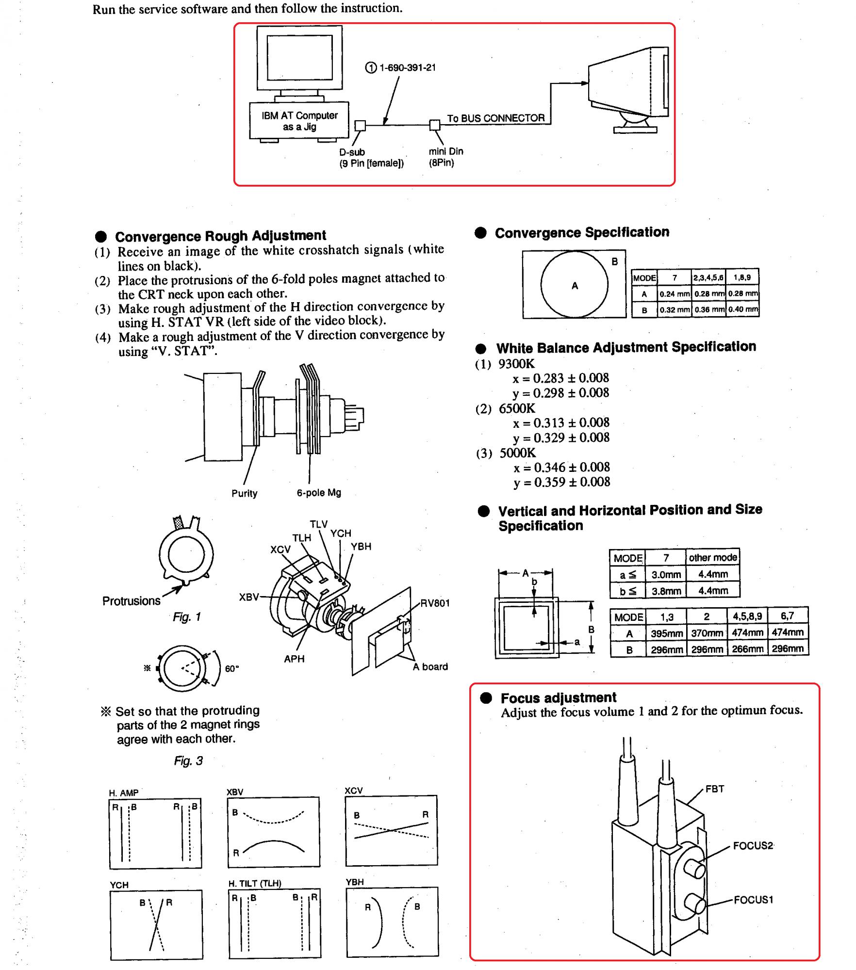

                    The other annoying thing is that theres no serial header like there is on the FW900, theres an odd miniDIN on the back thats labelled Service Port.
                    Im sure its just a serial port but I cant find ANY data at all.
                    Anyone know its pinout/baud rate etc? Or even if WinDAS etc will talk to it?
                      No idea either, but I have a very old HP Trinitron from 1994/1995 that uses the same port type. Considering how similar the FW900 and W900 are, I would be inclined to think it is the same thing that the FW900 has, but just with a different port connector. But again, that's only a guess.

                          Originally posted by Uphill Gardener
                          I took it on the grounds that by the look of it thered be some juicy salvage inside.
                          Once I saw the CRT was intact I emptied the plastic shrapnel and odd metal clips & screws out of the casing, checked the looms for good connections etc and stuck some power on it.
                          Amazingly it came up with a no signal message, but once Id put a signal on it I saw the lower right quadrant was green tinged and fuzzy.
                          That is an amazing story! I almost didn't believe it until I saw the pictures you posted. Poor monitor . Yet it still works and picture looks very good.
                          By the way, I just noticed the W900 is very different from the FW900, both externally and internally.
                          Externally, the W900 has the old style horizontally-curvy tube, so this suggests the tube is much older. And this is probably why the W900 has a lower resolution limit over the FW900. Most likely this older tube wasn't made to support higher resolutions and probably won't look good if you forced it to. But I like the older horizontally-curvy Sony monitors - the tubes in those seem a lot more robust than the newer flat screen ones.
                          As for the internals - I just had a look over the service manual for the W900, and the schematics for the D board and G board look quite different too compared to the FW900. The first thing that struck me is that the flyback is on the G board rather than the D board. Moreover, the flyback design has some differences with that of the FW900. On most monitors, the focus adjustment knobs are on the actual flyback transformer, whereas on the W900, it appears to be on a separate module that is fed high voltage from the same winding tap on the flyback as the tube HV, but just at a lower point (the wire called MV). Although this is a less common design, I don't think it's too-uncommon in Sony monitors, because my HP A4032A also uses that design. Just have a look at the pictures I attached below. (Also note the old "Service" type port. Is this what you have?)
                          So with that said, I am pretty sure you won't be able to use a FW900 flyback to fix your W900 (provided you can even find one anymore... well I still have 1 more as does kc8adu). But if you are really needy, go to a junk yard or city dump if you have one, and start picking up various Sony monitors and TVs. Chances are, there are probably other Sony monitors that use that design as well. Looks like an old design, so go for the older Sony monitors.
                            That's even better - it means that is a module that can be replaced separately from the flyback. Good luck finding one though.
                              Yes, although Im unsure as to where the fault is located. The FBT is most likely I suppose, but it now means that just in case Im on the lookout for 2 PCBs rather than one!
                              The service sheet calls them both FBTs, see attached images.
                              Theres also some mention of the service port, its like a PS/2 connector but 8 pin. Getting to the back of the monitor for a photo is tricky - its 41kg!
                              If I cant find a suitable connector I'll stick a cable with pins attached into the socket and mould a DIY plug around them by using some of that hot water melt plastic (polycaprolactone?).
                                Yes, but in reality, only 1 is truly the FBT (the flyback on the G board). The module on the D board simply takes high voltage from the flyback and then uses that to feed the potentiometers that are used for the focus adjustments. I guess what's nice about that design is that it leaves you the possibility to feed your own high voltage to that second FBT module (not that I would recommend it, though, unless you absolutely know what you are doing). If I was to try that, it would be on a dead monitor since I don't really know what the effects can be on the tube from doing that.

                                          Looks like classic over-brightness issues with retrace lines. It affects quite a few Sony monitor models, not just the GDM-FW900. It's fixable.
                                          With the GDM-FW900, there is a drift-correction circuit on the Cut Off Amp on the "A" board that is partially responsible for this issue. Disabling it (by putting a jumper between Collector and Emitter on transistor Q401) could partially or fully fix the monitor. See this particular post:
                                          https://www.badcaps.net/forum/showpo...7&postcount=25
                                          If the screen is too dark after disabling the drift-correction circuit, you may need to adjust the brightness of the monitor with a software called WinDAS and a Serial to TTL converter cable.
                                          Here is the whole tread from the beginning, where Th3_uN1Qu3 describes how he does the adjustment with WinDAS:
