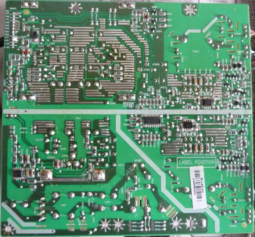

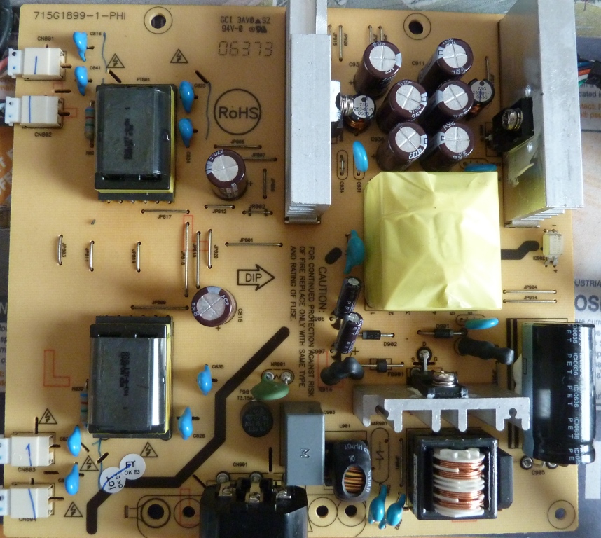

    The best way to get assistance is to take a picture of the top of the power supply and attach it to your next post using 'Manage Attachments' - below the text entry area. A second picture showing the bottom of the power supply would also be appropriate. Pictures with a resolution close to the maximum of 2000 x 2000 pixels are best. Also, note the links in my signature.

      Uploaded pics as per your links - tried to get as close as possible to res type using microsoft viewer. If the pics aren't good enough, I'll upload from a different pc that has adobe lightroom on it.

        They aren't real good, but will do for now.
        First, to answer your question, the large rectangular object wrapped in yellow tape near the center of the board is the SMPS transformer. There are two small electrolytic caps to the left of it, I believe they are C906 and C907. Those two caps are critical to the SMPS operation.
        Next, I'm going to suggest a few tests. Refer to the picture of the bottom of the board. In the upper left corner is the connector for the cable going to the signal card. I can see points labeled GND, 5V, 12V, DIM and ON/OFF.
        With the power supply plugged in, but disconnected from the signal card, measure the voltage from GND to 5V, 12V, DIM, and ON/OFF.
        Now unplug the power supply, wait a few minutes, connect the cable to the signal card but disconnect the signal card from the LCD panel, plug in the power supply and measure the same points.
        Repeat these steps with the LCD panel connected to the signal card.

              Just to add to my previous post - i changed the two caps next to the transformer - CLICKING HAS DISAPPEARED!! You were right, so the PSU is operation again.
