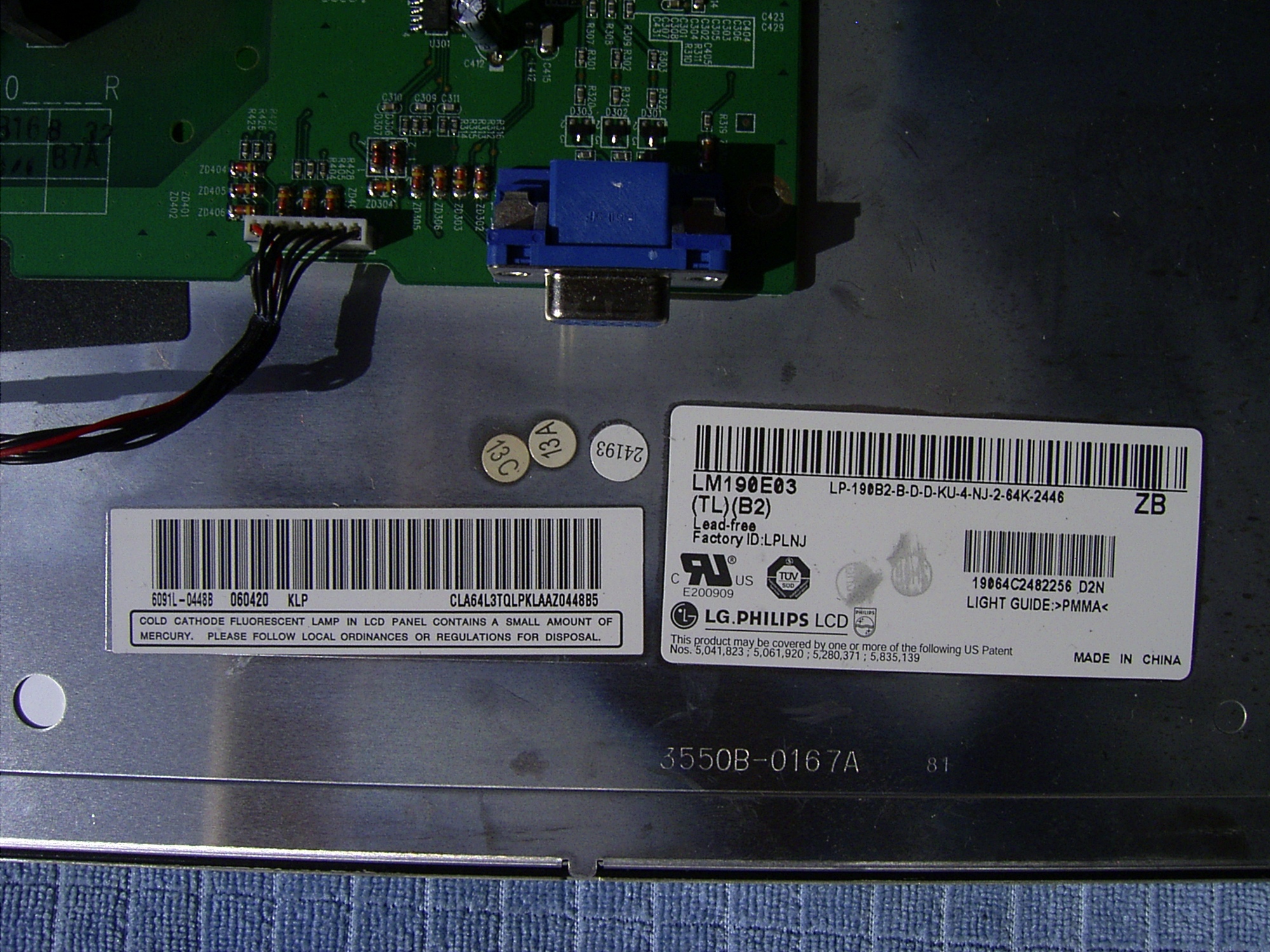

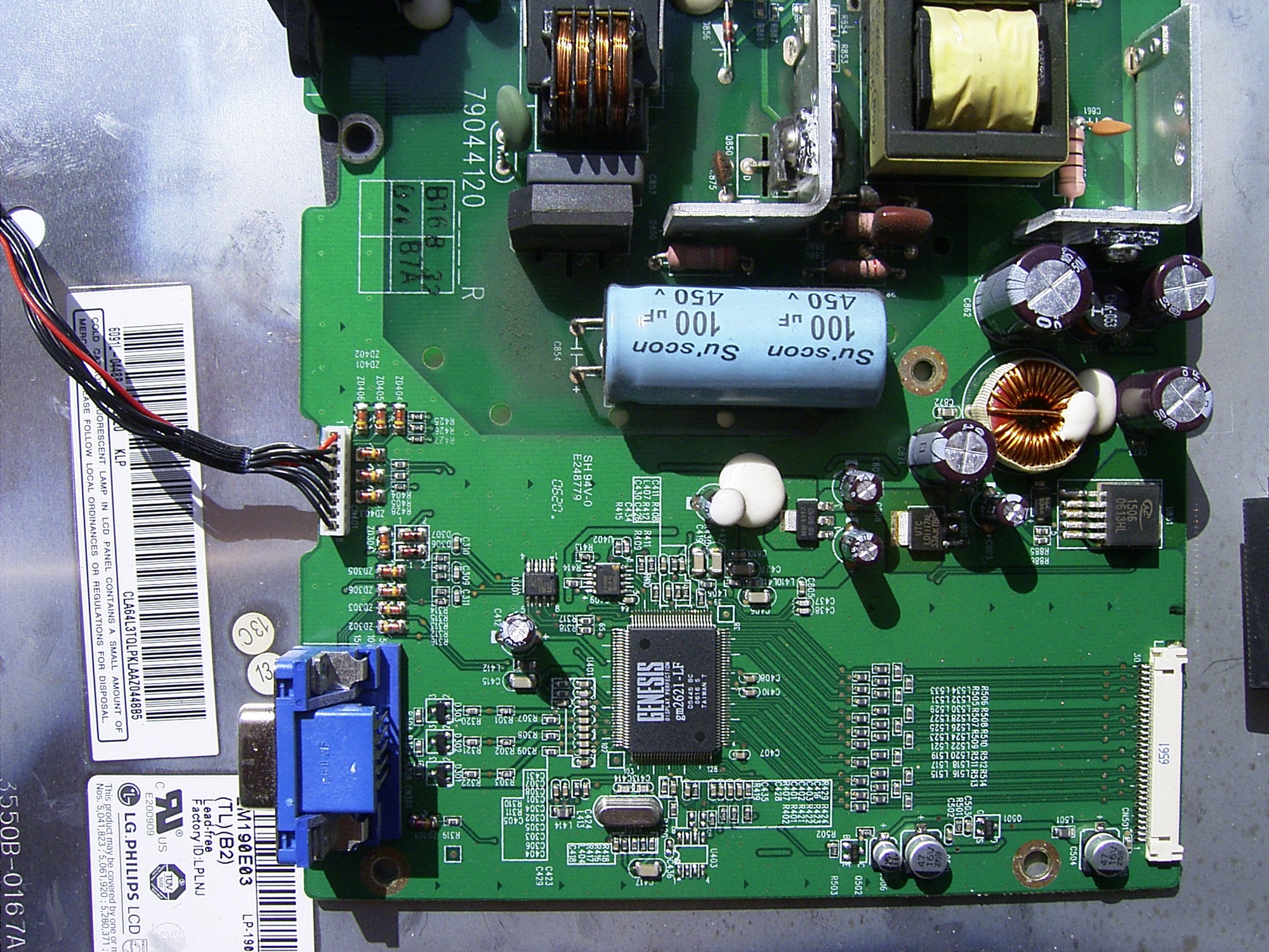

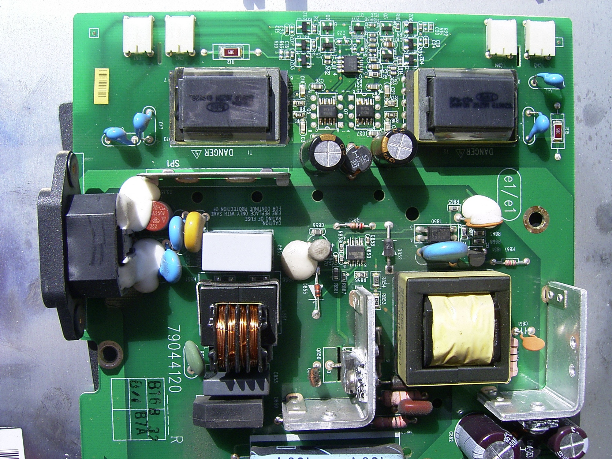

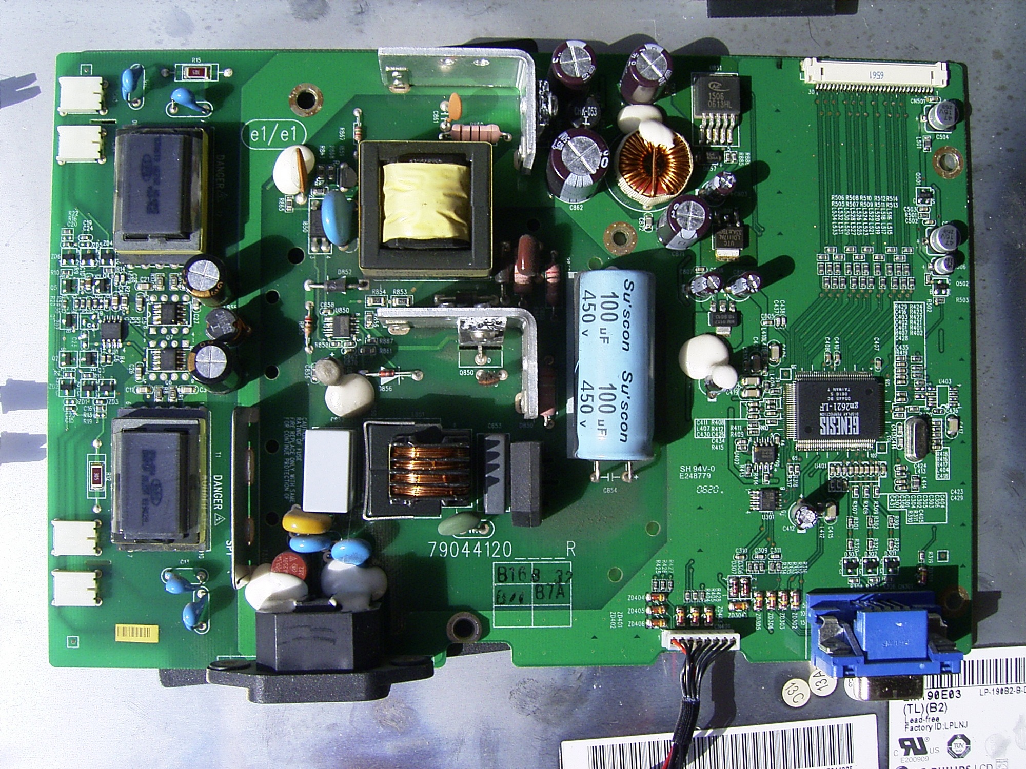

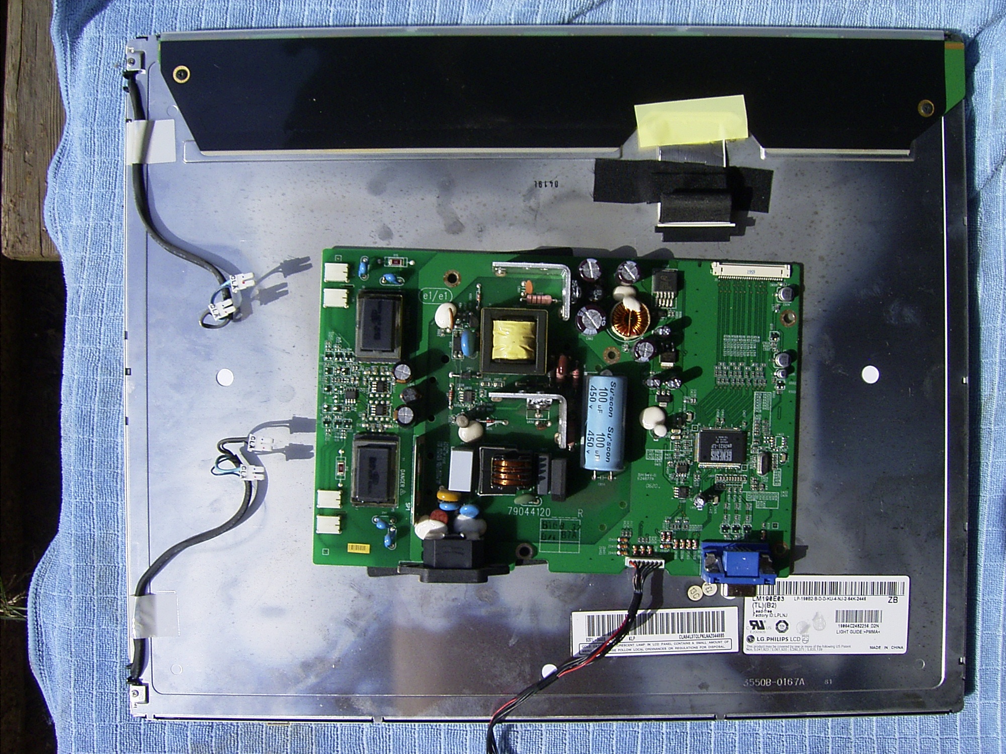

    i have a Dell E196FPf monitor that showed a very "low light" picture.
    i mean that i had to turn off all the lights in my room to hardly see what's on the screen.
    so i opened it and saw 2 220uF 25V bad cap's, i replaced them with 2 330uF 25V caps (this is what i had and i understood that i can replace the 220uF caps with up to 440uF caps with same Voltage).
    after that, i turned it on and all the screen is white, the light is ok, but white screen is all what i got.
    what should i check more?
    here's some pictures of the board:
    thank you,
    Oren.

          Assuming the caps you changed were C1 and C9, these would not effect the video out, as those are part of the Inverter/Backlight circuit.
          Your first port of call is to measure the voltages on U801 and U802,which are located just to the right of the Large Cap.Put the negative probe of your meter(I assume you have one !!) into the VGA Screw hole, and then measure the DC Voltage on each of the pins of the 2 voltage regulators, and advise the readings you get.

            The D- sub cable is not the correct cable,you need to check the flat cable from the logic board to the LCD panel

              I'm not sure who told you that, but as a general rule, changes in capacitor value should be made only if you understand the function of the capacitor. Many capacitors perform some timing function. Change them and the circuit may not work. Sometimes filter caps are selected to establish power rise times. Again, a significant change in value can upset that.
              If memory serves, a year or more ago someone substituted a higher value cap in the power supply of his signal card and discovered it wouldn't work at the higher resolutions. Installing the proper value corrected that.
              As to the specific problem you are now seeing, the most common cause of 'white screen' is an improperly seated ribbon cable from the signal card to the LCD panel, just like alexanna suggested.
