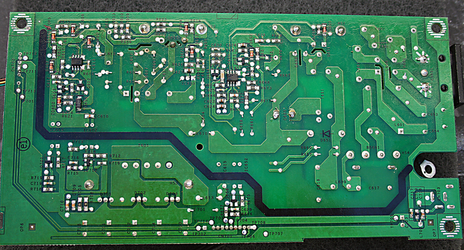

    We have a Winner:
    My 2407WFP is working again.
    The for the cap C626 i used 1nF, Farnell 1856532,
    seems to work fine.
    Still working on the Schematics, have it but need to draw them better.
    Will post when ready.
    Thank you for you help!

          I found a schematic diagram for the power board (4H.L2K02.A11) of the Dell 2407WFP. The document is naturally for the BenQ FP241VW.
          The original document with an ugly background can be found here.

                    Ok.. here are some photos of the damage. I've already removed the big cap and R670, and installed a Rubycon 450v 120uF capacitor. I just did some testing and I believe Q651 is bad, and now that can see the IC's up close, it looks like IC651 may be bad. Not sure on that though.
                    But I came here to get your guys opinion considering I'm very novice at diagnosing problems with circuit boards.
                    I found "new" power boards for the 2407wfpb on ebay, shipped from Hong Kong for only $24.99, which isn't a bad price. From my understanding though, they come with Elite caps, which should be replaced on day 1.
                    As a backup plan I came across a laptop power brick which is 19.5v (actually reads 20v on my meter), 5.13A 90watts. Spec wise, it seems perfect for modding the 2.5mm jack on the power board and going that route. I'd rather not risk killing this screen though.

                      Well.... I replaced the big cap, q651 MOSFET, and burnt out R670 resistor... Put things back together just enough so I can apply the power and when I did... I saw a quick flash from the ceramic fuse.
                      Any thoughts?
                      Edit:
                      Hmm... Did the fuse blow because the cap was empty? From my experience with powerful car audio amplifiers I recall that when first applying power the fuse would blow because of that sudden power draw to fill the amos built in capacitors or if I was using a separate stiffening capacitor. To avoid this on first hookup we'd ground the amp and put a resistor between the hot terminal and the power cable. I know this far less power with these caps but wouldn't the same principal apply since the fuse is correspondingly small?
                      Thanks!

                        Re: Dell 2407WFPb Monitor - Bad Cap
                        If the output of the IC (which is more likely to be damaged) that drives the Gate has stuck HIGH output instead of switching on and off, the MOSFET will be fully on, basicaly shorted the main B+ to primary circuit ground, it is always good idea to replace the IC and the MOSFET at the same time.
                            Doh!!! Time to order a new IC.
