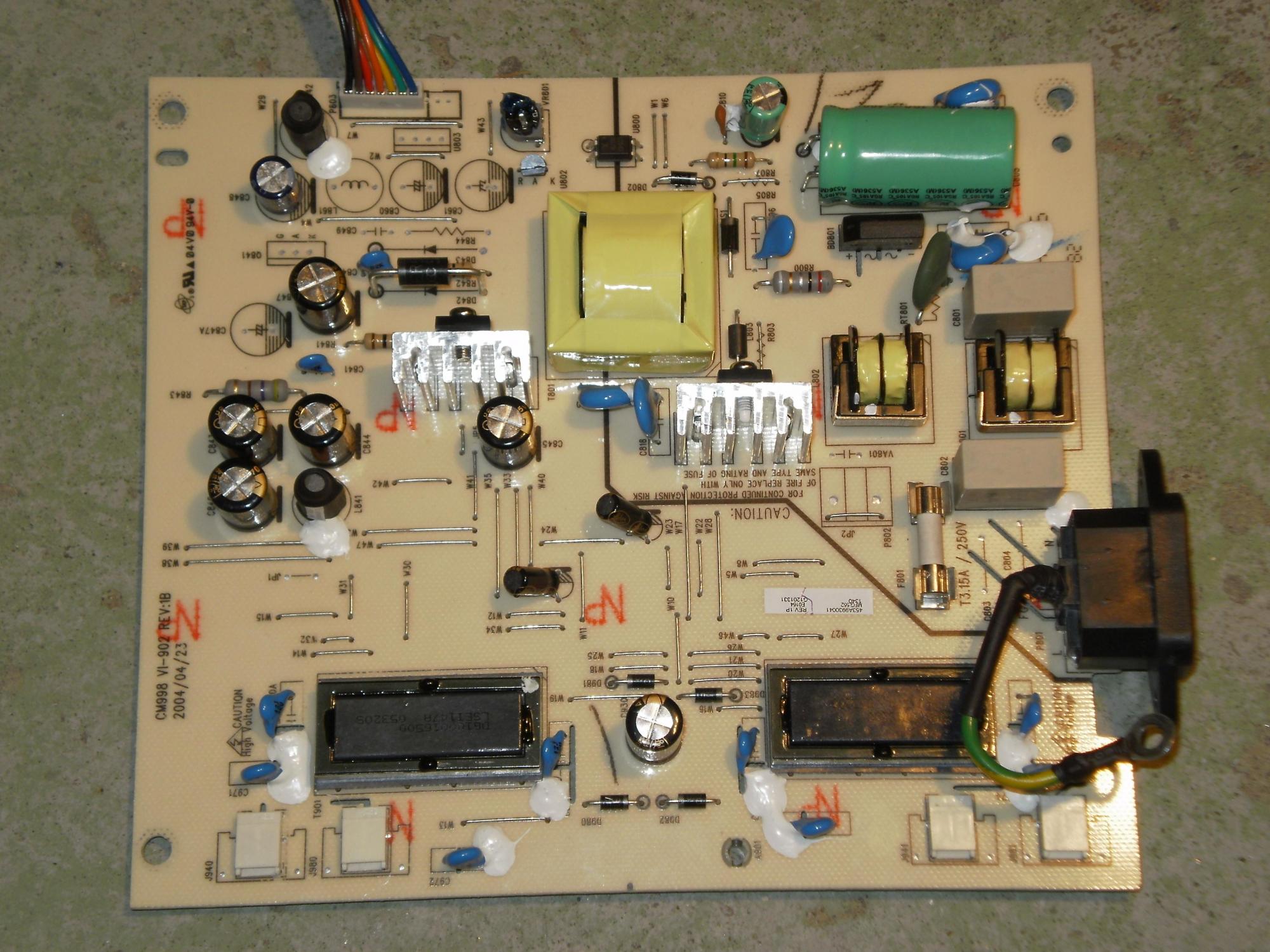

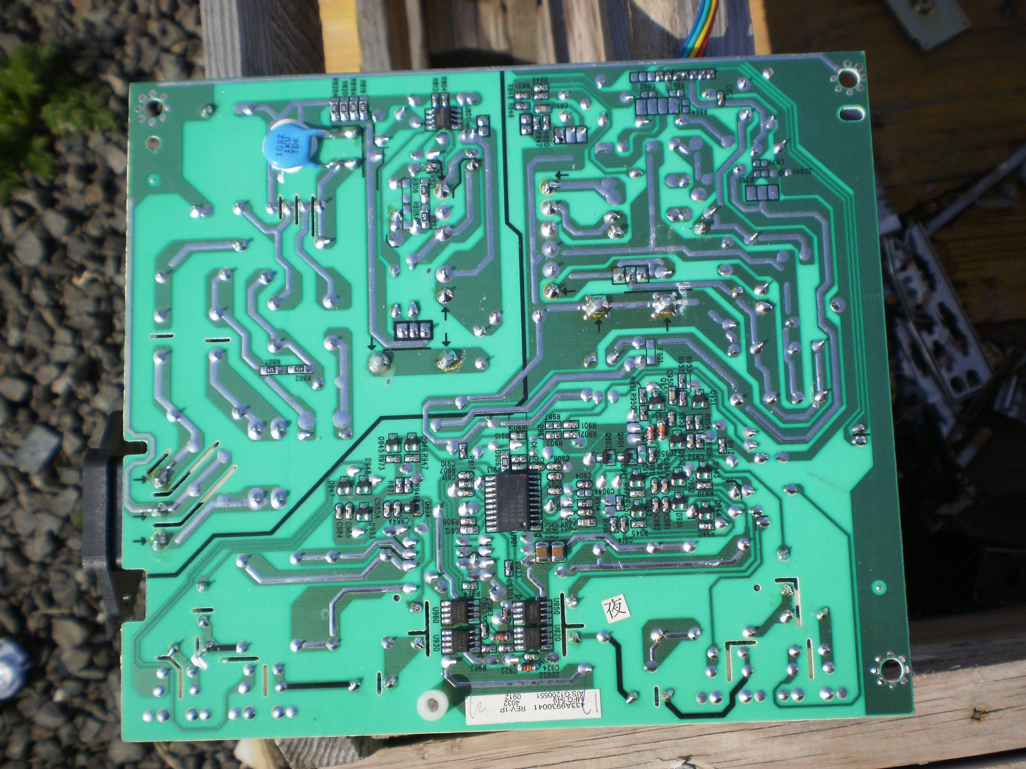

Neovo F-419 no power.
+ More Options
Latest Activity
  • playman
    replied
    Re: Neovo F-419 no power.
    Hi again, sorry for the late post.
    I finally was able to check the cap, it mesured 320v
    Leave a comment:
  • PlainBill
    replied
    Re: Neovo F-419 no power.
    Originally posted by playman
    Thanks it took me a while though, to get them that good lol
    I'm in Iceland, using 230v system.
    The fuse was the first thing I checked
    how should I check the Cap? plug the monitor in and test it or? sorry i'm still a newbie
    btw I have no ESR tester.
    Correct, with the monitor plugged in, CAREFULLY check the voltage across the large cap. On a 230 volt system you should see about 320 volts across the large cap.
    PlainBill
    Leave a comment:
  • playman
    replied
    Re: Neovo F-419 no power.
    Originally posted by jetadm123
    Nice photos!
    Thanks it took me a while though, to get them that good lol
    Try checking the main fuse, F801, 3.15A for continuity. If it checks good, then check the voltage across the main cap (large green one upper right). If you are in the USA, it should measure approx. 165VDC.
    I'm in Iceland, using 230v system.
    The fuse was the first thing I checked
    how should I check the Cap? plug the monitor in and test it or? sorry i'm still a newbie
    btw I have no ESR tester.
    Leave a comment:
  • jetadm123
    replied
    Re: Neovo F-419 no power.
    Nice photos! Try checking the main fuse, F801, 3.15A for continuity. If it checks good, then check the voltage across the main cap (large green one upper right). If you are in the USA, it should measure approx. 165VDC.
    Leave a comment:
  • playman
    started a topic Neovo F-419 no power.
    Neovo F-419 no power.
    I get no power on the lcd, not even on the power led.
    scematics of the PCB.
    D801 was missing when I opened it, I replaced it with RGP10D instead.
    D802 is PS104R D0-41 PANJIT wich seems identical to PS1010R DO-51 PANJIT wich I belive should be in D801.
    Any ideas what might be wrong?
  • Caly411
    burned mosfet wich has written on top "I6 GUE 8v1507"
    by Caly411
    Hi, Im having a similar problem with my Acer Nitro 5 AN517 52, took it to repair and they said that the problem was a burned mosfet wich has written on top "I6 GUE 8v1507".
    There is written PQB12 on the motherboard right next to it.
    Does anyone know if there is soemthing similar I can buy to replace it with?
    Seems impossible to find theidentical mosfet online.
    08-30-2023, 10:48 AM
  • cacko85
    Asus R520U wich type od ssd ??
    by cacko85
    Hello folks
    Laptop Asus R520U problem with instaling ssd drive, laptop come with 2.5" hdd drive, but there is slot for ssd (M.2 I think) I put SAMSUNG 500GB SSD 980 Pro M.2 PCI-E NVMe, but can't be recognized in bios or windows
    I don't have any other type of ssd to try, maybe the bus is sata3 not pci-e ??
    Any info ?? tnx...
    08-13-2021, 03:07 AM
  • Malcolma172
    Philips 42pfl6008s/12 red led comes on for a second and then goes away but 3.49v stay active
    by Malcolma172
    I was trying to repair my tv wich previously had a blinking red led 2 times and it kept going. After shorting the sdm the blinking led changed 5 slow blinks and 3 fast ones wich in the service manual meant error 53 / the fusion chip.
    After I heated the fusion chip with a hairdryer for 5 minutes it started working perfectly but after a day it stopped this time no led blinks even in sdm mode.
    After probing the psu I have 3.49v and for 1 second I have at least 2 12.3v lines active the fusion chip gets warm in that second the led turns on and then the 12v lines start losing power...
    07-23-2025, 01:20 PM
  • ladharimohamed2
    Need bios toshiba satellite pro r50-b-15j
    by ladharimohamed2
    I need bios for toshiba satellite pro r50-b-15j motherboard faebsy2
    i have tried this :
    but no power
    and i tried this
    the laptop worked but asked for a password
    i have tried many with same motherboard name wich is FAEBSY2 A5A003954010 A but the laptop didnt turn on (no lights, no fan spinning)
    i have attached my original bios wich has been corrupted after a windows update (turn on but black screen)
    if any have the bios for the exact model name will be great "toshiba satellite pro r50-b-15j"...
    04-18-2024, 07:54 AM
  • Larchemont
    HP Elitebook 840 G1 BIOS Issues
    by Larchemont
    Hello Folks,
    i have a HP Elitebook 840 G1 with a locked BIOS and i have bought a CH341a (black PCB). My problem is that the Bios Chip reads 25Q128A 13ECO and i cannot find a profile for this chip in any of the software recommended in the guide threat in this forum. The chip cannot be detected wich i dont find too surprising, but i can read the chip with random other profiles selected.
    I have found a post in this forum in wich the user stated he was able to flash this exact chip with the CH341a and the testclip, but unfortunately this user is no longer active. In...
    08-21-2022, 07:24 AM
