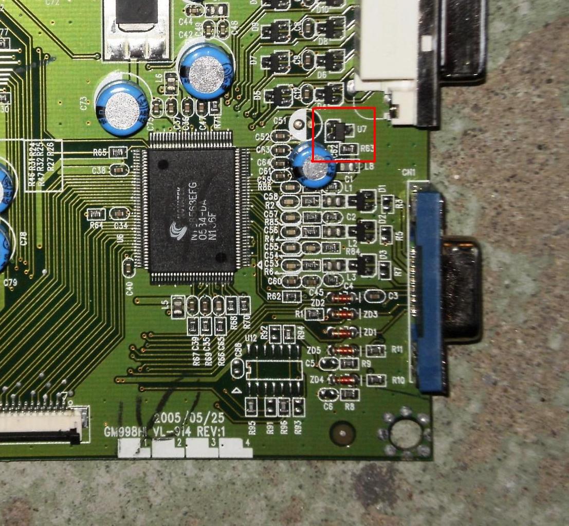

            Had a quick look at the schematic. Apparently, your monitor has a reset circuit, which if faulty, can cause the problems you describe.
            1) look at the link below, it describes a acer monitor with the same problems you have and describes the function of the reset circuit:
            https://www.badcaps.net/forum/showth...ghlight=max810
            2) the chip on your board is U7, part # MCP809-300 and is located on the logic board.
            3) please post a photo of the logic board.

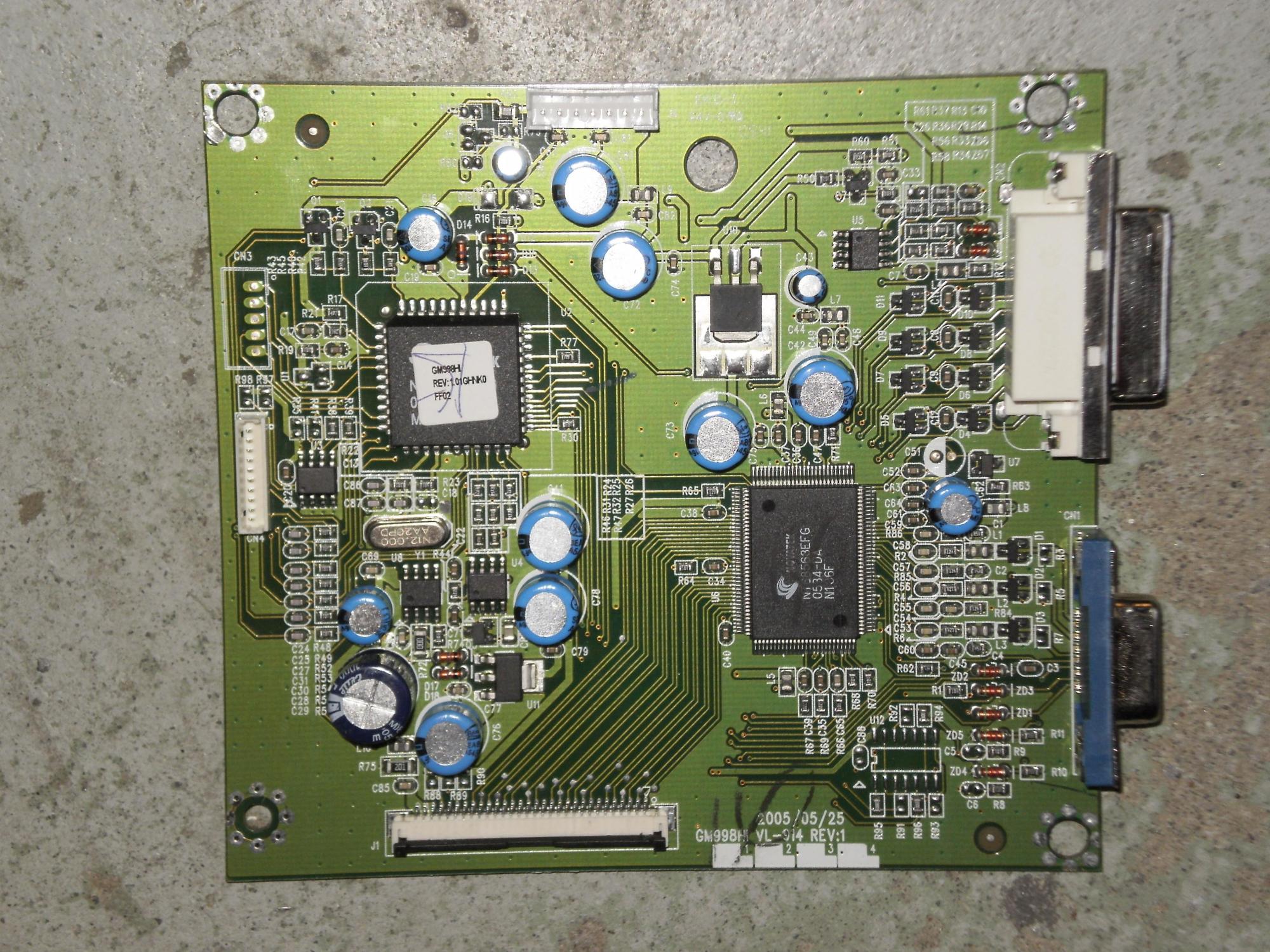

                Re: Neovo F-419 no power.
                Hi jetadm123
                I was not able to find the U7 chip, I must be blind
                any way here are the fotos you asked for.
                sorry for the flash on the picture.
                • pedro
                  • 199
                  • AUSTRALIA
                  Originally posted by playman
                  Hi jetadm123
                  It's east-north-east from the NE corner of U6, half-way to the connector. It's in a SOT-23 style body, only three pins on this device.

                        Hopefully, you read the link I provided. If U7 has failed, it prevents the power supply from starting up, which results in zero ouput from the power supply.
                        • sabre504
                          • May 2010
                          • 449
                          • United Kingdom
                          U7 on pic
                              Not quite correct.
                              U7 is the reset controller for the processor on the signal card. If it is bad the processor will not start, and the power LED will not come on. You WILL still have the normal voltages out of the power supply.
